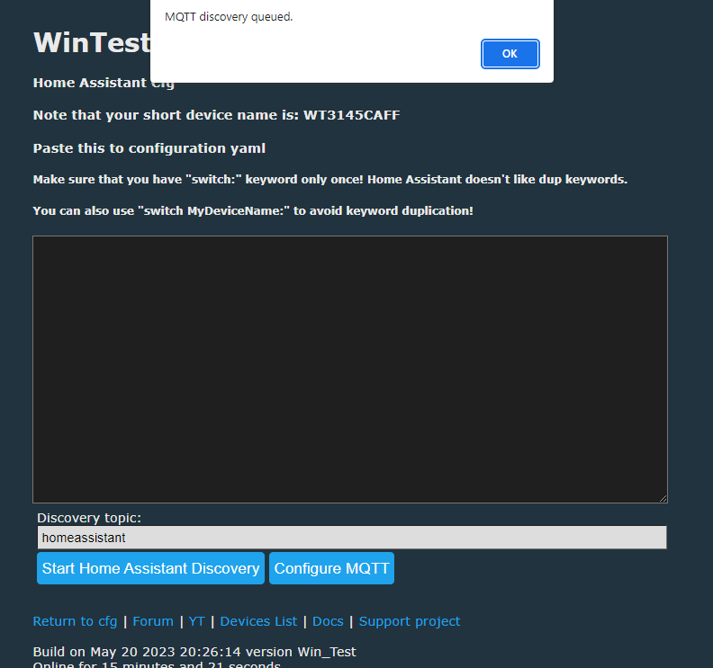

    @nelevit thank you for reporting, it turns out that Autodiscovery is simply missing a check to work with TuyaMCU.
    You have two options:
    1. just do a Yaml copy/paste from this topic (to configuration yaml, it's very simple, just remember to check device mqtt name)
    2. wait for an update that will add a missing link between TuyaMCU and autodiscovery

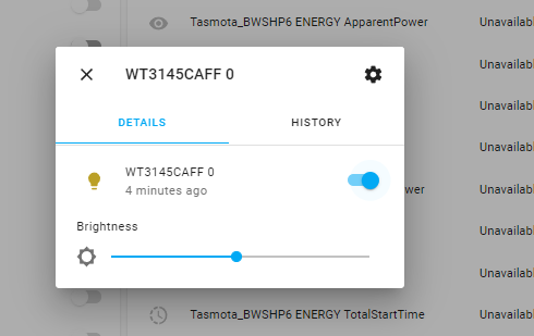

  • Updated Home Assistant YAML for TuyaMCU dimmer
    #35 20326969
    nelevit
    @nelevit before that's added to Autodiscovery, is the Yaml from the first post working for you?
    Hi, I have an update :) Managed to add it via configuration.yaml, works like charm.
    The code from above had to be slightly tweaked as they changed syntax:

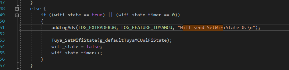

    I _thought_ it was caused by `wifi_state_valid = 0`. I'm guessing we're sending that to the MCU and it is getting annoyed and beeping to say "Hey, I'm here in pairing mode ready for you". And the MCU doesn't get reset when the WB2S gets reset, so it's only on hard power off that it stops beeping.

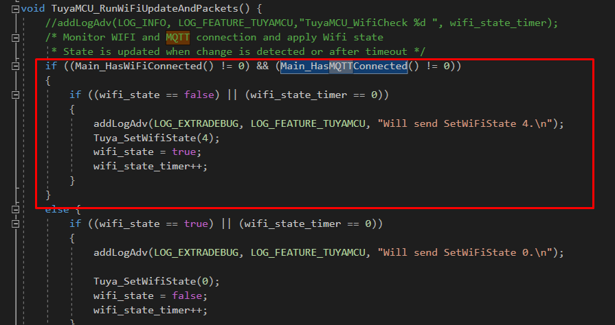

    I remember having a report that device beeps while MQTT is not connected. What kind of change would you propose to mitigate it?
    I wouldn't recommend sending raw packets.
    Maybe add a flag to make device always think it's paired?
    I could even change the "wifi state always valid" to default behaviour but I am worried that it might break sensor devices which have to wait for wifi/mqtt state to be correct before reporting.

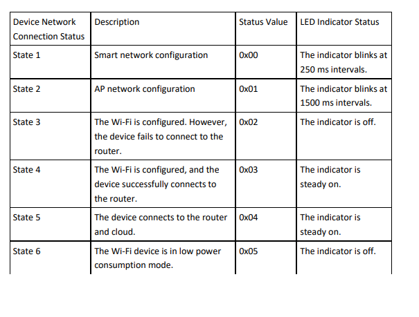

    Maybe we should use a different WiFi state as a default one?
    OpenBeken and TuyaMCU dimmer - configuration guide/tutorial
    by default, obk is using 0x00 status value.
    I could add a command to change it so you can check what happens if 0x02 is a default one...
    UPDATE:
    added command: tuyaMcu_defWiFiState [Value]
    it will set the default wifi state to use when mqtt/wifi is not connected.
    Usage: add in autoexec bat line:
    tuyaMcu_defWiFiState 3
    to makeTuyaMCU think by default that:
    The Wi-Fi is configured, and the
    device successfully connects to
    the router.
    Can you try if it helps for you?

    #39 20386150
    max_allan
    I found when setting values from the logs page I have to wait for the wifi_state_timer to reach 60 and reset (so about a minute) for each value to take effect. That confused me a bit while testing it out, sometimes values worked, sometimes they didn't!
    0 : Rapid beeping, leds flashing (bip bip bip)
    1 : Slow beep, leds flashing (beeep, beeep, beeep)
    2 and above : No beep, leds steady
    So, yes it works, thanks a lot that was really helpful, and such quick service!! :D

  • TuyaMCU log string fix and dpId timer note
    #40 20386202
    Posts: 14756
    Rate: 12883
    Don't worry, we're here to help get all your devices running cloudfree.
    If you can, could you provide some photos of your devices so we can add it to templates list here:
    The current code was assuming that TuyaMCU gets only "paired and online" message when MQTT is also connected. That's why it kept it in wifi state 0 all the time.
    Sorry, this is correct. I can see how that can be confusing.
    The current system periodically sends something like a "keep alive" packets to TuyaMCU and requests dpIDs. You can see that there are counters to see how many seconds has passed since last update.
    Great catch with that "something else is trying", because it's my mistake, I forget to change log string
    As you can see, it's not trying to set 0, it's just not updated log value.
    It's fixed now.
    Regarding special dpIds - maybe there is something like a countdown timer available? You can check if it works.
    Altough we also have a scritpable countdown timers in OBK itself so it's not really needed

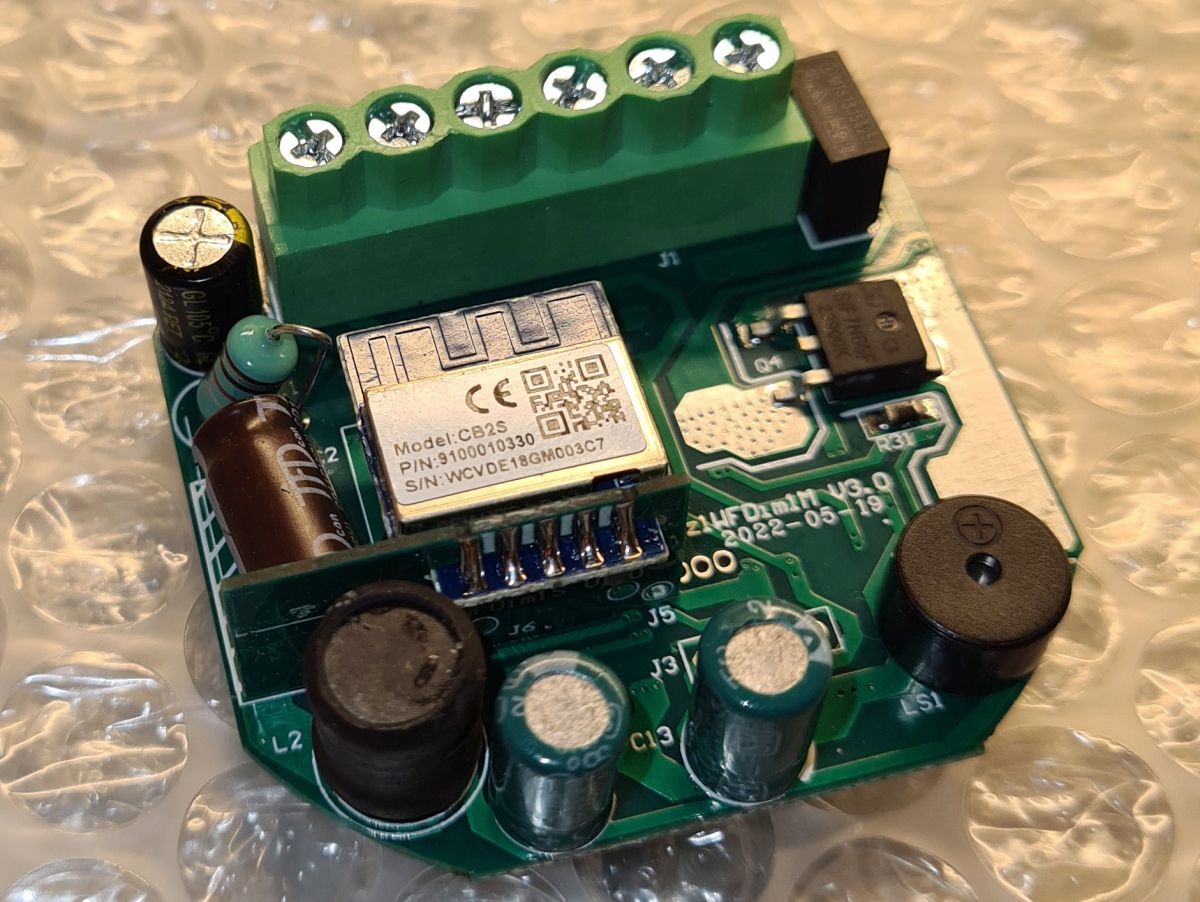

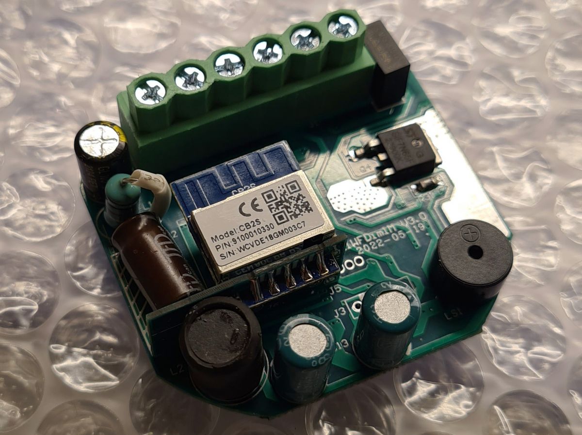

    I have bought one of these from Aliexpress with v3.0 of the same PCB. They have switched to an SMD transistor SIF7N65F: datasheet
    I guess it's a cheeper option as it has lower current limit and higher resistance: Vds = 650V, RdsOn = 1.1Ohm (vs. 0.6Ohm), Id = 7A (vs. 12A).
    A problem that could cause the damage to the one burnt is that on mine was basically zero clearance between the Wifi module and the current limiting resistor:
    What I did I have added some heat shrink on the resistor wire:
    Other solution could be to rotate the resistor to have the body on the Wifi modules side and the wire on the other, but that would require de-soldering both ends.

  • Beep fixed with tuyaMcu_defWiFiState 3
    #43 20456812
    gbauer
    I also had the Beep isse on my recently bought device, could also fix it with the "tuyaMcu_defWiFiState 3". Probably you can also add this to the initial post, it took me some time to recognize that there are additional pages in this topic.
    One question, when i do a power cycle the dimmer is always in "off" state. In Tasmota you can configure this state to use the last known state. Also for relais Contacts this might be helpfull. Is this already possible with openBK? I searched for such a command without success.
  • Checking default value 3 and TuyaMCU last-state support

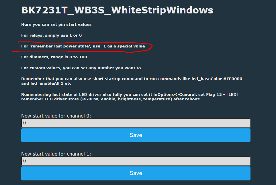

    For remember last state, we are using:
    The problem is, I don't know if it works for TuyaMCU, can you check?
    If it's not working then I can try to fix it for you, but I 'd need your help with tesitng.

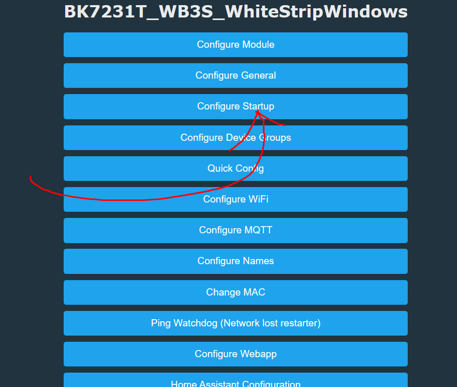

    The Startup command seems not to be working. I tried all combinations, the connected Lum is always off when i power the Dimmer up.

    @gbauer I have prepared a work around for your problem, but you show the config of your device?
    Since latest update, the special channel indices 200 at further, are saved in flash memory.
    So you can now do:
    1. make sure that in startup you have 0 values (or 1, not -1, to avoid overwriting values)
    2. add a script like:
    // when channel 0 changes, save it to flash channel 200
    addEventHandler OnChannelChange 0 setChannel 200 $CH0
    // when channel 1 changes, save it to flash channel 201
    addEventHandler OnChannelChange 1 setChannel 201 $CH1
    // when channel 2 changes, save it to flash channel 202
    addEventHandler OnChannelChange 2 setChannel 202 $CH2
    // On start
    // addRepeatingEvent [RepeatTime] [RepeatCount]
    // This should fire once due to RepeatCount 1
    addRepeatingEvent 5 1 backlog setChannel 0 $CH200; setChannel 1 $CH201; setChannel 2 $CH202
    This basically does two things.
    This addEventHandler saves channel values to special flash channels when the channel changes:
    And the code below runs only once at startup, after 5 seconds, with 1 repeat (only once), and restores those values from flash manually:
    Please try it, you might need to adjust the script, or post your full autoexec here so I can do it for you.

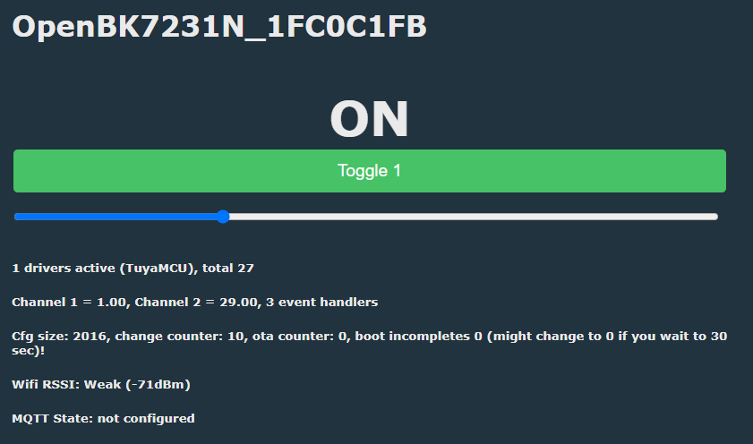

  • Autoexec.bat TuyaMCU dimmer configuration not working
    #47 20462342
    gbauer
    Hi,
    thanks for the work. Thats my autoexec.bat content:
    startDriver TuyaMCU
    setChannelType 1 toggle
    setChannelType 2 dimmer
    tuyaMcu_setDimmerRange 0 1000
    linkTuyaMCUOutputToChannel 1 1 1
    linkTuyaMCUOutputToChannel 2 2 2
    // On start
    addRepeatingEvent 5 1 backlog setChannel 1 $CH201; setChannel 2 $CH202
    It seems not to be working at the moment. I am running FW 1.15.513.
  • Verify channel saving with echo $CH2 and $CH202
    #48 20462358
    Posts: 14756
    Rate: 12883
    Edit, wait a moment.
    Added after 3 [hours] 6 [minutes]:
    Please update to latest version which has a cosmetic change for echo command, and then can you do some simple debugging steps, so we know what's wrong?
    Let's start by setting your dimmer on user interface to some strange value like 73%.
    Then, on Web App console do:
    echo $CH2
    This should print value of channel 2, so I'd expect 730 ?
    Then try:
    echo $CH202
    This should print saved value of channel 2 from slot 202. Also 730?
    Then do reboot. Device restart.
    Then do again:
    echo $CH202
    echo $CH2
    Please do all four steps from above.
    And again, I will repeat- you should put "0" (disable) the channel saving in Startup in WWW panel, because otherwise it would overwrite the manually saved channels.
    I will also try to double-check on my device to make sure the mechanism works.
  • Autoexec config restored TuyaMCU dimmer operation

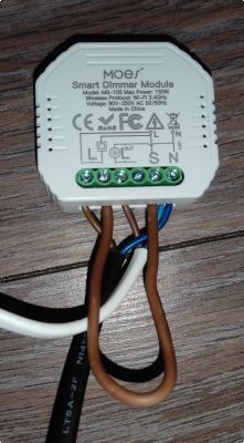

    So this is a long shot but maybe someone can help me :) I just got the MOES MS 105 WIFI dimmer and want to put openbeken on it. It's a good dimmer and I would like to install a couple of them however hit a wall with the openbeken flashing with cloudcutter. I have set up a raspberry pi 3 just for this and with many devices it worked flawlessly, either with the button pressing method or the 6x on/off method, not with this device however, it looks like this one does the pairing differently.
    - Out of the box and on first power on it is already in AP mode and beeps rapidly, if it's paired in the tuya app the beeping stops.
    - Connecting/disconnecting it to power 6 times does not put it in ap mode again, only deleting it in the tuya app does.
    - When in AP mode, tuya cloudcutter does not see it - I did this with around 10 devices by now so I think I'm not doing something wrong here
    Additional info:
    - The manual emphasizes that bluetooth on your phone needs to be activated, could it be that with this device pairing (and potentially also putting into flashing mode) somehow needs to be achieved via bluetooth?
    - According to the tuya app it runs V 2.0.2

    When I go to HA autodiscovery and click the button I get the error message that no "No Relay, PWM, sensor or power driver running, HA discovery queued" - does not show up in HA and I guess the message hints at the reason :) but I don't know how to solve this
    Added after 39 [minutes]:
    Additionally, the field for the yaml config in the home assistant menu is also empty.

    #53 20551594
    Posts: 14756
    Rate: 12883
    Very good job, it seems you have figured it out, but here are my hints:
    - HA discovery is not there yet for TuyaMCU devices
    - if device beeps, you may force it into thinking it's paired by using tuyaMcu_defWiFiState 4 command in autoexec.bat after starting tuyaMCU
    - if nothing is received, you may also try to change TuyaMCU baud: tuyaMcu_setBaudRate 115200 in autoexec.bat after starting tuyaMCU
    - it is also worth to put PowerSave 1 in autoexec.bat , but make sure to check if it works good on your device. It will reduce power usage and heating of wifi module
  • TuyaMCU dimmer needs 9600 baud and switch cable
    #54 20551611
    jrhenk
    Posts: 59
    Rate: 8
    Thanks for the compliment and sharing these finishing touches! Maybe interesting for the database or future tweaks:
    - I already tried tuyaMcu_defWiFiState 4, also 3 and 5 - but without the cable faking a switch it kept giving the beep on startup and dimming up and down. The strange part about this is that in the manual it says that the dimmer only works with a push switch and with the cable it is now as if you keep holding this switch constantly :) As the connections for the switch are high power, I guess it might be something hardcoded on the daughterboard that is hard to overwrite/control via the firmware?
    - tuyaMcu_setBaudRate 115200 does not work, seems it needs to stay 9600
    - I give PowerSave 1 a try, with this option it's still working perfectly and maybe it indeed stays a bit cooler now. It's not terribly hot but I noticed it is getting a bit warm over time, so thanks for this. There are so many possible commands so a pinpointed recommendation is always nice!
    Thanks again for all the work you put into this, the percentage of openbeken flashed devices keeps growing in my house :)
  • Suggesting a status check between Beken and TuyaMCU
    #55 20554301
    jrhenk
    Posts: 59
    Rate: 8
    Hi again!
    So I installed the dimmer and had a bit of time to stress test it - I noticed that ever so often (couldn't find a logic yet) the beken chip thinks the light is on (sends the update via mqtt and displays it on its own webui) but it seems something went wrong with the communication with the tuyaMCU. Would it be possible to build in a check whether the TuyaMCU status and the Bekenchip status are the same after a command has been sent in some of the next updates?
  • Requesting Web App logs to trace false TuyaMCU state reports
    #56 20554421
    Posts: 14756
    Rate: 12883
    TuyaMCU communication is using CRC to check the content of the packets, so there is a very little chance of getting any garbage data.
    Please try to keep Web App Log open with extradebug log mode (or even all) and try to find out what happens in logs when you get a false state report.
    Currently I have no idea what may be happening, the only options is that TuyaMCU reports given dpID as boolean value 1, so it's kinda TuyaMCU's fault for saying that light is on...
    Unless you have a configuration error. That also could be possible.
    Web App log would tell us where does the "light is on" value comes from.
    Btw, you are the first one to have such issue and we already had many TuyaMCU lights and users with obk..

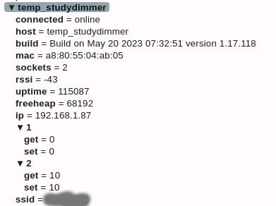

    #58 20587994
    jrhenk
    Posts: 59
    Rate: 8
    Hi! It's been a while so I wanted to ask about the status of getting brightness control with tuyamcu in Home Assistant with autodiscovery again :) I just tried again with the most recent firmware but for me it's still not working. I remember that it was working for you from a screenshot but in my case I just checked the information being sent via autodiscovery in mqtt explorer and I still can't see any brightness information, just on/off. Tried out all possible mqtt (and just to see what's happening also LED related flags), yet without any success. Don't know if I can still do anything from my side here.
    Here's the home assistant mqtt autodiscovery info from a dimmer with a tuyamcu
    "dev": {
    "ids": [
    "temp_studydimmer"
    "name": "temp_studydimmer",
    "sw": "1.17.118",
    "mf": "Beken Corporation",
    "mdl": "BK7231N",
    "cu": "http://192.168.1.87/index"
    "name": "temp_studydimmer 1",
    "~": "openbk/temp_studydimmer",
    "avty_t": "~/connected",
    "pl_on": "1",
    "pl_off": "0",
    "uniq_id": "temp_studydimmer_light_1",
    "qos": 1,
    "stat_t": "~/1/get",
    "cmd_t": "~/1/set"
    And just for comparison, this is what I see with a tuya rgbw bulb:

    #59 20588750
    Posts: 14756
    Rate: 12883

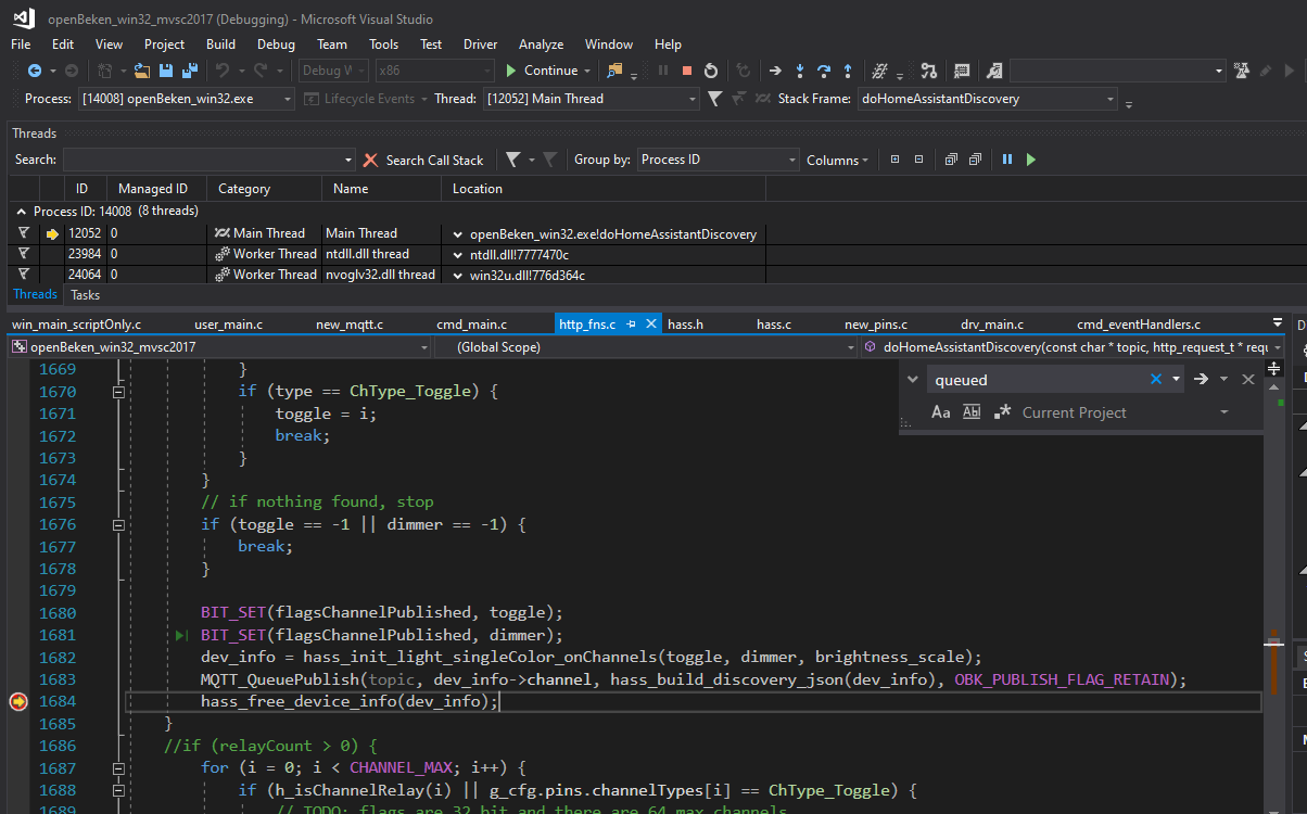

    Hello @jrhenk , I was sure that Dimmer+Toggle discovery is working. It was added recently. Latest version should support it. Let me check...

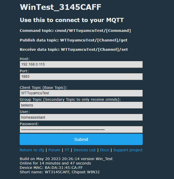

    Okay, first I configure MQTT:

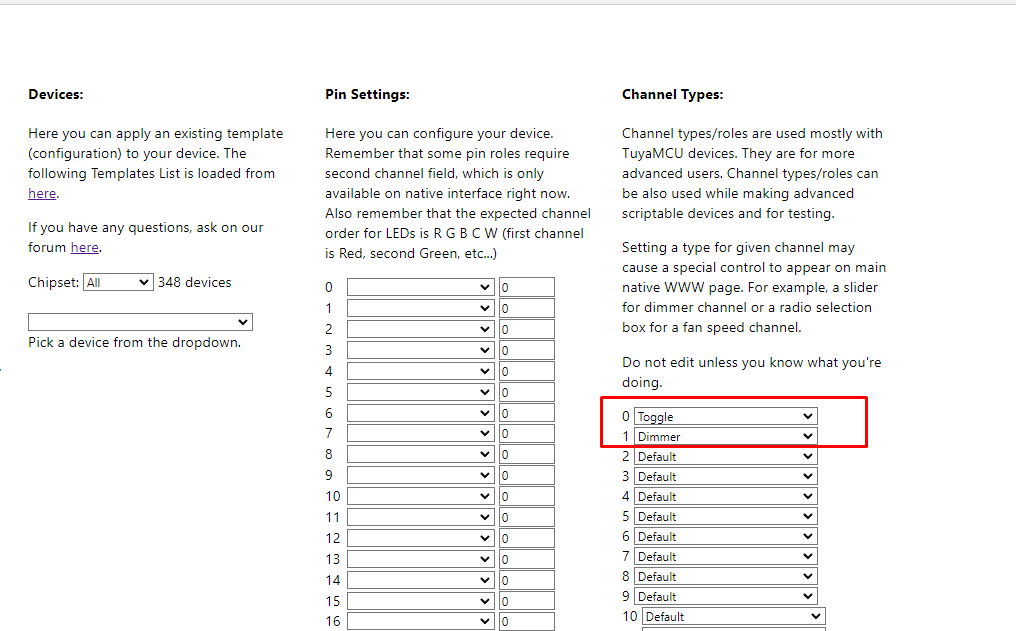

    Then I set channel types:
    Then do Discovery:
    And while debugging, I can see it sees TuyaMCU dimmer TogglE+Dimmer combo:
    Content:

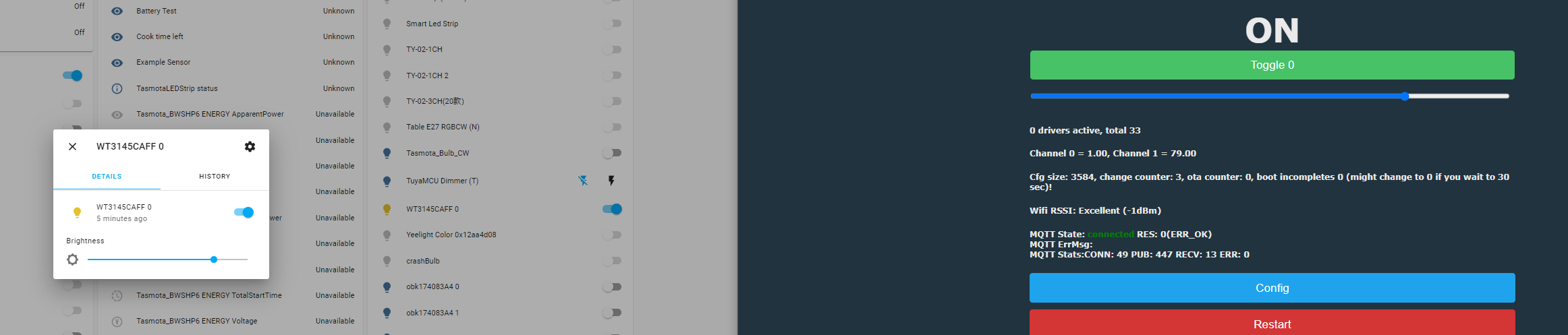

    Hmm and in HA:
    It seems to work for me:
    So, the question is, why it's not working for you? Do you setup both channel types for Toggle and Dimmer?

    #60 20589651
    jrhenk
    Posts: 59
    Rate: 8
    Hi,
    Thanks for the answer and no worries about the delay... I can fully use it with the manual config in the yaml, this would just be nice to work, too. I really can't say why it is not working, I configured on/off and dimmer level, during testing I even reset the device, gave it a new name just to make sure it's not an mqtt issue or a problem with HA that the same device is configured manually and autodetected but still no change. Moreover, when configured manually the "normal" mqtt broadcasts also contain all the info:
    But for some reason the homeassistant autodiscovery one does not:
    "dev": {
    "ids": [
    "temp_studydimmer"
    "sw": "1.17.118",
    "mdl": "BK7231N",
    "pl_on": "1",
    "pl_off": "0",
    "qos": 1,
    "cmd_t": "~/1/set"
    The only thing I think is remaining to test is to set different flags, as I couldn't test all combinations and was just randomly activating, disactivating them to see what happened. Then again, when it's broadcasting everything correctly via one MQTT channel this might not help a lot, but who knows :) Which ones are the most crucial ones to set?
    I'm happy to share any log files or dumps if it helps!
