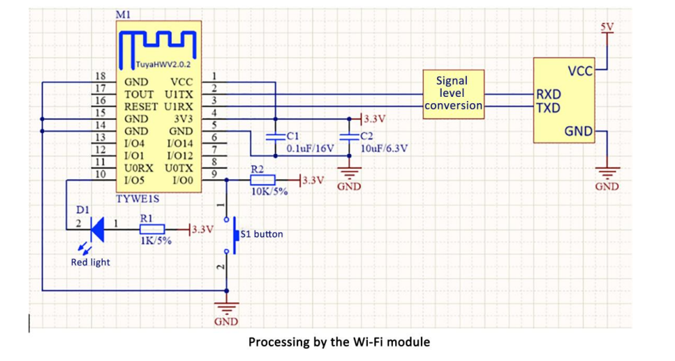

    What is TuyaMCU?
    TuyaMCU is a communication protocol used between the microcontroller and the WiFi module present in Tuya products:
    Connection diagram of a Wi-Fi module with signal level conversion.
    Block diagram of MCU and Wi-Fi module cooperation.

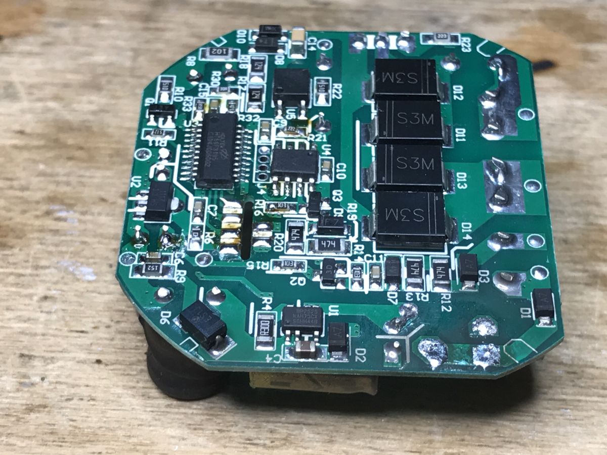

    The interior of the dimmer
    Now it's time to look inside.
    It is really easy to remove the casing.
    Here, the photo gallery will be a bit unusual, because I also have the same dimmer damaged, I got it from one of our users, so I will put both in the photos
    OpenBeken and TuyaMCU dimmer - configuration guide/tutorial OpenBeken and TuyaMCU dimmer - configuration guide/tutorial OpenBeken and TuyaMCU dimmer - configuration guide/tutorial OpenBeken and TuyaMCU dimmer - configuration guide/tutorial
    Two dimmers next to each other, functional and damaged:
    What does the dimmer have inside? First of all, the WB2S WiFi module + Holtek HT66F3195 microcontroller. They communicate via UART.
    They are powered by BP2525 (transformerless power supply), and next to it we have a whole circuit associated with a dimmer (S3M rectifier diodes), an optocoupler to detect the sine cycle, an unmarked controller circuit and ... SIF12N65F. Originally I was expecting a triac here, but this is an N-channel MOSFET (Vds = 650V, RdsOn = 0.6Ohm, Id = 12A). This explains these four rectifier diodes. This dimmer apparently rectifies the mains voltage and then keyed it with a transistor.

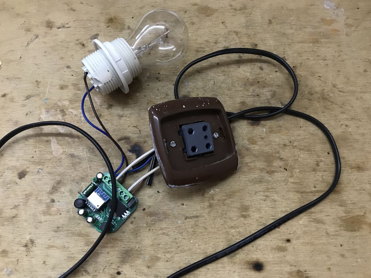

    How does the button work?
    At first glance, you might think that the button is not supported by OpenBeken. But nothing could be more wrong!
    In this product, the button is connected to the TuyaMCU, not to the module with WiFi. This TuyaMCU supports the button. We have everything ready. We connect the button to the appropriate pin (S for switch):
    Both bistable and monostable buttons can be used. The button works in such a way that after switching on the brightness gradually increases and we can choose what level we want by simply switching it again. If, on the other hand, the light is on, the quick switching on and off of the button will turn it off completely. All of this is done by HT66F3195.
