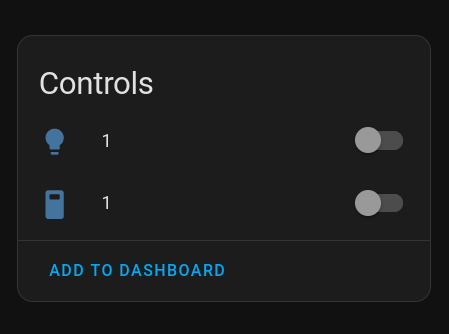

    jrhenk
    Posts: 59
    Rate: 8
    And more interestingly, with it deactivated, I actually get a second icon as if I had activated flag 34
    OpenBeken and TuyaMCU dimmer - configuration guide/tutorial
  • #66 20604121
    Posts: 14699
    Help: 656
    Rate: 12743
    I don't think I experienced that. Maybe there is some kind of leftover from previous config?
  • #67 20604181
    jrhenk
    Posts: 59
    Rate: 8
    Just deleted the device in the HA MQTT Integration, renamed it and let HA discover it again but it still looks the same. Really doesn't matter to me though since the major issue is solved now :)
