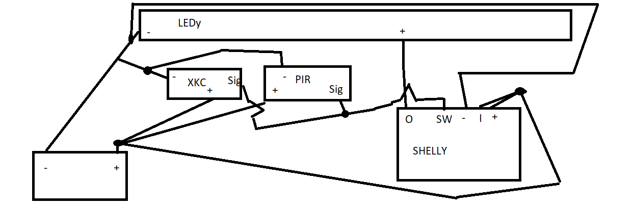

    I would like to connect 12v LED stair lights controlled via Shelly 1 and sensors which would give a signal to this Shelly. At the top of the stairs, I can have a regular PIR, but at the bottom of the stairs, due to the location of the stairs near a place where one often passes, it cannot be a PIR because it catches things badly, so I came up with a photoelectric reflective sensor. Such as an XKC-001A like the one here:
    https://pl.aliexpress.com/item/10050032059355...ffb-f8a4-4577-be6a-08ebd4fdbfa7-45&pdp_ext_f={"sku_id":"12000024656163618"}&pdp_npi=2@dis!PLN!!26.22!!!!!@2100bddd16547159568394694e156d!12000024656163618!sea
    This would meet my expectations I think, only now as I'm not entirely familiar with how this can be paired with Shelly 1 I have a question as to what version of XKC to buy? There are versions XKC-001A-TZ-12 and XKC-001A-NO. From this sensor there are 3 wires, - and a signal which is like a normal PIR sensor. As I understand it, the signal from the XKC-001A and the upper PIR will be connected to the SW terminal of the Shelly and the receivers (LEDs) will be connected on one side to the -(minus) power supply and on the other to terminals in the Shelly, e.g. terminal O and (plus) power supply to terminal I in Shelly 1.
    I know that the drawing is very illustrative, but I am going to illustrate something.
    So my questions are, does it matter what XKC I buy and is it possible to make it so that after driving from the XKC after e.g. 30 seconds the Shelly cuts power to the LEDs and they go out? Unless there is a better way to solve this circuit?
