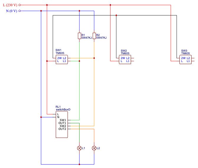

    I am back on topic after a long while. I decided to test the circuit still by replacing the Shelly with a Polish made switchBoxD .
    I connected using 5W47KJ resistors as shown in the diagram below:
    Remote control of tactile switches in a staircase-crossing arrangement .
    The result: it works. It is possible to switch both physically - with a switch - and via the web interface switchBoxD. I selected the 47k resistance by going down from 1M (0.25W), through 330k (0.25W), 100k (5W) and 57k (5W). Only at 47k did the switch detect the load and start to function.
    Previously, connecting via the LED adapter from Touchme also worked. A multimeter measurement indicated the resistance of such an adapter to be 15k (unplugged). As the adapters were getting quite hot, I also tried connecting 2 in series to the output and this also worked and the power was evenly distributed.
    Unfortunately, the 47k resistors get even hotter (they are also smaller in size than the adapters). My question is – would it be safe to enclose them in a can after all, along with the switchBoxD relay? The temperature of each measured with a kitchen thermometer is about 74°C 8-) Or would it be better to connect several in series again to spread the power?

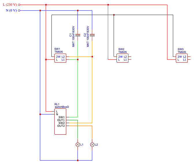

    Unless, instead of 5W resistors, to use something else, like MKT 100 nF / 630 V capacitors?

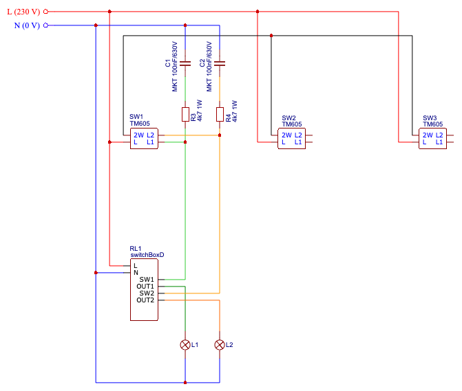

    I finally connected using MKT 100 nF capacitors (630 V), adding 4.7 kΩ (1 W) resistors in series for additional current limitation. It works stably and the heating problem is no longer present.
    I hope that the characteristics of the capacitors will allow continuous operation and that a reasonably constant impedance (at 50 Hz) can be assumed for them.

Blebox switchBoxD worked when paired with 47 kΩ shunts. It allowed both physical and web control. Later, the shunts were replaced by a 100 nF + 4.7 kΩ series network. That removed heating while keeping stable operation. Results were confirmed by repeated tests. [Elektroda, raspberry_pajac, post #18766462]
