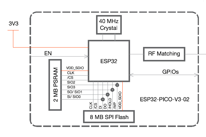

    Does the low state of the EN pin internally disable the power supply to the RTC module in the EPS32 ?

    Is it possible to somehow preserve the time between resets triggered by the low state of the EN pin ?

    On the device I have a hardware watchdog connected to the EN pin. If for some reason it triggers then I lose the timing information completely. I wonder if I should go along with this. Frequent NVS memory writes are unlikely to be a good solution

    One more solution came to my mind but probably too risky.
    I am using an ESP32-V3-02 with an internal PSRAM. The memory is powered from the ESP pin. It is, admittedly, labelled "Output power supply". However, I think this is a regular IO pin. It is externally accessible. So potentially VDD could be connected to it. In this situation, a low state on EN will not disable the PSRAM power supply and the data in memory will remain
  • #8 20083929
✨ When the EN (CHIP_PU) pin of the ESP32 is set to a low state, it disables the internal low voltage regulator that powers the RTC module, resulting in a loss of timekeeping. To preserve time between resets, users can store data in flash memory (NVS), although frequent writes may not be ideal due to limited write cycles (100,000 to 1 million). Some users consider alternative solutions, such as connecting external power to the PSRAM, but this risks disabling sleep functions and may not maintain data integrity during power loss.
