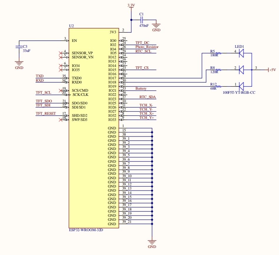

    Could someone take a look and see what needs to be corrected to make it work?
    I know the rtc 21, 22. battery and tft touch pins for analog input.
    Greetings and thanks in advance

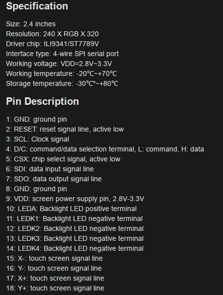

    Among other things, you have not specified which display you intend to use.

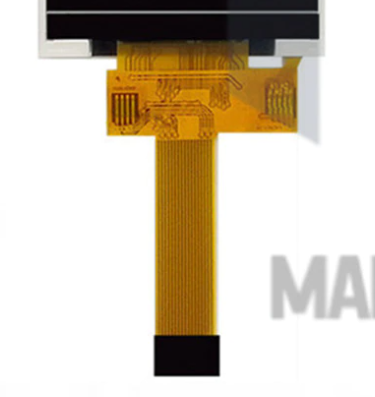

    The ILI9341 is a controller for displays and not the display itself. There are dozens of different displays using this driver.

    If we know the leads of the display, I don't understand what the problem is
    author of the topic.:?:

    I am just not sure. And the project is important to me. Could you check if this type of connection would be correct:
    Tft scl -> sck
    Tft sdo -> sdo
    Tft ssi -> sdi
    Tft reset -> not connected
    Tft dc -> gpio 2
    Tdt cs -> gpio 15
    Rtc sda -> gpio 21
    Rtc scl -> gpio 22
    Photoresistor -> gpio 4
    Battery -> gpio 32
    X -> gpio 25
    X- -> gpio 26
    Y -> gpio 27
    Y- -> gpio 33
    En -> capacitor AND to resistor 10k
    Diode -> gpio 17,18,19 (diode at 5V is there, won't this burn esp32?)
    I am not an electronics engineer. The board is being designed by someone else who has a problem checking the pins. I would be very grateful if someone could give advice to check this quickly.

    Where did you get the diagram from post no.1 ?
  • #19 20088428
    domus12
    Level 4  
    Posts: 33
    This is what the wise ones designed (the contractor). But it seems wrong to me, I prefer to make sure.

    khoam wrote:
    domus12 wrote:
    the diode at 5V is there, won't that burn up the esp32?
    With series resistors on the order of 100Ω this is quite likely. I don't understand why these diodes are powered from 5V, with such a high current.
    Well here's the problem. How do I calculate it so that the resistors are selected so that the same power at 3.3V ?

    5V is not the problem, just the resistors incorrectly selected.

    inot wrote:
    5V is not the problem, just the resistors incorrectly sized.
    This is how it was tested on the nano with no problems it worked. And this is also the light output of the diode needed. It can only be stronger, weaker certainly not.
    Added after 46 [seconds]: .
    khoam wrote:
    I would not make this type of statement. The pins on the ESP32 are not 5V tolerant contrary to the rumours spread by various jutubers.
    and with these pins what I have given the rest is correct?

    khoam wrote:
    I would not make such statements. The pins on the ESP32 are not 5V
    5V even advisable,because the blue and green LEDs would not light up.
    5V is not an issue (unless you short-circuit the diodes), as the voltage drop on the red diode is 2.2V, on the green and blue 3.2V.
    I have not found specific data for this diode, but it is probably a 20 mA LED and therefore these resistors do not fit (23-28 mA current).
    Tft reset -> Pin 17 as on the schematic.
    Battery -> gpio 32 on the schematic GPIO 21
    Used for voltage measurement , but GPIO21 does not work as ADC.
    X+ -> gpio 25 in the schematic of gpio 32
    X- -> gpio 26
    Y+ -> gpio 27 on gpio 33 schematic
    Y- -> gpio 33 in gpio 27 schematic
    In the full schematic, the display backlight will not work either (Cathode and anode connected to each other):

    These are the parameters I found for the diode:
    2V-2.2V(R) 3V-3.2V (G/B) Volt 20 mA
    Added after 1 [minute]:
    inot wrote:
    5V is not even advisable, because the blue and green LEDs would not light up.
    5V is not an issue (unless you short-circuit the diodes), as the voltage drop on the red one is 2.2V, on the green and blue 3.2V.
    Battery -> gpio 32 as on the schematic GPIO 21
    Used for voltage measurement, but GPIO21 does not work as ADC.
    X -> gpio 25 in the schematic of gpio 32
    X- -> gpio 26
    Y -> gpio 27 on gpio 33 schematic
    I'll get an editable version of this schematic from them and send it to you. It is a drama that things like this come out at this stage.

    khoam wrote:
    RGB diodes of slightly higher power are not controlled directly from the ESP outputs. MOSFET transistors are used for this. Admittedly, the maximum load capacity of a single GPIO in the ESP32 is 40 mA, but that's no reason to make a heater out of the ESP.
    Correct, but unfortunately this is how the circuit was designed.

    I sent you a message with the schematic for Altium. If you could please correct it so that I can upload the code.
    Added after 5 [hours] 25 [minutes]: .
    I just checked this diode on ESP32 Wroom DA with 5V on the diode from the Nano and nothing heats up. So it's giving the advice.
