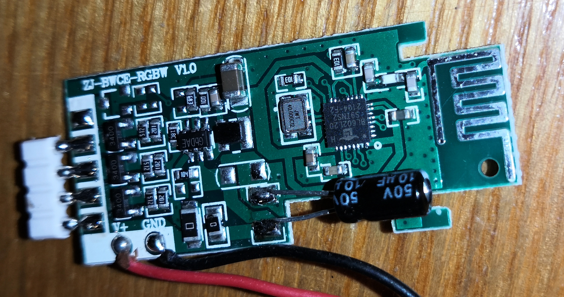

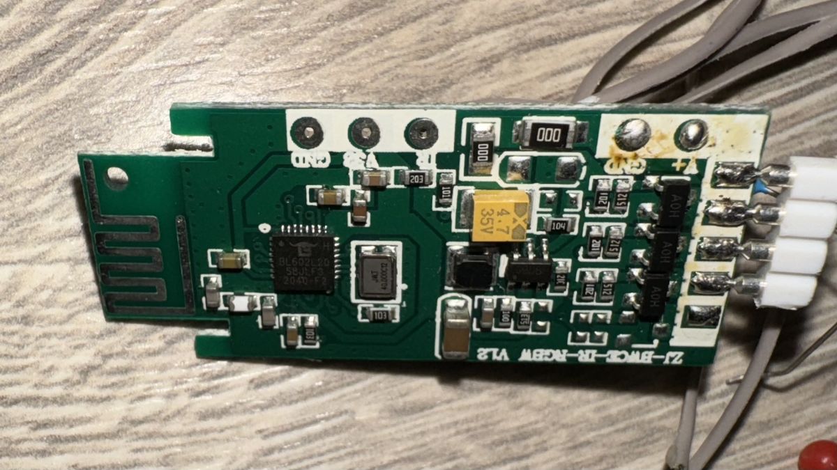

    printed circuit board
    [BL602L20] LED RGB Strip (Magic Home) [BL602L20] LED RGB Strip (Magic Home)

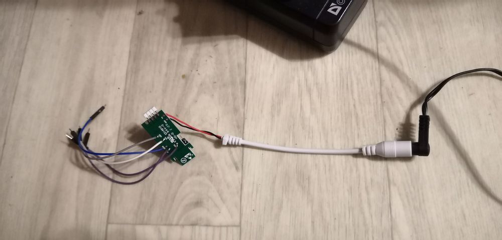

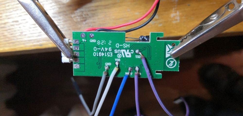

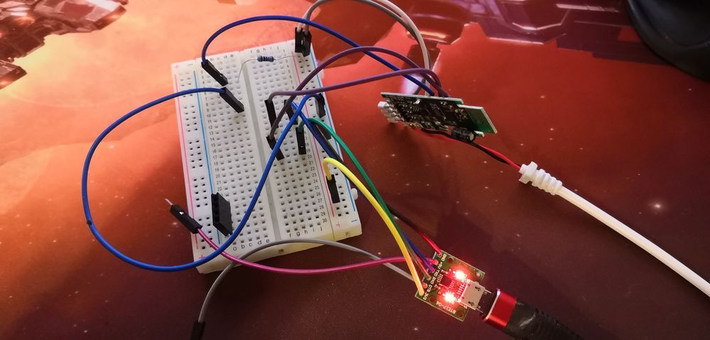

    Preparation. Soldering
    connect to TTL. Additional power is not required, we take with TTL 3.3 volts.
    buy TTL on Aliexpress

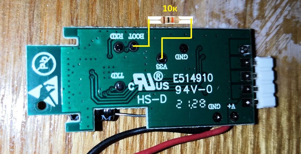

    To enter the BL602 into programming mode, it is necessary to connect the boot output through a 10k resistor to the positive before power is applied. After the firmware, the jumper must be removed.

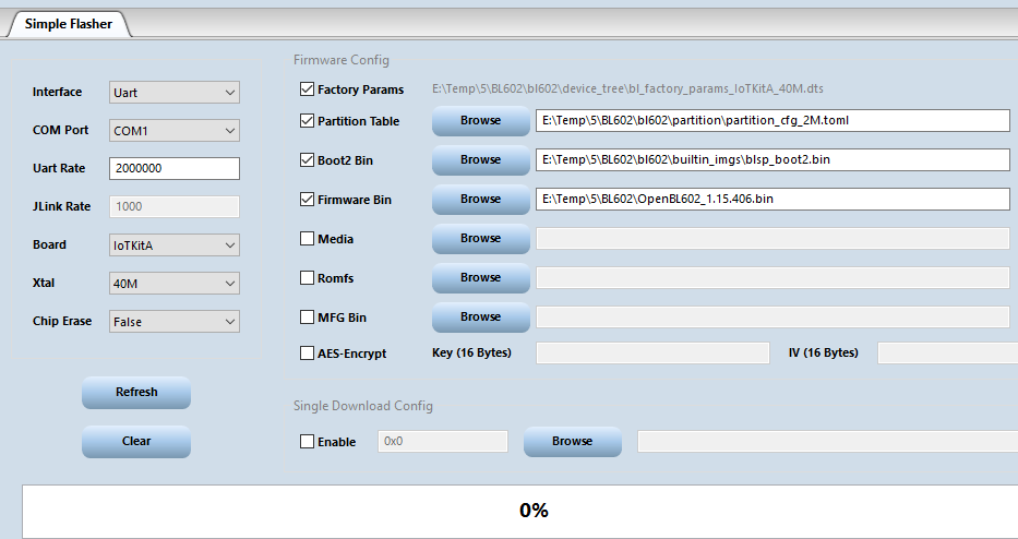

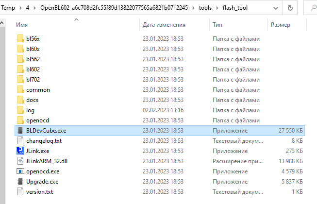

    Download the full project (800+ megabytes) and unpack.
    I reduced the archive by removing everything that is not needed within the framework of this article and added the OpenBL602_1.15.406.bin firmware.
    Smoll package. The total volume of the archive turned out to be 33MB. BL602.zip
    Connect TTL to your computer before running the utility. The firmware utility does not know how to update the state of the ports. Tested on two different computers under win10.
    Launching the firmware utility
    Click "Create and Download" while waiting for the download to complete.

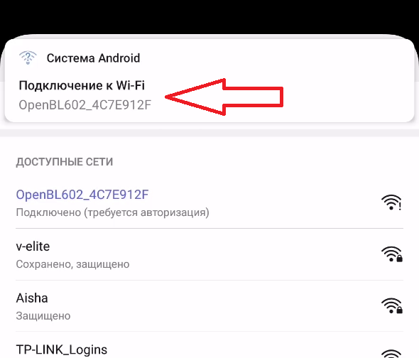

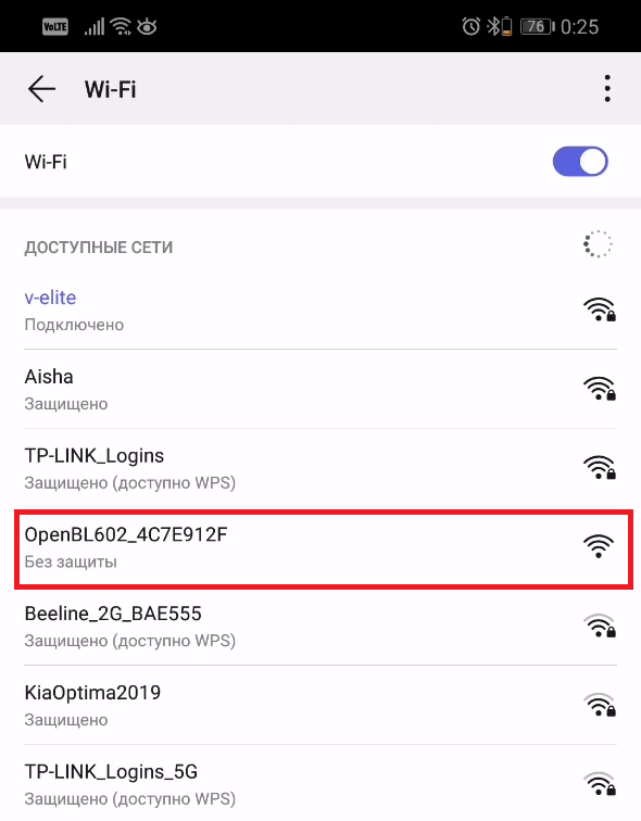

    Open any device and see available Wi-Fi networks. There should be a network starting with OpenBL602_
    We connect to the network. If you do this from an android, a message will pop up at the top, clicking on which will automatically open the address http://192.168.4.1 for initial setup. In any other case, we open ourselves.

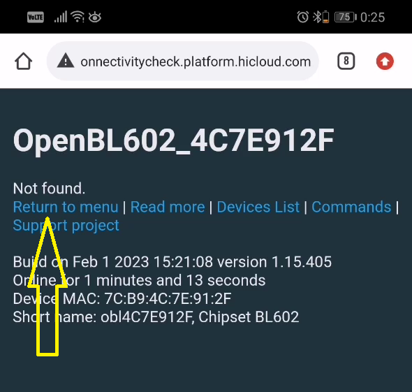

    This is the first window that popped up for me. Click on "Return to menu"

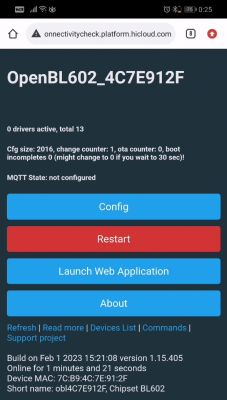

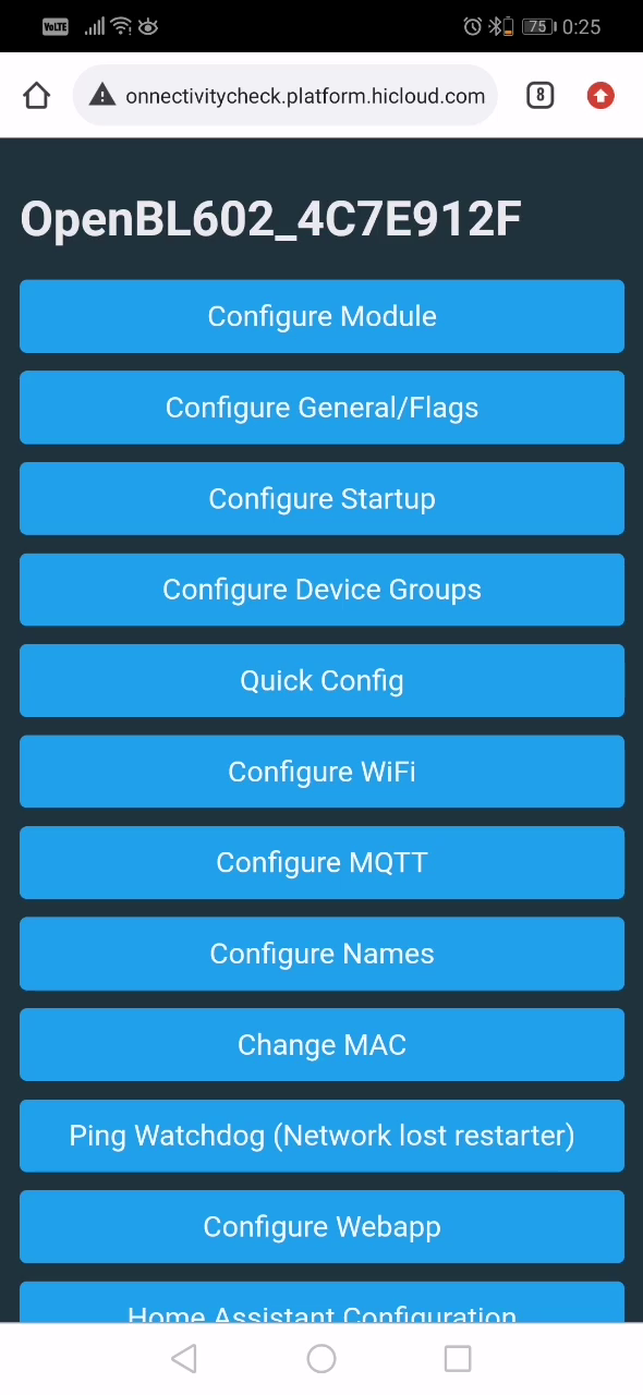

    Main menu. Click "Config", then "Configure WiFi"

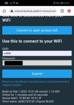

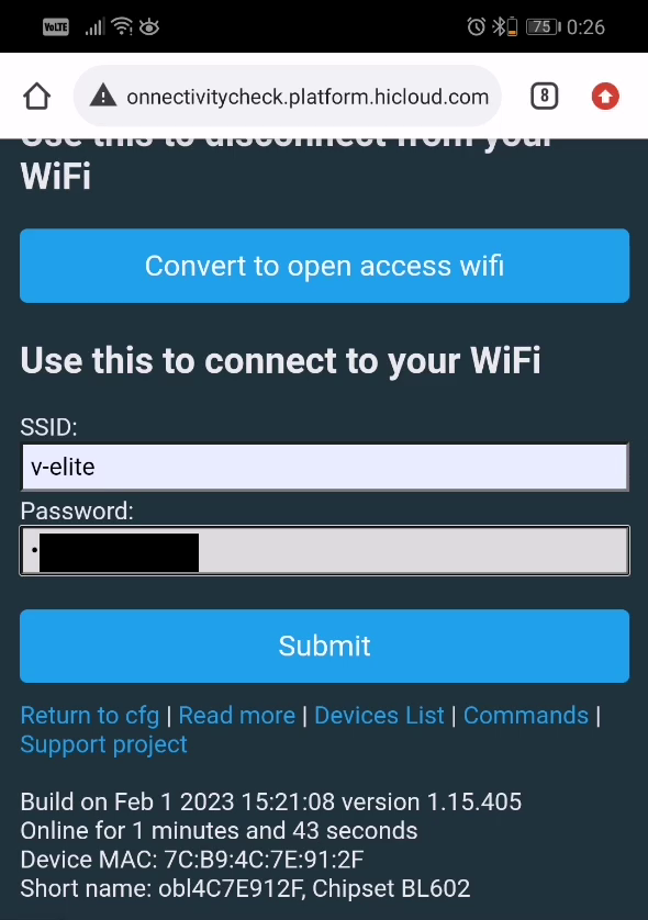

    Setting up your home network (WiFi)
    Reboot. I have "lost". I had to turn the power off/on.

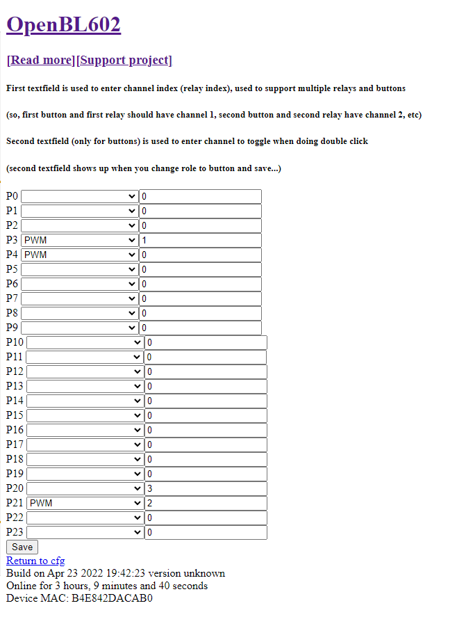

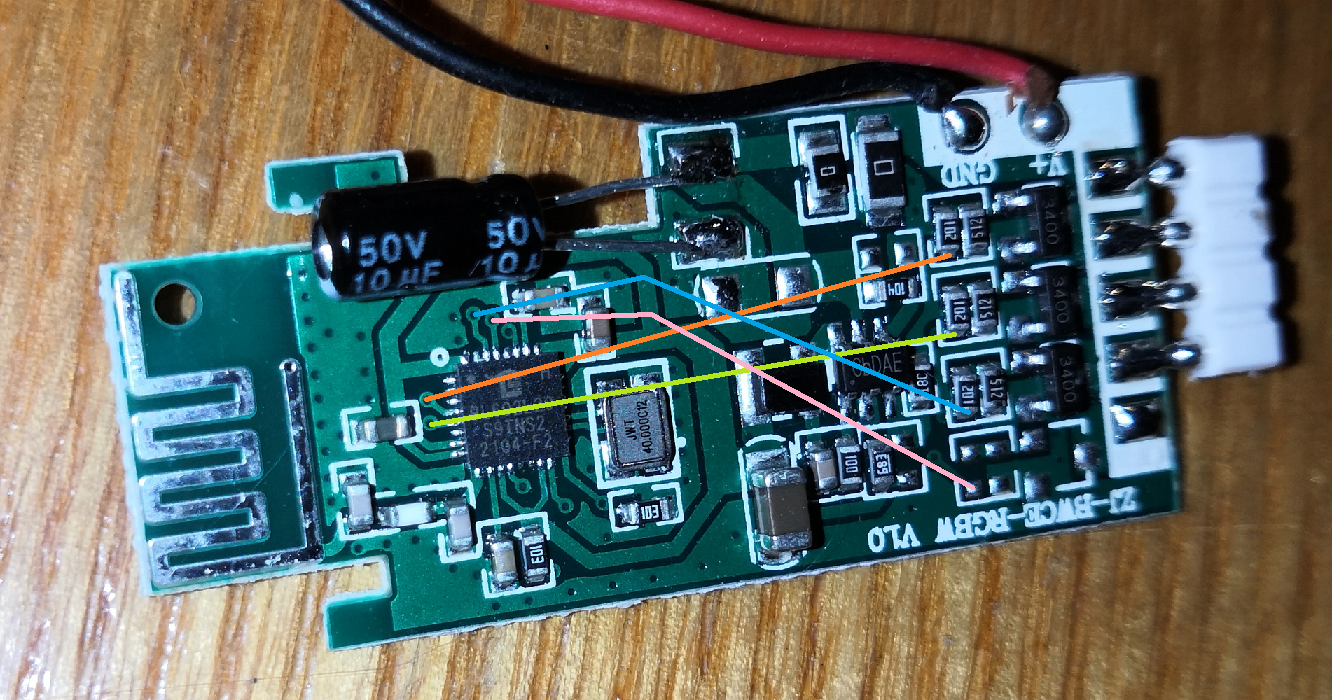

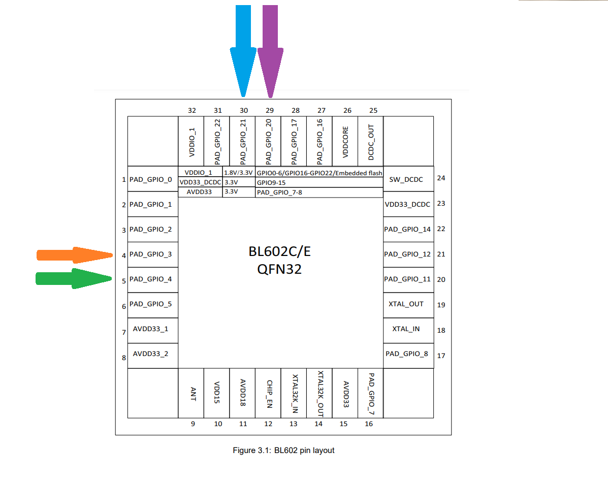

    Set up shim ports. The description was taken from the developer's project, p.kaczmarek2. The device differs only in the presence of an IR port, which I do not have.

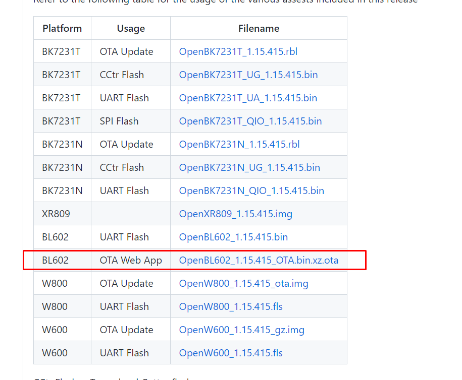

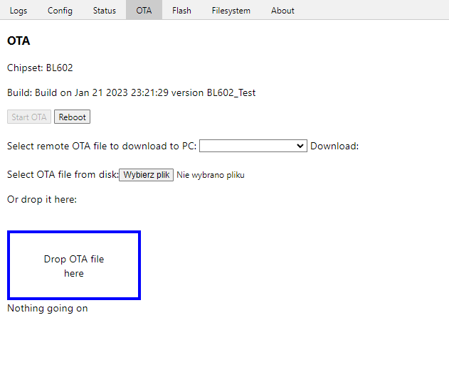

    It is also worth to note that you can do OTA here:
    Screenshot of the OTA interface for chipset BL602 with update options.
    OTA file is now released here:
    https://github.com/openshwprojects/OpenBK7231T_App/releases/
    So you can remotely update the device.

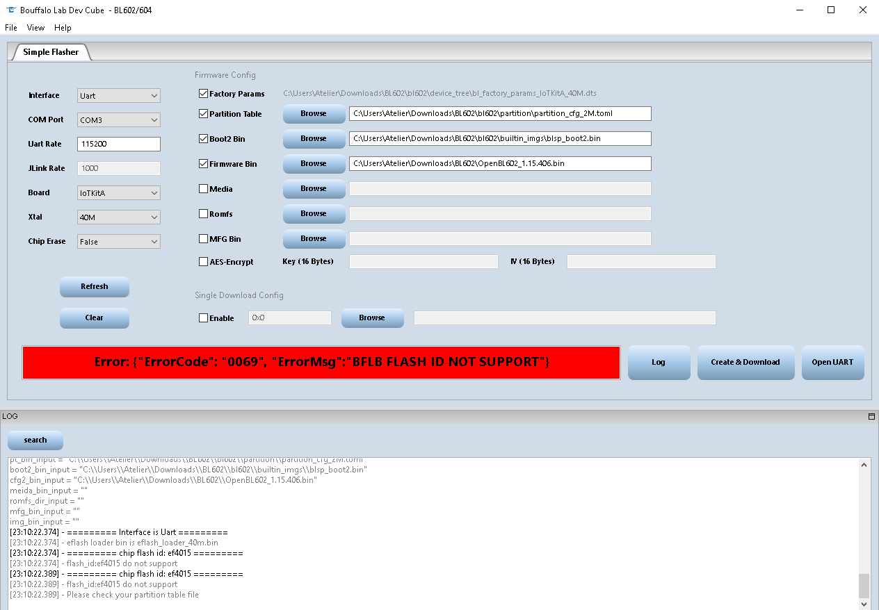

    Hey,
    Thanks for the work !

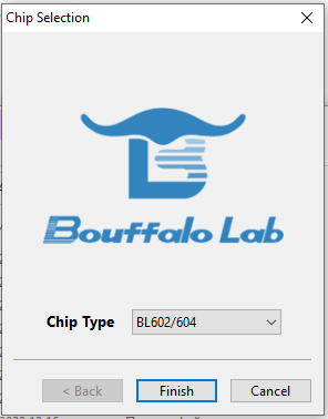

    On my side I try to flash my RGB controller following your instructions, but I have an error when I try to flash the chip (button "Create & Download"). My wiring are good and I also have the 10kOmh between boot and 3v3 pin.
    Screenshot of the Bouffalo Lab Dev Cube application showing a chip flashing error.
    Any ideas ? :)
  • #4 20963757
    Posts: 14751
    Rate: 12867
    "BFLB FLASH ID NOT SUPPORT" ? What kind of chip do you have? How does it look like?

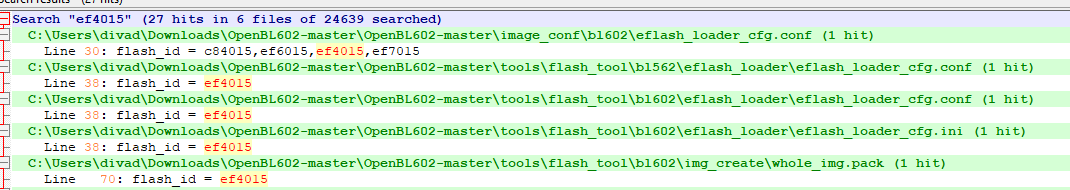

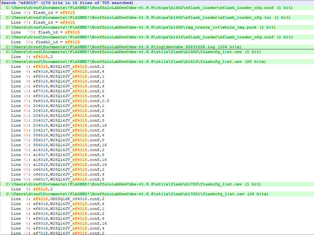

    Posts: 5205
    Help: 446
    Rate: 914
    there are more references to ef4015 in BLDevCube 1.8.8 than there are in the old 1.4.8. so maybe supported in newer. or config files from newer can be used in 1.4.8?
    Search results of references to ef4015 in various files in BLDevCube v1.8.8.
    vs
    Screenshot of search results showing configuration files with references to ef4015.
  • #6 20963900
    bmarchais
    Posts: 7
    >>20963757
    It’s the BL602
    Printed circuit board with a BL602 chip.
    Added after 47 [seconds]:
    >>20963862
    Do you have the sourcefile for the new version 1.8 ?
  • #7 20963903
    Posts: 14751
    Rate: 12867
    Strange, they have changed internal flash memory but left marking the same. Try the new tool as @divadiow said

    Using the last version (1.8.9) it works fine for uploading the image. However, I'm stuck at the connection step to my router. I try several times and by parsing the serial log, the chip reports me error on association :

    I tested using a different router and it's works. So I try again with my main router (capable of wifi 6), and still nothing. I changed the security protocol in my IoT network from WPA3+WPA2-PSK to WPA2-PSK+WPA-PSK and it finally works ! I believe it's using the WPA security and not the more recent one.
    Thanks for all your answers. Really appreciate this open source firmware in order to maintain close IoT device and to not depend on cloud services :)
    Update: I have to update to the latest version (1.17.492) in order to make the connection between this device and homeassistant works

  2. Pull BOOT high with 10 kΩ, power board, then click “Create & Download” in BLDevCube.
  3. After success, remove BOOT jumper, restore normal 5 V power, and connect to the emitted SSID OpenBL602_… [Elektroda, Svetlaya, post #20426337]
What GPIOs drive the RGB outputs?
Default mapping in OpenBL602: GPIO7 → Red, GPIO8 → Green, GPIO9 → Blue. Adjust under Web UI → Config → Pins if your PCB differs [Elektroda, Svetlaya, post #20426337]
