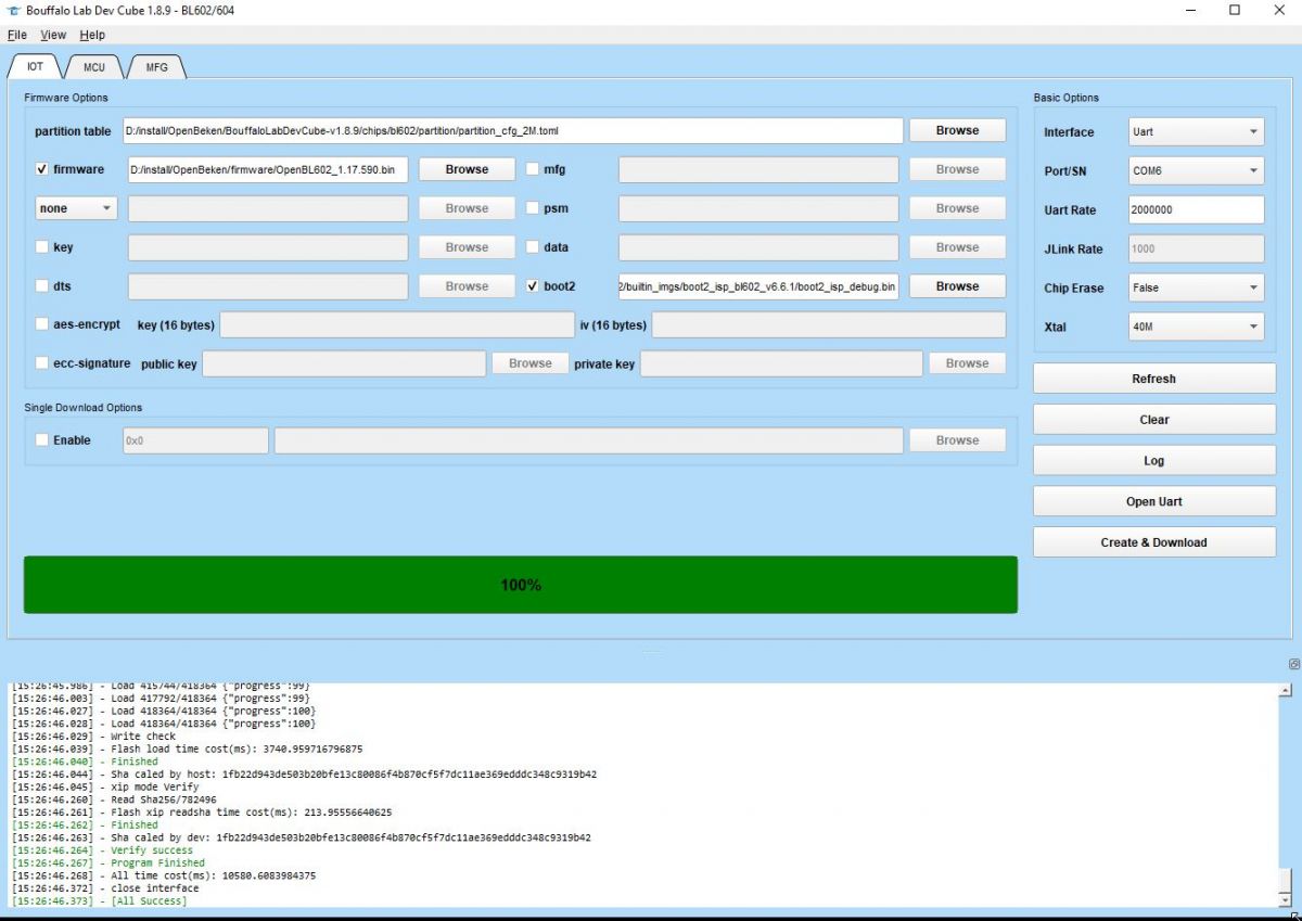

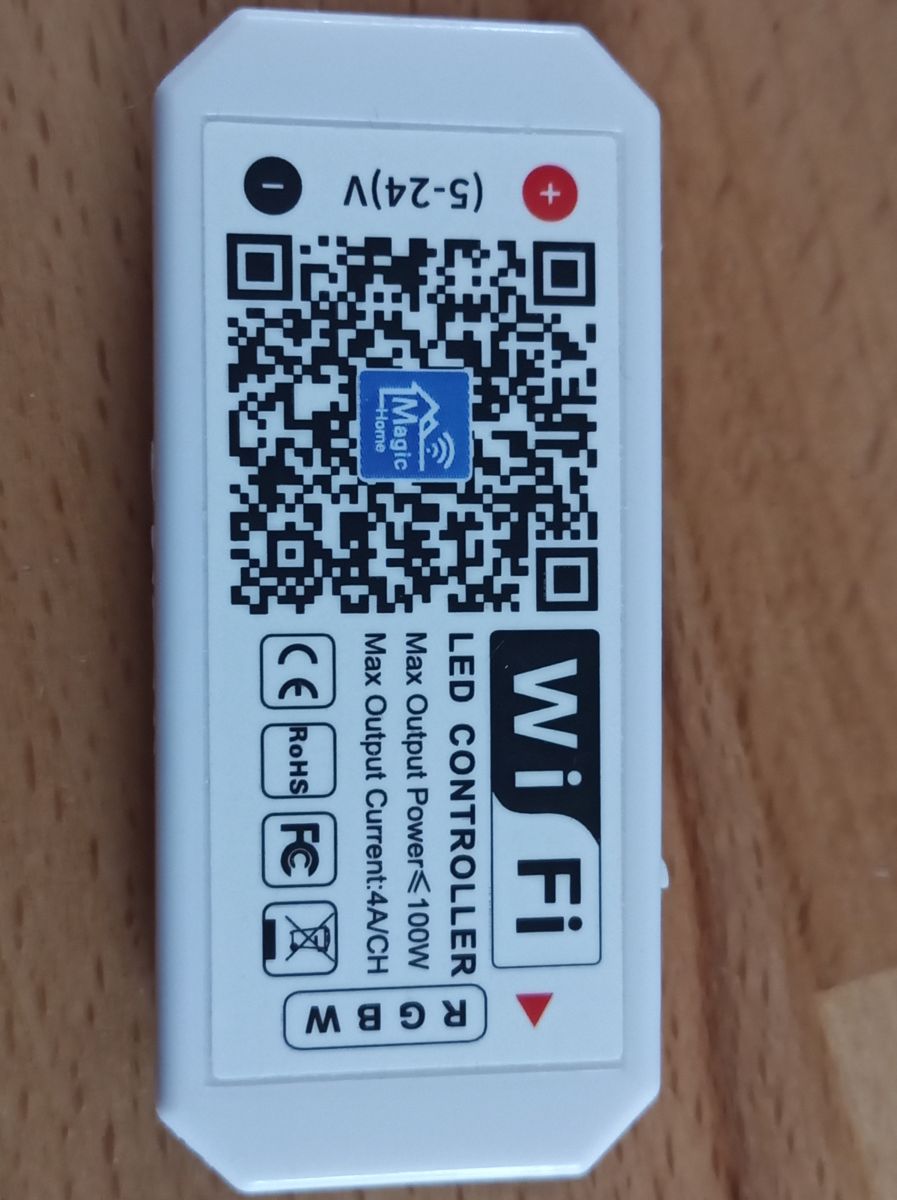

    Hi everyone,
    first of all I want to thank all for their work to provide clould-free homeautomation!
    Yesterday I got aware that there is this solution similar to Tasmota for i.e. BL602 devices.

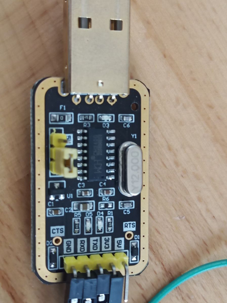

    I was able to
    - solder PADs of Bl602L2 RGBW strip device
    - successfully flash OpenBl602 to it (golden USB TTL providing 3.3V) using BlDevCube 1.8.9, 10k between 3.3V and Boot
    - receive serial log in Putty
    - connect to device's Access Point via Smartphone and Laptop
    But I did not manage to connect the device to my OpenWrt (Fritzbox 3390), WPA/WPA2 security.
    It seemed that my SSID/password and IP values were not stored into the memory of the device and after reboot again AP came up with original configuration entries (DHCP, no SSID, ...).
    Finally I decided to erase the chip and flash it again => probably a big mistake.
    I figured out that I need to flash boot2 again.
    - PartitionTable=BouffaloLabDevCube-v1.8.9/chips/bl602/partition/partition_cfg_2M.toml
    - Firmware=OpenBL602_1.17.590.bin
    - boot2=BouffaloLabDevCube-v1.8.9/chips/bl602/builtin_imgs/boot2_isp_bl602_v6.6.1/boot2_isp_debug.bin
    Since then I again get serial logs and the device creates a AccessPoint.
    BUT: I cannot connect anymore.
    Laptop does not even show this AP.
    Smartphone shows it (Channel 1) but cannot connect.
    Obviously I erased too much and have no clue how to get it working again.
    Thanks a lot for any help!
    P.S.:
    Just noticed that AP name has changed after the Erase. Don't know whether this is important to know.
    perviously: OpenBL602_943F9A4D
    now: OpenBL602_43C90001
    Greetings
     Eva

    #2 21090900
    miegapele
    Posts: 173
    Help: 15
    Rate: 29
    You need to specify dts file, that will make correct mac appear. And you probably need to power it from some regulator capable of more current, that chip can't provide that. That is likely why you can't connect

    Posts: 16
    I flashed DTS file "BouffaloLabDevCube-v1.8.9/chips/bl602/device_tree/bl_factory_params_IoTKitA_40M.dts".
    According to this URL
    https://nuttx.apache.org/docs/10.2.0/platforms/risc-v/bl602/index.html
    the 40M is the default dts file for BL602.
    Access Point is visible again for Laptop. I'm able to connect and see OpenBL602 menus.
    Thanks a lot for the help. Back in the game :-)

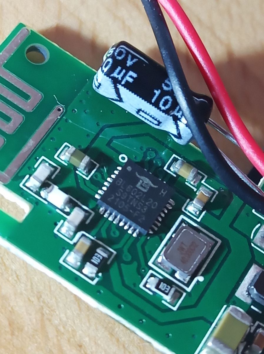

    Hinzugefügt nach 6 [Stunden] 4 [Minuten]:
    Hi,
    so far everything looked fine.
    I can configure the device and tested with a RGB Strip.
    BUT I noticed that the BL602 chip gets really hot (>100°C) in seconds... even if I completely disconnect the strip and even when powered by TTL stick via 3.3V
    Even when started in flashing mode (with 10k resistor between BOOT and 3.3V).
    So I did several power on/off to eliminate potential configuration issues and tried to flash with some variations of DTS and boot2 images.
    No success...
    Is it normal that BL602 chip gets that hot? Any sugestions how to solve it?
    Did I kill the device somehow?
    Thanks for your insights
     Eva

    Is it real measurement or it's just temperature device reports? Device report is probably unreliable.
  • Possible overclocking from wrong XTAL setting
    #5 21092206
    evaluation
    Posts: 16
    the BL602 chip is really hot, it's not only the value in the WebUI.
    But of course measuring temperature by hand is subjective. So far I was not able to measure it correctly. My Laser thermometer shows silly values and my Tasmota DS18B20 is too slow. I cannot press them together until the DS shows ~50°C continuously increasing slowly.
    BTW also the TTL is getting hot when I power the BL602 over it.
    I'm quite sure that this was different before my erasing/reflashing...
    Could it be that I'm overclocking the BL602 because I flashed wrongly?
    There is a XTAL value in the flashing tool: 40
    Near BL602 there is JWT 40.000C12 chip. Don't know what XTAL means but this seems to fit.
    But to be honest I don't have a clue what I'm doing because all those abbreviations (XTAL, msg, psm, ...) are unknown to me.

    This suggests powersave may not be working as expected. Using the newer SDK looks to solve this problem, and probably a few other issues, but such an update sounds like a lot of work.
    https://github.com/openshwprojects/OpenBK7231T_App/issues/1157
    Added after 4 [minutes]:
    40m xtal is default for BL602

    I never measured my BL602 devices, but 100°C looks too much. Mine show internal temperature of 55-60°C, another in open air shows 40°C. BL602 SDK has provision for calibration, so this could be calibrated and correct. But with Chinese stuff, you can never know.
    Regardless, I don't think wrong flashing could cause anything like this. Usually if you flash something wrong, the device just doesn't work.
    Original firmware might have had some power-saving provisions, which do not work at all with this firmware.
  • OpenBL602 powersave commands do not lower chip temperature
    #9 21092642
    evaluation
    Posts: 16
    miegapele wrote:
    Original firmware might have had some power saving provisions, which does not work at all with this firmware.
    this might have been the case.
    Unfortunately I struggled a lot with Wifi after having flashed OpenBL602 to the device and did not focus on temperature.
    I noticed the high temp after having ERASED the device completely and reflashed it with BOOT, DTS, ...
    Don't know whether simple Firmware flash of OpenBL602 already had this temp issue or it rather was my silly ERASE...
    You mention "power saving feature".
    Just remember that I saw such a command in a device template I activated for the controller.
    I'm currently testing the device under a 8cm fan, still ~80-90°C. So far "powersave 1" or "powersave 0" has no effect.
    If this is really related to a not working powersave feature in current OpenBL602 firmware then I would assume that no one can really work with this firmware version, or?
