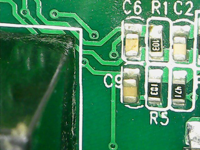

    Rate: 12954
    It's nice to see another BL602 device! It seems that supporting that platform was worth it.
    Thanks for the template, I will add it to our devices list.

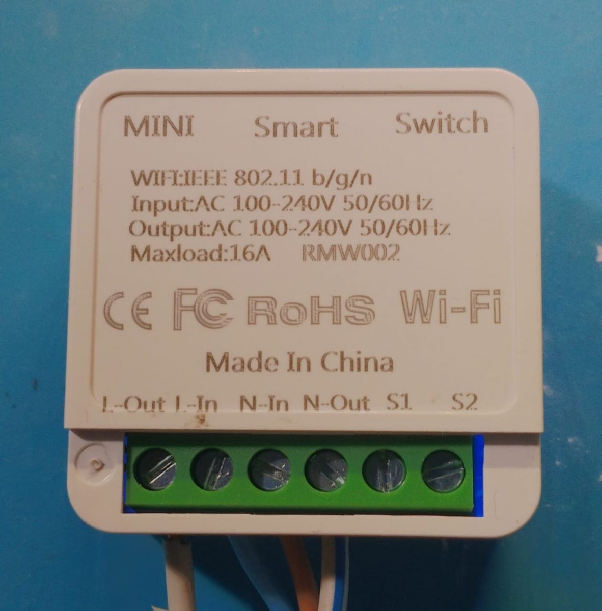

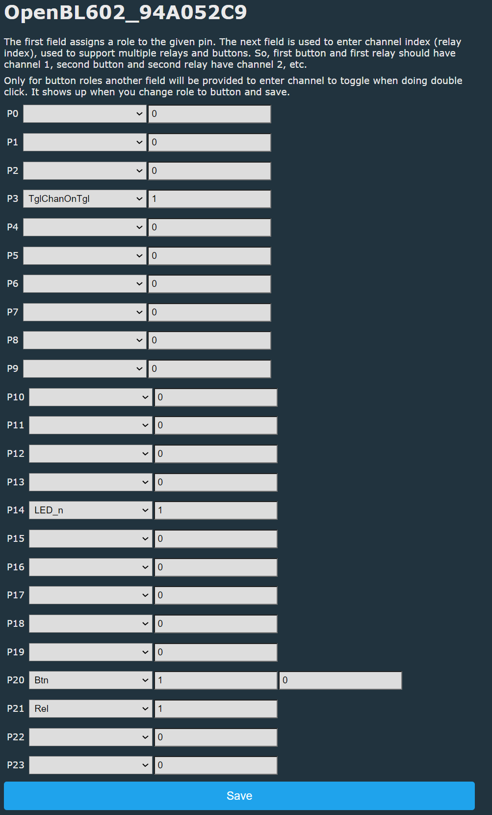

    Got the same device from Aliexpress. Did a reverse engineering of the traces. In my version of the RMW002 the config is similar but not identical to the config described above.
    GPIO_3 = TglChanOnTgl
    GPIO_20 = Button
    GPIO_14 = LED_n
    GPIO_21 = Relais
    With TglChanOnTgl also the external switch works (S1/S2).
    Screenshot of OpenBL602 device pin configuration.

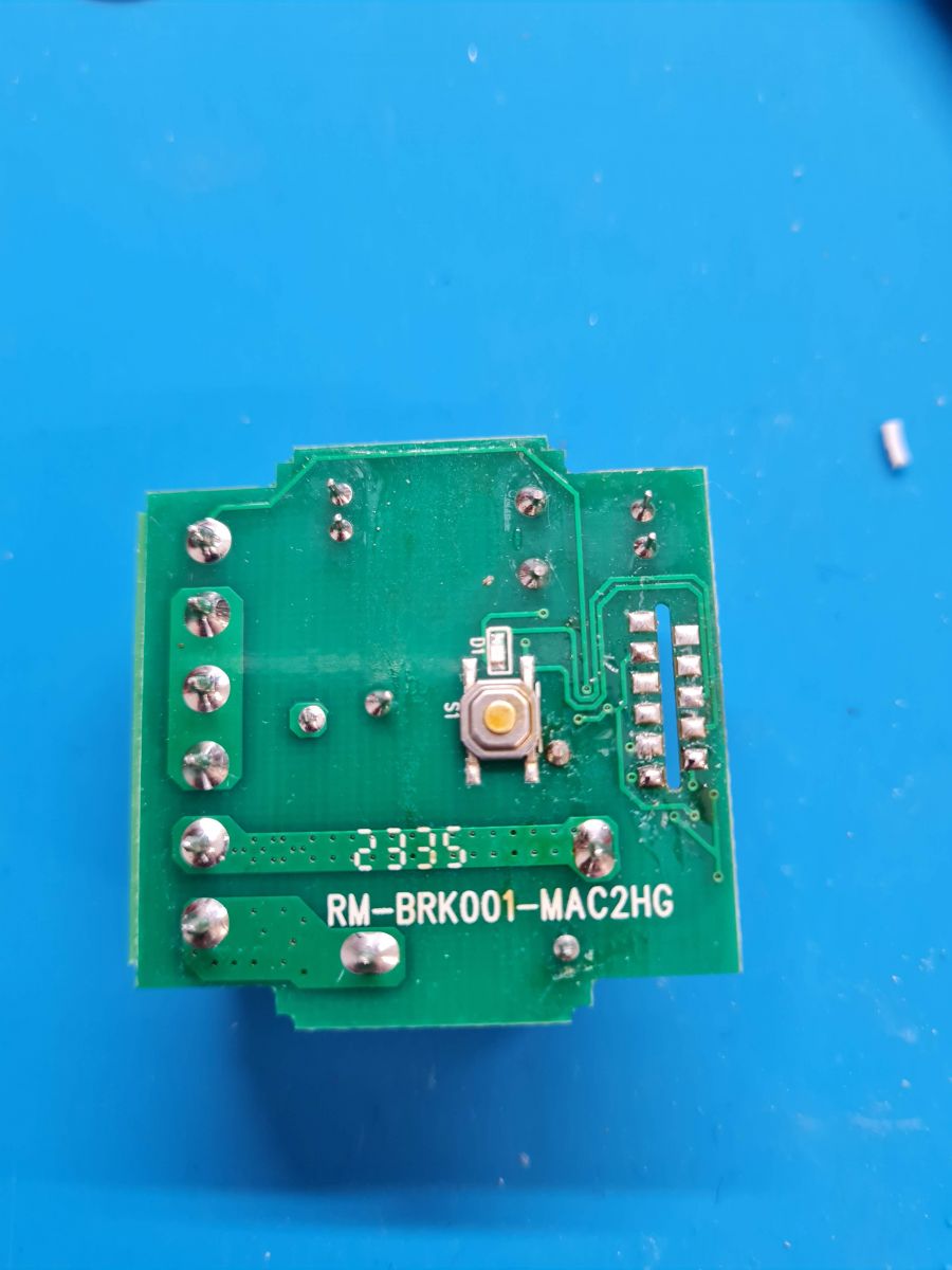

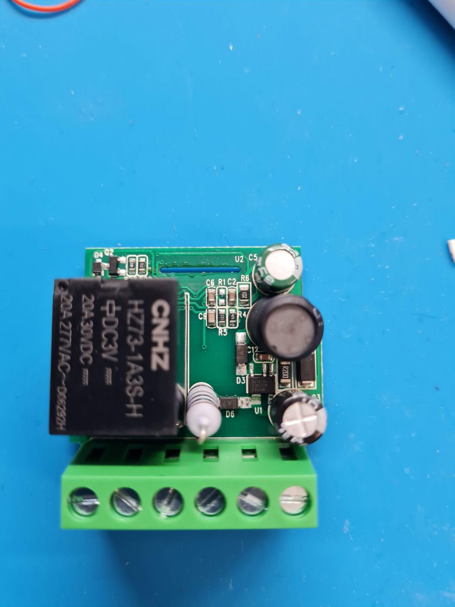

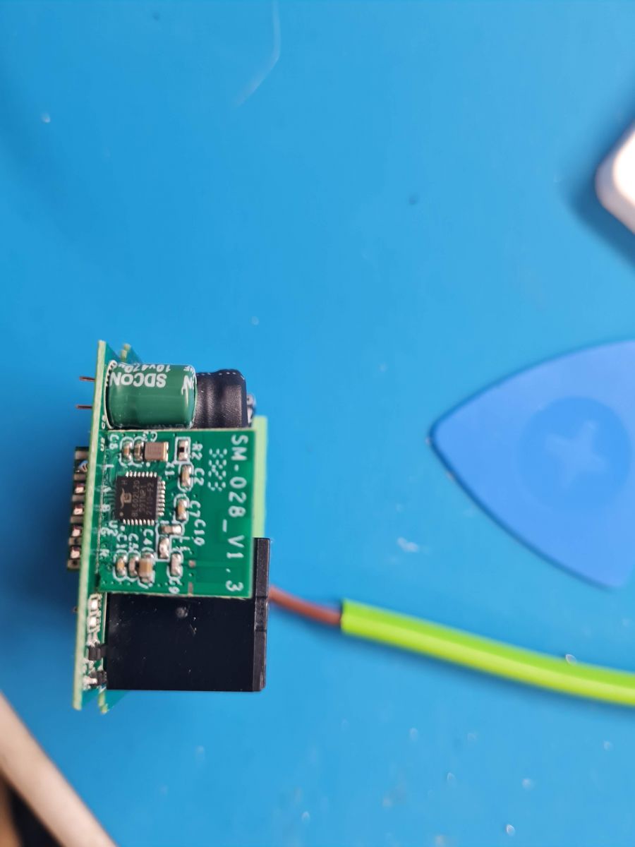

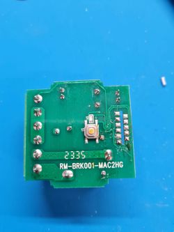

    Here are some photos from the internals. SM-28 Board removed for better visibility of traces.
    Electronic module with components on a blue background. Close-up of a circuit board labeled RM-BRK001-MAC2HG on a blue background. Close-up of a SM-28 V1.3 circuit board with visible traces and components on a blue background.

    Hello, can you post a GPIO template from the Web App?
  • RMW002 pinout and board definition for BL602
    #5 20795450
    stefan_73
    Sure, here you go.
      "vendor": "Noname",
      "bDetailed": "0",
      "name": "Mini Smart Switch",
      "model": "RMW002",
      "chip": "BL602",
      "board": "SM-028",
      "flags": "1024",
      "keywords": [
        "TODO",
        "TODO",
        "TODO"
      "pins": {
        "3": "TglChanOnTgl;1",
        "14": "LED_n;1",
        "20": "Btn;1",
        "21": "Rel;1"
      "command": "",
      "image": "https://obrazki.elektroda.pl/5649141700_1698005842.jpg",
      "wiki": "https://www.elektroda.com/rtvforum/viewtopic.php?p=20795450#20795450"
    • RWM002.zip (373 Bytes) You must be logged in to download this attachment.

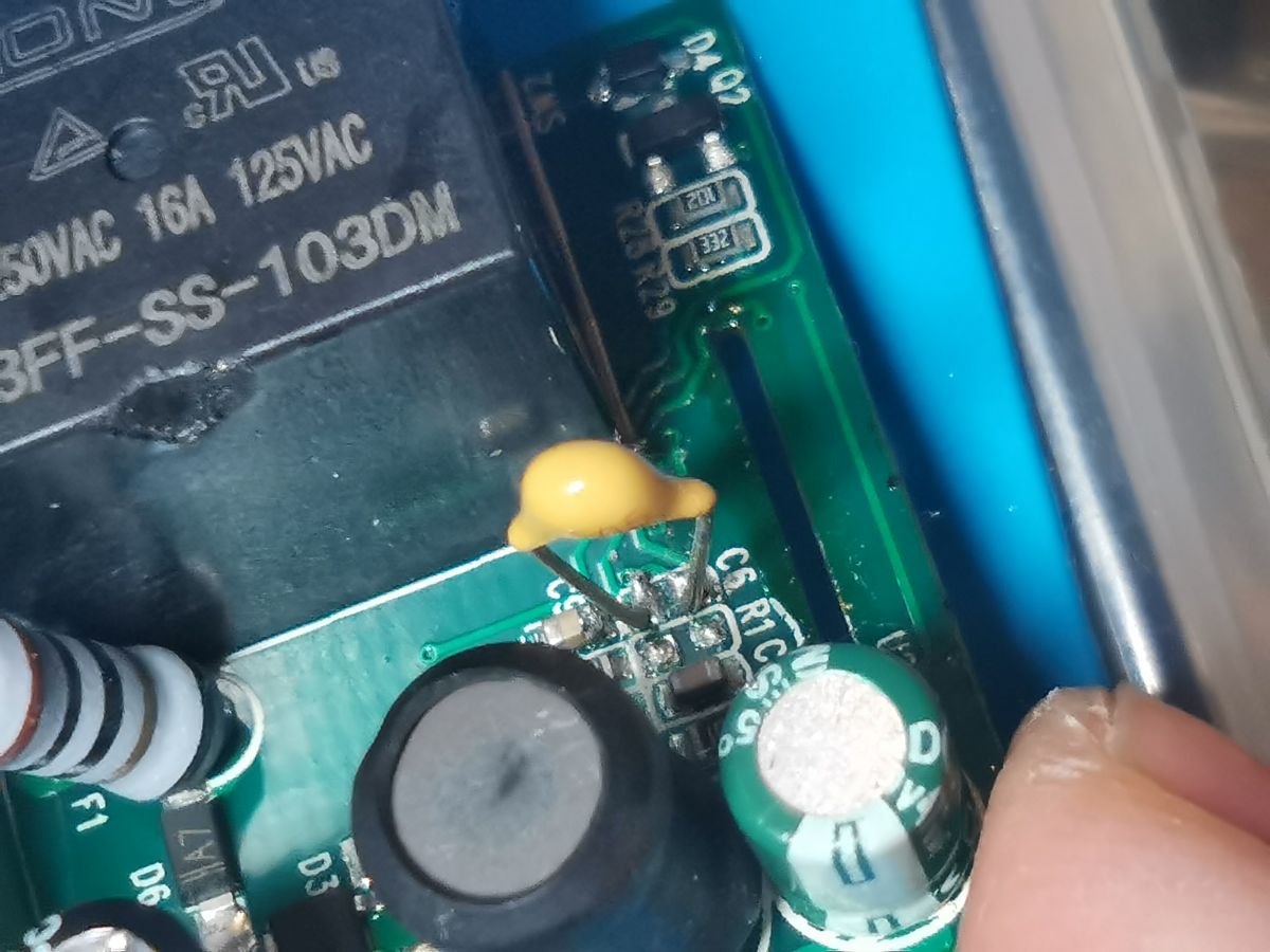

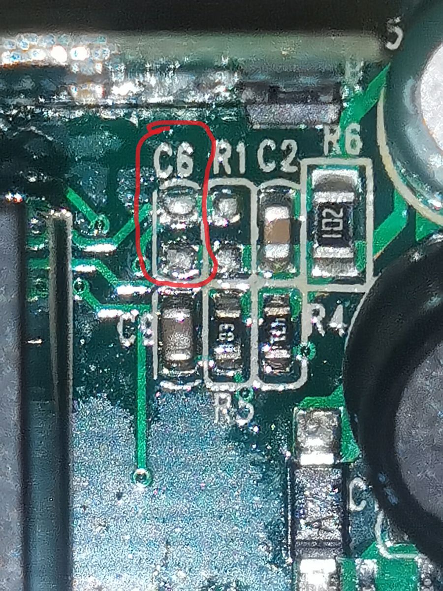

    hard3d
    Posts: 19
    Good afternoon! Is there any software protection against rattling?

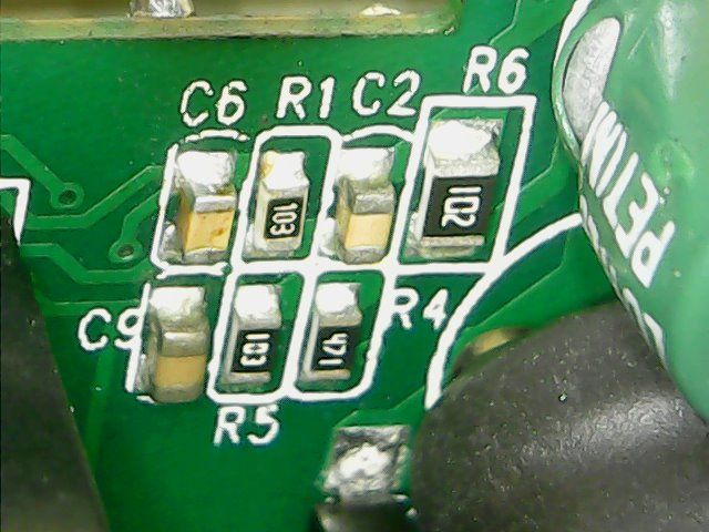

    I have 2 devices and one of them is missing a C6 capacitor. And when I activate the 3 pin, the relay starts clicking.
    Close-up of a circuit board with a missing capacitor C6. Close-up of a circuit board with a missing C6 capacitor marked.

    ildarnizamutdinov
    >>20806790
    I also had no C6 and there was a rattle of contacts when I turned on pin 3 in togle mode. Soldered C6 = 100nF and resistor R1 = 100k and the rattle disappeared

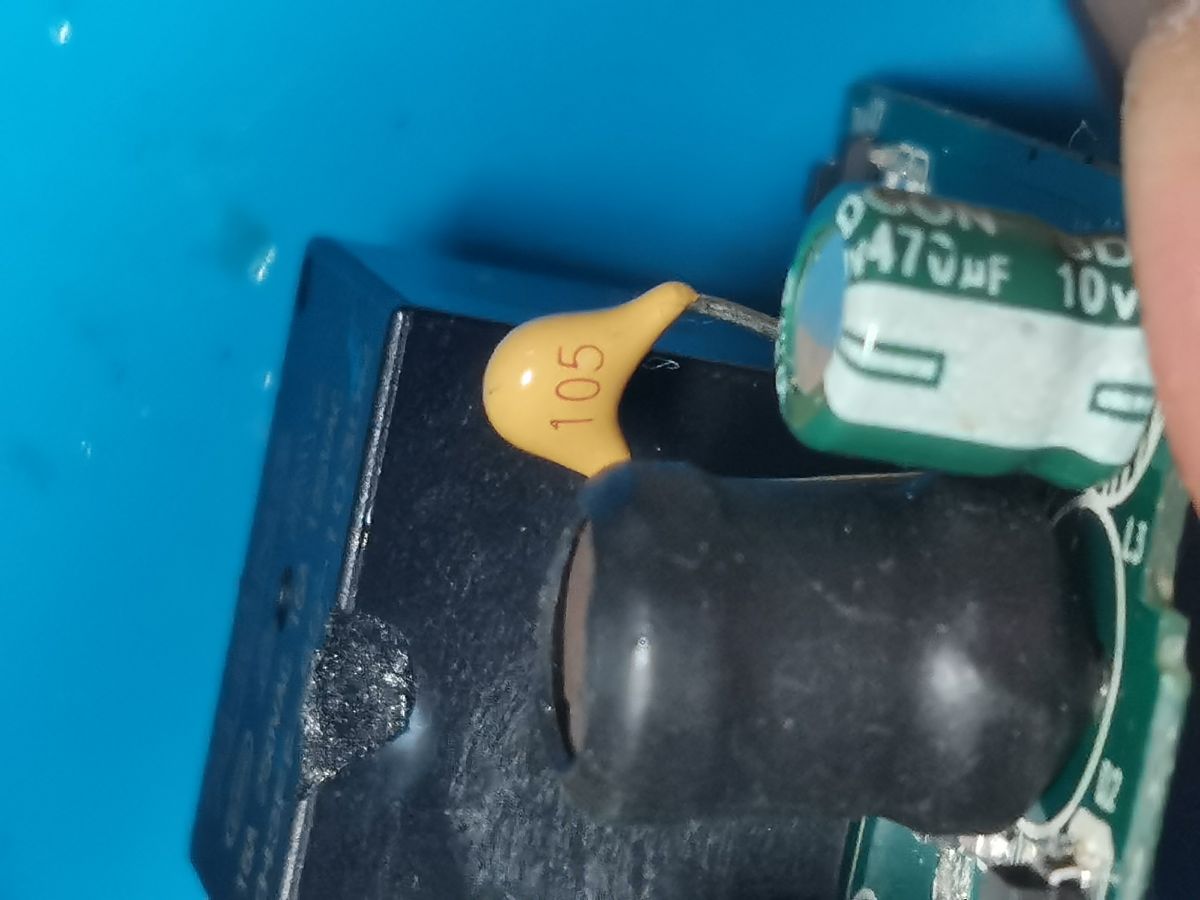

    hard3d
    Posts: 19
    I only soldered the capacitor. SMD was not available, soldered what was.
    Close-up of a circuit board with a soldered capacitor and components. Close-up of a circuit board with a manually soldered capacitor.
  • #15 20807303
    Posts: 14797
    Rate: 12954
    I'd personally shorten the leads of that capacitor before soldering, shortening leads reduces the noise

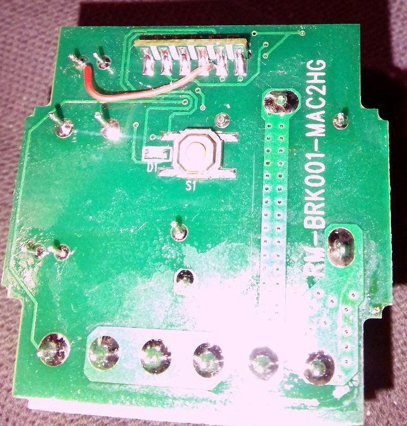

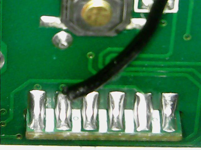

  • C5 to ground solder bridge causing phantom switching
    #26 20855410
    LuidgiVampa
    Разобрал rmw002 (bl602l20) С кондёра С5 на землю висит сопля.
    I disassembled the rmw002 (bl602l20) There is a wire hanging from the C5 to GND.
    Close-up of a printed circuit board with soldered wires.
    I tested this relay for a couple of days. What can I say. The device did not inspire confidence in me. A phantom switching on and off occurs every hour. It cannot be used in serious projects. May be I have a bad relay module.

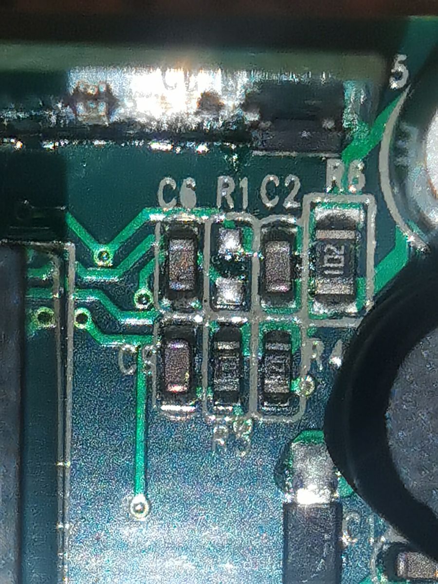

  • Add R1 10 kΩ and C6 0.1 mF to stop phantom switching
    #27 20859608
    LuidgiVampa
    Ложные срабатывания RWM002 решение проблемы (Solution - RWM002 phantom switching)
    To solve the problem, you need to solder the elements onto plates R1 and C6. R1- 10 kOhm, C6- 0.1 mF. After soldering these smd elements on the board, switching problems should stop.
    My revision.
    Circuit board with marked components R1, C6, R6, and others.
    Close-up of a circuit board with markings C6, R1, C2, and SMD components.
    P.S.
    I completely forgot to write! If your wire is red. Be sure to change it to a black wire. Otherwise the rocket won't fly! ))))))
    Close-up of a PCB with a soldered black wire.
