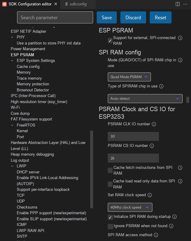

Why is it not possible to enter the SPI RAM config option? ESP32S3-R8, PSRAM support.

    I installed idf master and created a sample project for ESP32S3. As described by https://docs.espressif.com/projects/esp-idf/e...32s3/api-reference/kconfig.html#config-spiram
    the menuconfig option SPI RAM config appears. However, it is empty. I.e. it cannot be accessed. Have I installed something wrong ?
    Is it possible to enable SPI RAM support in idf4.4 for ESP32S3 ?

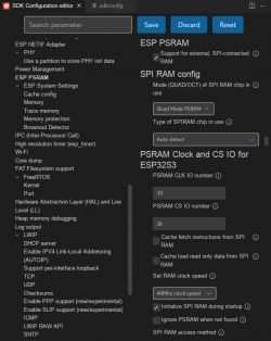

    In IDF4.4 in menuconfig I found the option I needed. It is called "Support for external, SPI-connected RAM".
