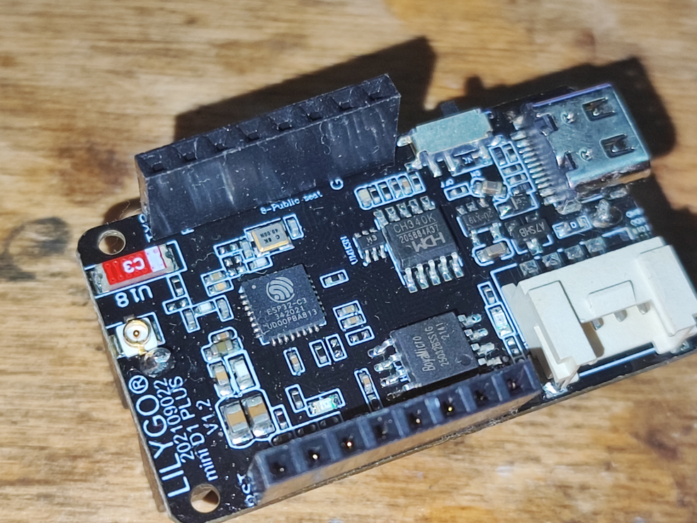

    So what kind of ESP32 modules do you guys have? I've found that one:
    LilyGO D1 Mini Plus module with ESP32-C3 chip on a wooden background
    Looks like ESP32-C3

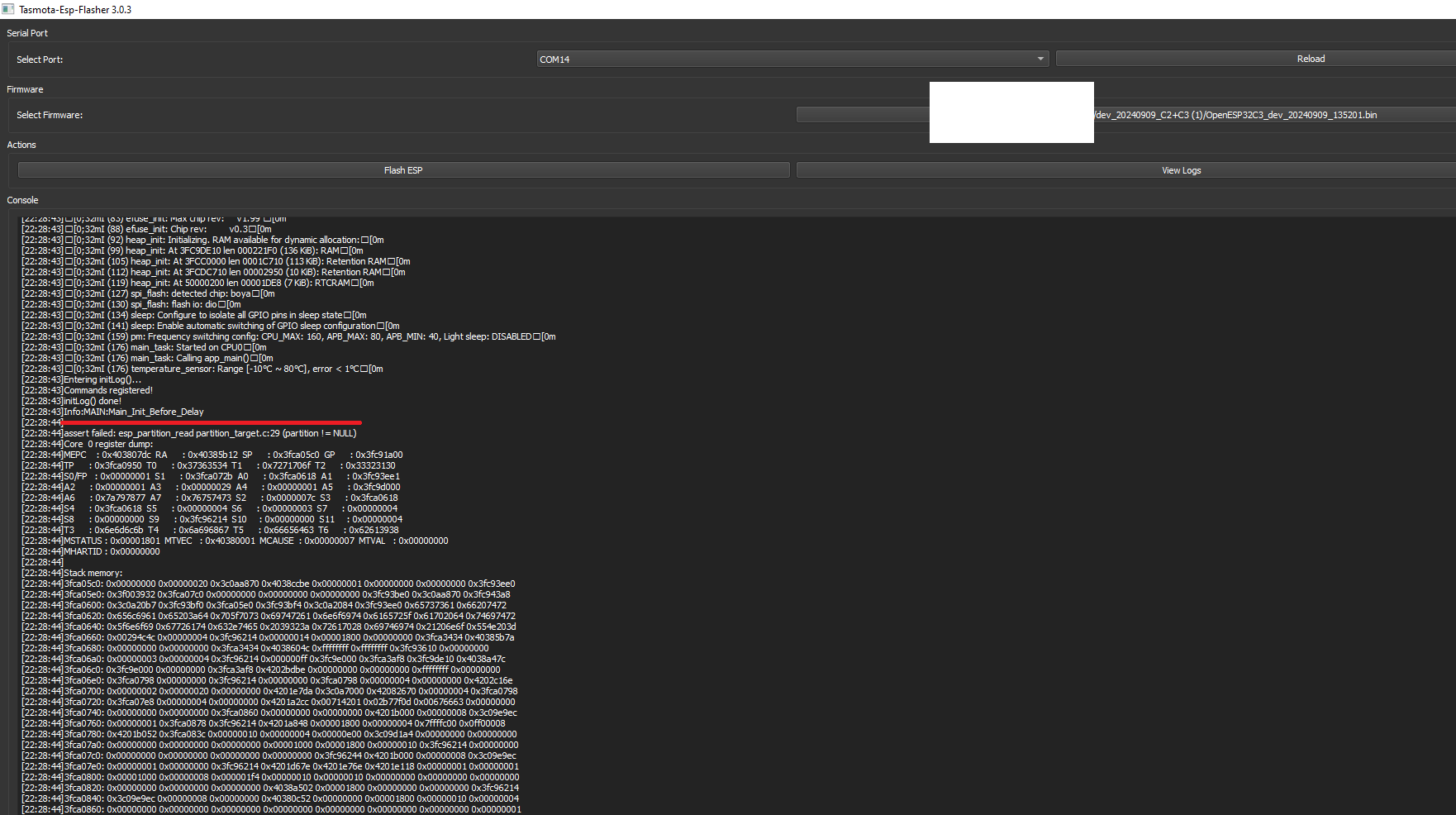

    Some early OBK printfs are there, but then it crashes:
    Screenshot of Tasmota ESP Flasher tool showing error information.
    • dev_20240909_C2 C3 (1).zip (1.75 MB) You must be logged in to download this attachment.

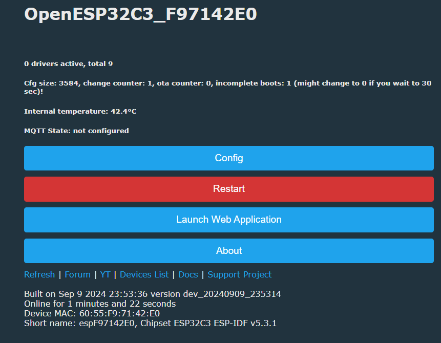

    I messed up the merge on c3 (bootloader must be at 0x0, instead of 0x1000), here is the fixed one
    • OpenESP32C3_dev_20240909_235314.factory.zip (484.81 KB) You must be logged in to download this attachment.
  • Request for missing features and online builds
    #20 21221040

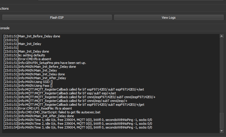

    Posts: 14763
    Rate: 12896

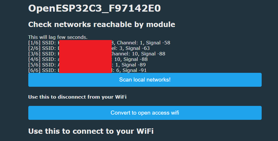

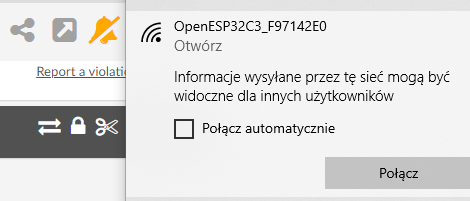

    Very promising, I'll check more:
    Console with log messages related to initialization and errors.
    Added after 29 [seconds]:
    Wi-Fi connection dialog for network OpenESP32C3_F97142E0 with an option to connect automatically.
    OpenESP32C3 application interface with Config, Restart, Launch Web Application, and About buttons.
    Congratulations, you did it! Now, which basic features are missing and how I can help? I personally consider online builds to be pretty high priority... I need to revise the PR code to know more, I will do it in the morning, as it's midnight here.

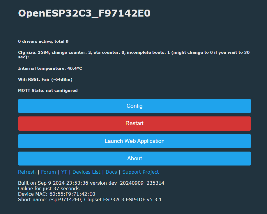

  • #22 21221048
    Posts: 14763
    Rate: 12896
    Even scan works:
    ESP32C3 module user interface showing a list of WiFi networks.
    Added after 3 [minutes]:
    it also connects to WiFi successfully:
    Screen of the OpenESP32C3 user interface displaying system information.

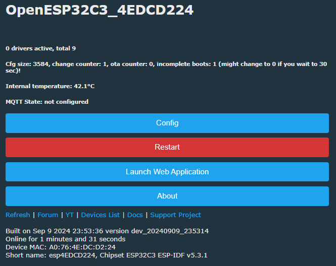

    Posts: 5215
    Help: 448
    Rate: 917
    divadiow wrote:
    unique to my device so I'll deal with that on its own
    burnt efuse with
    espefuse.exe --port com9 burn_efuse DIS_DOWNLOAD_MANUAL_ENCRYPT
    espefuse.exe --port com9 burn_efuse SPI_BOOT_CRYPT_CNT
    to make
    anyway. the import thing is
    OpenESP32C3_4EDCD224 web interface displaying configuration, restart, and launch web application buttons.
    Screenshot of the LittleFS file management panel with options to edit the /autoexec.bat file.

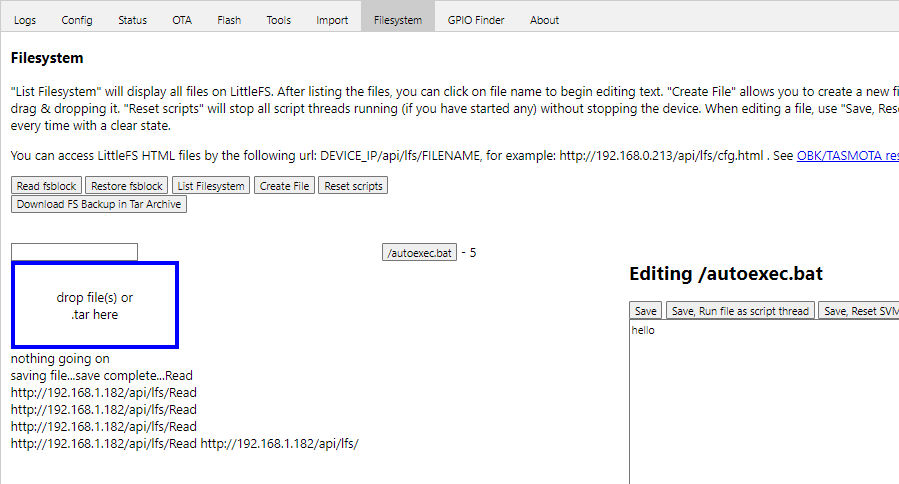

  • #24 21221088
    Posts: 14763
    Rate: 12896

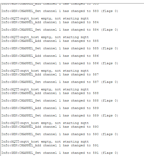

    Nice, I didn't notice that LFS works:
    again:
    addChannel 1 1
    delay_s 1
    goto again
    Screenshot of a system log with messages related to channel changes and MQTT.
    However, I am now confused, it seems to increase less frequently than every second.
  • #25 21221094

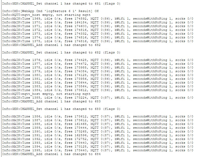

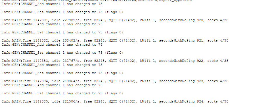

  • Suspected invalid g_deltaTimeMS on ESP32 scripts
    #27 21221104
    Posts: 14763
    Rate: 12896
    The issue with script counting too slowly seem to be ESP-related. It works good on WB3S:
    Screenshot of system logs displaying changing channel and time information.
    On ESP increase is every few seconds:
    Screenshot of system logs showing channel changes and time information.
    It seems that delta time of the scripts tick is invalid:
    Code: C / C++
    it is called from user_main.c:
    Code: C / C++
    Maybe g_deltaTimeMS is invalid on ESP globally.
    Here is a larger snippet:
    Code: C / C++
    Does that mean the QuickTick thread gets fired not often enough?
    Code: C / C++
    I am not sure right now....
