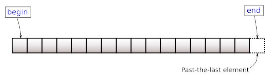

    However, there is a small problem, because the function seems to not sum the last element:
    Example print:
    1658734976,205,208,235,234,-3,330,331,329,332,331,332,333,330,331,332,331,331,332,331,331,333
    Total voltages: 4967
    Counting from the seventh decimal (v01 330) to the last 333 should be 5300.
    [edit.]
    I already know why:
    "Input iterators to the initial and final positions in a sequence. The range used is [first,last), which contains all the elements between first and last, including the element pointed by first but not the element pointed by last. "
