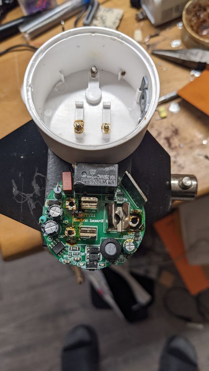

  • This is a teardown of an unbranded wifi switch named SmartPlug. The printed manual referred to Smart Life app.
    The appearance is quite generic with a single button on one side. There is a blue LED around the button.
    W600 TW02 Generic SmartPlug W600 TW02 Generic SmartPlug
    I was able to safely open using using a sharp spudger. The electronics are recessed so spudger has quite less change of damaging anything. Desoldering the power connections takes patient but I was able to do just using a desoldering wick.
    W600 TW02 Generic SmartPlug W600 TW02 Generic SmartPlug W600 TW02 Generic SmartPlug
    And here is the cleaned up board and the chip.
    W600 TW02 Generic SmartPlugW600 TW02 Generic SmartPlugW600 TW02 Generic SmartPlug
    The module had power and serial connection cleared marked and serial connection showed this.

    Examination of the board showed that there was actually a red and a blue LED; red was tied to the relay. W600 TW02 Generic SmartPlug

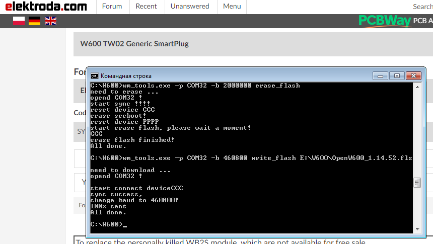

  • TW-02 2.0 flashes reliably at 460800 baud
    #4 20251927
    omelchuk890
    Posts: 70
    Rate: 10
    To replace the personally killed WB2S module, which are not available for free sale, TW-02 2.0 was purchased.
    I begin to conduct the following tests of the brain and iron.
    P,S. Used to flash the module
    Everything works fine on 460800.

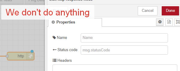

  • Node-Red OTA update workflow for W series

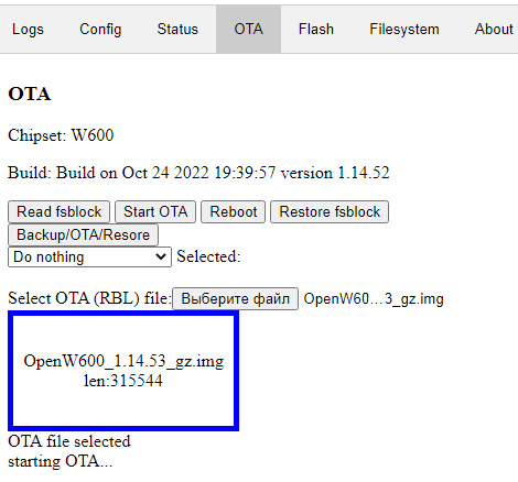

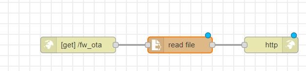

    #12 20253602
    omelchuk890
    Posts: 70
    Rate: 10
    @p.kaczmarek2
    Everything turned out using Node-Red.
    It's very simple. Absolutely.
    But a little instruction to those who follow in my footsteps.
    Copy the file we need to the home folder, I put it in the downloads folder using winscp. Copy the path.
    Next, we assemble a simple construction in NR. Insert the path and name of the file. Select "one buffer object".
    We test through the browser, if everything is OK - insert the link in the OTA configuration menu.
    We enjoy simplicity.
    P.S. 1.14.53 is the latest release that can be downloaded for the W series. There are no recent files.
    Is this the end?
    P.P.S. 1.14.66 and next - ok.

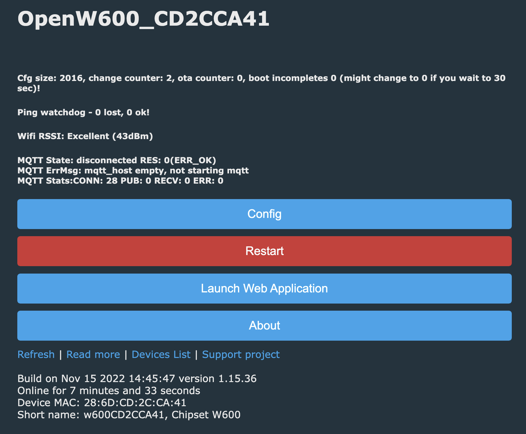

    MisterPi
    Posts: 7
    Update: Flashing with the latest (OpenW600_1.15.36.fls) via serial using w600tool.py worked. Had to tinker with the parameters just a tiny bit, but it worked! So cool! Now I can actually do something with these little boards!
    Thanks and hats off!

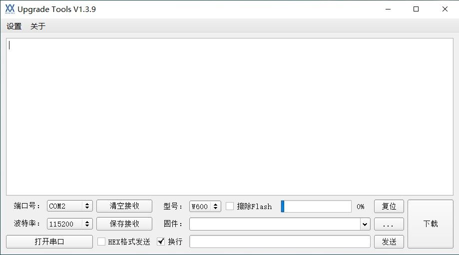

  • #29 20594776
    billdengy
    Level 4  
    I found a full version of w6xx, w8xx flash firmware program, very easy to use, recommend this:

    • Upgrade_Tools_V1.4.18.exe (9.78 MB) You must be logged in to download this attachment.

Three-step flashing guide?
  1. Hold BOOT, tap RESET to enter UART mode.
  2. Run wm_tools -p COMx write_flash firmware.fls.
  3. Power-cycle; connect to the new AP for setup. [Elektroda, iprak, post #20275572]
How do I perform OTA updates on W600?
Use the basic HTTP OTA field in the web Config page: host the .img on a local server (XAMPP, Node-RED, or IIS), paste the URL, and press Update [Elektroda, iprak, post #20252832]
My OTA failed with versions 1.14.70/71—why?
Those builds lacked Wi-Fi initialisation for W600; after update the AP never appears, forcing serial rollback to 1.14.69 [Elektroda, omelchuk890, post #20256479]
What’s an edge-case failure to watch for?
Using the web-app drag-and-drop OTA won’t work on W600/W800; only the direct HTTP method is implemented [Elektroda, iprak, post #20252812]
