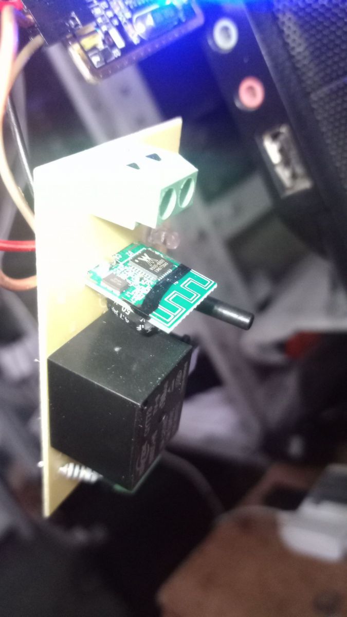

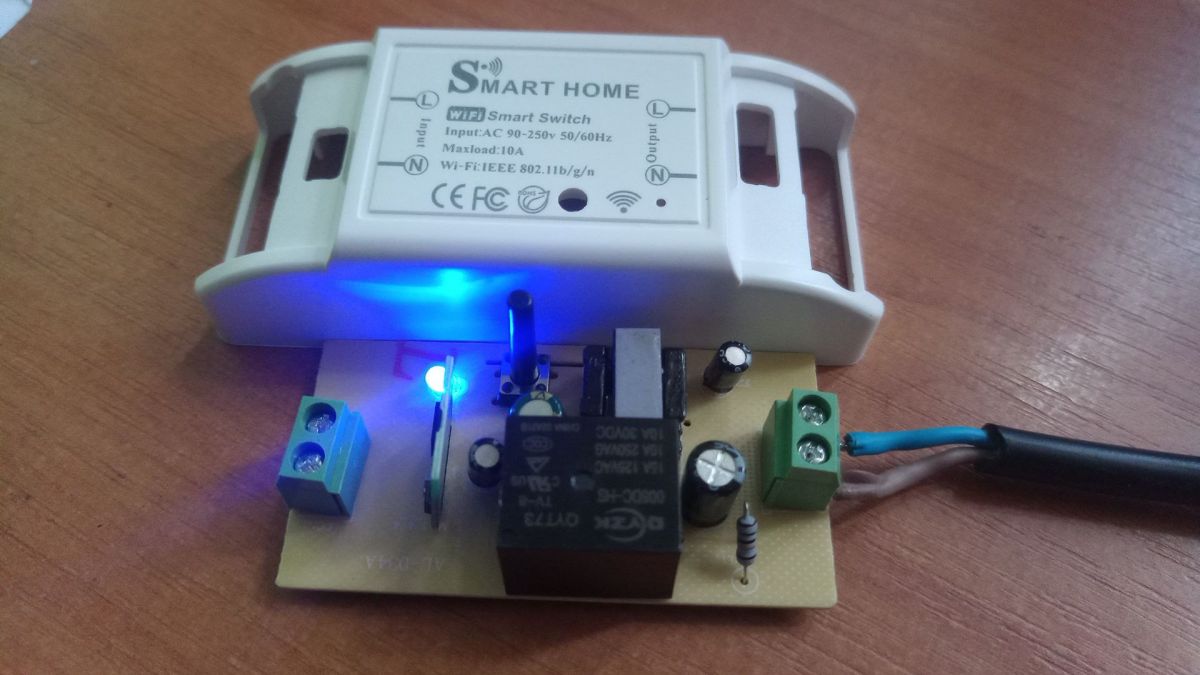

    Recently bought a small amount of WiFi switch for about 1.4 eur.
    It is clearly seen that on https://www.elektroda.com/rtvforum/topic3815120.html - exactly the same boxes and the layout of the board, only the color of the board is light yellow.
    Close-up of a WiFi Smart Switch with exposed PCB and a glowing blue LED.
    The build and soldering quality is disgusting :)
    Disassembly showed that they installed realtek and started installing the w600.
    Circuit board with a WiFi module integrated into an electronic setup.
    Internal board T102 w600-v2.0, goldfinger as wa2, cb2s, wr2s or TYWE3S TYWE2S.

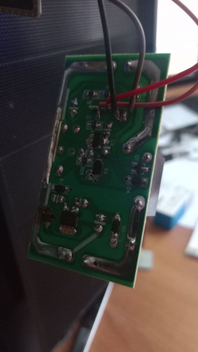

    TX-RX additional boards are not attached to the board, so it is possible not to solder out the board for programming (and it is possible to use it). They are distributed in a 6-pin row cut after VDD and GND.
    Electronic circuit board with wires connected to various components.
    Downloading the firmware to the platform as described in the topic: https://www.elektroda.com/rtvforum/topic3926992.html#20239610
    software: https://github.com/w600/wm_tools
    I used the port speed: 460800
    GPIO Finder will help me set pins:
    "pins": {
    "6": "Btn;1",
    "14": "Rel;1",
    "16": "LED_n;1"
    JSON:
    Template file: AL-034..zip (450 bytes)You must be logged in to download this attachment.
