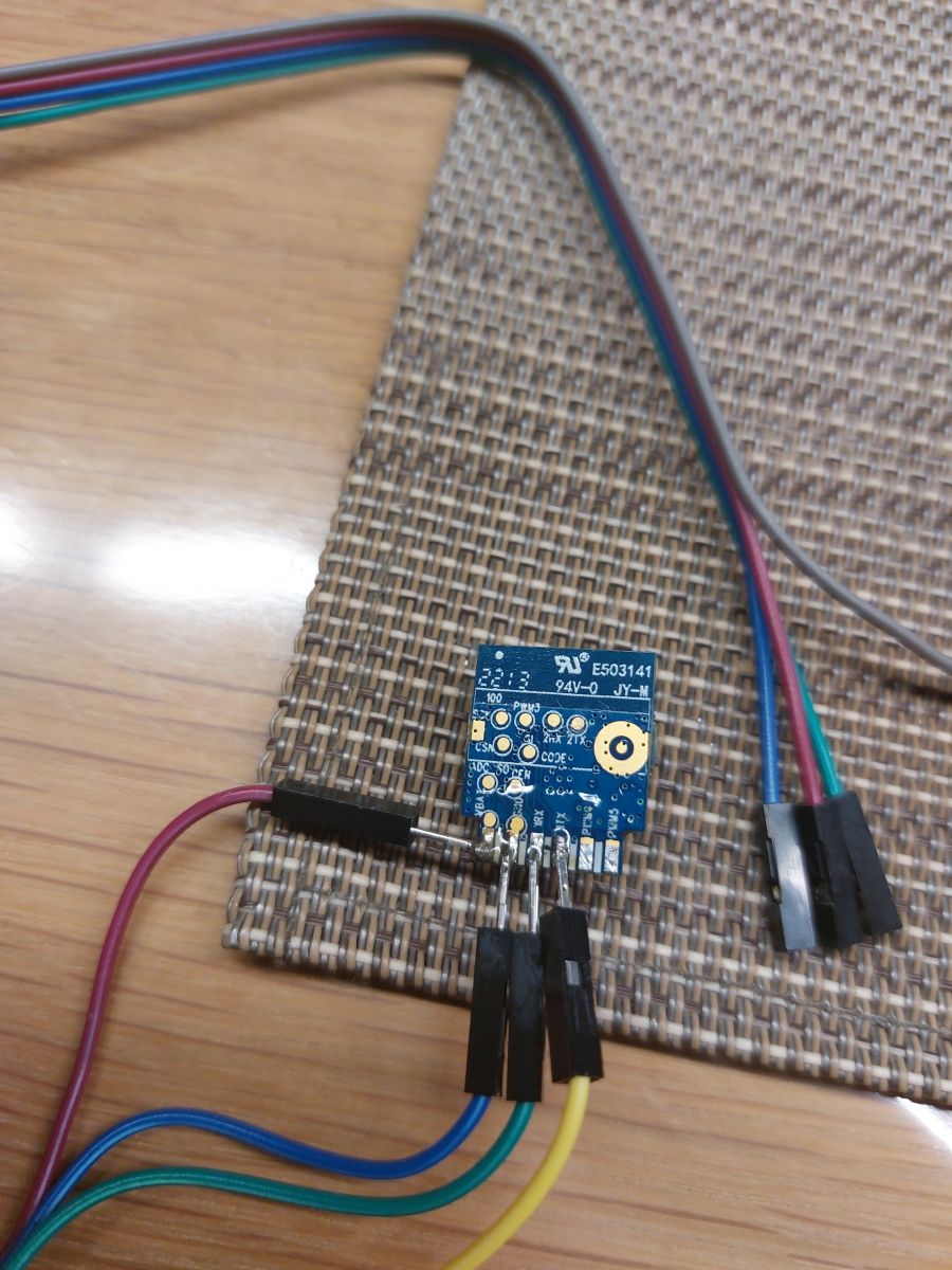

    Patient from the subject
    Here is the aforementioned module with a damaged bootloader - BK7231T on a board with readily available signals from SPI.
    BK7231 programming via SPI in flash memory mode - Python and Banana Pi
    As a supplement, I will add that in the picture above we have pins:
    - TX and RX (normal UART programming)
    - TX2 and RX2 (log UART)
    - IO0 - it's probably a remnant of ESP, I don't know what it's for
    - RST - I didn't check what it was for, but it's probably RESET
    - CE (CEN) - this is the pin I reset BK7231
    - SO, SI, SCK, CSN - SPI interface
    - ground and 3.3V power supply - you know

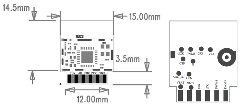

  • Clarifying whether SPI or flash pins should be used
    #2 20279193
    danaia

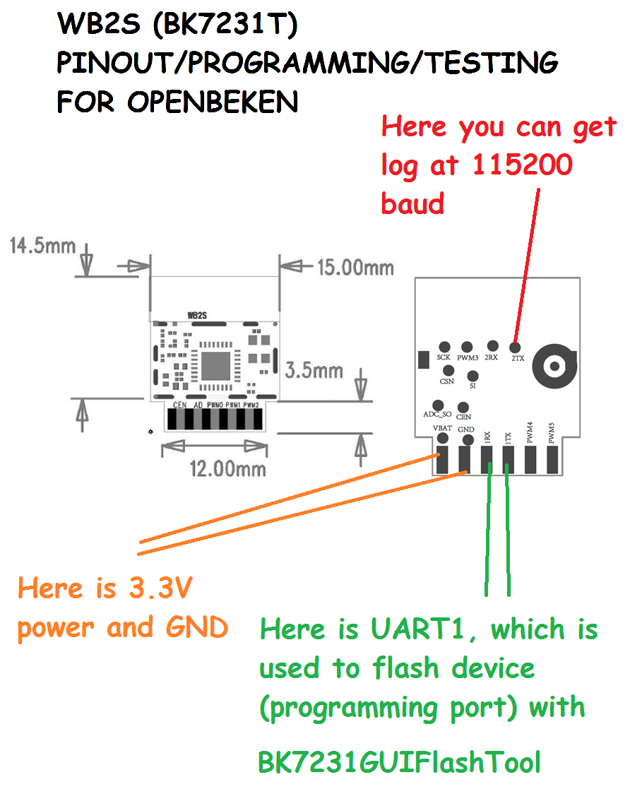

    I've been trying this method to resurrect a BK7231T with no success as of yet. I'm using a Raspberry Pi Zero, SPI seems to be functional (tested with spi_test).
    I soldered wires to SPI_* pins on the chip (on the right of the diagram). However, I noticed that this guide specifies that the FLASH_* pins are to be used (which are on the top of the diagram). Could you specify which pins are supposed to be used? Thanks
  • #3 20279198
    Posts: 14793
    Rate: 12941
    Hello @danaia, it seems that you are correct. It must be an editing error. All my boards used for experiments have already broken out pins so I didn't verify that. You should try these pins:

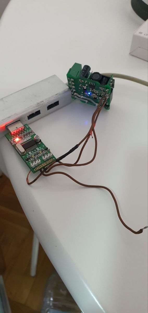

  • #4 20279614
    danaia
    It worked! I have the WBLC5 board, so I was able to used its provided pads instead of soldering directly to the chip.
    The device ID wasn't correct with 30000Hz configured, so I tried some random values and ended up succeeding with 3000Hz.
    Thanks for the guide!

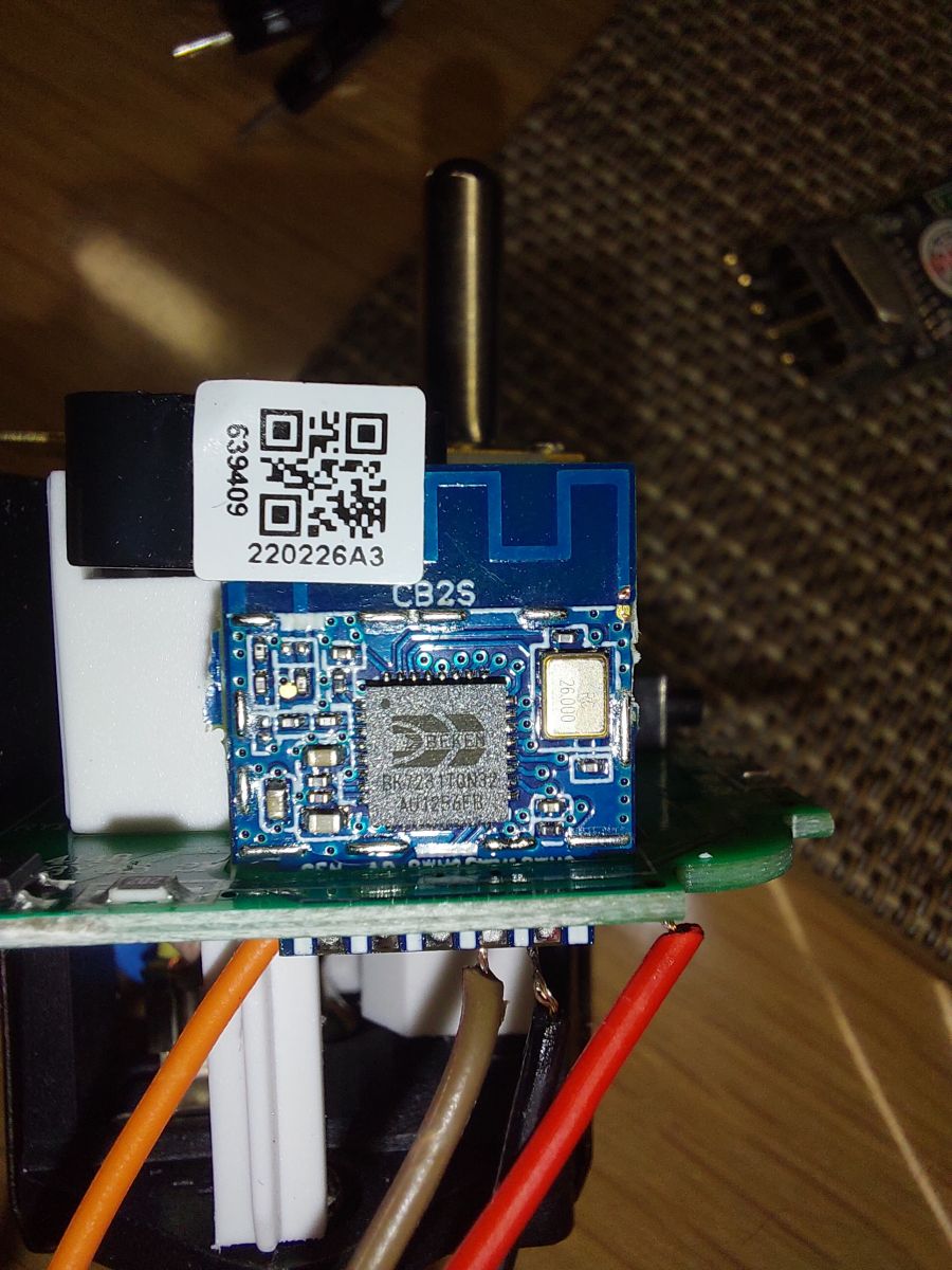

  • OrangePi SPI flashing fixes for BK7231T CB2S
    #7 20339930
    blowagie
    Posts: 11

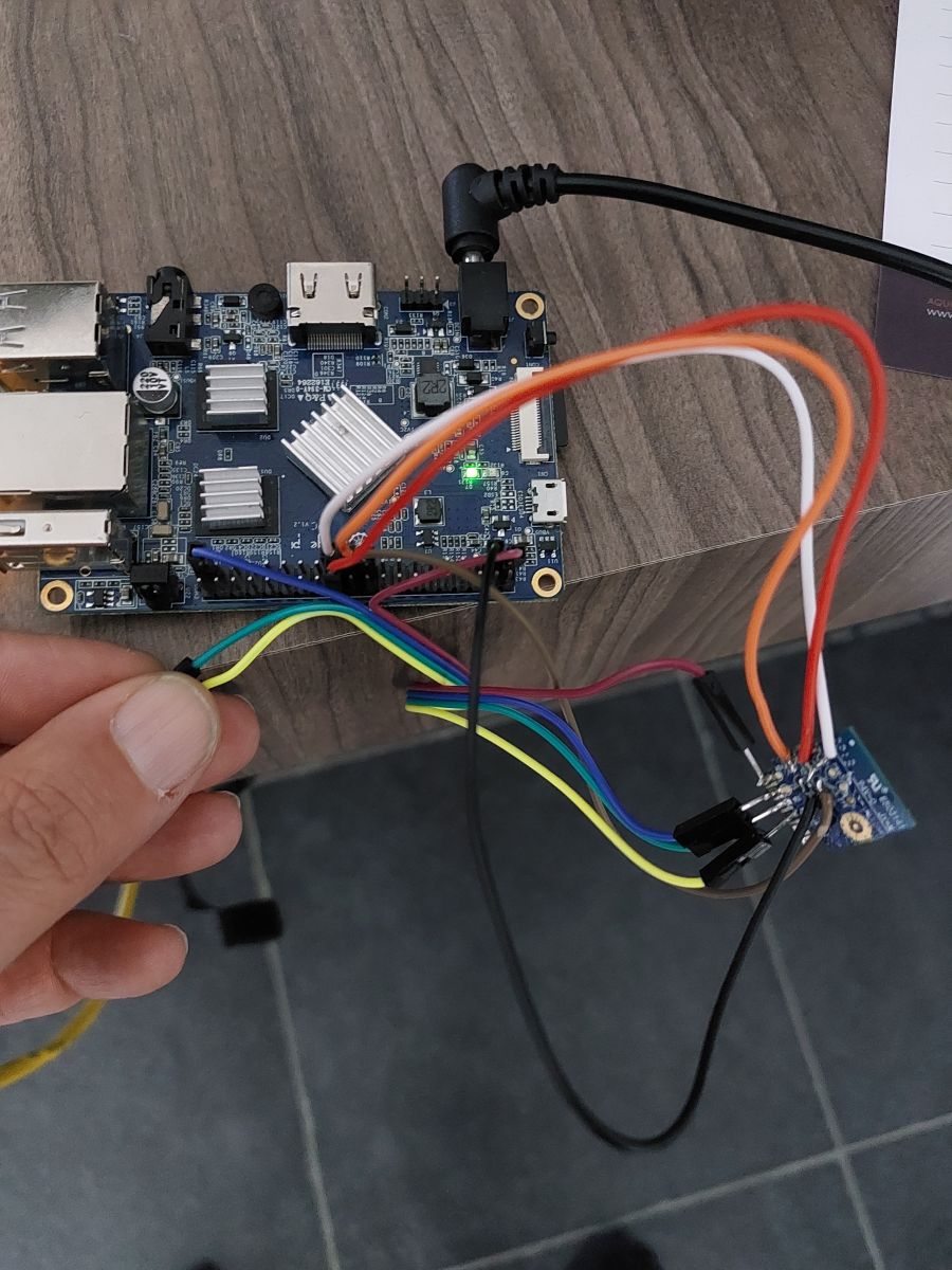

    Thanks a lot for this manual. I've used this procedure to recover from a wrong flash I did before. My CB2S module has a BK7231T chip installed instead of a BK7231N.
    To flash an image with the bootloader, I used my OrangePi PC with some modifications of the code:
    import OPi.GPIO as GPIO
    CENGPIO = 3
    GPIO.setboard(GPIO.PCPCPLUS)
    GPIO.setmode(GPIO.BOARD)
    I also had some compilations problems which where fixed by:
    export CFLAGS=-fcommon
    pip install --upgrade pip
    pip install wheel
    pip install spidev
    pip install OrangePi.GPIO
    I also needed to adjust the sleep from 1 second to 0.2 seconds before the the chip went into SPI mode.
    I wired the PINS as follow:
    Black CEN --> PIN 3
    Brown SCK --> PIN 19
    Orange SO --> PIN 21
    White SCK --> PIN 23
    RED CSN --> PIN24
    Purple VBAT --> PIN 1
    Blue GND --> PIN 39

    CB2S with BK7231T... I have never expected to see such an oddity. I wonder what was the story behind it. A BK7231N shortage? A production error?
    Anyway, good job. That bit of information with 0.2 also might be useful.

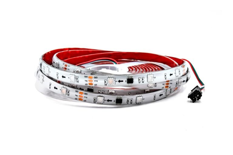

  • BK7231T LED strip runs firmware but ignores commands
    #13 20574683
    fagnerlins08
    It's an addressable led strip with BK7231T microphone chip, I don't even have a knowledge about arduino I started with it today :(
    I even ran the firmware on the device, but I couldn't control it, not even a command that was sent worked.

    I do SPI on WB2S
    root@raspberrypi:~# python beken_sp_flash.py
    /root/beken_sp_flash.py:13: RuntimeWarning: This channel is already in use, continuing anyway. Use GPIO.setwarnings(False) to disable warnings.
    GPIO.setup(CENGPIO, GPIO.OUT)
    Send 250 'D2'
    0x0 0x52 0xd2 0xd2 0xd2 0xd2 0x0 0x0 0x0 0x0 0x0 0x0 0x0 0x0 0x0 0x0 0x0 0x0 0x0 0x0 0x0 0x0 0x0 0x0 0x0 0x0 0x0 0x0 0x0 0x0 0x0 0x0 0x0 0x0 0x0 0x0 0x0 0x0 0x0 0x0 0x0 0x0 0x0 0x0 0x0 0x0 0x0 0x0 0x0 0x0 0x0 0x0 0x0 0x0 0x0 0x0 0x0 0x0 0x0 0x0 0x0 0x0 0x0 0x0 0x0 0x0 0x0 0x0 0x0 0x0 0x0 0x0 0x0 0x0 0x0 0x0 0x0 0x0 0x0 0x0 0x0 0x0 0x0 0x0 0x0 0x0 0x0 0x0 0x0 0x0 0x0 0x0 0x0 0x0 0x0 0x0 0x0 0x0 0x0 0x0 0x0 0x0 0x0 0x0 0x0 0x0 0x0 0x0 0x0 0x0 0x0 0x0 0x0 0x0 0x0 0x0 0x0 0x0 0x0 0x0 0x0 0x0 0x0 0x0 0x0 0x0 0x0 0x0 0x0 0x0 0x0 0x0 0x0 0x0 0x0 0x0 0x0 0x0 0x0 0x0 0x0 0x0 0x0 0x0 0x0 0x0 0x0 0x0 0x0 0x0 0x0 0x0 0x0 0x0 0x0 0x0 0x0 0x0 0x0 0x0 0x0 0x0 0x0 0x0 0x0 0x0 0x0 0x0 0x0 0x0 0x0 0x0 0x0 0x0 0x0 0x0 0x0 0x0 0x0 0x0 0x0 0x0 0x0 0x0 0x0 0x0 0x0 0x0 0x0 0x0 0x0 0x0 0x0 0x0 0x0 0x0 0x0 0x0 0x0 0x0 0x0 0x0 0x0 0x0 0x0 0x0 0x0 0x0 0x0 0x0 0x0 0x0 0x0 0x0 0x0 0x0 0x0 0x0 0x0 0x0 0x0 0x0 0x0 0x0 0x0 0x0 0x0 0x0 0x0 0x0 0x0 0x0 0x0 0x0 0x0 0x0 0x0 0x0 0x0 0x0 0x0 0x0 0x0 0x0 0x0 0x0 0x0 0x0 0x0 0x0 Test by sending get ID
    0x0 0x1c 0x70 0x15 ID OK
    WriteImage OpenBK7231T_QIO_1.17.105.bin
    count 0/2097152
    count 256/2097152
    count 2096384/2097152
    count 2096640/2097152
    count 2096896/2097152
    root@raspberrypi:~#
    This code (https://github.com/openshwprojects/BK7231_SPI_Flasher/blob/main/bk7231_spi_flasher.py) but only
    custom this:
    CENGPIO = 3
    spi.max_speed_hz = 2500
    WriteImage(0,"OpenBK7231T_QIO_1.17.105.bin", 0x200000)
    After finishing nothing is happening Chip don't send me wi-fi OpenBKxxx or anything...I found dump that i get from that device before i kill him with this command:
    WriteImage(0,"OpenBK7231T_QIO_1.17.105.bin", 0x11000)
    WriteImage(0x11000,"dump.bin", 0x200000)
    All goes ok but in the end nothing...
    Any ideas?
    Thanks

    Please post the RX2 log at 115200 baud rate so we know what happens on the chip.
  • #16 20576982
    slaweb91
    Level 4  
    Posts: 9
    Ok, how can do that? I never to SPI before now :)
    Added after 11 [minutes]:

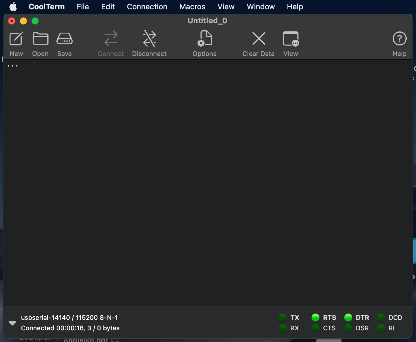

    When I connect the chip to USB-TTL and try to connect with bk7231flasher I can't get anything...I start all and 1sec I connect CEN to GND but nothing.
    It seems to get stuck somewhere when starting.
    Can I get some log from SPI because SPI works fine...

    Unfortunately nothing...only blue LED work. As soon as I turn it on, the LED lights up and when I connect CEN to GND in ms off and again LED is on. LED doesn't blink...works constantly.

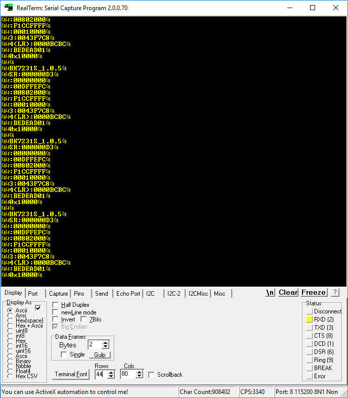

  • Check TX2 output with UART terminal open
    #19 20577098
    Posts: 14793
    Rate: 12941
    It's not "bothering", I am happy to help. Please ask much as you want. We're here to help you.
    Ok, so now, are you really, 100% sure that you are getting nothing from TX2 pin?
    Please keep UART terminal open and then power off and on the BK7231.
    Keep only power connected, because it may be in RESET state due to the CEN connection at low level, that's why it prints nothing.
    Check again if it prints anything. It should at least print the chip name at 115200 baud.
    If device is alive, even with broken bootloader, you should get:
    ----Nothing, when I power off and on BK in ms, I get RX on COOLTERM software goes green but nothing to see on console.
    ----You meen 1TX because i dont have that TX2 pin on wb2s chip?
    No, I mean TX2, the UART1 is for programming via bootloader, and UART2 is for debug log.
    Hmm it seems to be marked 2TX on silkscreen, but still, 2TX (UART 2 TX) is a debug log output.
    Let me be clear:
    You will get log output at TX2 (2TX, UART2TX, etc, etc, etc).

    I just did that but unfortunately, I get absolutely nothing.
    I connect my 3.3 gnd and rx(from uart) to 2tx(wb2s) and I start CoolTerm...10 times I turn off and on 3.3 for wb2s but nothing.
    I can only connect to SPI and do flash but in the end nothing...
    I order 1pcs of ESP-02S and I will flesh that chip with tasmota and replace him with my wb2s :(
    I dont have any more ideas how can I back to life my wb2s.
    First I dump flash with "bk7231tools read_flash -d /dev/ttyUSB0 -s 0 -l 0x200000 dump.bin"
    And that was ok i get dump.bin orginal firmware.
    After that i copy command that i use for cb2s(day before I flesh that chip without any problem, but his offset is 0x0 and i didnt see that)
    bk7231tools write_flash -d /dev/ttyUSB0 -s 0x0 -l 0x200000 --bootloader OpenBK7231T_UA_1.17.105.bin
    And after that I get dead chip :)
    This i think was i right command:
    bk7231tools write_flash -d /dev/ttyUSB0 -s 0x11000 -S 0x11000 -l 0x20000 OpenBK7231T_UA_1.17.105.bin
    But in future I will use flasher with GUI...

  • #25 21206167
    dwmw2
    Posts: 19
    Should this work for a BK7231N? I just bricked one by accidentally power cycling it as it was flashing:
    I was briefly hopeful that 0x1c000 was outside the bootloader but it's stuck in a bootloop and doesn't seem to connect again.

    BK7231N is not-brickable. You can restore bootloader even with our simple flasher, just enable overwrite boot option:

    >>21206217 Aha thanks. Perhaps I just didn't have the probes on the TX/RX pins very well; after a lot more tries, I did manage to get it to reconnect.

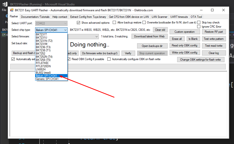

    Here's new tool for Beken SPI recovery:
    This will work along with CH341 and is a recommended solution now.
    Chip selection menu in BK7231Flasher app with Beken SPI CH341 option highlighted
    Remember to choose Beken SPI mode, not generic. Btw, you can drag and drop file on flasher to put it in "select firmware".
    Futhermore, connect D2 of CH341 to CEN, so it can reboot Beken externally.
Discussion about recovering and programming BK7231-based modules through SPI flash mode using a Python script on Raspberry Pi/Banana Pi and later Orange Pi. The original guide explains that BK7231 is normally flashed over UART bootloader, but SPI mode can be used to restore devices when the bootloader is damaged or overwritten. Several users clarified pin mapping errors, confirmed successful recovery on WBLC5 and WB2S boards, and reported that lower SPI clock rates such as 3000 Hz may be required for reliable device ID detection. One user adapted the script for Orange Pi, changed GPIO libraries, fixed Python package issues, and shortened the startup delay before entering SPI mode. The thread also covers troubleshooting dead modules, checking UART2 TX debug output at 115200 baud, comparing read-back data after flashing, and notes that BK7231N can be restored with overwrite-boot options in BK7231GUIFlashTool. Later posts mention attempts to use Arduino Mega 2560 as an SPI programmer, and a final recommendation to use the newer Beken SPI recovery tool with CH341 in Beken mode.
TL;DR: 2 out of 2 bricked BK7231 boards were revived in <10 min using a 3-step SPI flash script; “BK7231 is usually programmed via UART” [Elektroda, p.kaczmarek2, post #20268279]
Why it matters: The SPI method can unbrick chips even when the factory bootloader is erased.
• SPI mode: Mode 3, 30 kHz typical; success also at 3 kHz on Raspberry Pi Zero [Elektroda, danaia, post #20279614] • Unlock sequence: pull CEN low 1 s, then transmit 0xD2 250 × [Elektroda, p.kaczmarek2, post #20268279] • Flash page size: 256 bytes; sector erase every 4 kB (0x1000) [Elektroda, p.kaczmarek2, post #20268279] • Bootloader length: 0x11000 bytes (68 kB) [Elektroda, p.kaczmarek2, post #20268279] • Chip ID response: 00 15 70 1C for BK7231T/N in SPI-flash mode [Elektroda, p.kaczmarek2, post #20268279]

Can I swap Raspberry Pi for an Orange Pi or Banana Pi?
Yes. Orange Pi PC and Banana Pi M1+ both succeeded after installing spidev and board-specific GPIO libraries; one user exported CFLAGS=-fcommon to compile OrangePi.GPIO [Elektroda, blowagie, post #20339930]
