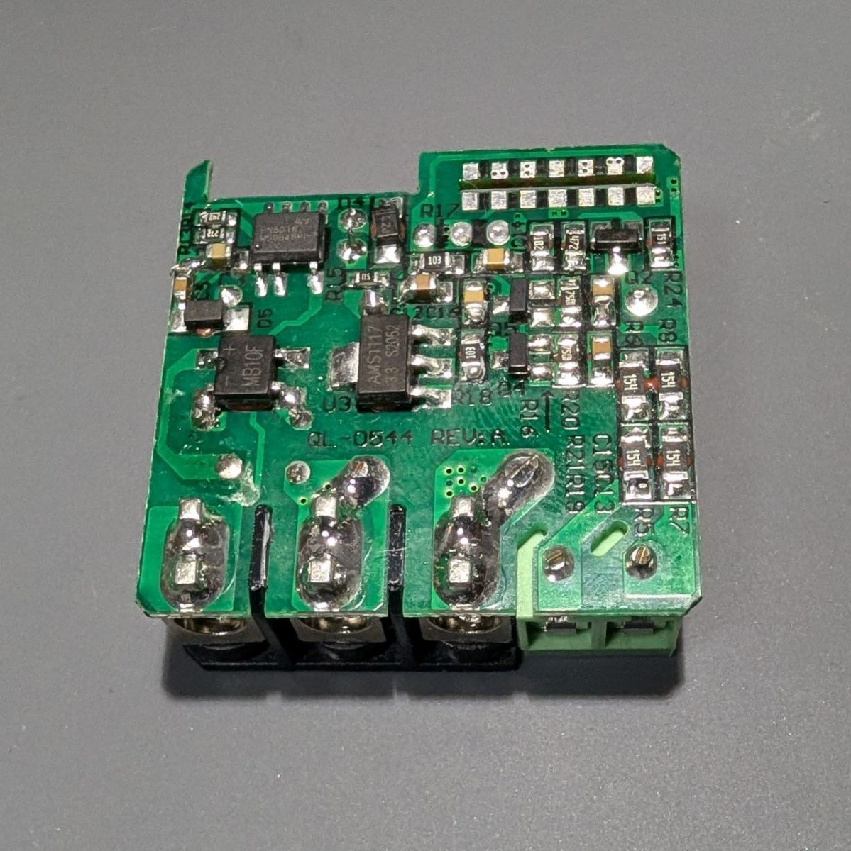

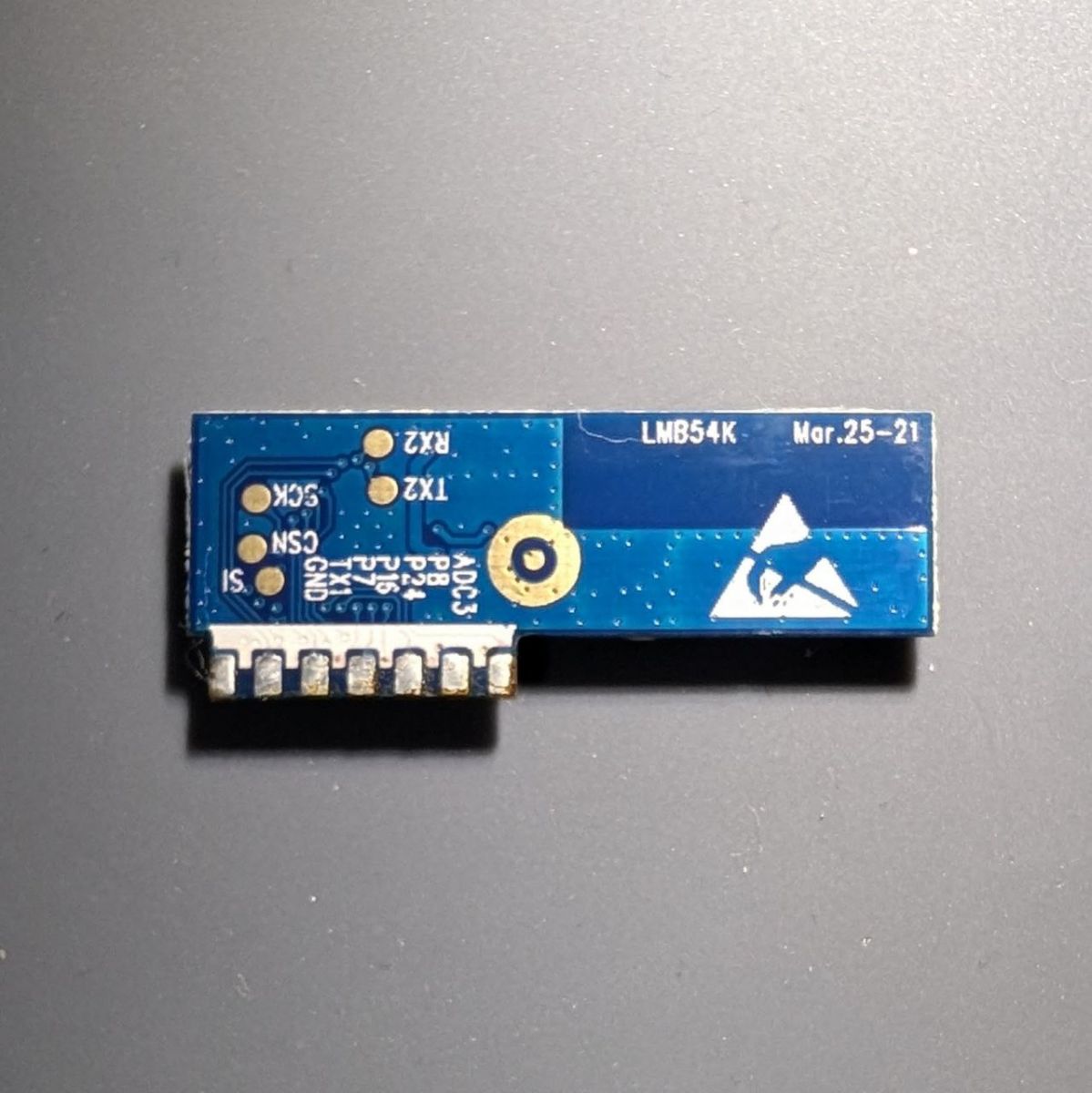

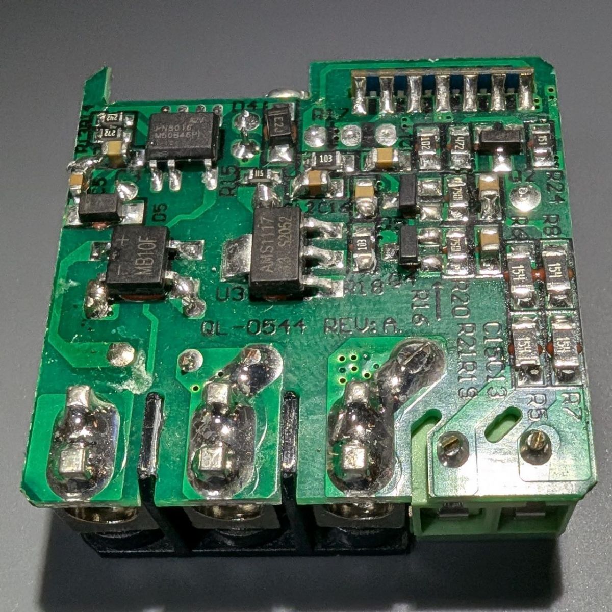

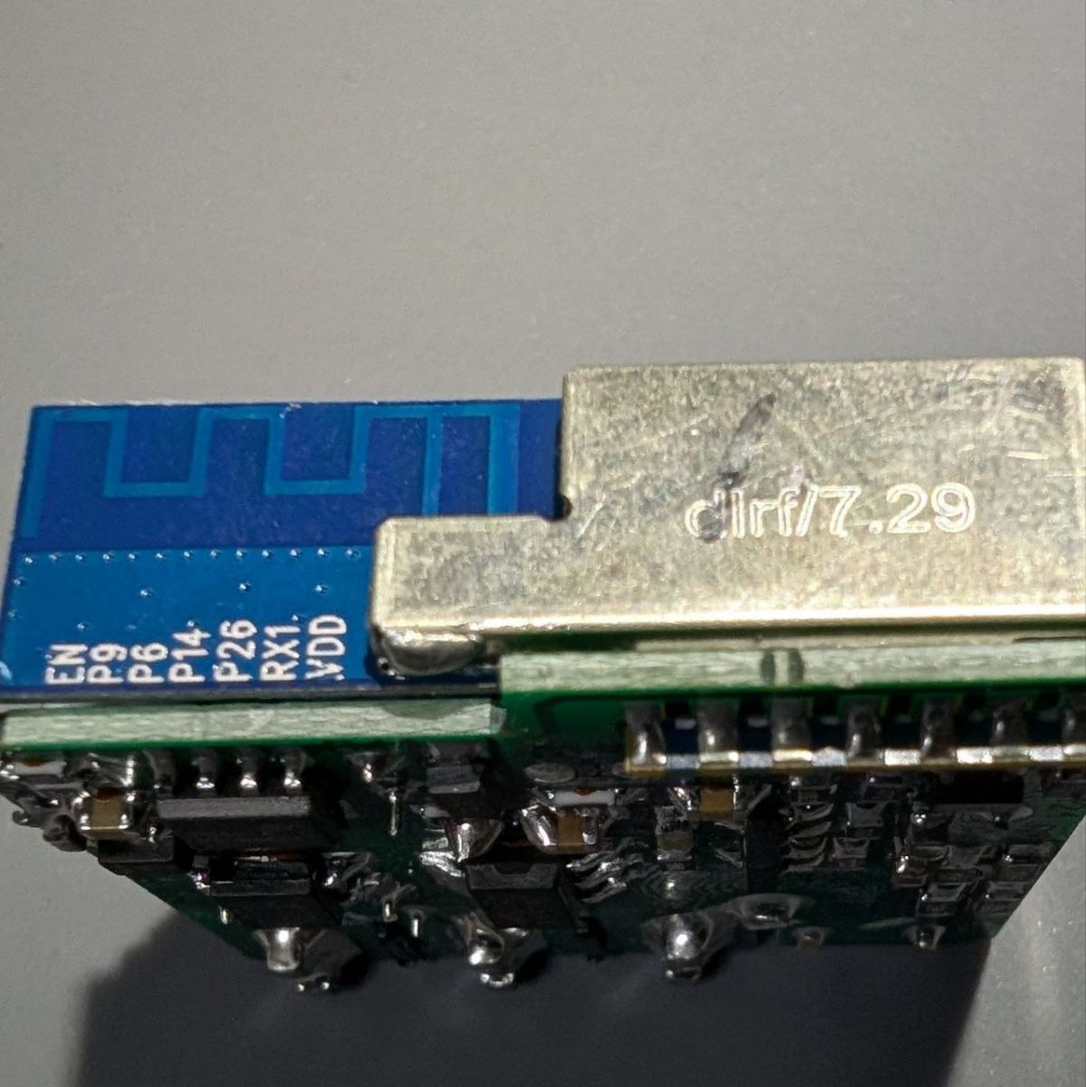

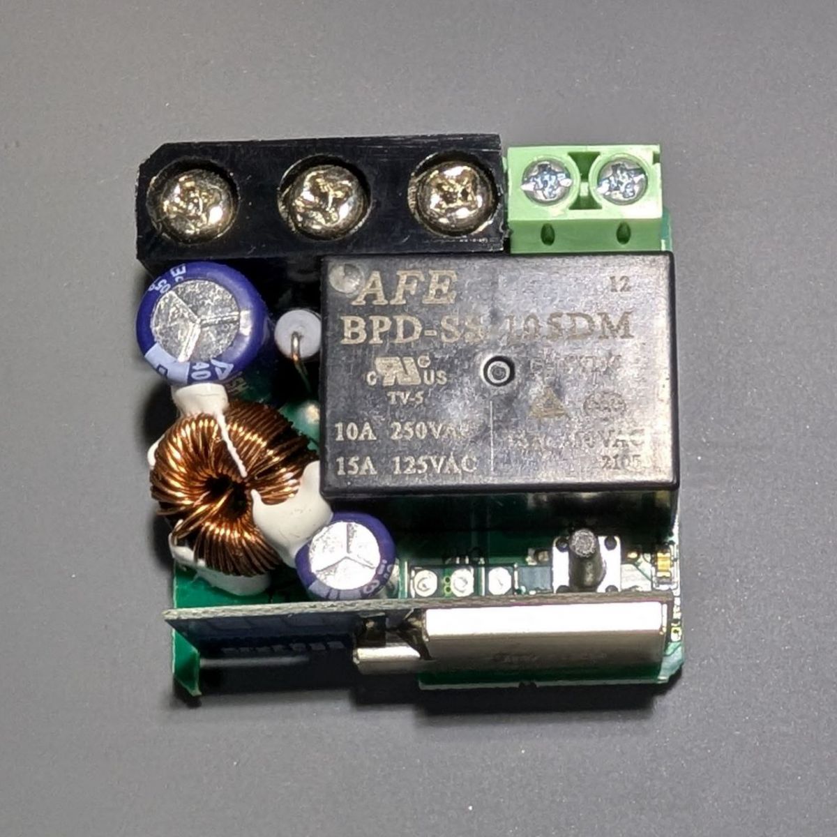

    Pin assignment for BK7231N relay board teardown
    #1 21278069
    tehb13
    Packaging of the SBER smart relay with text Salut! This is a smart relay and specification 1 channel, 3.68 kW.
    SBER smart relay device with technical specifications
    Close-up of a printed circuit board featuring an AFE BPD-S104SDM relay and other electronic components on a gray background.
    Circuit board with integrated circuits and electronic components.
    Close-up of an electronic module with pin markings and an antenna.
    Blue PCB with pin labels and a logo at the top.

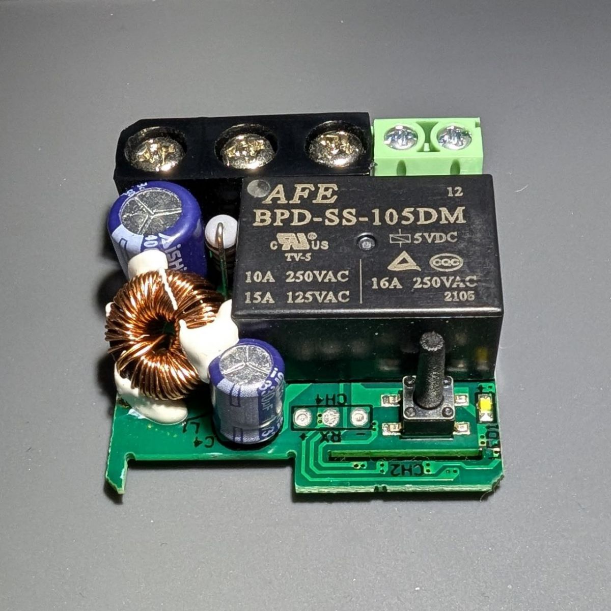

    AFE BPD-SS-105DM relay module with coils and capacitors.
    Electronic module on a gray background with visible components and connectors.
    PINAssignment
    ADC3
    P8Switch
    P24
    P16Button
    P7
    TX1
    GNDGND
    PINAssignment
    EN
    P9RELAY
    P6
    P14
    P26LED
    RX1
    VD0 3.3v

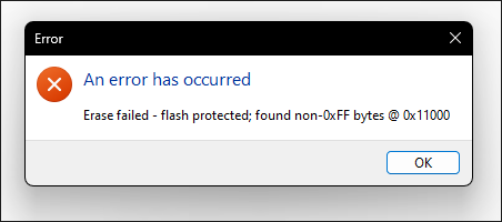

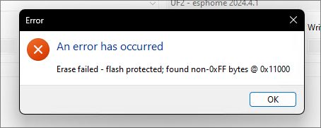

    tehb13
    >>21278408
    Error message regarding a failed erase operation with flash protection.
  • OTA package flashing avoids full-image restore
    #7 21279490
    insmod
    Posts: 1432
    Help: 168
    Rate: 455
    >>21279480 If erased without backup, then the original bootloader is lost - guaranteed brick. Or then separating the bootloader from backup image, and flashing just it. Alongside losing RF partition.
    >>21279094 Besides, there is no need to flash a full image, just flashing ota package is enough. Bootloader will then update the firmware. In my case on a different device - bkcrypt_coeff is probably wrong - flashing didn't work. But writing rbl at ota address, and subsequent updates from esphome works ok.
  • UF2 flashes cleanly but relay stays nonfunctional
    #8 21279522
    tehb13
    I flashed the backup. The device works.
    I got this error when flashing the sbdv-00050-ota.rbl
    When flashing sbdv-00050.uf2, no errors occur, but the device does not work, as well as without adding:
    Code: YAML

    >>21279522 At what address did you flash sbdv-00050-ota.rbl?
    Try to get uart1 connected, if bootloader version is something like 1.0.13, then it will print what is wrong with OTA package (like wrong enc keys).
    You can also erase main firmware (for first attempt - 0x10000 to 0x12000) after flashing OTA. Maybe it will work then.

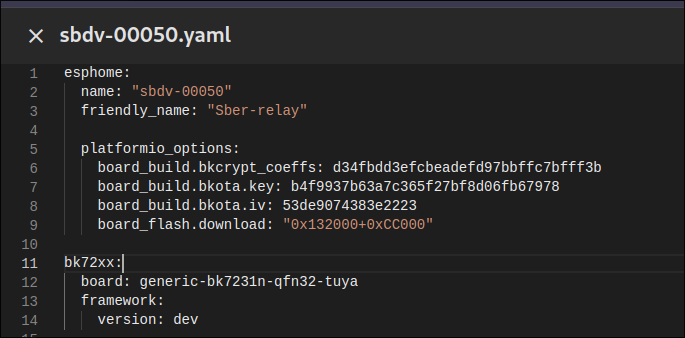

    >>21284726 If you are using ltchiptool, then choose rbl and just flash it, it should be autodetected as beken ota image with 0x132000 address.
    Btw, you are missing a "+" sign in board_flash.download, it should be "0x132000+0xCC000"
    And please add log to esphome configuration, it will be easier to debug. And maybe enable api encryption?
    Also, what esphome version are you using? In the OTA config in the latest versions you need to select the platform (just esphome for now) like that
    ota:
      - platform: esphome
        password: !secret ota_password
  • #13 21284811
    tehb13
    I have not lost the plus symbol in yaml. This probably happened when publishing the post
    Screenshot of a YAML file named sbdv-00050.yaml with a configuration for esphome.
    When I try to flash sbdv-00050-ota.rbl via ltchiptool, over the factory, I get an error
    Error displayed during an attempt to flash a file using ltchiptool
    BKFIL flashes it without an error.
    logs_sbdv-..050.txt (40.54 kB)You must be logged in to download this attachment.

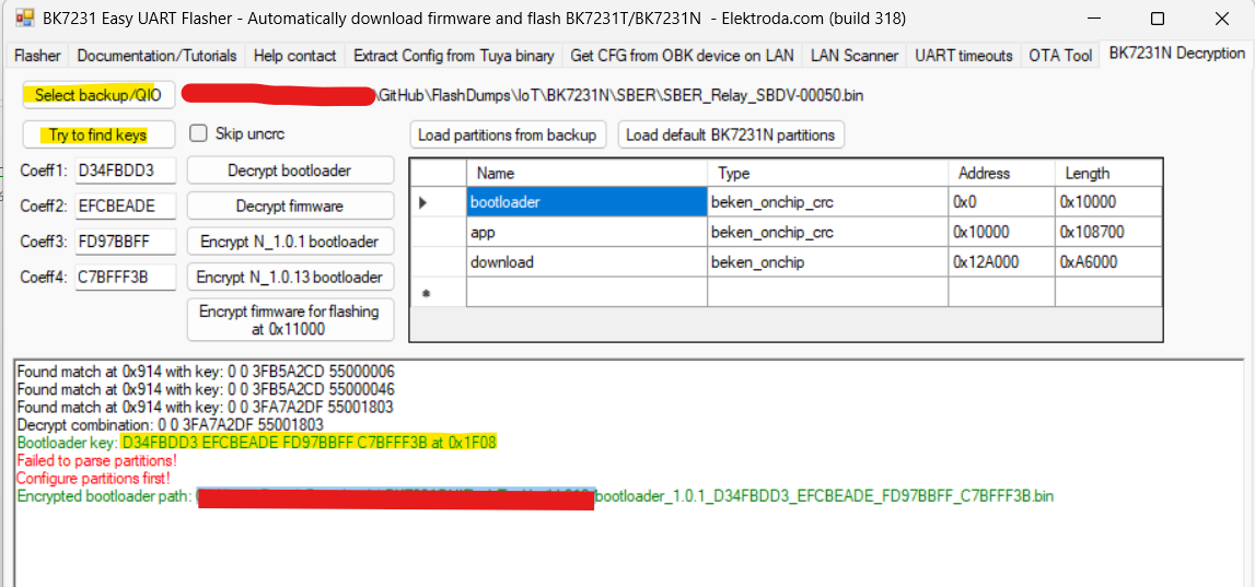

    Hello everyone. I also have a problem with this relay. I took a dump in the "M" mode. Then I flashed different firmware, but it didn't work out. I tried to return the dump, it doesn't work either. The LED does not light up when turned on. I've tried different programs. And I inserted the code above into yaml and compiled the firmware in esphome, but it still doesn't work. There were no firmware errors.
    Code: YAML
  • #16 21912674
    Posts: 5216
    Help: 448
    Rate: 917
    open your backup in this tab in Easy Flasher and try to find keys. if the backup is mostly OK maybe it will come back with the same key as below?
    Screenshot of BK7231 Easy UART Flasher showing partitions table and found decryption keys
    if it's the same key then the bootloader attached (flashed to 0x0) should boot (no OBK AP will broadcast) and you'll see the bootloader log if you're watching TX debug with a terminal.

    #17 21914774
    lesder1986
    Level 4  
    Posts: 7
    The keys match, and I can decompile my backup the same way. Do I need to flash the attached bootloader via BKFIL at 0x0 to the native firmware? Then flash the Ota already compiled with my code through itchiptool? Thanks.
  • #18 21914777
    insmod
    Posts: 1432
    Help: 168
    Rate: 455
    Flash it via any tool at 0x0, but OTA image must use default Tuya OTA key (simply remove all platformio_options). OpenBK7231N OTA image would work too.
    Added after 4 [minutes]:
    Oh, and OTA image must be flashed to 0x12A000
  • #19 21914882

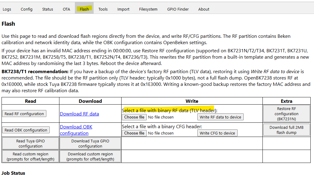

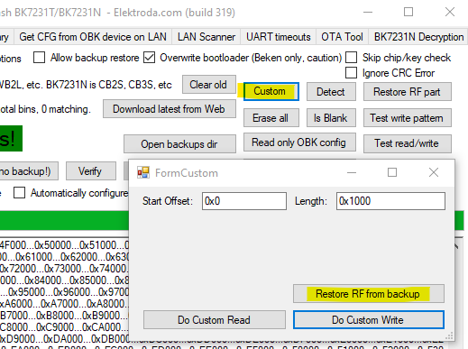

    good stuff. there's also the option to restore your original device's rf info, including mac, from the backup if you need to
    BK7231N Sber Smart Relay SBDV-00050 Pin Assignment and Teardown
    or the same with Easy Flasher if UART still wired
    Screenshot of BK7231N tool showing “FormCustom” window with offset/length fields and read/write buttons.

    >>21915242
    Thank you, I restored it using a full backup via the firmware, I did not make a separate RF backup, but I understood that it would not be possible to restore the full bin file over the Internet.
  • #28 21915274
    Posts: 5216
    Help: 448
    Rate: 917
    rf = wifi calibration etc :)
    and yes, I forgot the TLV section would need to be cut out of the backup for the web app flash to work. I do have a PR that includes full-flash scan for the TLV section and will lift that bit out for flashing, but the other changes in the PR might need reviewing first.
