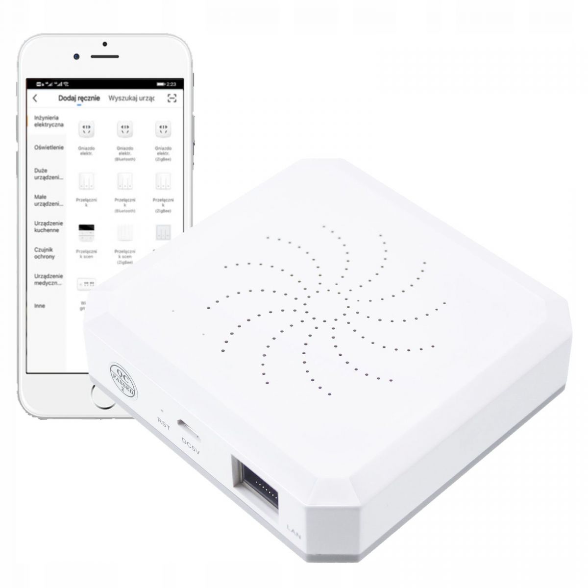

    Part, I'm looking and reading various forums and I already have a definite confusion in my head, I want to build a small simple smart home system, light control, garage and entrance gate (somfy) some temperature sensor and that's it. I have added to the conclusion that I will head into zigbee tuya, what do you guys think? What gateway should I buy to be as compatible as possible? Something like this could be?
    https://allegro.pl/oferta/centralka-bramka-zigbee-wifi-tuya-smart-life-9054486387

    Do you want to connect the gateway to the router via an Ethernet cable or via Wi-Fi?

    It doesn't matter to me, the gateway will be next to the router anyway, so it will probably be wired, I'm just looking for a proven device because there is a lot on the market and you don't know what to buy.

    As for a tried and tested version, how I use one that looks like the one in the Allegro auction number "11544179239".
    Zigbee Tuya - what gateway/central for light control, Somfy gates, temperature sensor? .
    I also bought on Allegro, but I see that the seller is now offering a different model - auction number "12140699340"

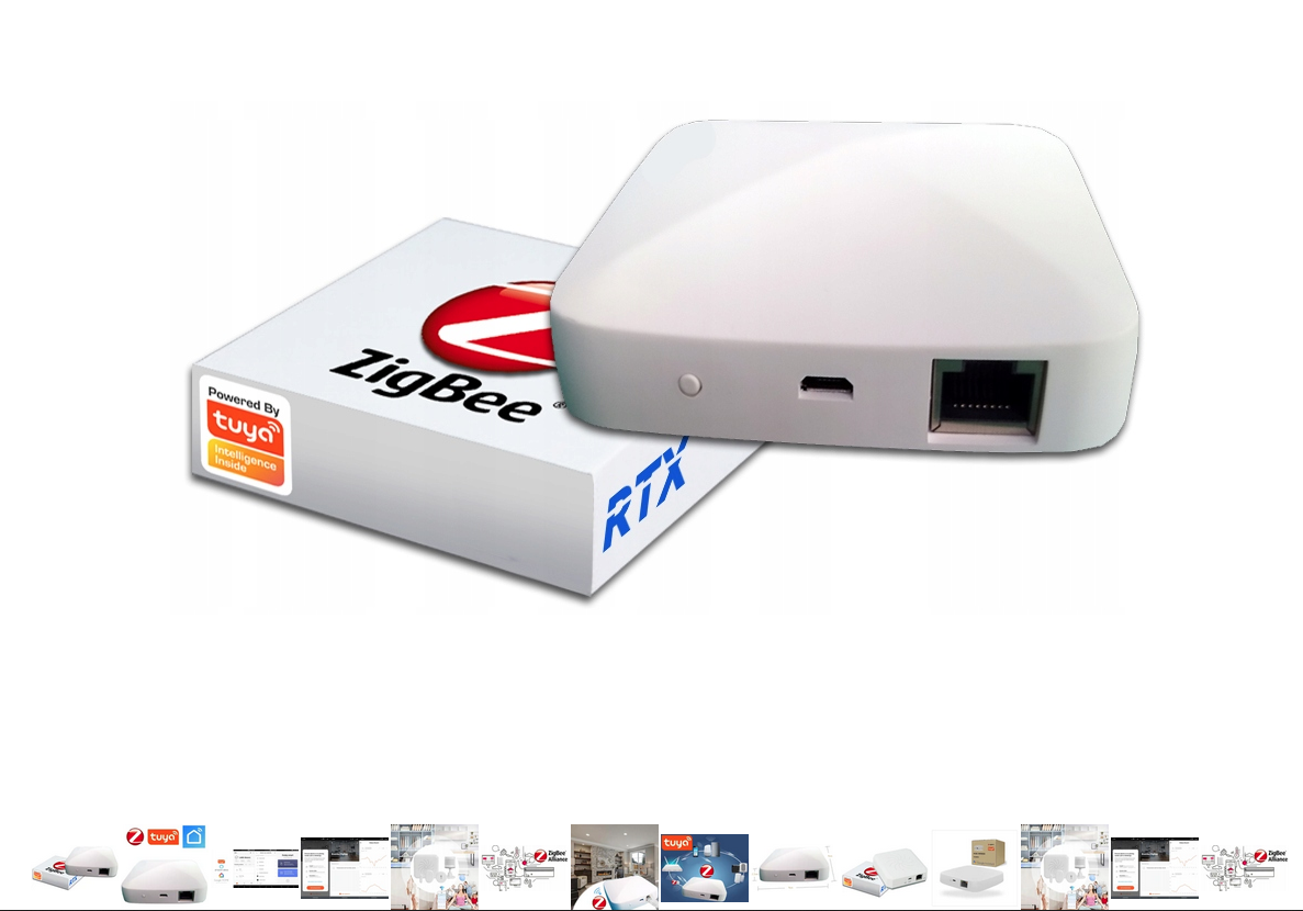

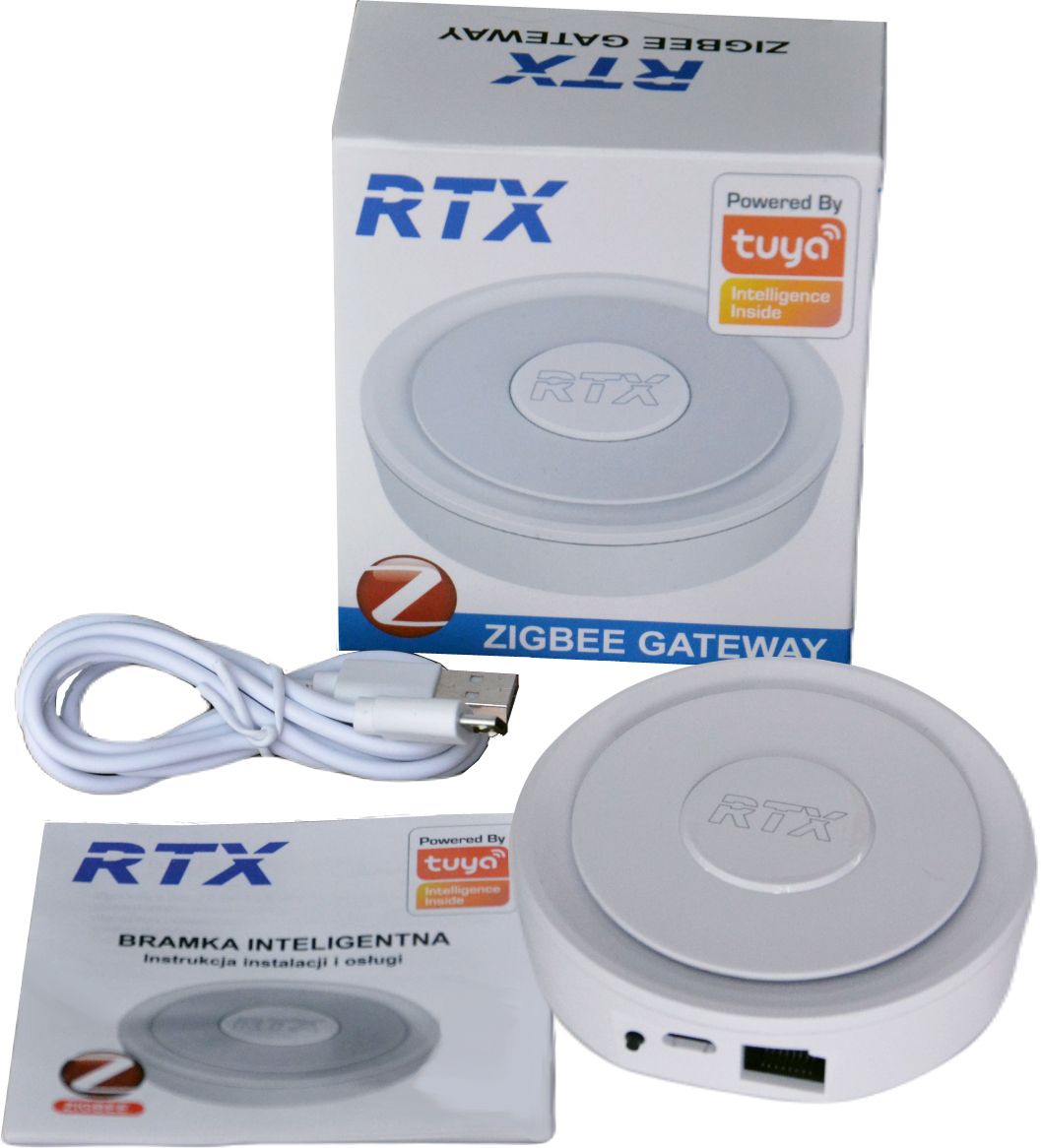

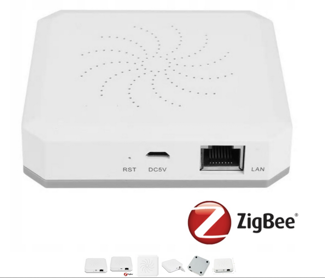

    #6 20505078
    siudkowski
    Posts: 43
    Not so old yet, I'll dig it out. ;) And how, did a fellow author finally buy one of these gates?
    I ask because I have also started my adventure with a simple home automation system. I've been playing around with WiFi bulbs via TUYA for a few months now and it was finally time for ZigBee and some kind of gateway though. :D Well, and above all, the extension modules. A gateway necessarily on cable, I have my eye on two, one of which looks like the one mentioned above.
    1. Control panel RTX ZigBee ZIG-Z1: https://allegro.pl/oferta/centralka-bramka-zigbee-3-0-tuya-smart-life-lan-11264410670
    2. Control panel ID3 SNTZ010: https://allegro.pl/oferta/centrala-sterujaca-bramka-zigbee-3-0-ethernet-tuya-13323089433
    Anyone can comment on this equipment? No difference at all, or is there a difference though?

    @siudkowski I use such a gateway all the time as the photo I inserted above. I don't know of any others.

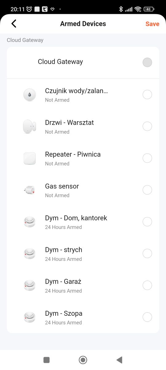

    #14 20614704
    lukawica
    Level 4  
    I have a goal: Zigbee Tuya - what gateway/central for light control, Somfy gates, temperature sensor? .
    Unfortunately I have a problem with setting the PIR as an alarm (Smart Protect).
    Only a few devices are visible (no PIR detectors for example) - I have almost all (except one) devices on Tuya zigbee.
    I can build an alarm using Scenes, but due to the complexity it doesn't work as I would like (e.g. it doesn't work without internet access).
    I am wondering if the gateway is at fault.
    Does anyone have experience of setting up an alarm (PIR detector)?
    What kind of gateway does it use?
    Does it work without internet?
    I have the gateway, siren and zigbee repeaters hooked up to the UPS, so I'm keen for this to work without internet.
