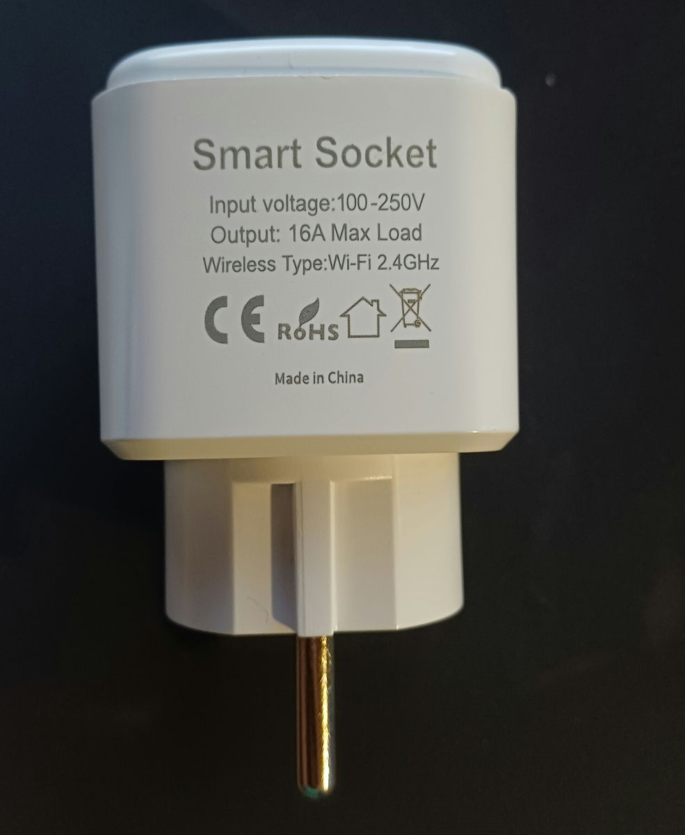

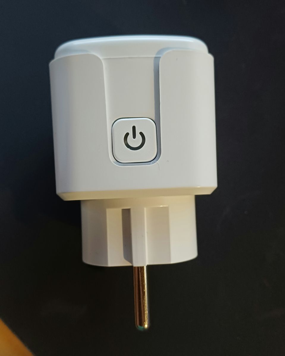

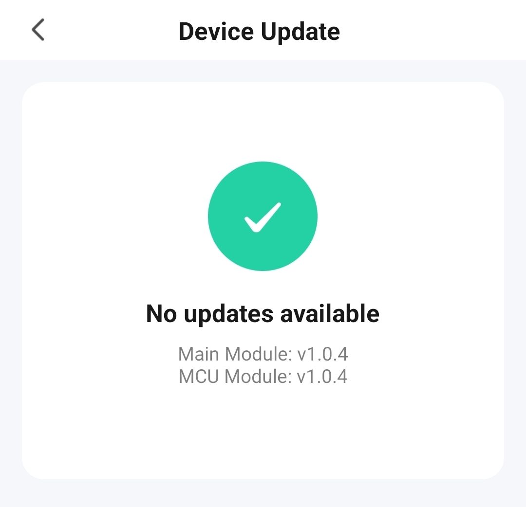

    A few weeks ago, I bought this set of unidentified Tuya smart plugs. I'd like to use Tuya Cloud Cutter to install OpenBeken, but I have no idea about the chipset, and, being a novice, I'm not too keen on opening them up. Here are some photos and the link where I bought them:
    https://www.amazon.fr/dp/B0F2F77R89?ref_=pe_151259331_1319653081_t_fed_asin_title&th=1
    I need help installing OpenBeken on a set of Tuya smart plugs
    I need help installing OpenBeken on a set of Tuya smart plugs I need help installing OpenBeken on a set of Tuya smart plugs I need help installing OpenBeken on a set of Tuya smart plugs
    “Device Update” screen with green check mark and the message “No updates available”.
    Thank you for your help

    Hey, what's the device MAC when paired with WiFi? Would you be able to open one? Usually soldering method is more reliable. Many devices are patched these days.

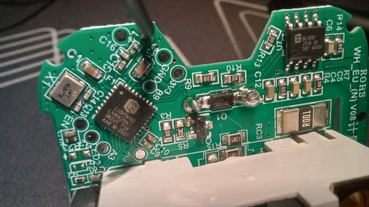

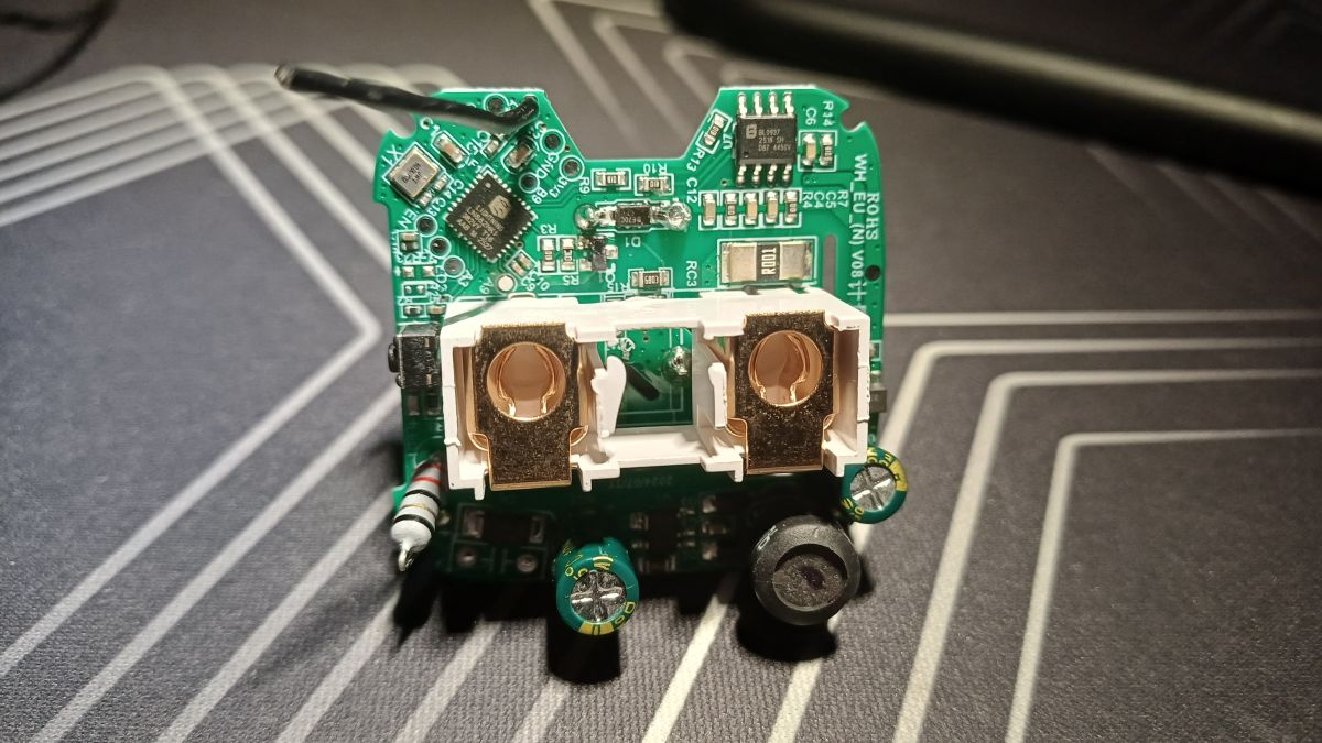

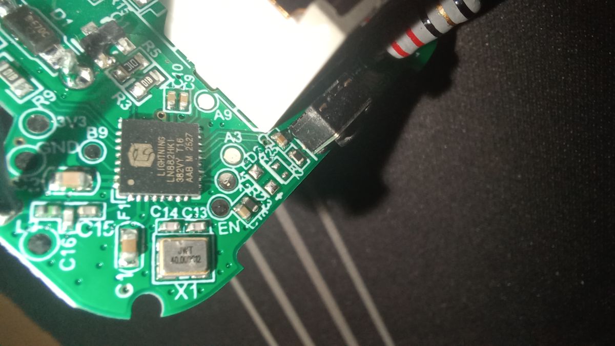

  • #4 21890140
    Kior_

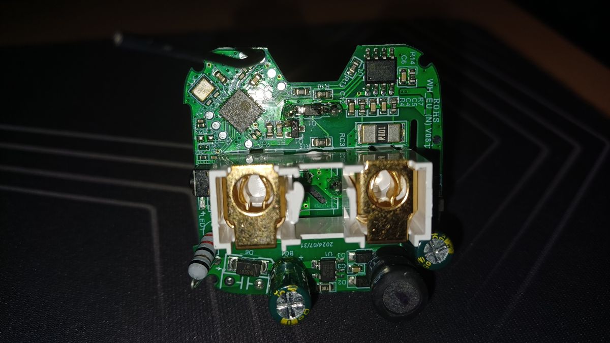

    I took apart a plug and I could see that the chip is an LN882H. Here are some photos.
    I need help installing OpenBeken on a set of Tuya smart plugs I need help installing OpenBeken on a set of Tuya smart plugs I need help installing OpenBeken on a set of Tuya smart plugs Close-up of a green PCB with an LSM9DS1 chip and a black probe touching solder pads.

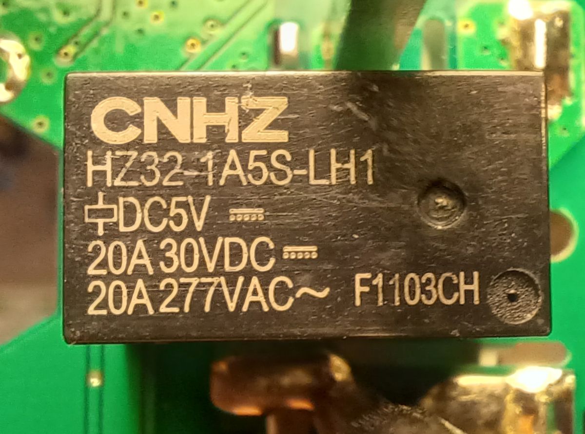

  • #6 21890534
    Posts: 14770
    Rate: 12913

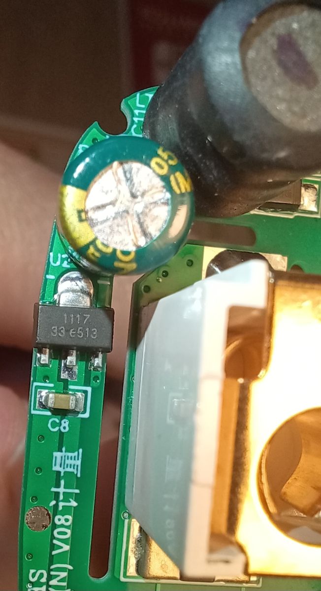

    Btw, out of curiosity, what relay model is there? I wonder if it's 3.3V relay. Is there AMS1117-3.3V on the board?
  • #7 21890571
    Kior_
    >>21890534
    The relay appears to be 5 V. I think I've found an AMS1117 on the side.
    It's definitely not flashable with Tuya Cloud Cutter? No update planned?
    Thank you for your help.
  • #8 21892986
    Posts: 14770
    Rate: 12913
    Cloudcutter does not work for LN882H I think.
    Have you managed to get 2 MB backup of your plug?
  • #9 21893738
    Posts: 5220
    Help: 449
    Rate: 918
    yes, won't work for LN882H. There is something else in the works though for TuyaOS3 devices built with certain builds of the SDK.
