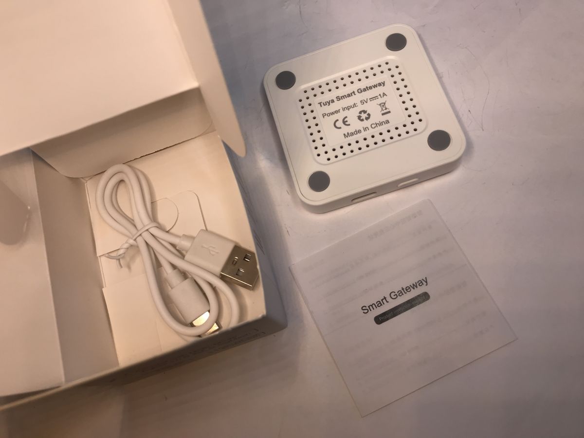

    Extract:
    Box containing the Tuya Smart Gateway, USB cable, and user manual. .

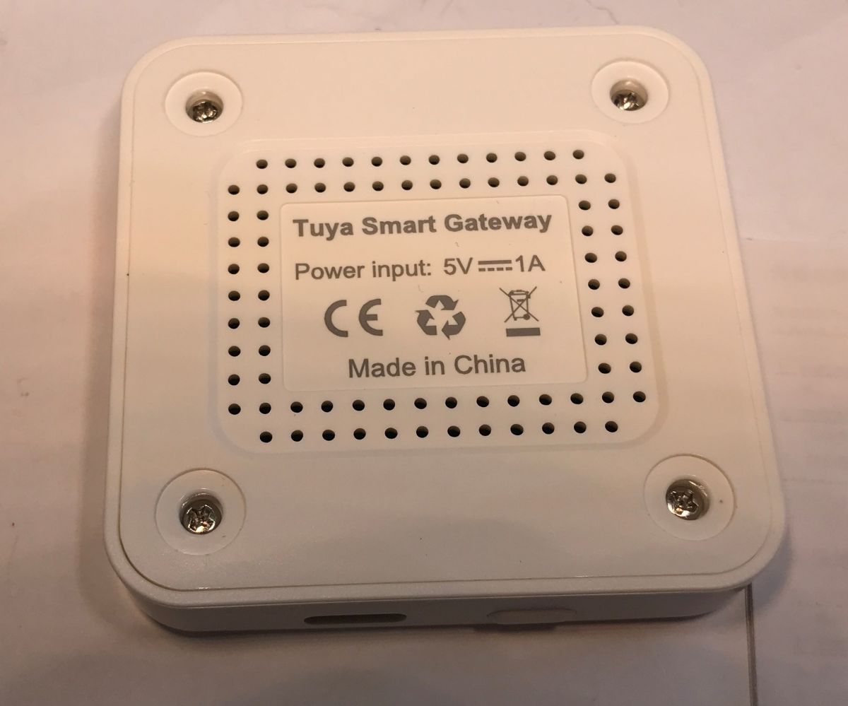

    White Tuya Smart Gateway with ventilation holes and power information. .
    A USB cable with a type C connector is included. However, there is no power supply - we need to have our own with a current capacity of at least 1A.
    It's time to plug in the power supply and get the gateway up and running.

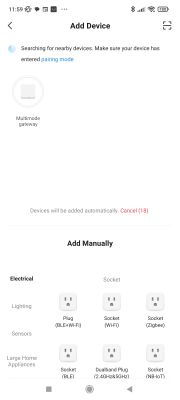

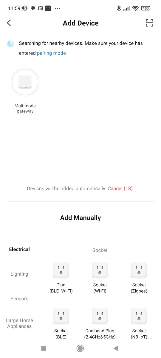

    A button on the case is pressed. In the Tuya app, you don't even have to select the device type, the app finds the gateway itself straight away:
    Screen of the Tuya app showing device addition with multimode gateway. .

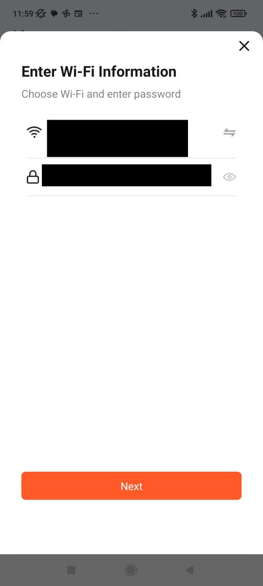

    We enter the details of our WiFi:
    App screen prompting for Wi-Fi information. .

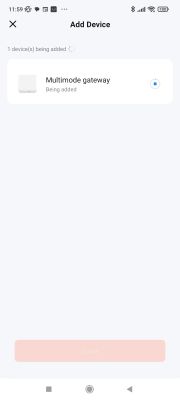

    We wait a moment:
    App screen showing the addition of a multimode gateway. We wait for a moment.

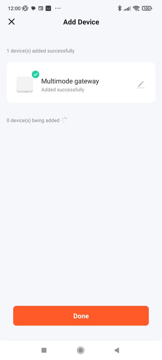

    Screenshot from app showing Multimode gateway added. .
    Linked.

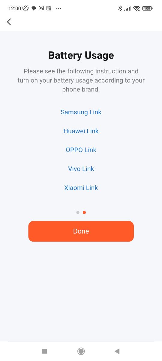

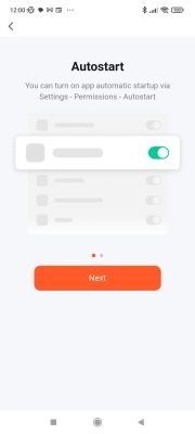

    The app is bothering us about notifications, but this is hardly relevant now:
    Tuya app screen with autostart option and enabled toggle switch. .
    Screenshot of an app with instructions about battery usage. .

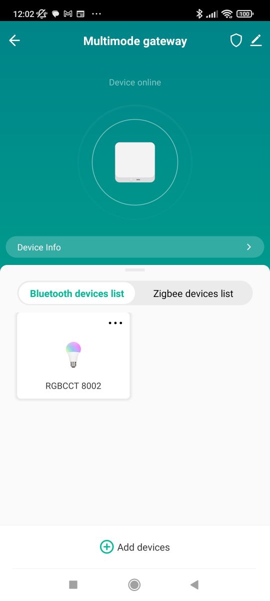

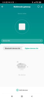

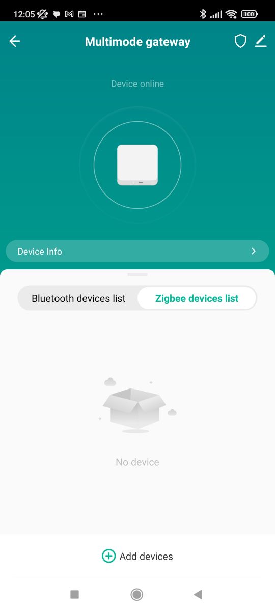

    After a while we are already in the gate. Interestingly, the light I had paired via Bluetooth (but unplugged) already appeared by itself at the gateway. The Tuya app remembers it...
    App screen with multimode gateway online and Bluetooth devices list. .

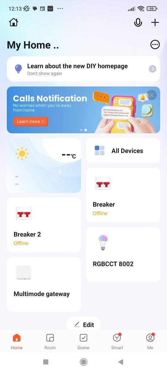

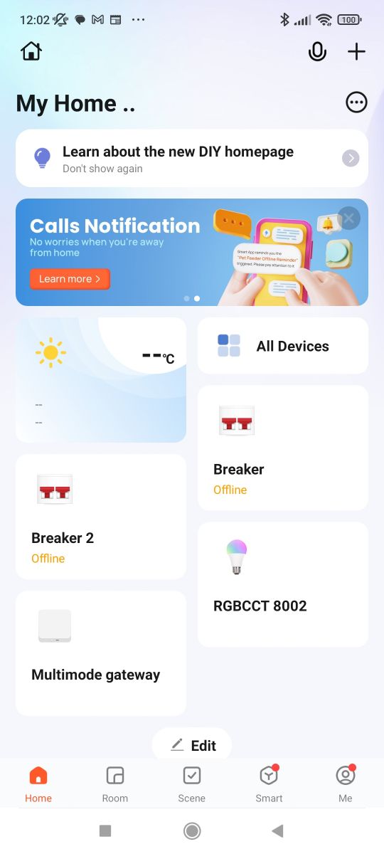

    Now I have her on the main panel and on the gateway at the same time:
    Tuya app screen showing Bluetooth device connections. .

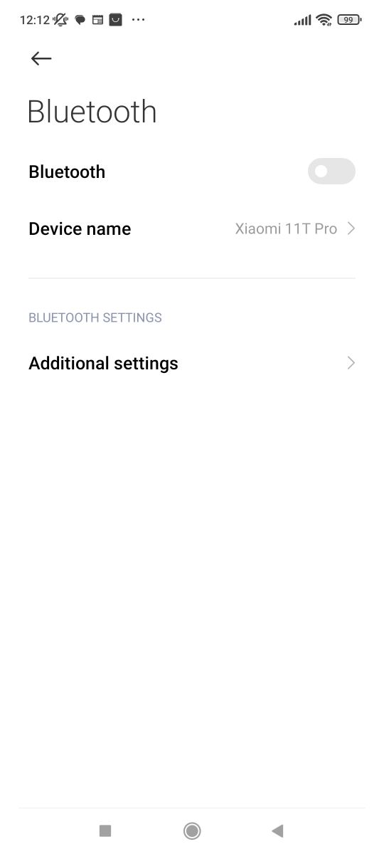

    Just to be sure, I turned off Bluetooth:
    Bluetooth settings on Xiaomi 11T Pro phone .

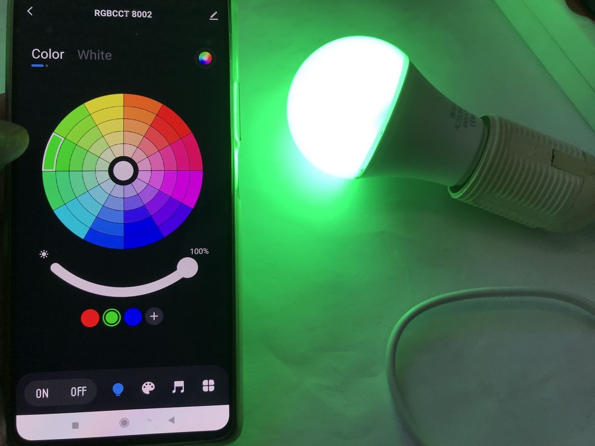

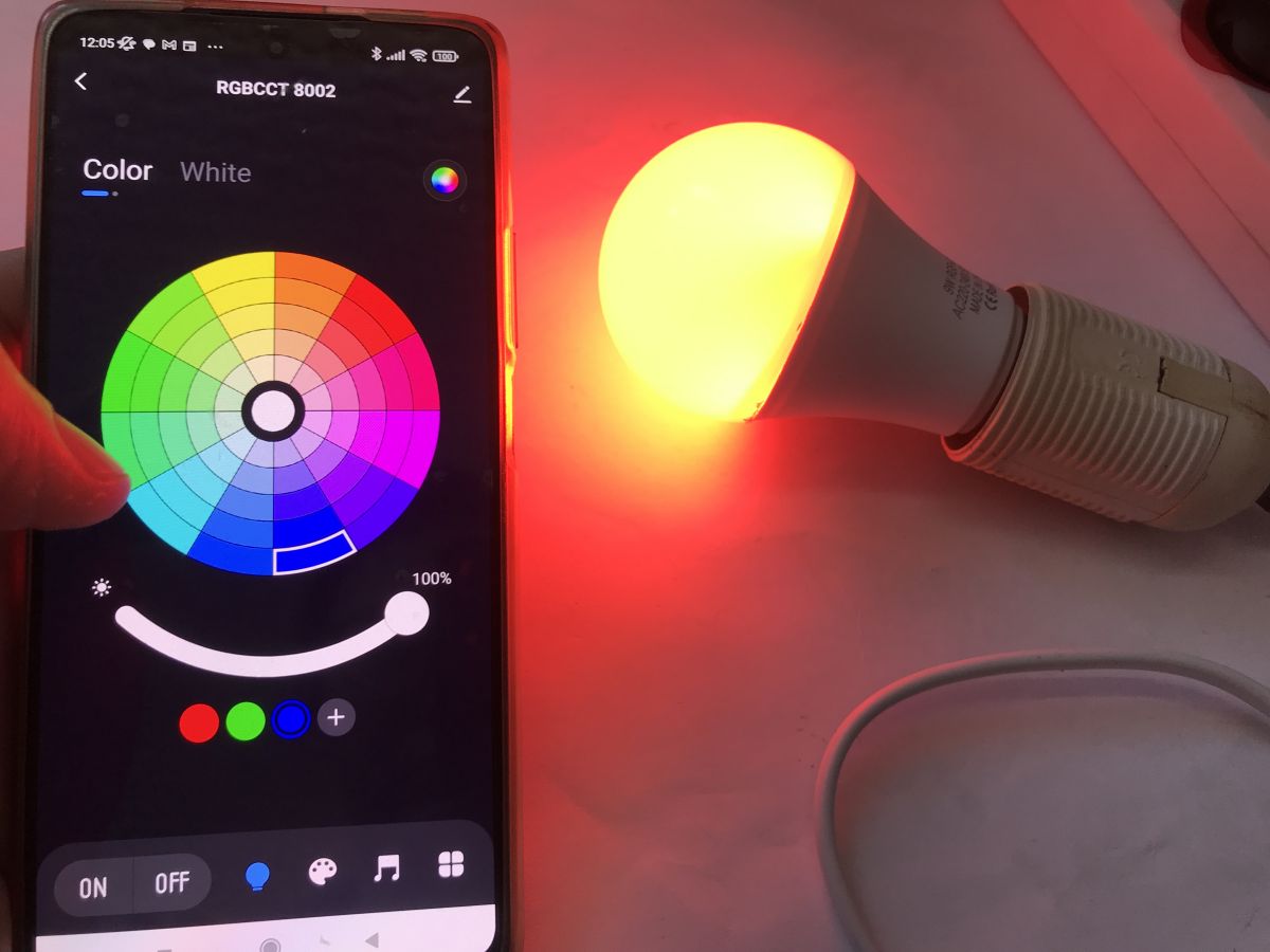

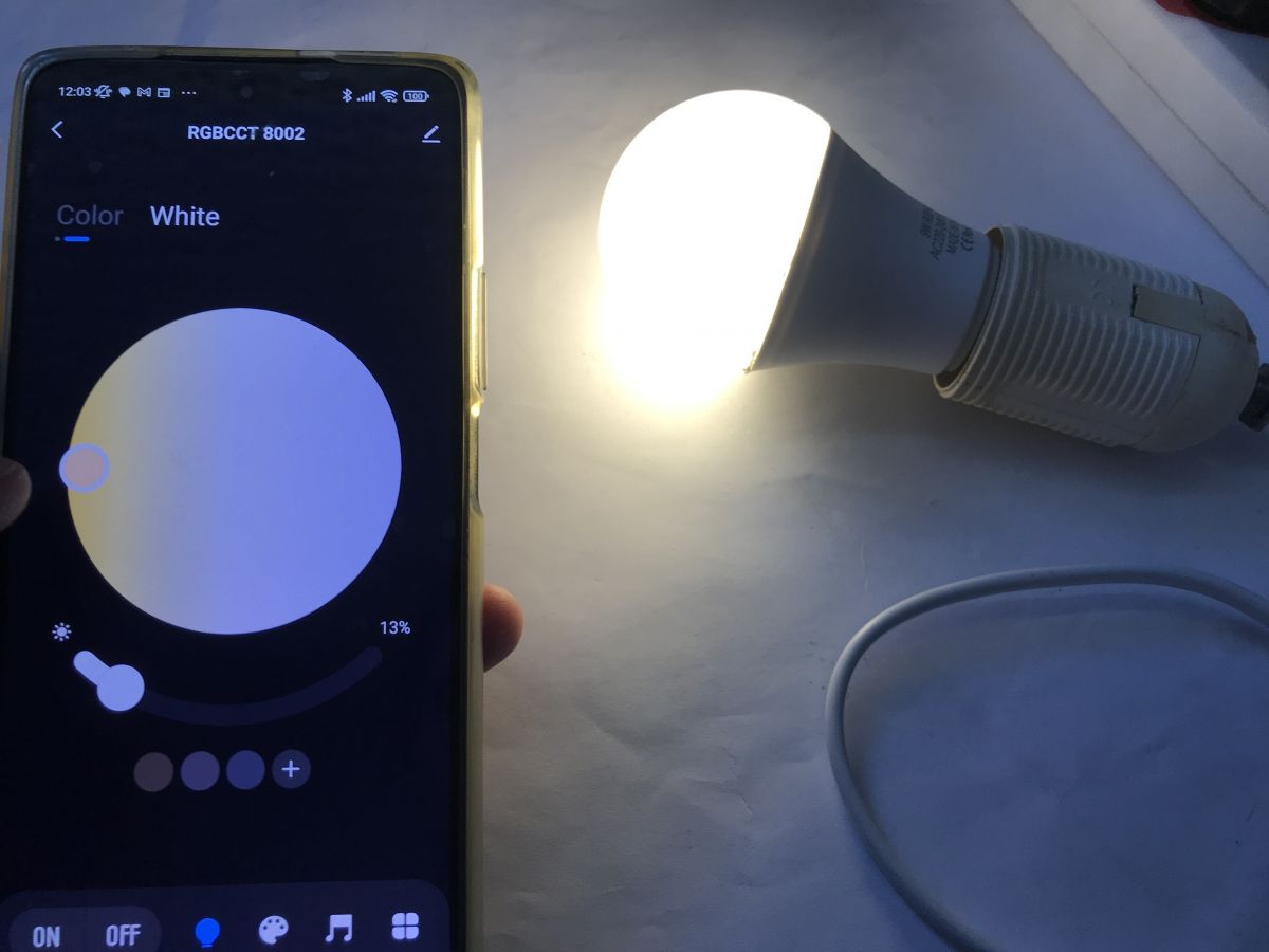

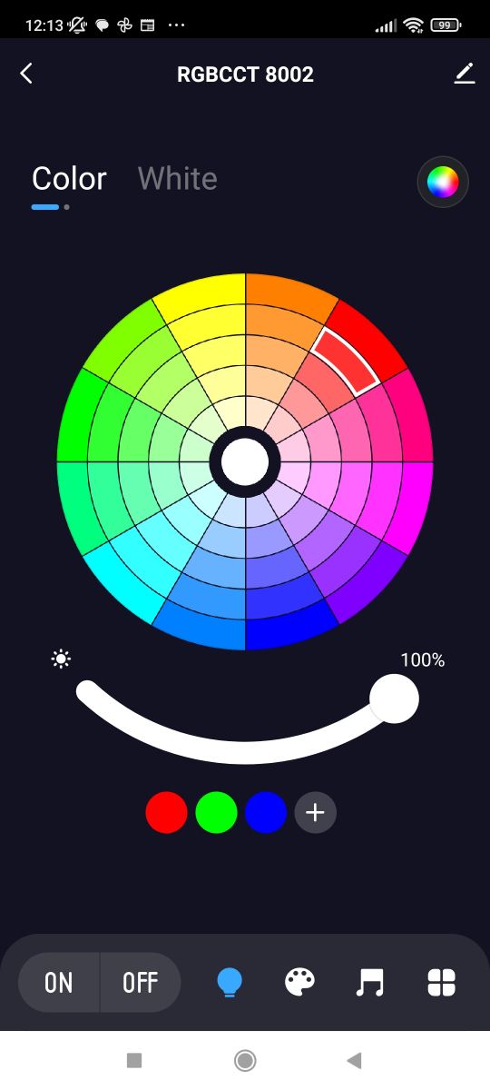

    Time to test the controls:
    Tuya app interface showing connected devices. .
    App screen for controlling a color LED lamp. .
    Sometimes the light does not respond immediately, but it is fine, it works:
    Tuya Bluetooth LED color bulb controlled via mobile app. .
    Smartphone with Tuya app controlling a Tuya Bluetooth LED bulb. .
    Colorful Tuya LED bulb controlled by a smartphone app. .
    Tuya app on phone next to a glowing LED lamp .

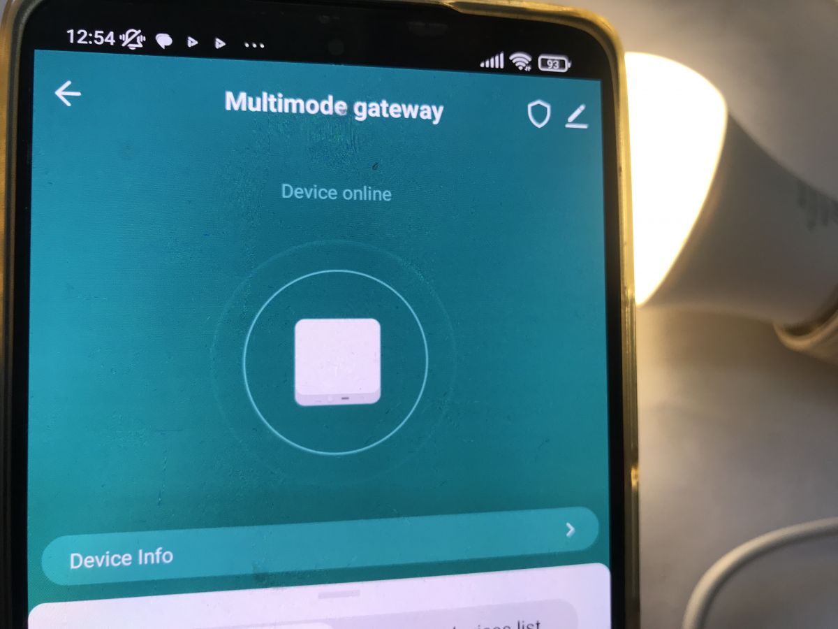

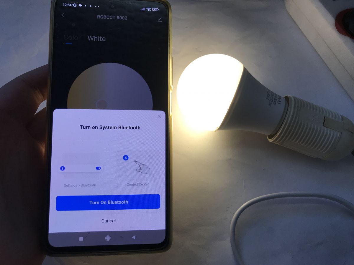

    Out of curiosity, I de-energised the gate while controlling the lamp:
    Smartphone pairing a Bluetooth device with Tuya app next to a LED bulb. .
    Close-up of a phone with the Tuya app showing a multimode gateway. .
    The light has lost connection, the gateway appears as 'offline' and the phone asks for BT to be switched on.

    In addition, there is also the option to add from within the gateway itself:
    Screenshot of the Tuya multimode gateway application screen. .

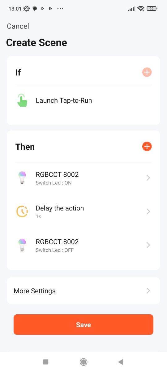

    Another issue is Tuya's scenes/automations. If we pair a Bluetooth light with a gateway, will it work in scenes?
    I have prepared a simple 'tap to run' effect is called blink, which simply turns the light on, waits a second and turns it off:
    Phone app screen for creating a scene. .
    Scene creation screen in the Tuya app with the name blink entered. .
    We test:
    Works properly.
