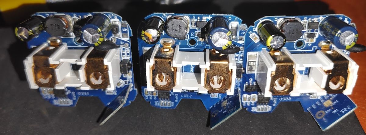

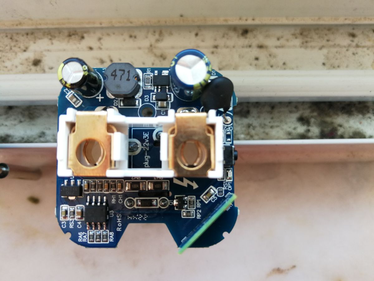

    I have no idea what is broken.
    1. when plugged in the led does not light up blue, but when you press the button you can hear some snapping inside.
    2.Quite possibly dead it doesn't give any sign. Nothing happens when you press the button
    3. apparently works but only for a few seconds, a minute. Can switch off on its own. Resetting the settings did not help.
    4. probably died after six months and was thrown away.
    EDIT: by the way, I am looking for some replacements for the ones that died. Also Chinese with a reasonably accurate energy meter. Is there any recommended brand?
    EDIT2: I took it apart, the method with the hairdryer went quite smoothly although one plug body was mashed. There appears to be an obviously swollen capacitor in 2. Replacement will bring such a plug back to life or would anything else need to be done?

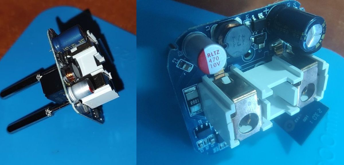

    There is a good chance that the plug will work properly after replacing the swollen capacitor.
  • Capacitor replacement only revived some sockets
    #7 21594788
    Michaelred
    Posts: 6
    2 of the sockets were able to be brought back to life. The 3 where the capacitor was not deflated unfortunately continue to have the same symptoms as before the capacitor replacement. It is detected and flashes pairing, but won't add itself to the program. It's like it doesn't connect to the network and sometimes it won't turn on at all. These capacitors some small came (smaller than the original ones) I think I read something wrong in the description.... but so far they work :) I wonder how long it will live.
    EDIT: 1 resuscitated socket has just died. it won't connect to the network, I can't re-pair it despite the led flashing fast.
