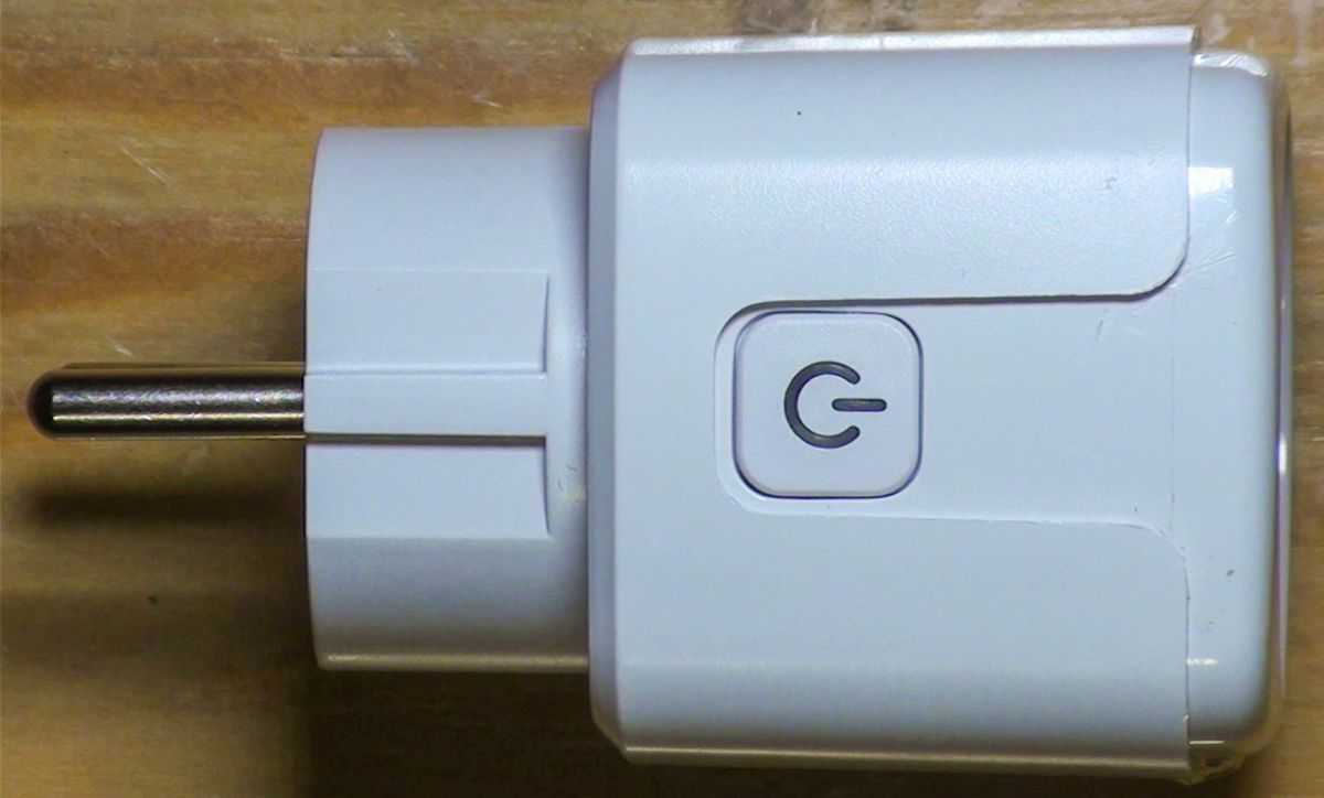

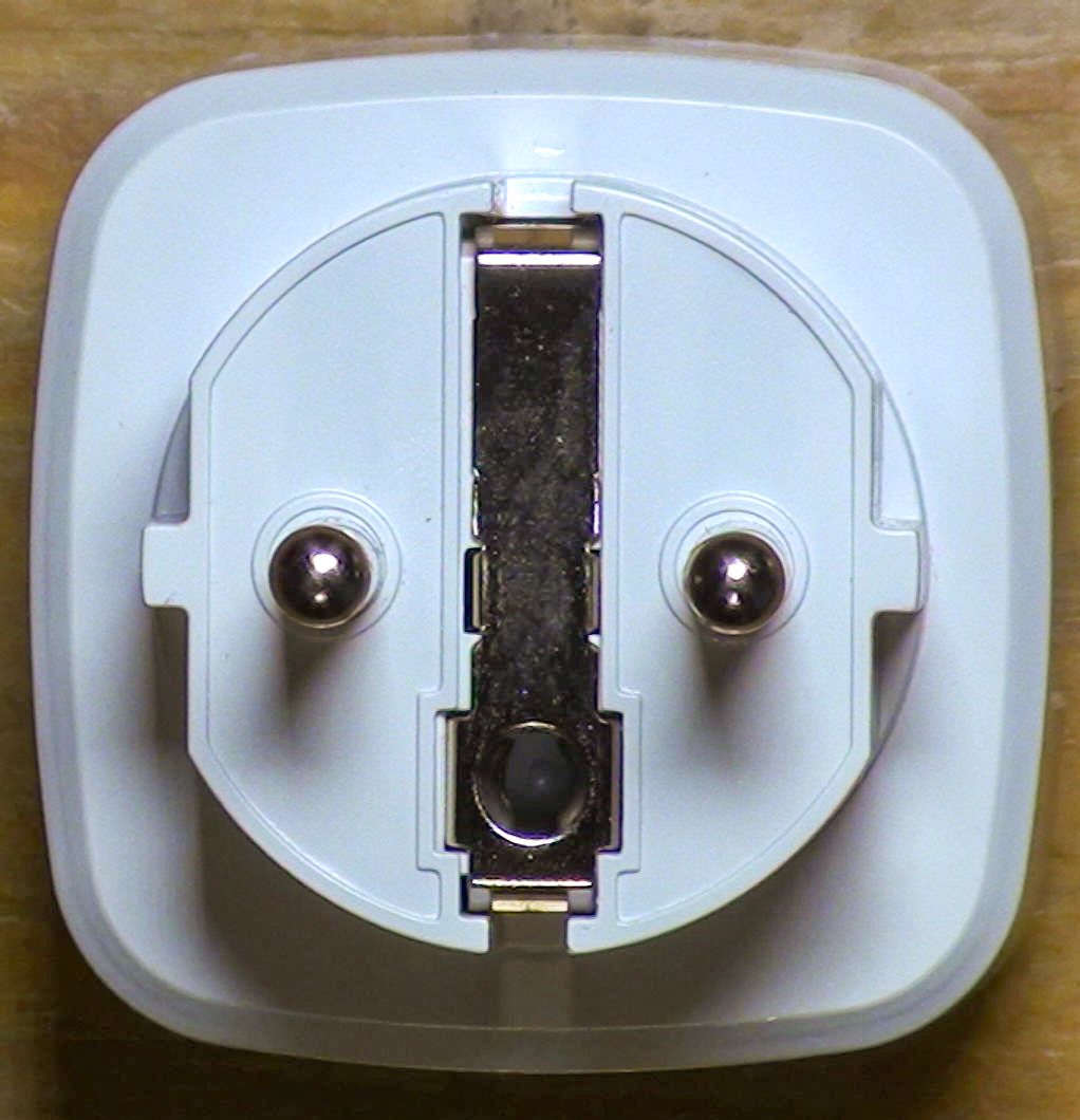

    A couple of more pics I took:
    Top view of a Tuya smart plug showing its electrical pins.Tuya smart plug with a power button on the side.

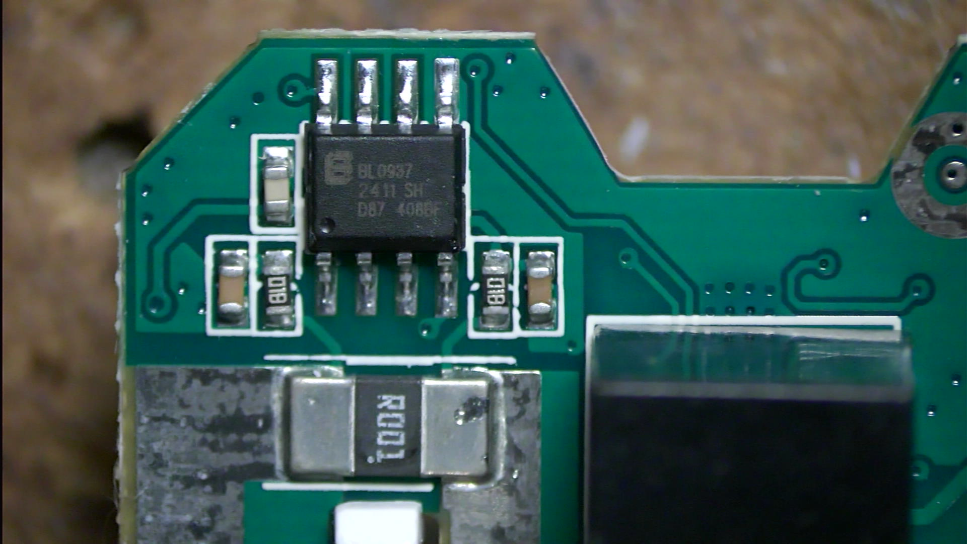

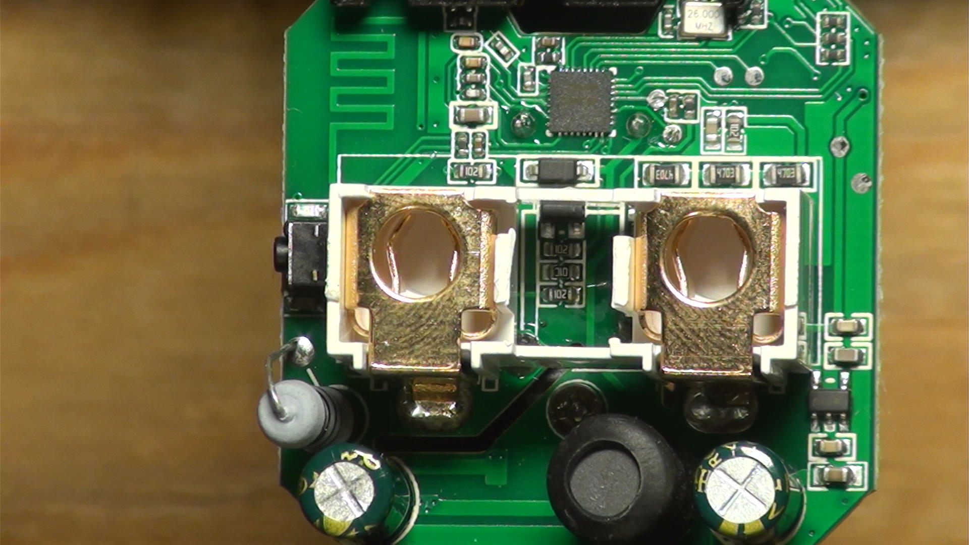

    On the insides you can see that contrary to other similar plugs, this one does not have a module, just a simple chip:
    Interior of a smart plug with BK7231N chip and electronic components. Close-up of a circuit board with a BL0937 chip.
