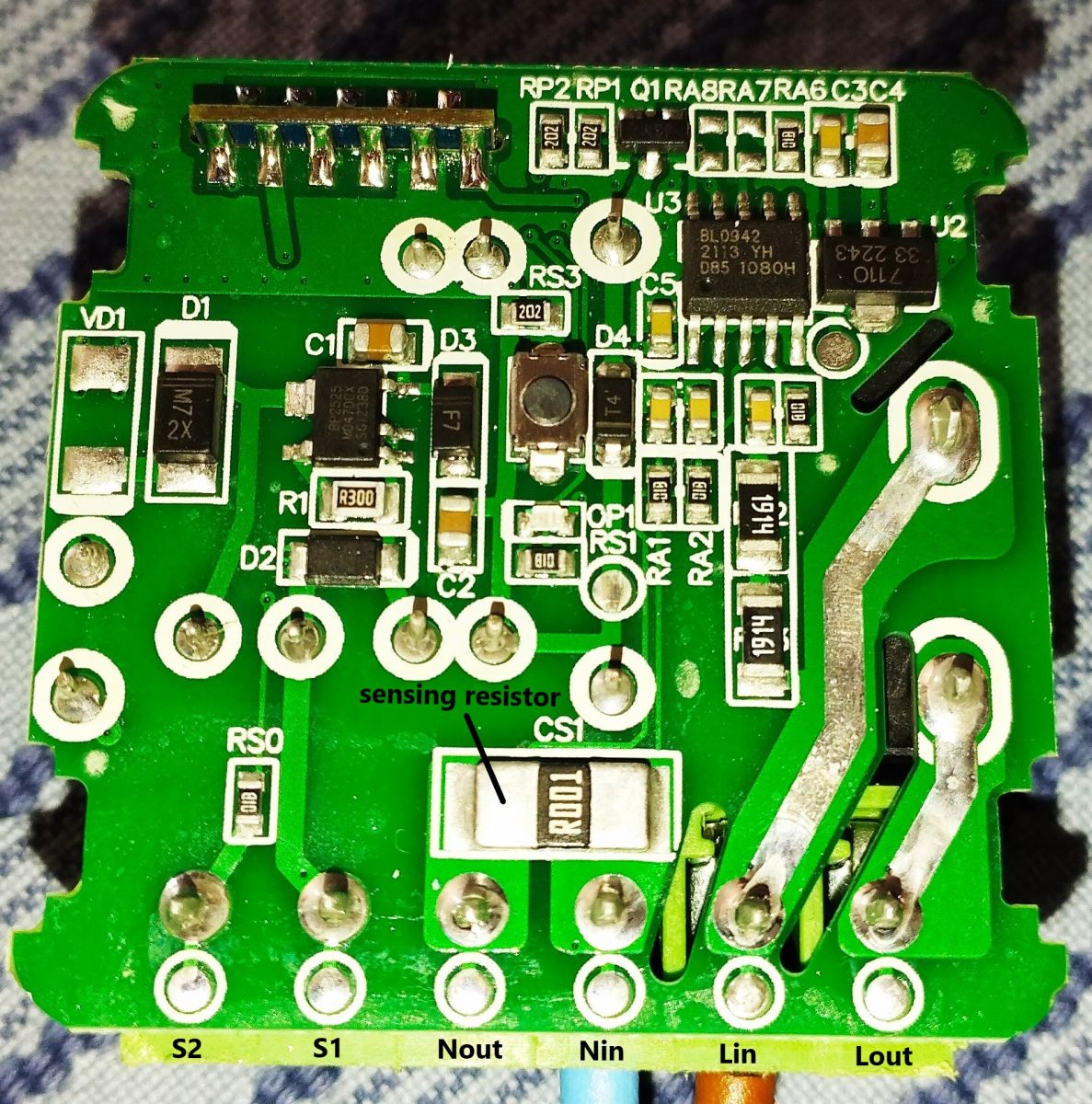

  • This is a short teardown of the Aubess Mini Smart Switch 16A which is based on BK7231N and it uses a custom PCB ,so no Tuya module in there.
    Basic Informations:
    Brand: Aubess
    Model: Aubess Mini Smart Switch 16A
    Chip: BK7231N
    Vendor (that's exactly where i bought it): https://www.aliexpress.com/item/1005003631131323.html? <- it's the kind of seller that ask for extra shipping fees,so not really recommend it
    Teardown Photos
    The switch is very easy to open so i wont go into details,but remember,this device it's using high voltage,so make sure it's not connected to the mains.Also ,i took pictures only of the relevant parts.

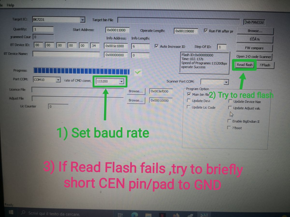

    Wiring: -> Check the attached picture to locate the pins on the PCB
    ( PCB ) GND - > GND ( TTL )
    ( PCB ) TX - > RX ( TTL )
    ( PCB ) RX - > TX ( TTL )
    ( PCB ) CEN/EN -> GND ( PCB ) <- CEN must be short to GND only for a second,in order to boot the chip in flash mode
    Flashing: -> In my case the 3.3v pin was not required at all.
    1) Connect GND,RX and TX to the USB TTL then attach the TTL adapter to the PC.
    2) Open BKwriter 1.60 and set the baudrate (see attached picture)
    3) Try to read the flash (if it fails ,then short CEN to GND for a second then try again) <- this will create a backup of the original firmware
    4) After BKwriter has finished the backup,you can proceed with the OpenBeken firmware flashing ,just follow the guide from https://github.com/openshwprojects/OpenBK7231T_App/blob/main/README.md#flashing-for-bk7231n
    5) After flashing Openbeken you should be able to find the quick configuration (i've sent a PR for that) for this device in ; http://[Device_IP] > Config < Quick Config

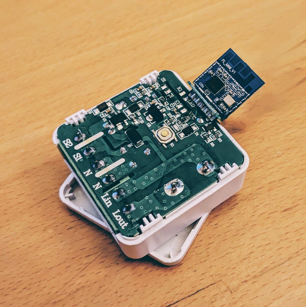

    I bought a bunch of these devices from Aliexpress. They're branded as Aubess but use a different pin configuration than the ones already documented in this thread.
    [BK7231N] Aubess Mini Switch 16A
    The small BK7231N-supporting board seems to be this TCB2S thing from Trolink.
    I managed to flash it using the UART (serial) method (therefore, QIO firmeware variant), following the usual BK7231N UART flashing guides from this forum (uartprogram) on the RX1/TX1 un-soldered pins. Happy to report OpenBK7231T_App QIO firmwares work just fine!
    Pin configuration: P6 is the internal button, P7 is the blue LED, P24 is the internal relay, P26 is the switch/toggle sensing on screw terminals S1 & S2. I'm sending a PR to add this variant.

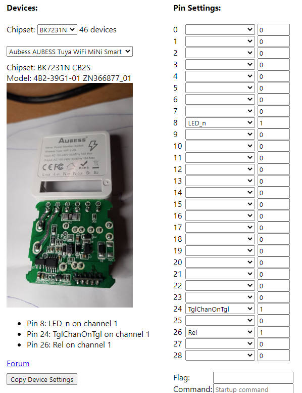

  • #11 20299165
    Posts: 14755
    Rate: 12881

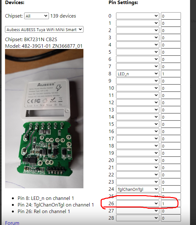

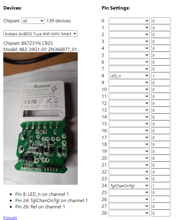

    Why is the Relay not set for pin 26? Is there some issue with the template?
    Please try manually entering Relay for pin 26.
  • Relay likely needs manual pin 26 assignment
    #12 20299209
    ciclopeblu
    Posts: 7
    I did but still nothing, the led go off and on when I click on/off in the web interface, but not the relay.
    I was wondering, if the LED is going on and off according to the commands I give using the web interface, is that telling me that all physical pin connections are good or is the led controlled using a different physical pin than the relay? just asking also because I have concerns about the pin marked as p6 be able to connect properly to the board..
  • Relay likely on a different pin than LED
    #13 20299232
    Posts: 14755
    Rate: 12881
    If LED is going on and off then it means that you don't have configured relay correctly. Maybe relay is on some other pin. Maybe take some HD photos and show us the board, or check where the base of transistor switching on the relay goes? Remember that there will be also a resistor on the way.
    In the device template you shown above, LED is using different pin than relay. LED is on pin 8. So the question is... on which pin is the relay?
    In worst case, you can try setting them one by one and checking if it clicks....
    ALSO.... please remember, if you are powering the device from 3.3V from your own 3.3V supply, then relay might NOT click because relay is powered usually from 5V on the board!!!

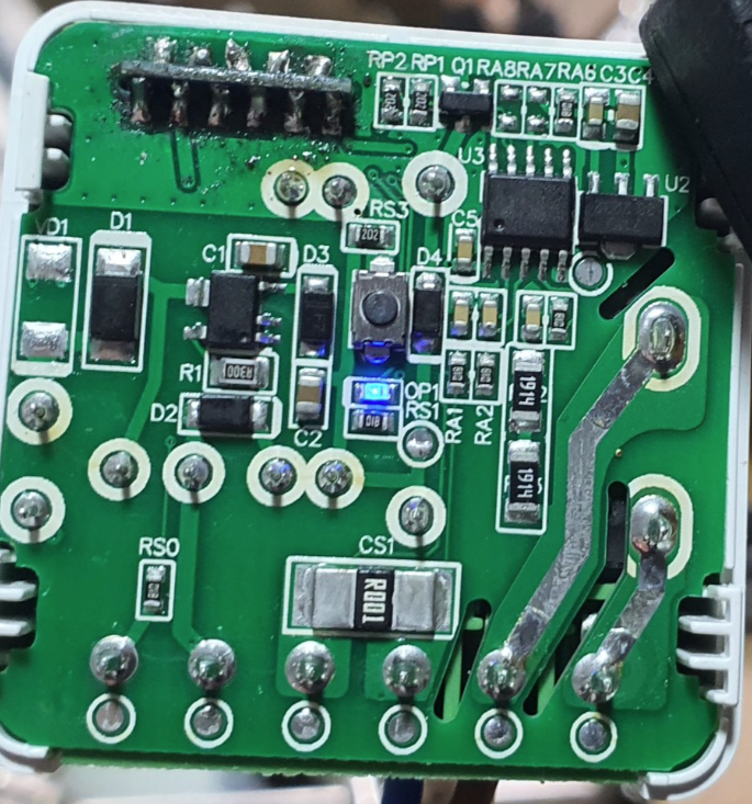

    This is the board:
    It looks pretty similar to the one on the app template.
    I have solded the module back so the volts powering the relay should be ok, I assume?
    Which one is the base of transistor switching?
  • #15 20299333
    Posts: 14755
    Rate: 12881
    U2 is the 3.3V LDO, so Q1 is most likely the transistor.
    Please check where it pins goes, one should go to Relay, and second one should go to WiFi module pin - check which pin.
  • #16 20299375
    ciclopeblu
    Posts: 7
    From Q1 :
    - middle pin is going to the switch (it can be seen also from the picture)
    - Left pin is going to GND
    - Right PIN doesn't go straing to any pin in the module, it goes to rp2 and then P26
  • #17 20299468
    Posts: 14755
    Rate: 12881

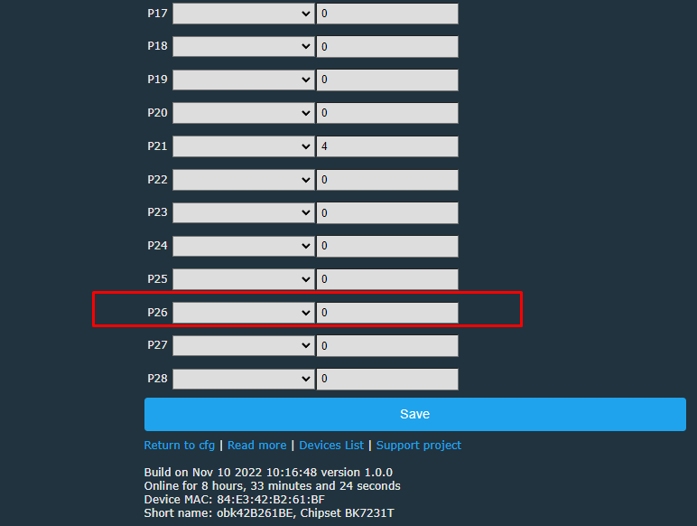

    Can you go to Options, Configure Module and show what do you have here:
    Post a screenshot
  • Template needs pin 26 added for BK7231N
    #18 20299481
    ciclopeblu
    Posts: 7
    Mate,
    Apologies, just replaced the board with another one and everything isa working fine! it was a defective board, the wifi module is perfect.
    The template needs to ne updated though adding the pin26.

  • LED stays dimmed after flashing Aubess switch
    #20 20386301
    jorgemsp
    Hi everyone,
    I've been exploring the flashing of those devices and the its operation with OpenBK7231N.
    I'm noob on this field so I apolagize in advance for any basic question I can place.
    I've used tuya-cloudcutter and OpenBK7231N to flash my AUBESS mini with success and I'm currently able to switch the relay though local network.
    What I've noticed is that the relay works fine but the LED is allways ON in what it seems an intermediate state (slightly dimmed). I've configured exactly like in the picture shared in one of the posts of this thread.
    Any idea how could I solve this problem? (not really important, but it would help me to better understand the device)
    Additionally, this device has two versions: w/power metering or w/o power metering.
    Any idea on how to configure/enable the power metering?
    Thanks in advance for any assistance!
  • Suggesting pin-by-pin LED and metering chip identification
    #21 20386394
    Posts: 14755
    Rate: 12881
    What kind of the device?
    LED could be on another pin, manufacturers tends to change it from time to time.
    Maybe you should try looking at PCB tracks or just guessing each pin one by one - if that's a WB2S/CB2S device, there is no many options. Just set each pin role to LED and mark as channel 2 and try toggling and see which pin makes the LED toggle.
    What kind of power metering device is inside? BL0937? BL0942?
  • BL0942 metering chip identified on board
    #22 20387650
    jorgemsp
    I was going to start changing pins and noticed that actually it was my mistake... I've assigned to P9 instead of P8...
    It is the BL0942:
    The BL0942 datasheet confirms that the IC incorporates two ADC's for current measurement (pins 2,3 of the IC - differential, coming from the sensing resistor) and votage (pin 4 of the IC from the resistor divider on the right part of the picture).
    Any tips on how should I iterate to find those measurements, if possible? (Energy and/or power should also be available though estimation)

    khafif wrote:

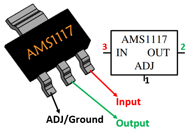

    Please can you mark on the above screenshots where do I have to connect the 3.3v on the WiFi board.
    Which device and which module?
    khafif wrote:
    I am not familiar with the terminology of LDO and where it is location.
    5V goes in, 3.3V goes out.

2. Which UART pins and supply do I need for flashing?
Solder to GND, TX, RX, and optional 3.3 V pads; short CEN to GND for one second if auto-boot fails. Supply only 3.3 V from the USB-TTL adapter—never mains [Elektroda, Pretoriano, #20145042; p.kaczmarek2, #20402821].
3. What tools give the highest flash success rate?
Use bk7231tools or hid_download_py; they retry and verify CRC. BKWriter 1.60 is “always discouraged, as it is very unstable” [Elektroda, kuba2k2, post #20278416]
4. How do I flash via UART in three steps?
  1. Connect GND, RX↔TX, TX↔RX, 3.3 V.
  2. Run uartprogram backup.bin 0x200000.
  3. Write OpenBeken QIO image, then reboot. Flash time is ~30 s at 115 kbit/s [Elektroda, khafif, post #20406685]
6. Relay clicks but external switch needs a double flip—how to fix?
Set the S1/S2 pin role to ToggleChannelOnToggle; this makes a bistable wall switch act as expected [Elektroda, p.kaczmarek2, post #20479272]
7. Relay stays silent after flashing—what checks help?
  1. Confirm the relay’s transistor base traces to the pin you set.
  2. Ensure board gets 5 V for the relay coil; 3.3 V supply alone will not click it [Elektroda, p.kaczmarek2, post #20299232]
