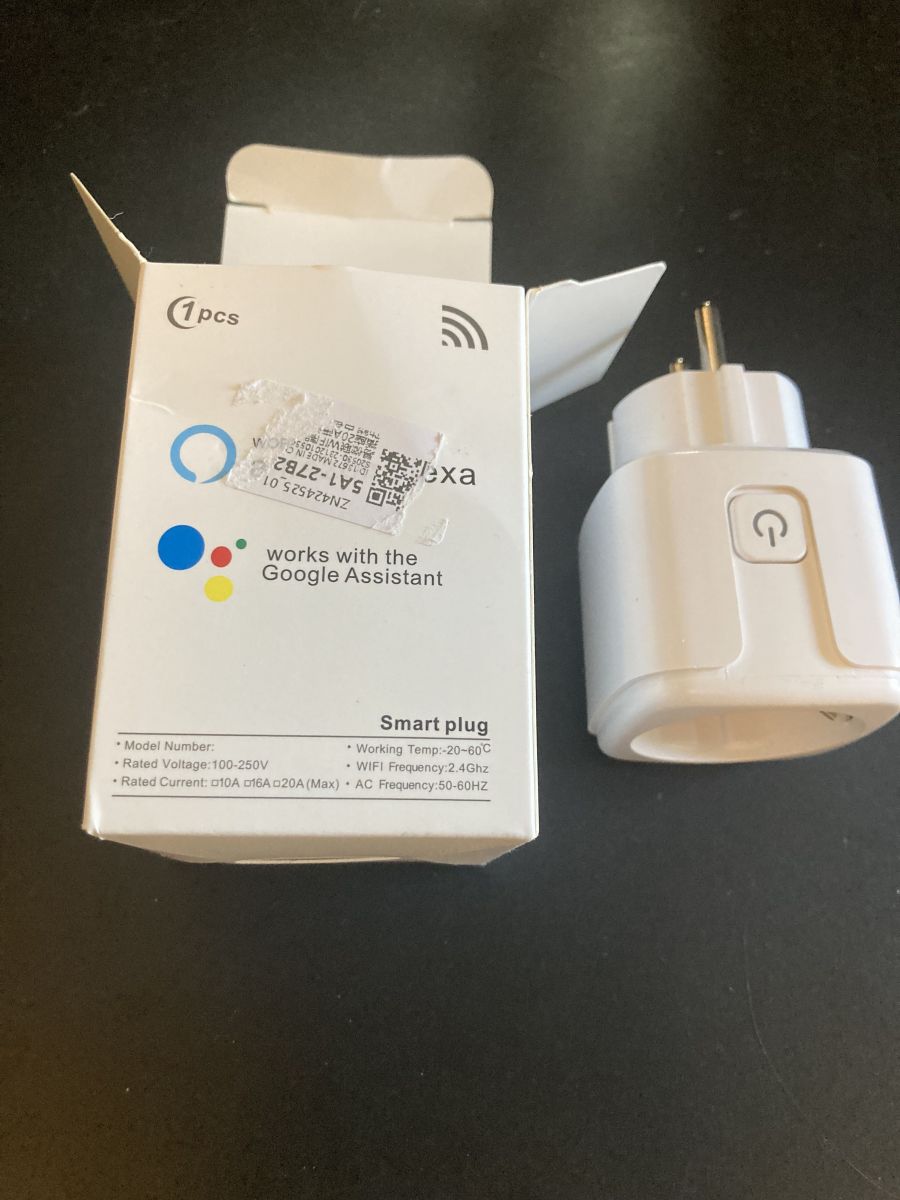

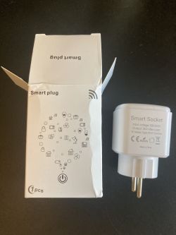

  • I bought a Smart Plug from Aliexpress: https://fr.aliexpress.com/item/1005005790622741
    They are named Aubess on the website, but not on the packaging or on the socket.
    Smart plug and its packaging from AliExpress. Smart plug and its packaging on a dark surface.

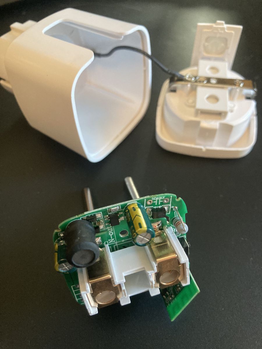

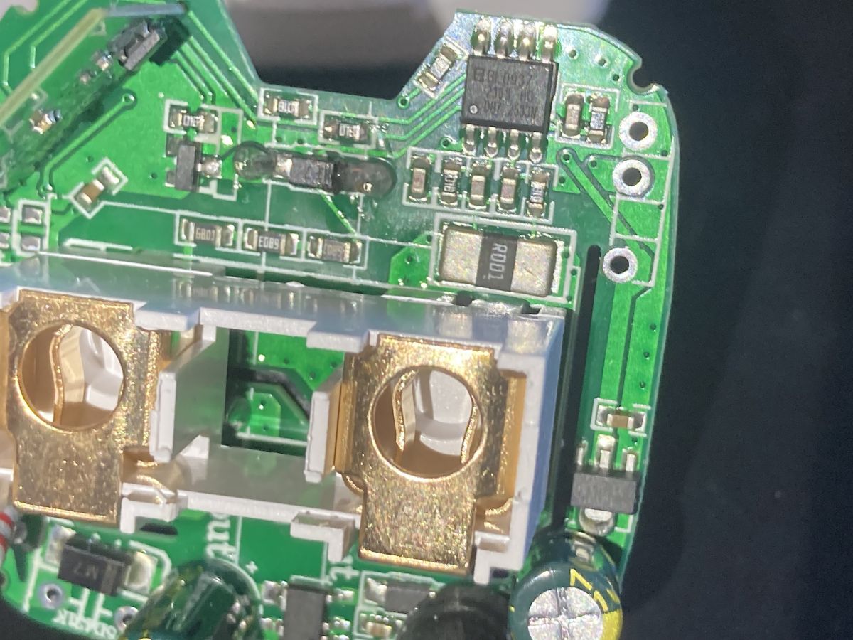

    Easy to open with pliers.
    Dismantled Smart Plug with visible circuit board.

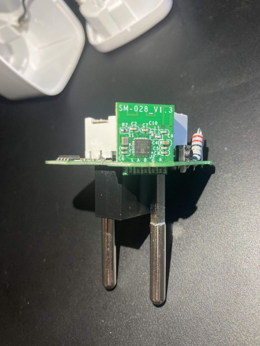

    Contains an SM-028_V1.3 with a BL602L02 chip.
    Close-up of SM-028_V1.3 circuit board in a smart plug with two metal prongs.
    And BL0937.
    Close-up of the interior of a smart plug showing the circuit board and electronic components.
    I soldered cables in the back of the SM-028_V1.3 between:
    SM-028_V1.3 RX -> FTDI232L TX
    SM-028_V1.3 TX -> FTDI232L RX
    SM-028_V1.3 3V3 -> FTDI232L VCC (on 3V3)
    SM-028_V1.3 GND -> FTDI232L GND
    SM-028_V1.3 BT -> to a 10Kohm to VCC

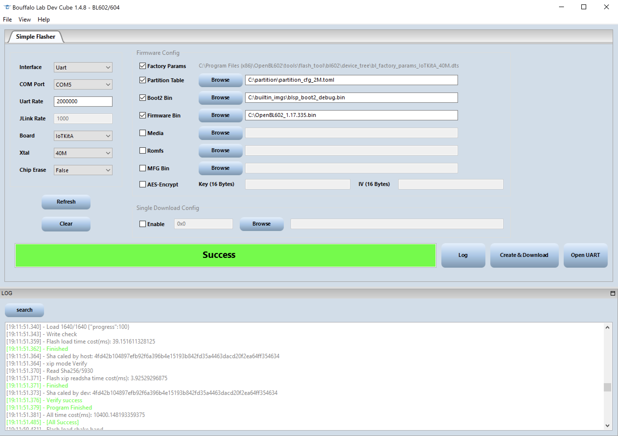

    And flashed it with Bouffalo Lab Dev Cube
    Firmware flashing interface of Bouffalo Lab Dev Cube software

    I checked the circuit wiring on the PCB between BL0937 and BL602:
    BL0937 CF1 -> BL602 GPIO3
    BL0937 CF -> BL602 GPIO14
    BL0937 SEL -> BL602 GPIO21
    LED -> BL602 GPIO20
    Relay -> BL602 GPIO2
    Button -> BL602 GPIO17
    (don't bother yet to check the LED and button) => TODO

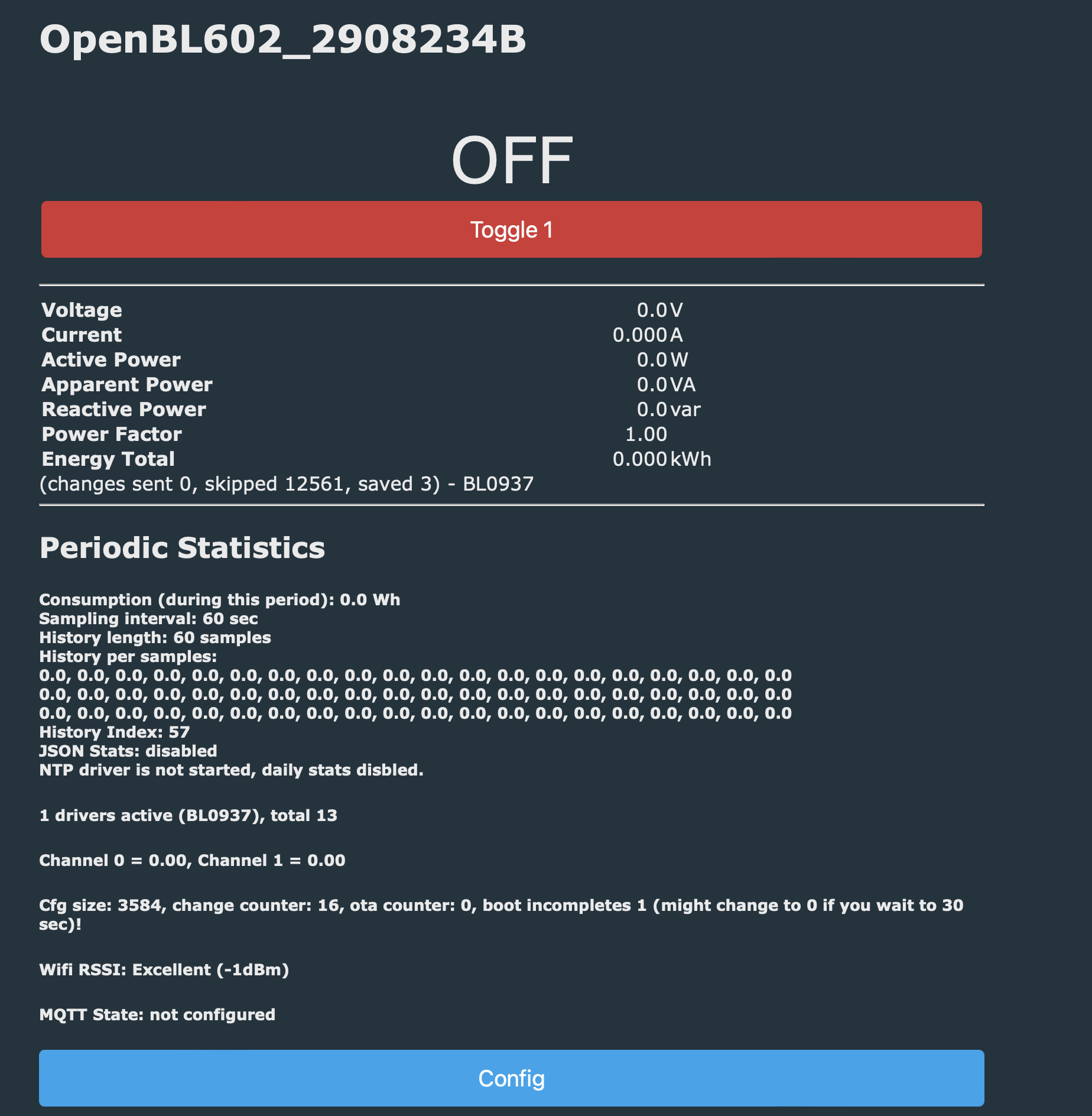

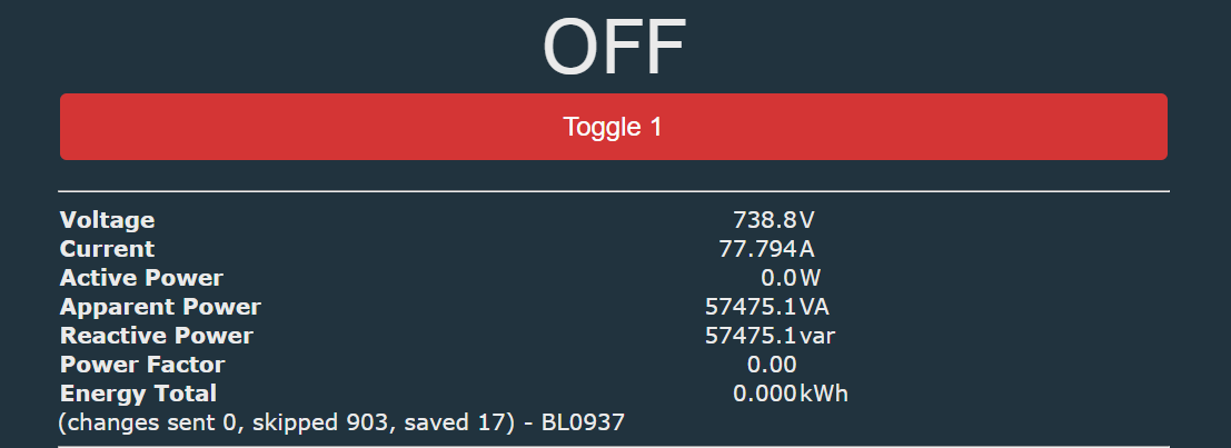

    But once configured, nothing showed up in the Web app (all values are zero)
    Screenshot of OpenBL602 user interface displaying power data.

    Sadly the interrupt counter for BL0937 is still missing. I think there is an unfinished version:

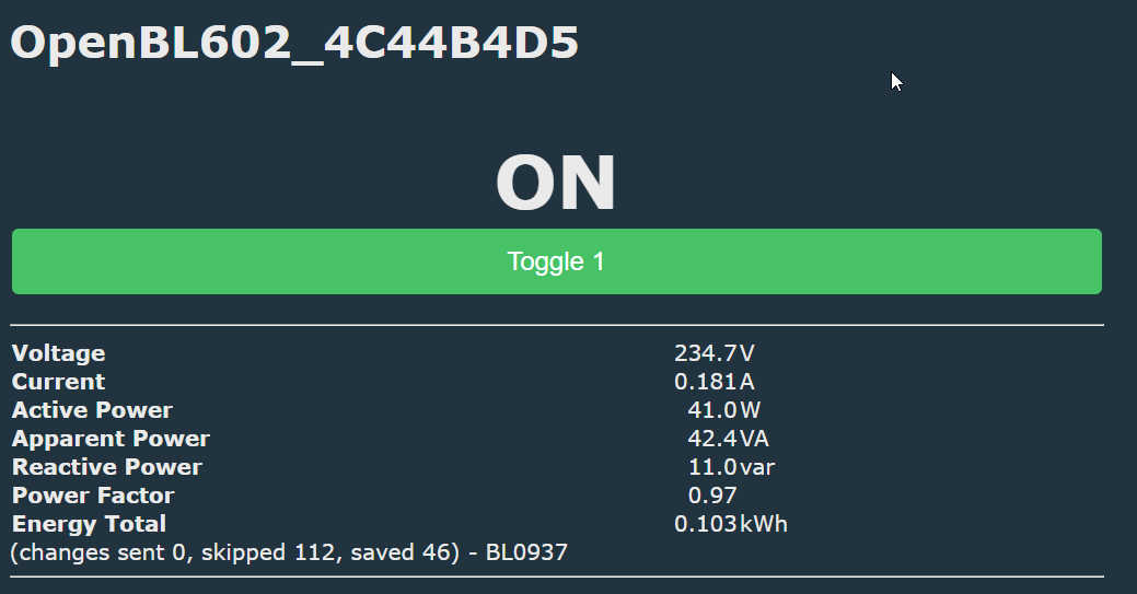

    Good news, got it working. Now there is two things to solve here, I think these long sdk includes should not be here, it should be moved to HAL layer I think. However, not sure how interrupt stuff for BK0931 and W600 works, looks to be included by some magic.
    Another issue is that there is no way in sdk to proper "shutdown" pins. Interrupt can be disabled, but it will still leave handler registered, and taking memory, we could add something like hal_gpio_unregister_handler to sdk, but not sure...
    Screen displaying power data for the OpenBL602_4C44B4D5 device.
    Regarding that reduced size update, it only reduces memory by like 1kb, is that right?

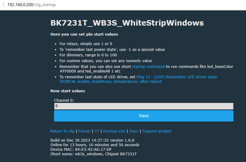

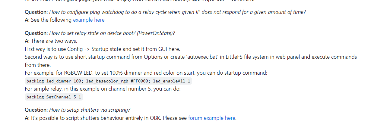

    How to set the relay to be ON by default or at least ON when device is powerred on? On a power outage (or if you plug the thing in and out) the relay stays OFF, before you manually set it ON.
  • Set relay default-on via GUI or startup command
    #29 20923585
    Posts: 14755
    Rate: 12880
    There are multiple ways to do it.
    1. via gui:
    Screenshot of the BK7231T_WB3S_WhiteStripWindows user interface for setting start values.
    2. via startup command - you can enter there something like:
    POWER ON
    or OBK syntax:
    setChannel 1 1
    3. via autoexec.bat scripting (similiar to startup command, but not available on BL602 yet)
    Added after 6 [minutes]:
    Btw, the same question is in our FAQ:
    https://github.com/openshwprojects/OpenBK7231T_App/blob/main/docs/faq.md
    Screenshot of OpenBK7231T project's FAQ documentation with questions and answers about device configuration.
