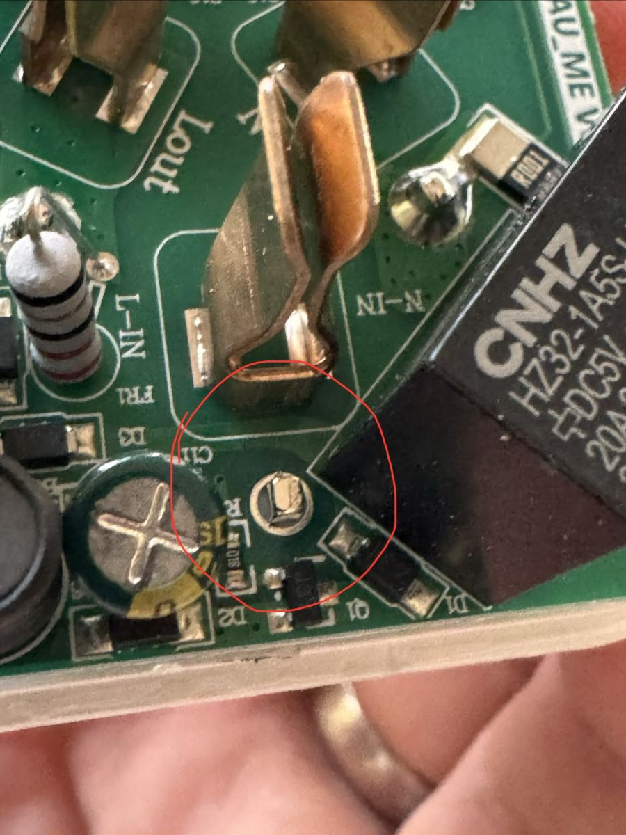

    I purchased some of these in November 2025 from a different Ali store, and the earth pin is not properly soldered on at least two. I have a metal USB device that was giving me a small shock (seemed to be about 11 V AC). I could see a voltage difference between the output earth pin of the Tuya device and the earth pin of the socket it was plugged into, so I opened it up, and the pin is connected through the pad but not actually soldered. In the pictures above, it seems like the one you have is. I tried to contact the store and have them let the manufacturer know, but I am not confident that is happening.

    >>21757650 The first one I bought had the same issue. Made it easier to disassemble, but now I purchased two more and those came up properly soldered. It seems that the assembly process is manual for that part and the operator forgot to solder it.

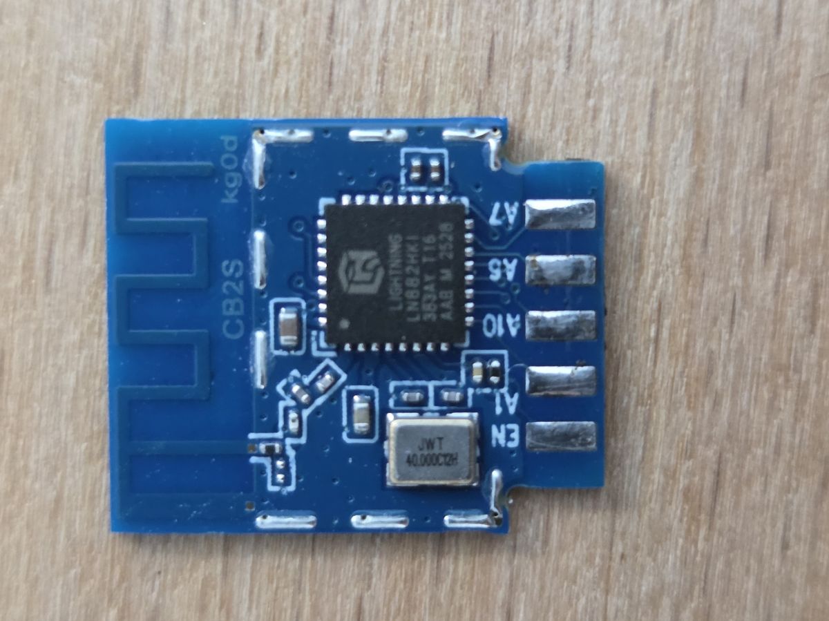

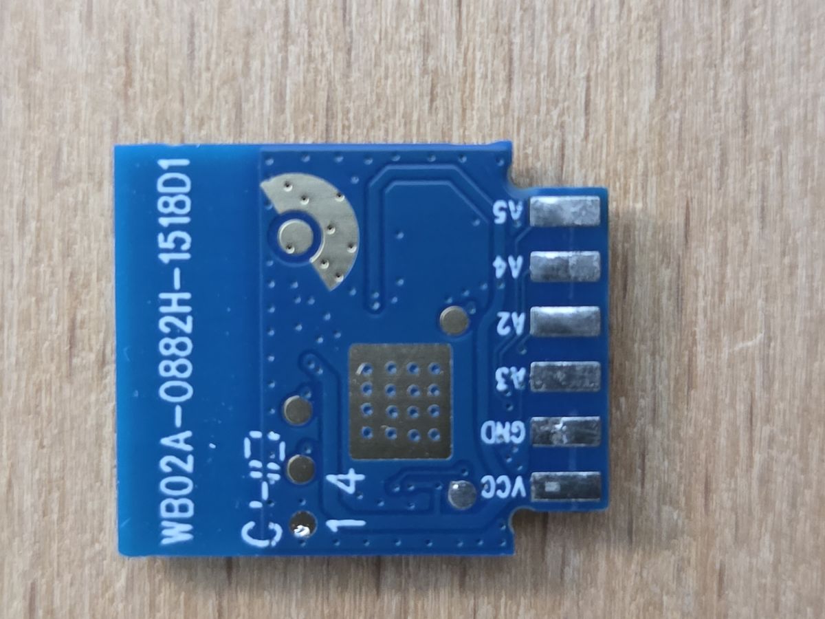

    I've picked up a version of this plug but it has a different WiFi board. It has the WB02A-0882H-151801 board, and the button is coming off the PA03 pin, so it interferes with the UART, which is crazy. Also, my earth pin was not soldered - very BAD indeed!
    Added after 45 [minutes]:
    Blue PCB module with a PCB antenna and IC; solder pads on the right labeled A7, A5, A10, A1, EN.
    Blue PCB with six pins labeled A5, A4, A2, A3, GND, and VCC.
    Here are the board images. It looks like there are 2 A5 connections, but the one between A10 and A7 is connected to A6 (pin 14 of the chip)
