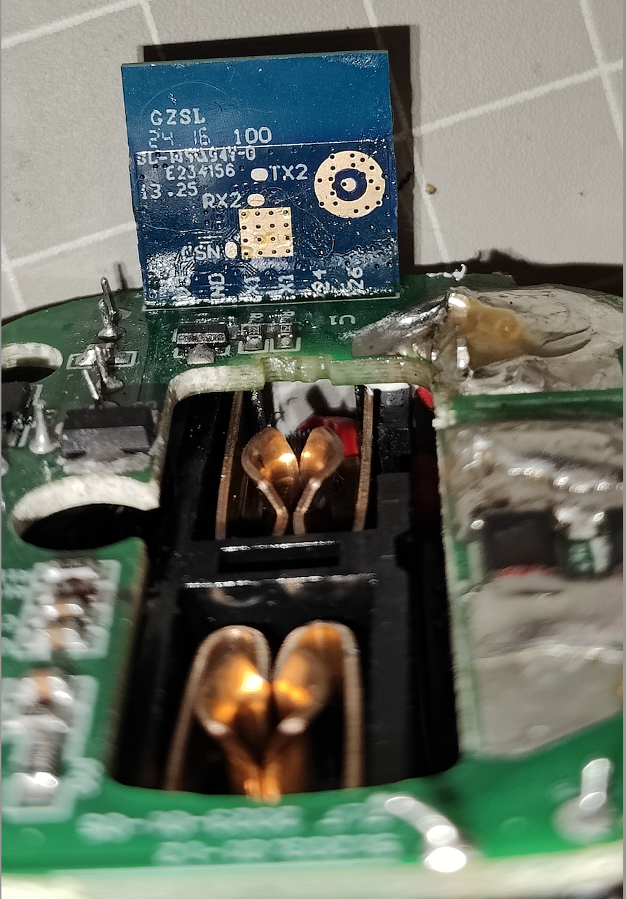

    Black WiFi adapter with protective cover.
    Anslut devices are usually re-branded generic Tuya for sale by Jula in Sweden.
    Device information:
    Chip: BK7231N
    Board: CB2S
    Energy monitor: BL0942

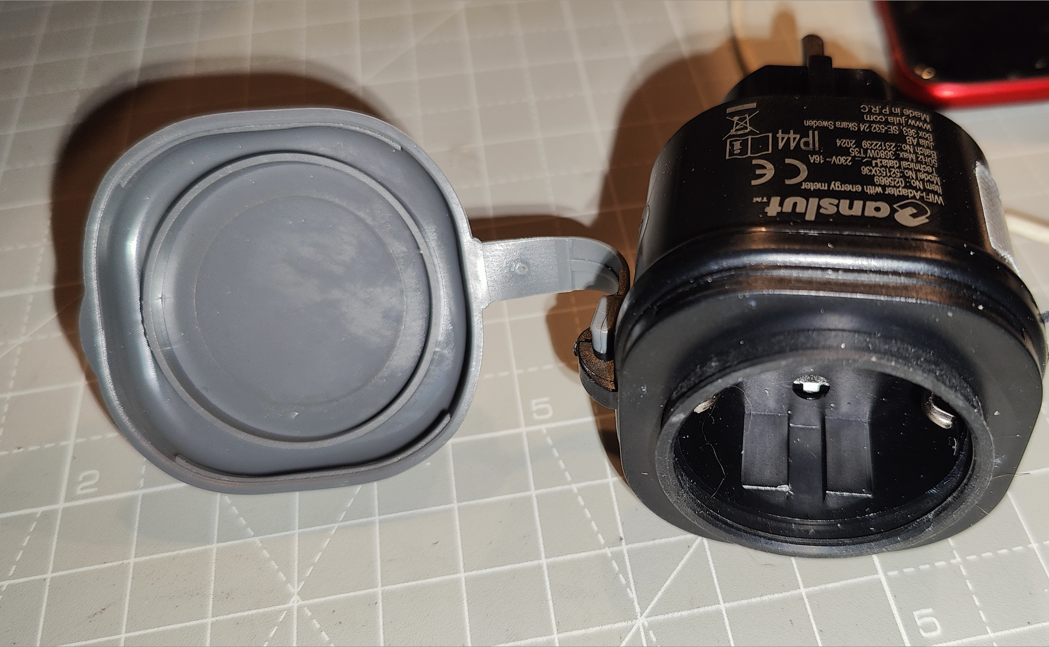

    This device is Class IP44, suitable for outside use or in a bathroom, but not totally watertight. After disassembly, the device must be re-sealed with a suitable sealant to prevent an electrical hazard.
    Close-up of an Anslut outdoor smart plug with the cover removed.

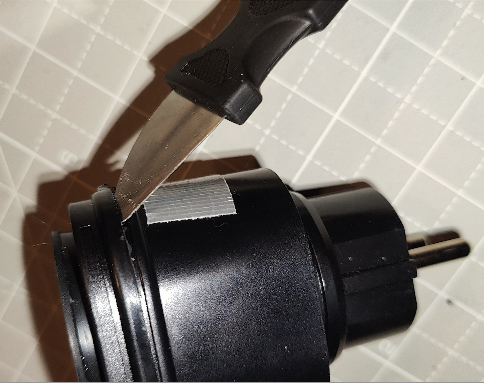

    Disassembly is most easily achieved by using a "spudger", flexible blade or similar tool to pry open the top, starting at the corner opposite the power-button (there is no holding-clip there) and working your way round, breaking the seal.
    Prying open the case of the Anslut device with a knife.

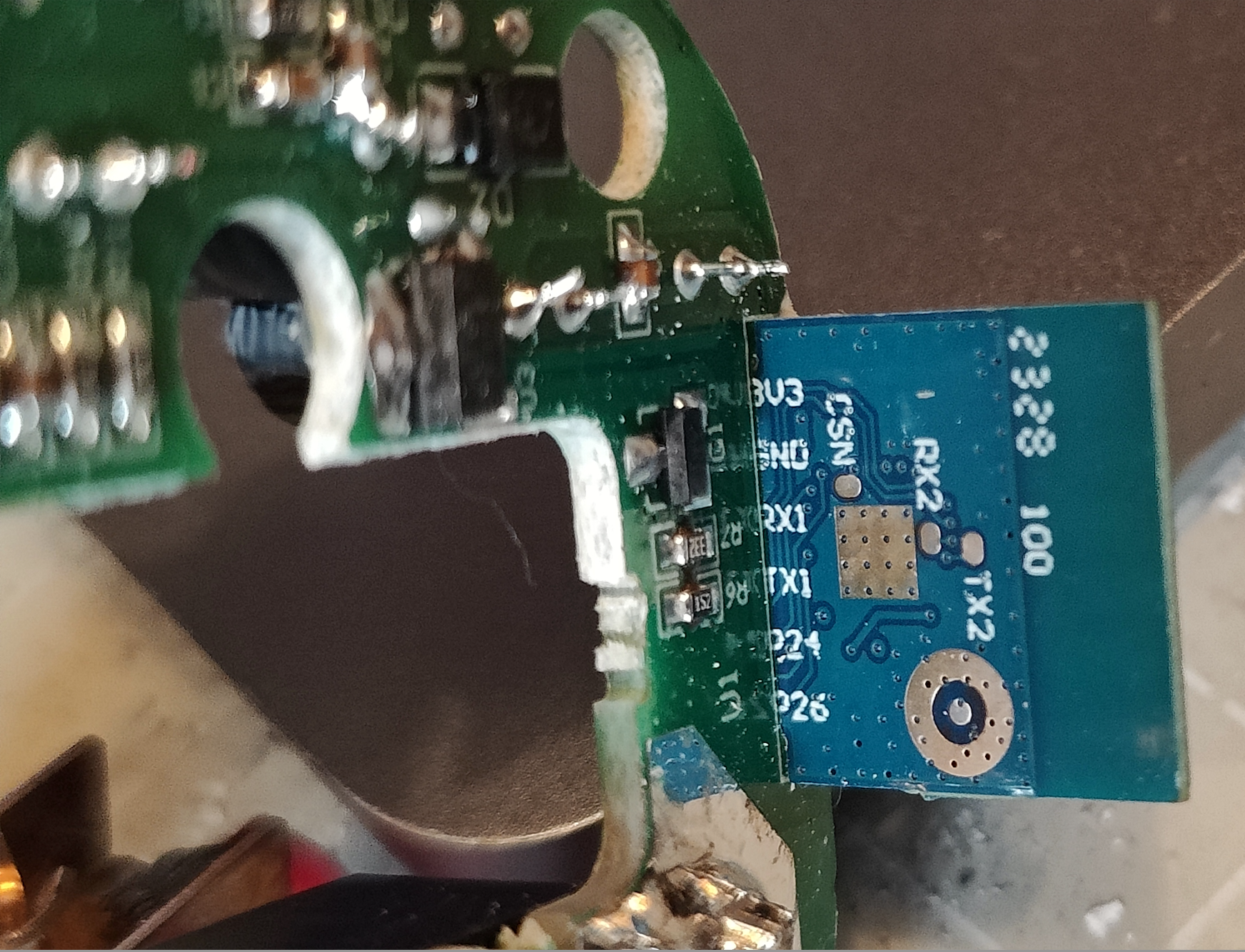

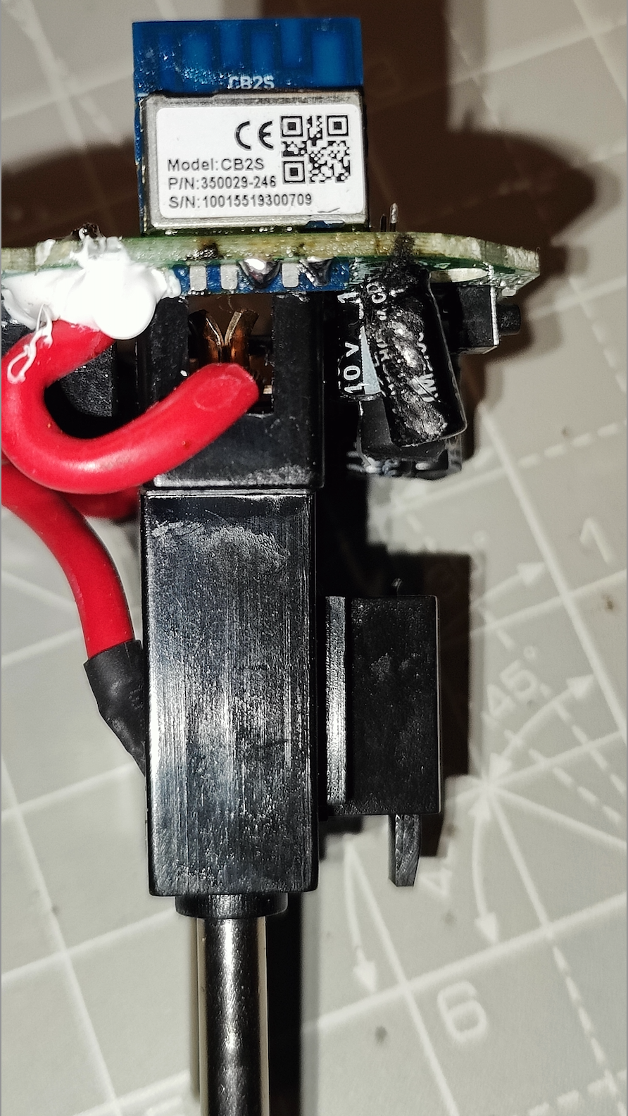

    Close-up of a CB2S electronic module with model and serial number labels, mounted on a circuit board.   Close-up of the interior of an electronic device with an exposed blue CB2S chip module..   Close-up of a printed circuit board with electronic components of the Anslut device..   Close-up of a circuit board with visible electronic components and signs of disassembly.
    I successfully flashed two of these with a generic FTDI-USB programmer, using the power from the programmer itself: one by desoldering the chip and one by soldering dupont pins in-circuit. The in-circuit flash required the baud rate to be dropped to 115200. Starting the flash and cycling the power by dis/re-connecting the power lead.
    The BL0942 Energy monitor chip is self-calibrating, so I assume the power usage figures are correct.
    The extracted Tuya config did not work out-of-the-box, but here is the working config.

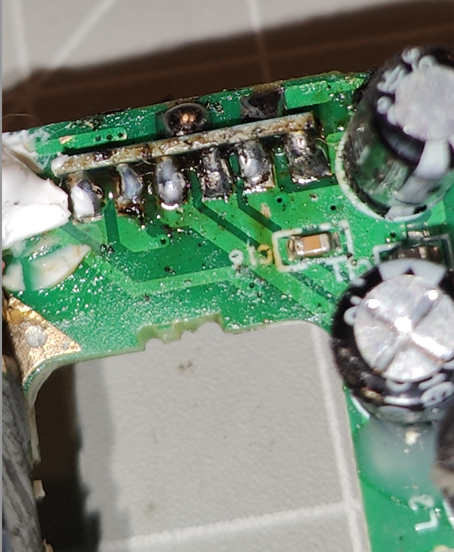

  • PowerSave required to avoid capacitor failure
    #3 21345568
    Posts: 14760
    Rate: 12886

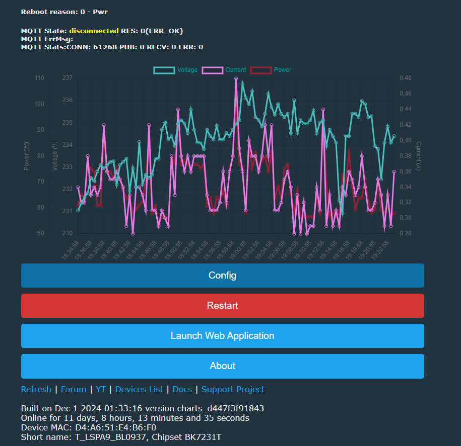

    I have similiar plug. I happened to run it without PowerSave and then I had to replace the low-ESR capacitor, just like in this topic:
    https://www.elektroda.com/rtvforum/topic3898805.html
    But that one has BL0942, so there should be no issues with PowerSave, just remember to enable it.

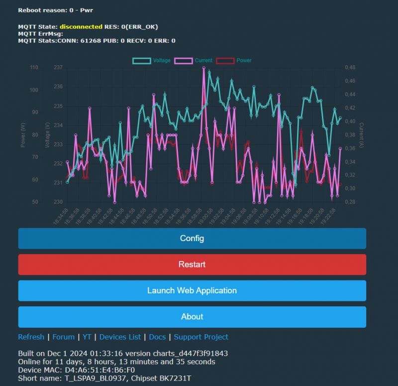

    PS: Those devices can make nice graphs, here is my PC socket:
    Graph of voltage, current, and power from a measurement device.
