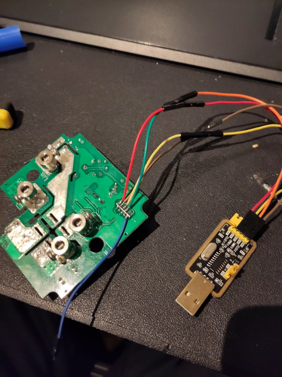

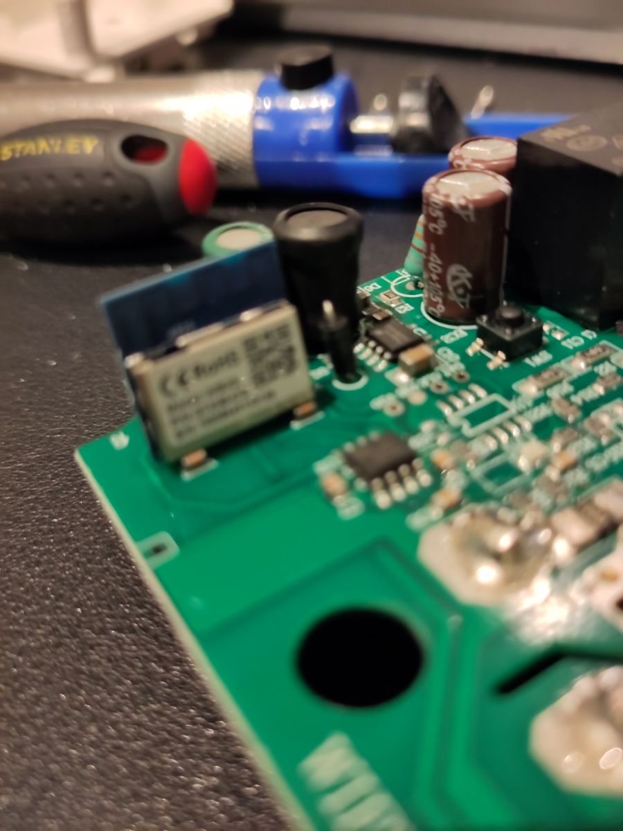

    I have a Chosry Fused Spur JKFS-WIFI that I use to control my hot water immersion heater.

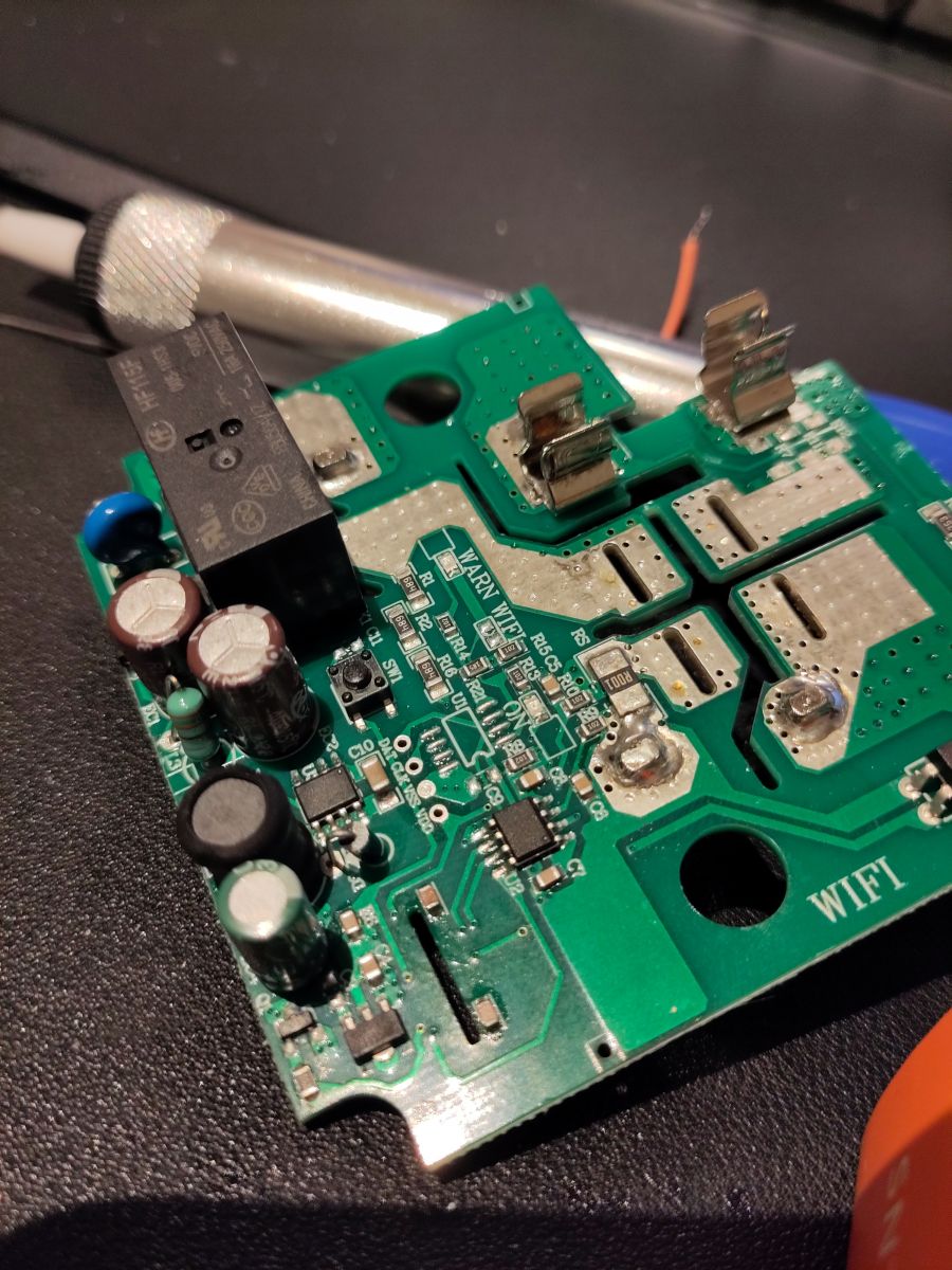

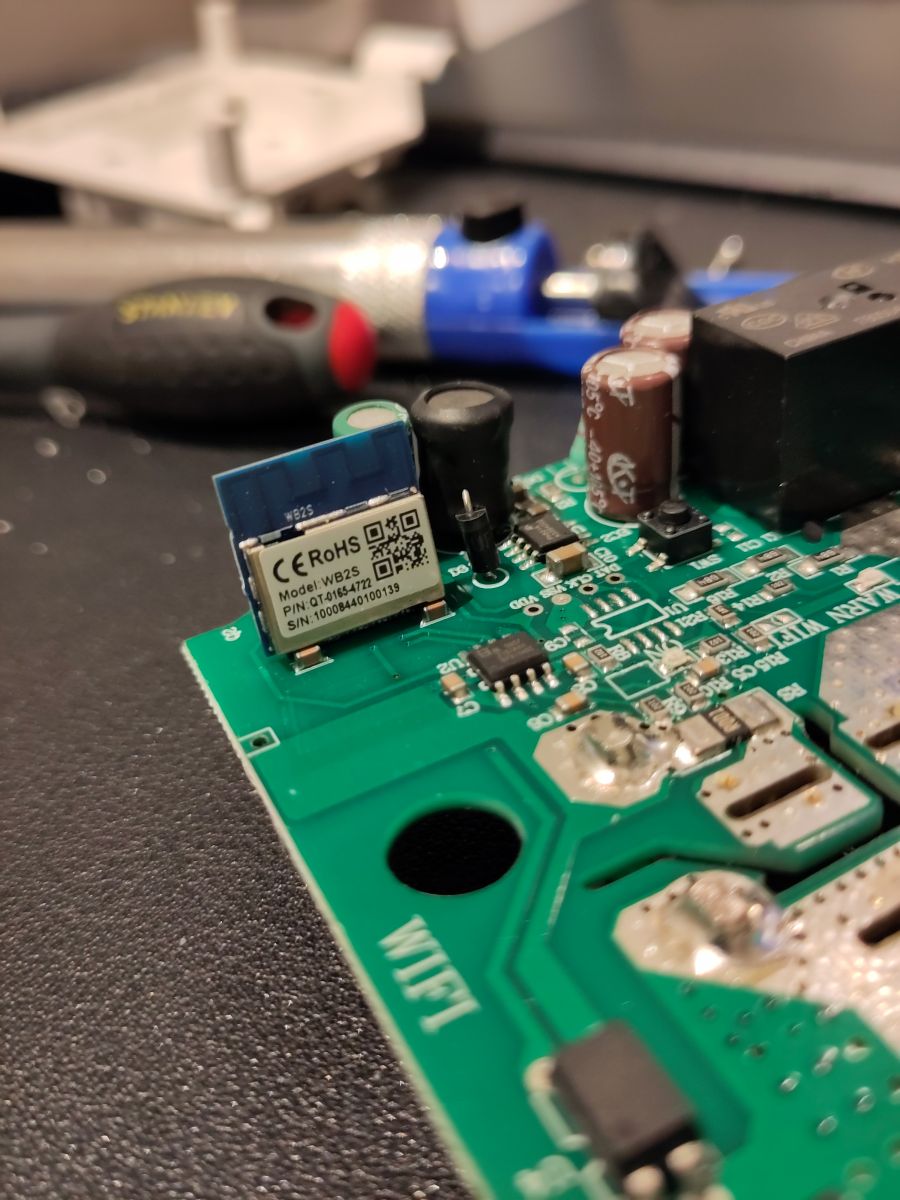

    After going through the inevitable Tuya problems I disassembled and found a WB2S inside.

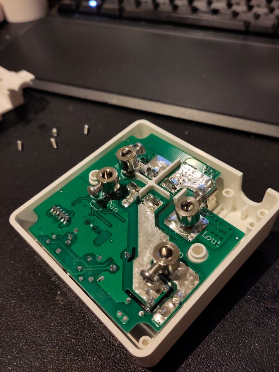

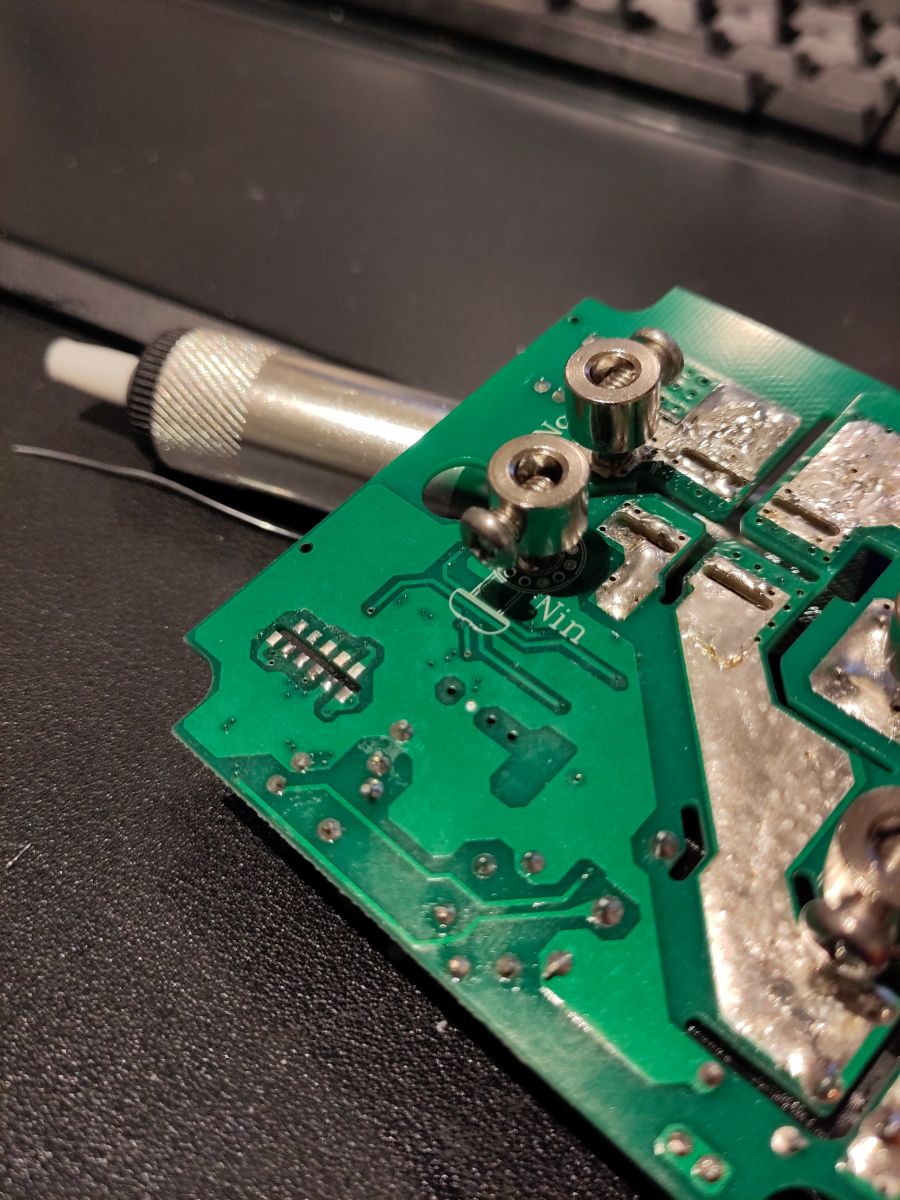

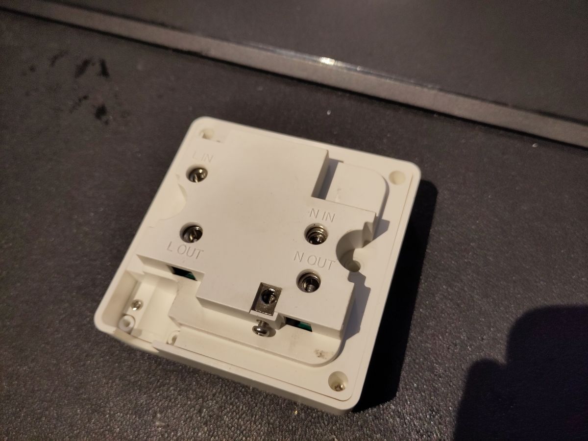

    I had to remove the manual switch from the front as it's fitted in from the front of the case and the PCB from the rear.
    After an unsuccessful flash I de-soldered and removed the board from the device, re-flashed and voila!

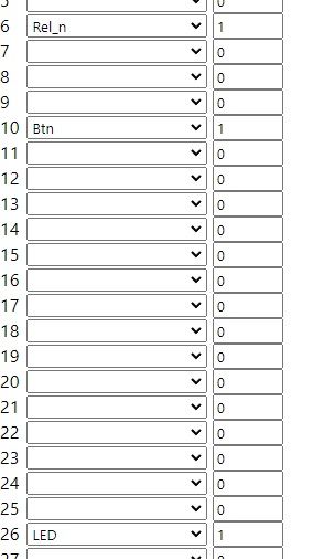

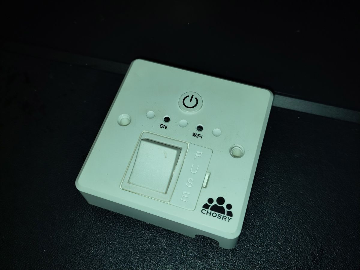

    Currently the config has both LED turn on when the device is active and both off when not as my boiler is in a cupboard in my bedroom and the LED are annoying!
