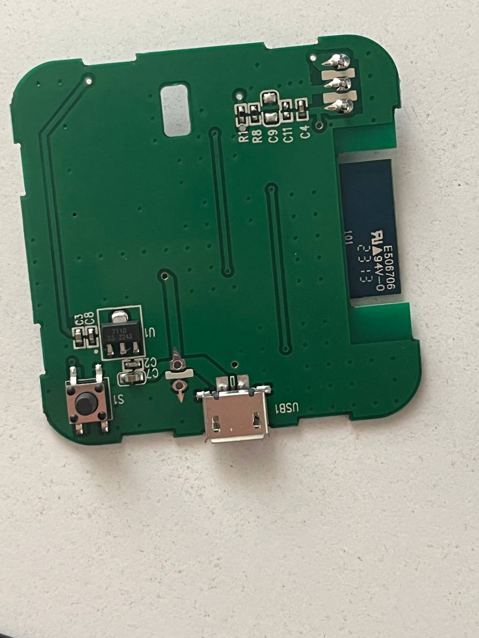

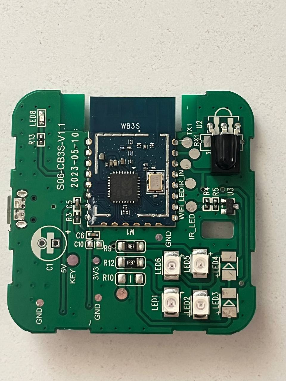

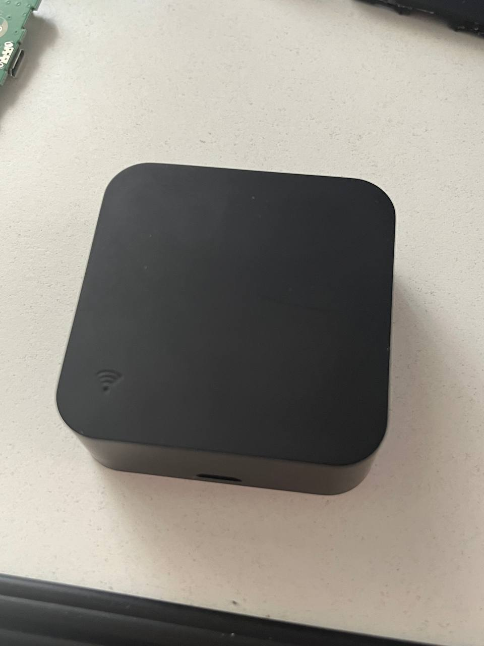

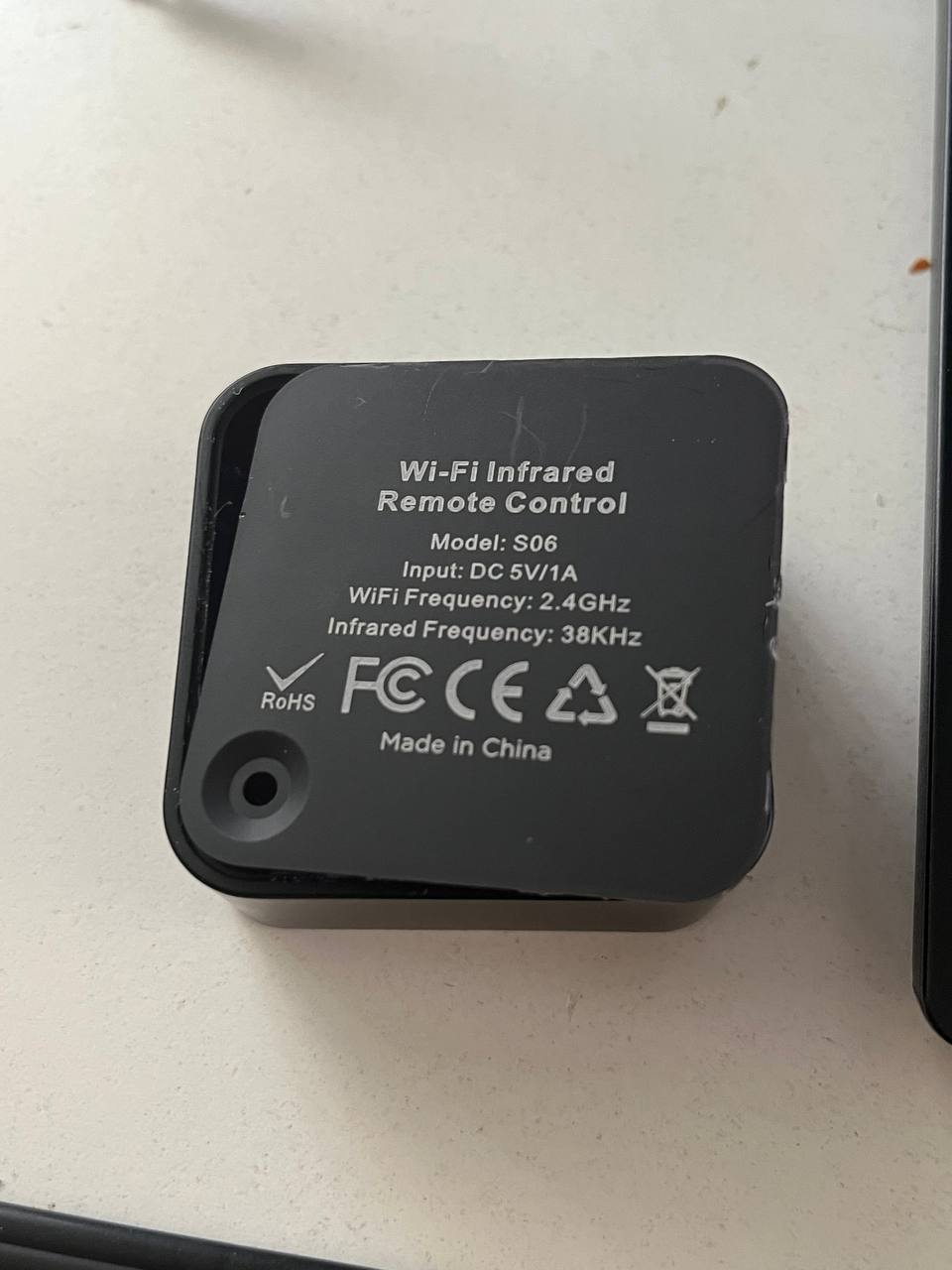

  • Teardown of a smart IR remote WiFi control based on WB3/BK7231T, a first Beken-powered device.
  • Inside, it uses 4 TX LEDs and 1 RX for infrared control over WiFi.
  • The unit cost a couple of euros on AliExpress and works okay with the Tuya app.
  • TX/RX functionality is still untested, so the infrared performance remains an open question.
  • Hi all,
    This is my first Beken powered device.
    Not tested yet if TX/RX work, but here's a teardown.
    Black electronic device on a white surface with a Wi-Fi symbol. Black square module with a Wi-Fi symbol on its top surface. Black Wi-Fi remote control with visible model S06 and technical specifications. Image of a PCB with a WB3S module, four TX LEDs, one RX LED, and labeled components. Electronic board with visible components like LEDs and a USB port, powered by Beken.
    It features 4 TX LEDs and 1 RX.
    WiFi connectivity.
    Bought from AliExpress for a couple of euros.
    Works okay with Tuya app.

    Hello, have you tried to change the firmware or make 2MB flash backup? We could use it to post the template.
    Still, maybe we could trace the GPIO roles just from the photos, they are good quality.
    It is interesting to see they used WB3S without shield.

    I can confirm for now that:
    P6: Btn (tested with GPIO tester)
    P8: IRRecv (tested with console info)
    P9: LED (tested with GPIO tester)
    To be confirmed:
    P26: IRSend
    I tried to send a command as I receive and nothing happens on devices. Tested an LED strip ON/OFF button (received Info:IR:IR IR_NEC 0xEF00 0x3 1) and an LG Soundbar vol+ button (Info:IR:IR IR_SamsungLG 0x2C2C 0x17 1).
