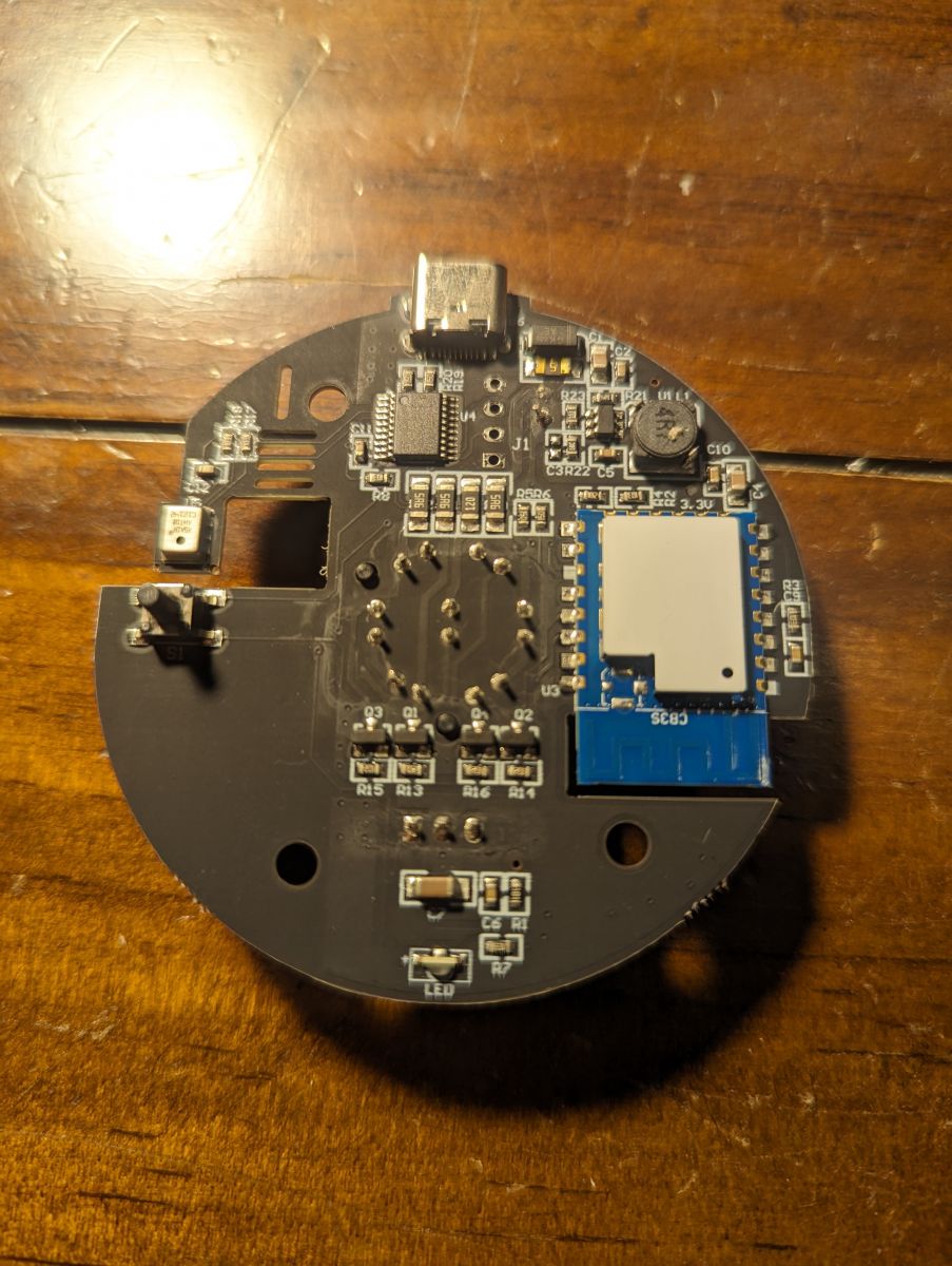

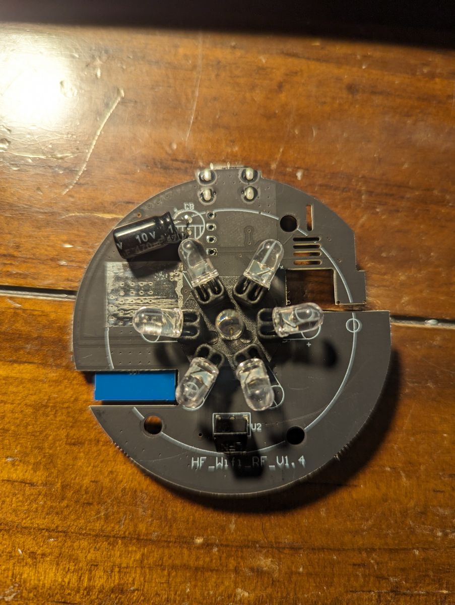

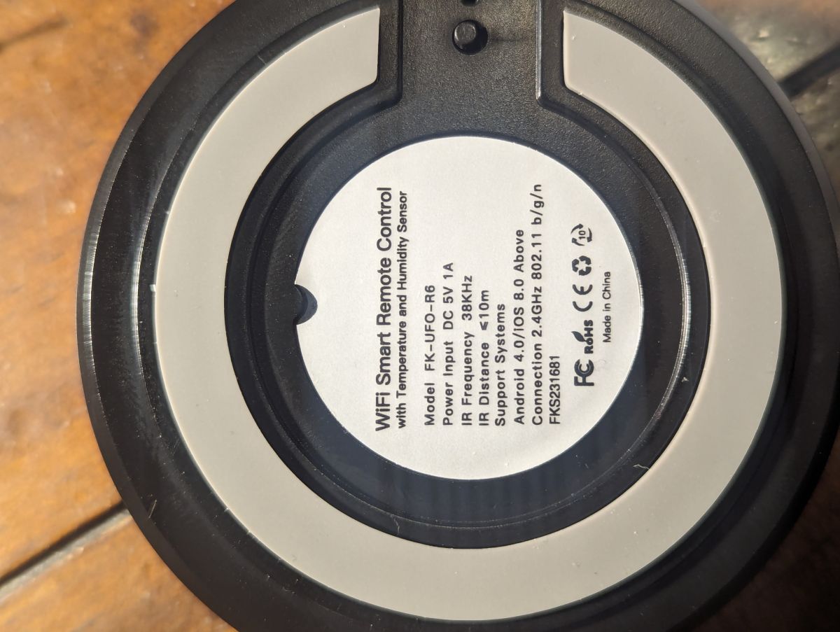

    I got this WiFi Smart IR blaster because it has a built-in humidity and temperature sensor with the goal of controlling an AC unit.
    The good news is taking the device apart is very easy, the plastic case opens nicely. Flashing with OBK was as simple as soldering wires to the CB2S module, and flashing the firmware (I use hid_download_py since I'm on Linux).
    Close-up of a label on the bottom of a WiFi Smart Remote Control module. Electronic module with visible STC chip. Top view of a WiFi Smart IR module with a circuit board and components on a wooden surface. Close-up of a WiFi Smart IR module PCB on a wooden surface.

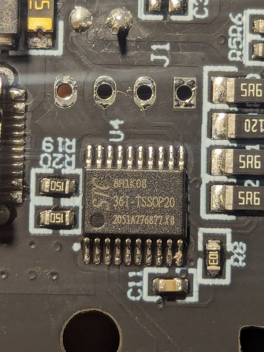

    I did manage to figure out the IRSend and IRRecv pins; however, I wasn't unable to figure out the onboard status LED or the button. Going through the GPIO Finder didn't help with either of those. I also have no idea how to figure out how to read the temp or humidity sensors. There is another MCU (https://stcmicro.com/stc/stc8h1k08.html) on the board shown in the pictures above. My thought is the sensors are talking through that? Unsure what to do next. My searches of the forum and online didn't bring up other smart devices with this chip in it. Is this considered a TuyaMCU??

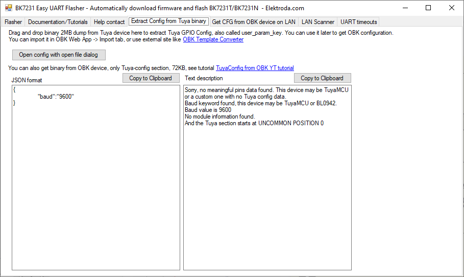

    The first step in such cases is to check the Tuya Config. It may contain baud information:
    Screenshot of the BK7231 Easy UART Flasher application showing Tuya configuration.
    And yes, it indeed looks like there is a baud setting. This device is using 9600 baud, which matches the low-speed TuyaMCU.
    So, I think you can now try to start TuyaMCU driver and maybe request state from it.
    See our autoexec examples:
    To query TuyaMCU state, use tuyaMcu_sendQueryState

    I enabled the TuyaMCU driver and it looks like it started talking to the chip.
    It seems that I would do a setChannelType1 Temperature to assign channel one as temperature and setChannelType2 Humidity to assign OBK channel 1 and 2 to temperature and humidity. I'm not 100% sure how to determine the dpIDs from TuyaMCU to link the channels. I guess I should have sniffed the UART communication before flashing OBK and put those into the TuyaMCUAnalyzer? OBK is already on the device, am I screwed? I tried my like to assume it was similar to other devices with temperature and humidity by running this for autoexec.bat
