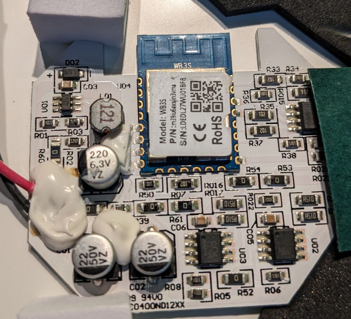

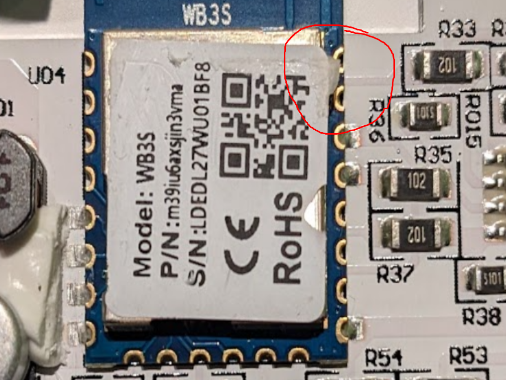

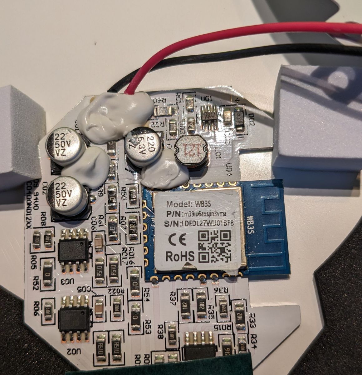

    I purchased these lights on Amazon. Teardown is simple, remove the 6 screws on the back of the downlight. The board is inside a white heat shrink. Cut along the edge with a razor so that you can simple slide the heat shrink back over the board after you're done.
    CLOUDY BAY 6inch Smart Wifi LED Recessed Lights, RGBCW
    I removed the WB3S module with a heat gun and stuck it in a DORHEA ESP8266 Code Burner to flash it. You may try flashing it while its installed but it wouldn't work for me with. Flashing while installed does work. My old serial programmer was malfunctioning. I successfully read and flashed it while installed using the DORHEA ESP8266 Code Burner.
    Pin configuration:
    P6: PWM/5
    P8: PWM/4
    P9: PWM/1
    P24: PWM/2
    P26: PWM/3
    After configuring the device and prompting the home assistant discovery, home assistant picked up the device and allowed me to control everything without any further configuration.
    The pictures here are of a light that had a catastrophic failure (I quickly assembled it for pictures here). I accidently shorted out a handful of pins on the back on a piece of metal, whoops.
    Edit: attached stock firmware.

    Hello, would you be able to provide some more pictures of your device, how it looks like from outside and maybe inside, and if not, maybe some screenshots from the shop offer where it was bought?
  • #3 20372247
    justinhunt1223
    Pictures uploaded, sorry!

    No problem. I see you did well with the heatgun, although I think it would be also possible to flash it in place, you just need a reliable 3.3V power supply (not the cheapest one that is on the board of USB to UART converter).
    And of course, never attempt to flash anything connected to mains.
    Btw, it's good to see that Home Assistant Discovery is useful. Our team member @iprak did a very good job with that. It's all his work.

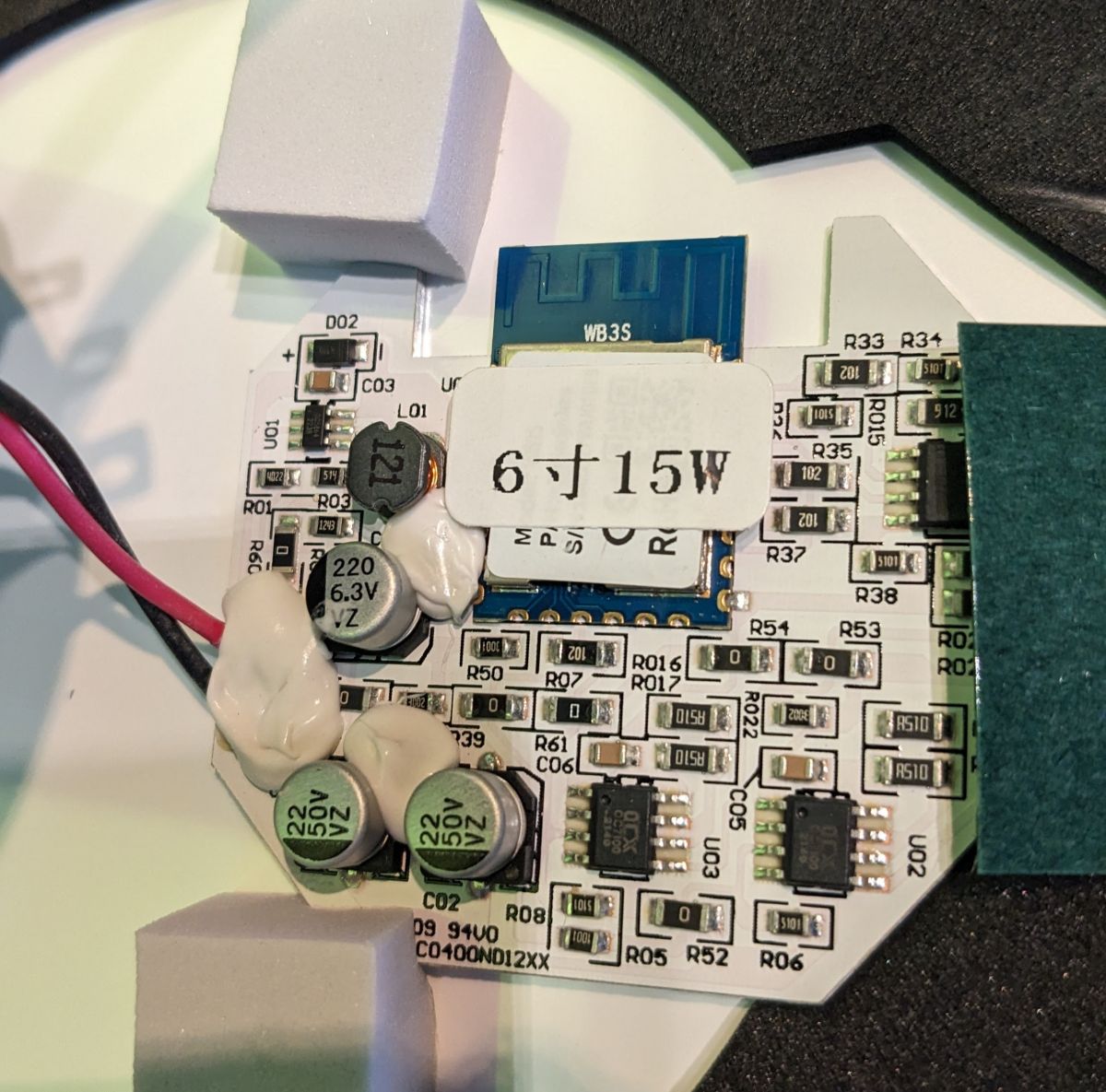

    Hi,
    Thanks for replying.
    Definitely it is not a range of the wifi :) I literally tried to setup the light two feet away from the Access point (U6-LR) :) and the rest of the lights are in a line of sight from 6 to 16 feet.
    Here are two images:
    Close-up of a circuit board with electronic components and a 6V 15W label.
    Close-up of an electronic circuit with a WB3S module and several capacitors.
    Let me know if I can do anything with this one. What equipment do I need... etc.
    Definitely I am willing to experiment :)
    thanks!
  • WB3S module identified with OBK flashing steps
    #17 20846110
    Posts: 14755
    Rate: 12881
    That's good, it's WB3S.

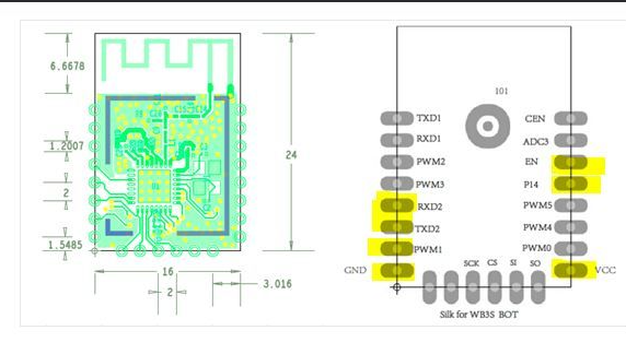

    In addition to previous post :) ... I decided to do some research, haha...
    looks like it is this module: https://developer.tuya.com/en/docs/iot/wb3s-module-datasheet?id=K9dx20n6hz5n4
    Cleaned up a glue to confirm soldering points:
    WB3S electronic module with visible solder points on a PCB.
    So it looks like those:
    WB3S module diagram with highlighted soldering points.
    ohh and I have not noticed you already replied.... I will watch videos... I've not flashed Tasmota or etc... this is a new adventure :)

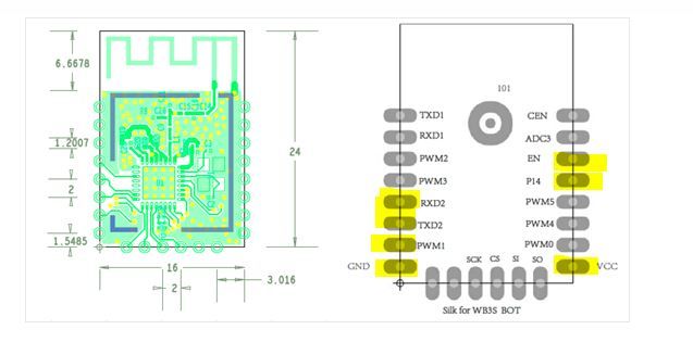

  • #19 20846182
    Posts: 14755
    Rate: 12881

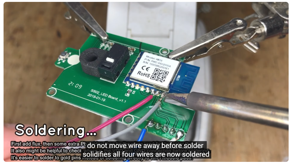

    PLEASE remember, this is a bottom view of modul:
    Diagram of an electronic module with pin labels on the right side.
    If you look from the top of the module, the TX1/RX1 is on the right.
    See, here is a screenshot from our video:
    Soldering wires to an electronic module.
    On the screenshot, we solder RX and TX to the right side of the module (when looking from the top)

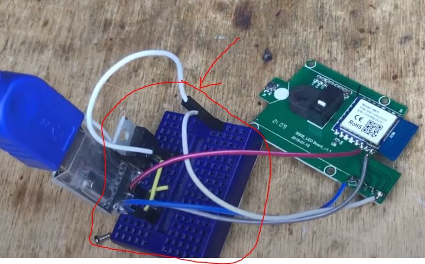

  • #21 20846406
    Posts: 14755
    Rate: 12881
    That thing may help.
    Alternatively, you may use NodeMCU or Arduino UNO or any other board like that, you just need to route out TX, RX, GND, 3.3V and futhermore, in case of those boards, you need to put the MCU (ESP or Atmega) in the RESET state, by shorting RESET to GND.
  • Asking how to wire the USB downloader and TX1/RX1 lines
    #22 20846509
    specialdude
    Posts: 36
    OK, so just not to complicate things.... or maybe I am :D Let's stick to this:
    https://www.amazon.com/DORHEA-Downloader-Comp...e-Transmission-Transceiver/dp/B08P37JQYX?th=1
    I can get that .
    and upon further reading I do not need any USB-UART device, it straight connects thru USB-A to MicroUSB cable to PC.
    Assuming I have it ... what is my next step to hook it all up?
    I think I would probably solder directly wires to it on a board like in one of the videos, but it looks like I need to do 4 of them....
    You told me about the two TX1/RX1 and any ideas about the other two?
    thanks
  • #23 20846514
    Posts: 14755
    Rate: 12881
    The device you linked is in fact a fancy USB to UART converter, but it should be good:
    Converter module with labeled parts including serial chip and receive/send indicators.
    Two other wires? Well, the answer is on linked video, but in general you need to connect:
    - GND to GND
    - 3.3V to 3.3V
    - RX to TX
    - TX to RX
    And then you do device reboot by disconnecting power when flasher is waiting for "getting bus".

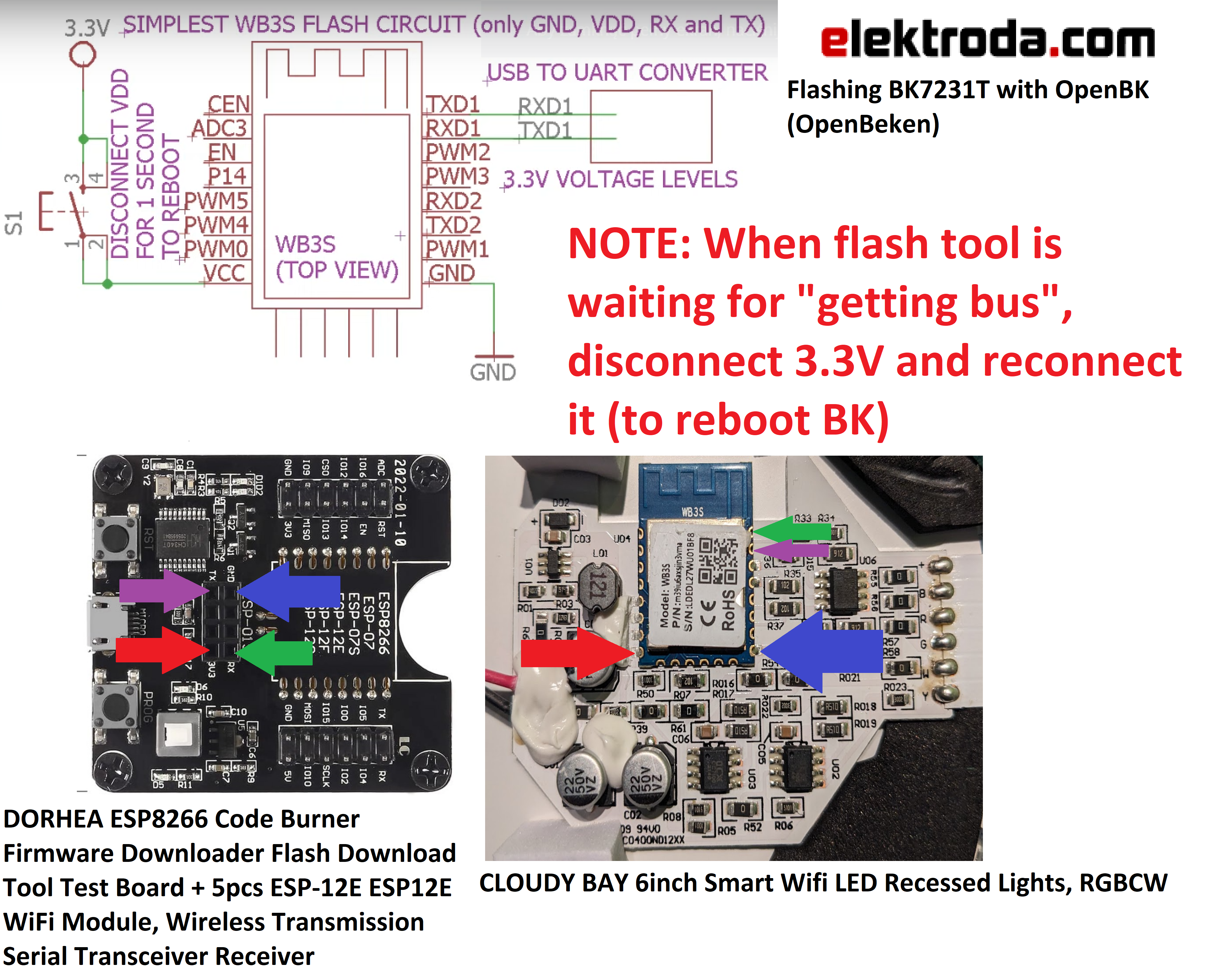

  • #24 20846561
    specialdude
    Posts: 36

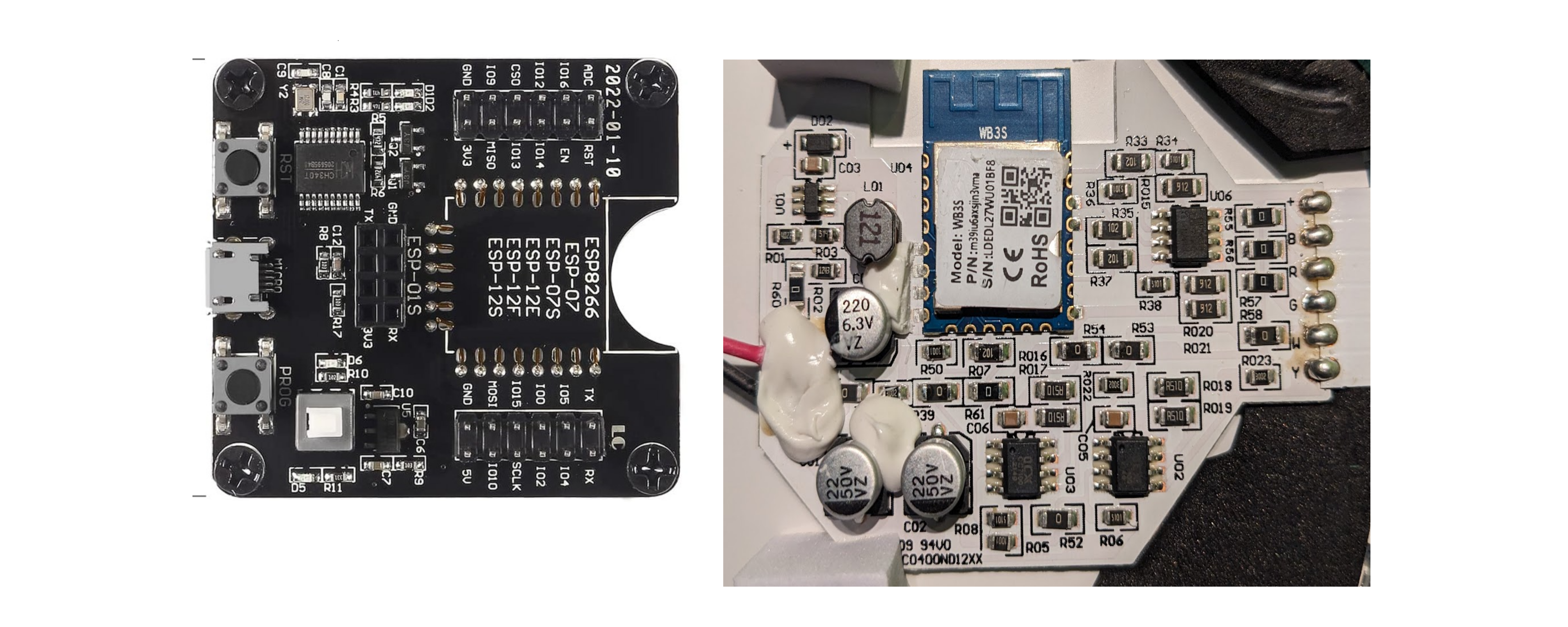

    can you visually on an attached below picture show how you would connect it?
    ESP8266 board on the left and WB3S module on a PCB on the right.
    Thank you up front very much!
  • #25 20846585
    Posts: 14755
    Rate: 12881
    Maybe something like that:
    Diagram and photos showing BK7231T flashing process with OpenBK.
    Keep in mind that in some cases you need to do more than that, see this video:
    https://www.youtube.com/watch?v=Yb3zXtBdSnE
    Sometimes you also need to swap RX with TX
  • #26 20846653
