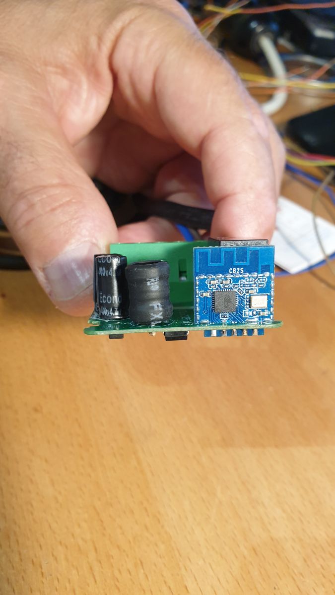

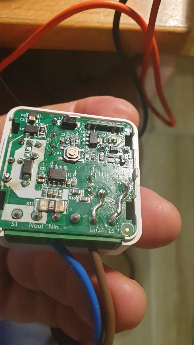

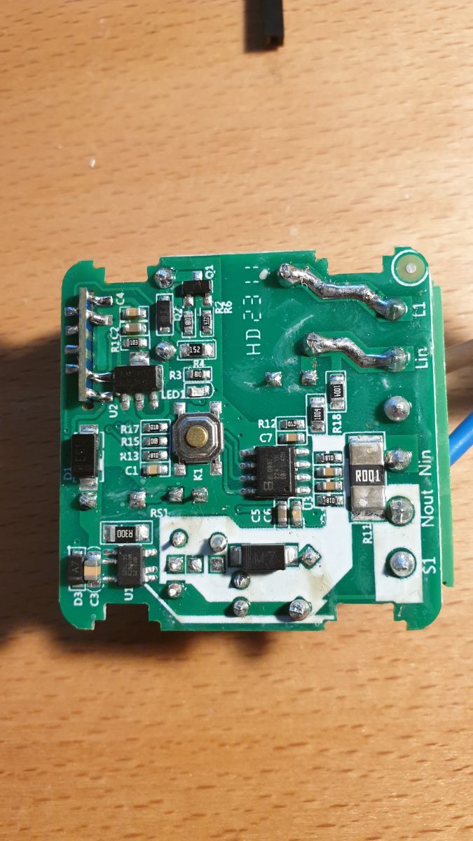

    Hi there,
    I have got yet another Aubess switch version.
    Brand: Aubess
    Model: FS-02HW
    Chip: CB2S (BL2028N)
    This is the listing where I bought it: https://www.aliexpress.com/item/1005004791531463.html
    Understanding the Aubess FS-02HW Mini Smart Switch: A Detailed Look at Chip CB2S BL2028N

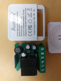

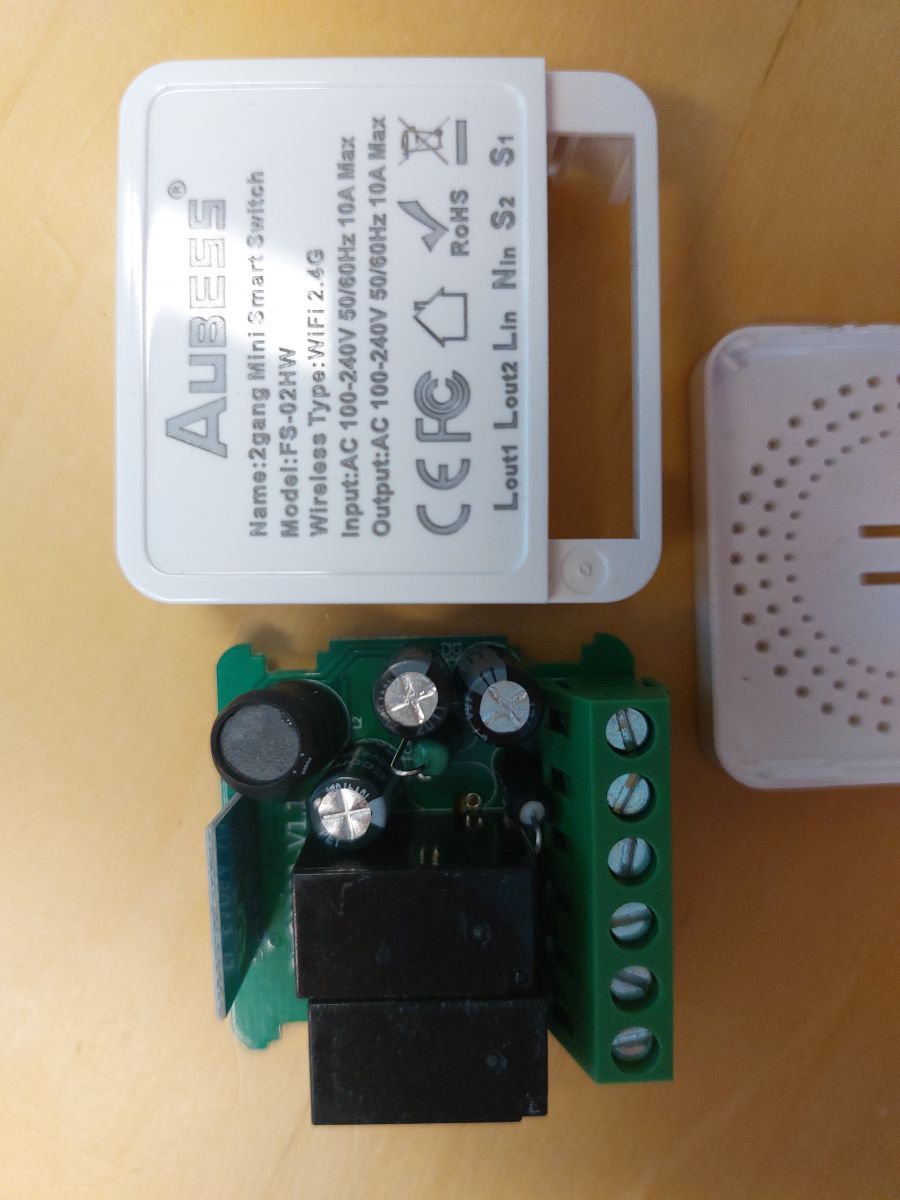

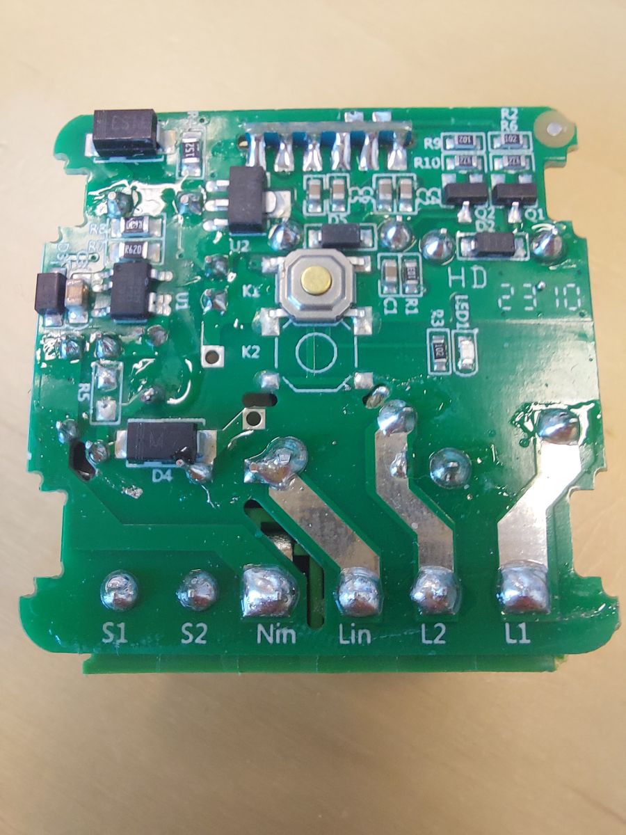

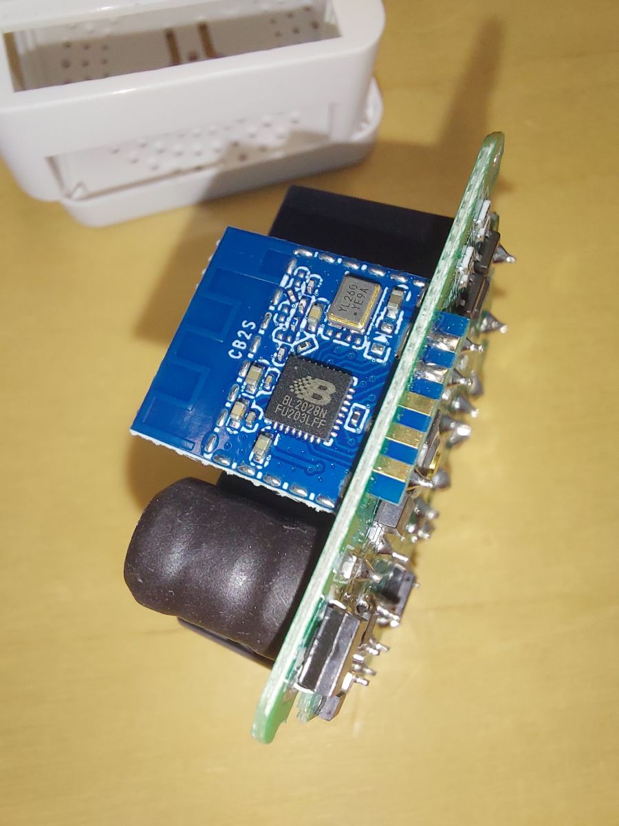

    Teardown photos:
    Understanding the Aubess FS-02HW Mini Smart Switch: A Detailed Look at Chip CB2S BL2028N Understanding the Aubess FS-02HW Mini Smart Switch: A Detailed Look at Chip CB2S BL2028N Understanding the Aubess FS-02HW Mini Smart Switch: A Detailed Look at Chip CB2S BL2028N Understanding the Aubess FS-02HW Mini Smart Switch: A Detailed Look at Chip CB2S BL2028N Understanding the Aubess FS-02HW Mini Smart Switch: A Detailed Look at Chip CB2S BL2028N Understanding the Aubess FS-02HW Mini Smart Switch: A Detailed Look at Chip CB2S BL2028N Understanding the Aubess FS-02HW Mini Smart Switch: A Detailed Look at Chip CB2S BL2028N Understanding the Aubess FS-02HW Mini Smart Switch: A Detailed Look at Chip CB2S BL2028N Understanding the Aubess FS-02HW Mini Smart Switch: A Detailed Look at Chip CB2S BL2028N

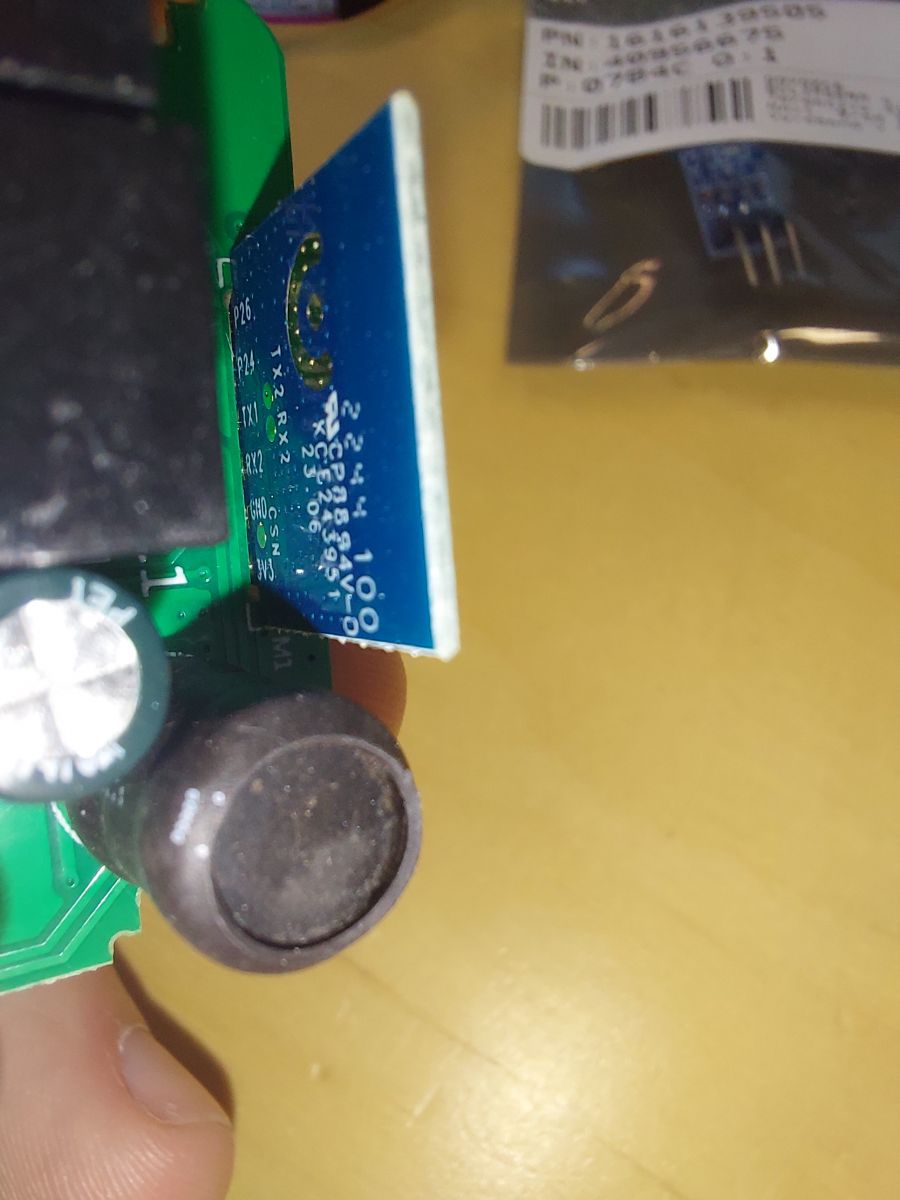

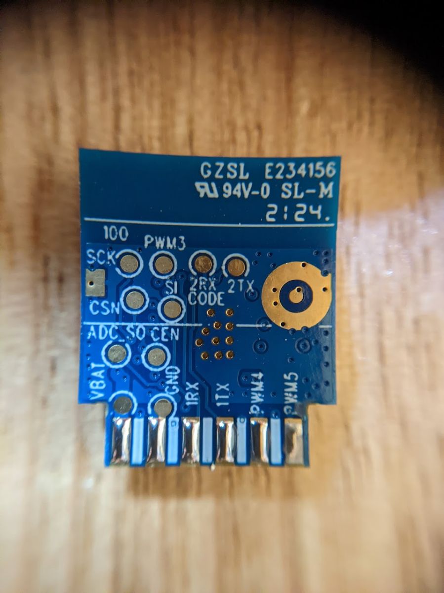

    So far this is where I end now. I am getting confused because according to labeling on the chip, there seems to be 2 "RX2" pins, and I need an advice how to proceed further with firmware flashing.

    Hello, the second RX2 (that in place of RX1) is a silkscreen error. Please see the image from Tuya docs.
    For flashing, we are using RX1 and TX1, not RX2/TX2 pair. UART2 is for debug log output at 115200.

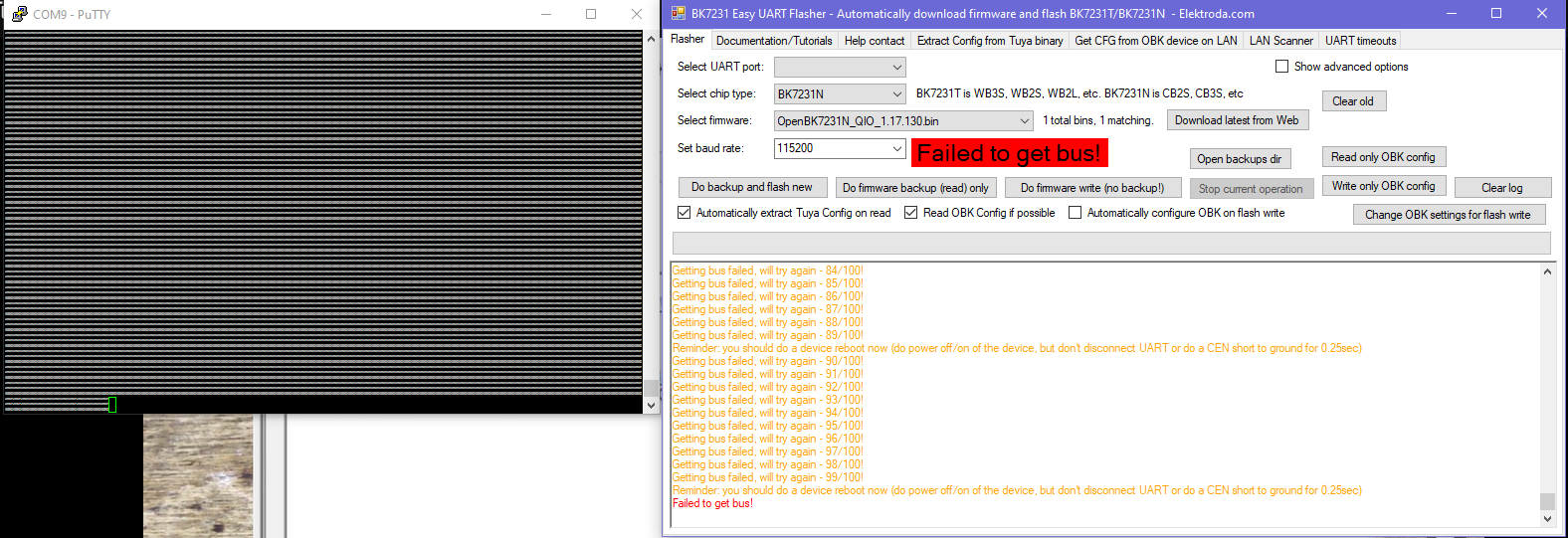

    Thanks, but so far no luck on this one.
    I'm not able to flash or read the device. First I tried to solder wires directly on the device, when that didn't work I did take out CB2S out of the device but results were the same..
    I tried both restart and CEN short mode, nothing..
    I even connected to UART2 for debug, but it's only a stream of nothing.. When CEN is shorted the stream from UART2 will stop.
    Don't know what to try next..
    Edit: Just flashed CBU successfully with the same setup...

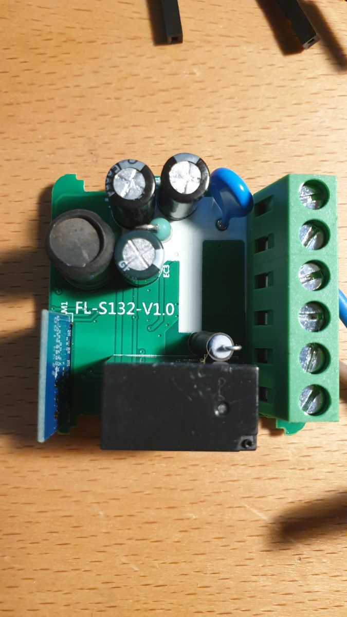

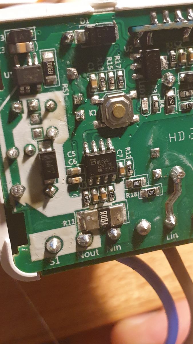

    Hi, I have the same problem with a similar module FS-02WE (same model but with an energy monitor). No load or backup firmware. I tried with different adapters, different PCs, and different tools (app or Python). I don't understand if you solved the problem and loaded the firmware in CB2S (BL2028N chip). If yes, can you help me? Thanks in advance.
  • CB2S module lacks UART access for flashing
    #5 20639165
    fabcia
    Hi, my sensor is a little different. my model is fs-02WE (power meter and switch on neutral line) see the photo Understanding the Aubess FS-02HW Mini Smart Switch: A Detailed Look at Chip CB2S BL2028N Understanding the Aubess FS-02HW Mini Smart Switch: A Detailed Look at Chip CB2S BL2028N Understanding the Aubess FS-02HW Mini Smart Switch: A Detailed Look at Chip CB2S BL2028N Understanding the Aubess FS-02HW Mini Smart Switch: A Detailed Look at Chip CB2S BL2028N Understanding the Aubess FS-02HW Mini Smart Switch: A Detailed Look at Chip CB2S BL2028N Understanding the Aubess FS-02HW Mini Smart Switch: A Detailed Look at Chip CB2S BL2028N
    Cb2s module not have uart communication with BL0937 (power meter chip). No solder or contact between rx tx pin in Cb2s module and other part of sensor. I think that non-bootloader firmware loaded in BL2028N (cb2s chip) and then no possible charge firmware with uart interface. The module works well with original firmware and tuya environment (tested in app and tuya iot cloud platform).
    I think also that only solution is load firmware in spi mode but c22s module don't have contact for this (it's too hard solder in BL2028N chip directly.)
    @p.kaczmarek2 There is another way to flash the openbeken firmware in my cb2s? or only solution is transplant it with esp8266 module and tasmota firmware?
    thanks in advance

    It looks like you have confused BL0942 with BL0937.
    BL0942 can be used in UART or SPI mode. It is usually connected to the RX/TX pin of BK7231.
    BL0937 is not a UART device. It can use any 3 GPIO as SEL, CF, and CF1. There is no need for contact with RX/TX.
    Furthermore, your CB2S has standard pads, so there is no problem with flashing:

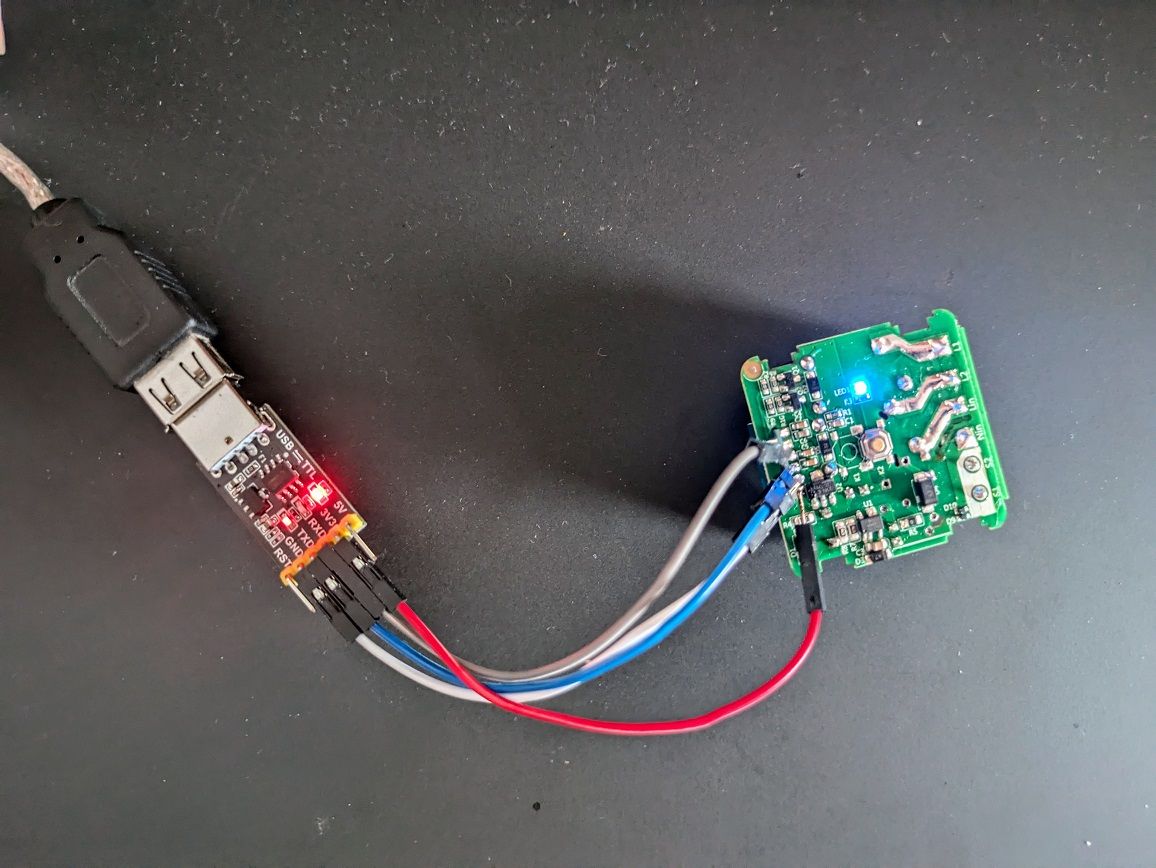

    Thanks USB UART adapter connected to a circuit board with glowing LEDs
  • Desolder CB2S and flash with 3.3V disconnected
    #12 21086320
    Posts: 14755
    Rate: 12881
    So are you flashing with CB2S desoldered or not? The photo is showing CB2S in circuit , without desoldering.

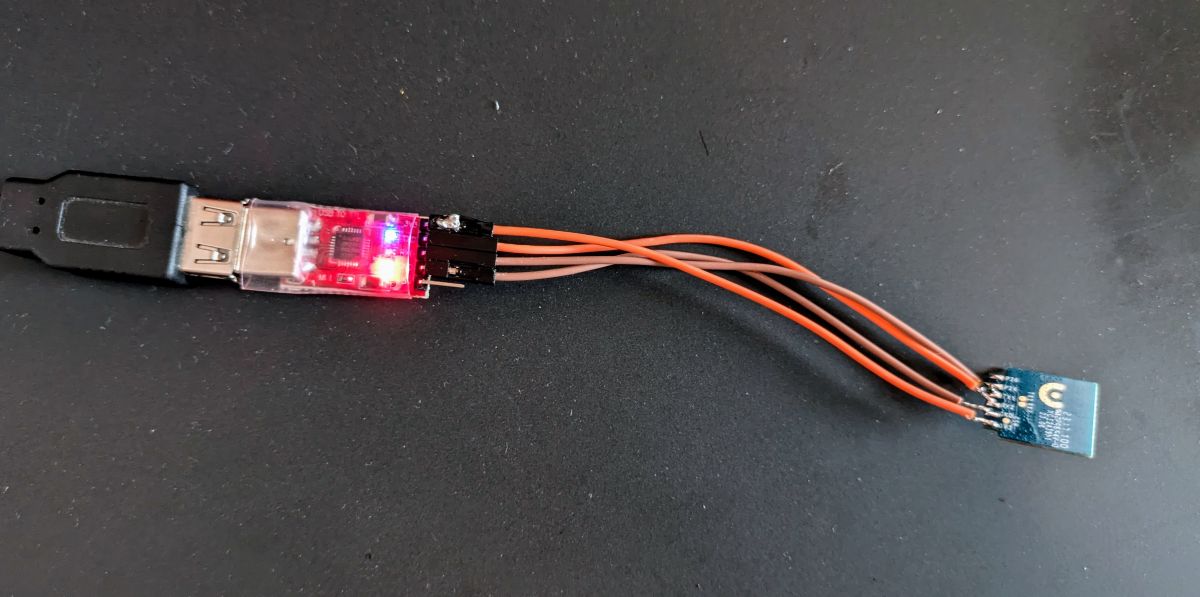

    #13 21086451
    Pete0815
    Posts: 34
    So are you flashing with CB2S desoldered or not? The photo is showing CB2S in circuit, without desoldering.
    Both. I have several CB2S and tried soldered/desoldered 2 different converters but no bus signal is detected.
    USB-RS232 converter with red LED lighting connected via wires to a small circuit board.
    Furthermore, are you really sure that this USB to UART converter can provide enough current?
    No because I don´t know the power requirements from converter + circuit. In the circuit I also see an AMS1117 as same on the converter but cannot be sure and therefore also tested desoldered and 2 converters but no success
    I don't use CEN method, I am usually doing:
    1. desolder CB2S
    2. connect rx, tx, 3.3V, gnd
    3. disconnect 3.3V from CB2S
    4. start flashing
    5. optionally. temporarily, short the 3.3V wire from CB2S (not from power supply !!) to ground
    6. connect back wire 3.3V from CB2S to power supply
    7. flashing should start...
    thanks also tested with temporarily shorted 3.3v to gnd before powering up to flash. sadly no difference.
    My guess was. that there must be in general something wrong (pc, usb etc etc) but then tested an ESP02S at same converter and this directly worked to flash with web flasher.

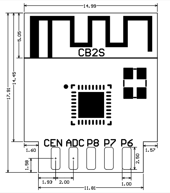

  • CB2S/WB2S flashing should follow pad layout, not silkscreen
    #14 21086488
    Posts: 14755
    Rate: 12881

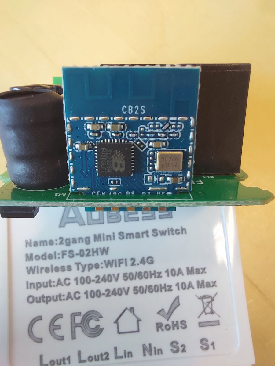

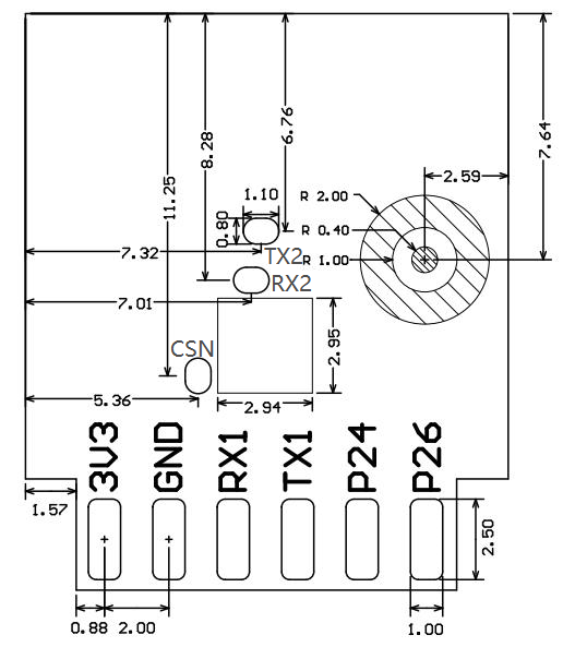

    Please provide a better quality photo of your WiFi module. The photo you posted seems to suggest that your WiFi module has invalid silkscreen marking and the marking of the pads are swapped.

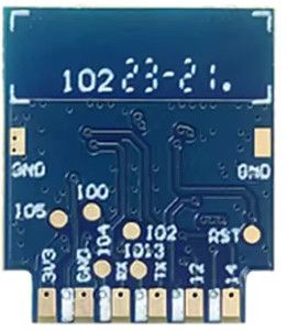

    When flashing CB2S/WB2S, always refer to this picture:
    Technical diagram of a WiFi module with pin labels and module dimensions.
    I already had CB2S/WB2S with a different silkscreen markings and I know that they should be flashed according to the picture from the documentation. The markings can be ignored. They are a human error.

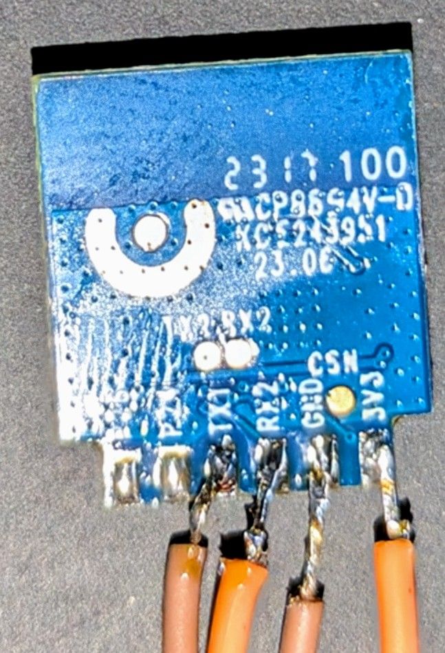

  • RX and TX pads are swapped on the WiFi module

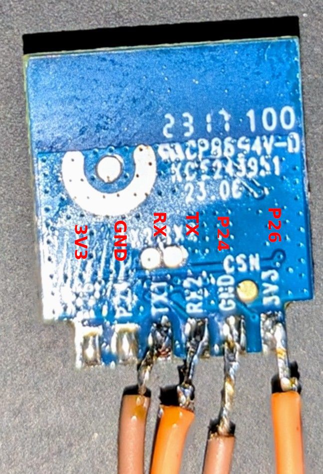

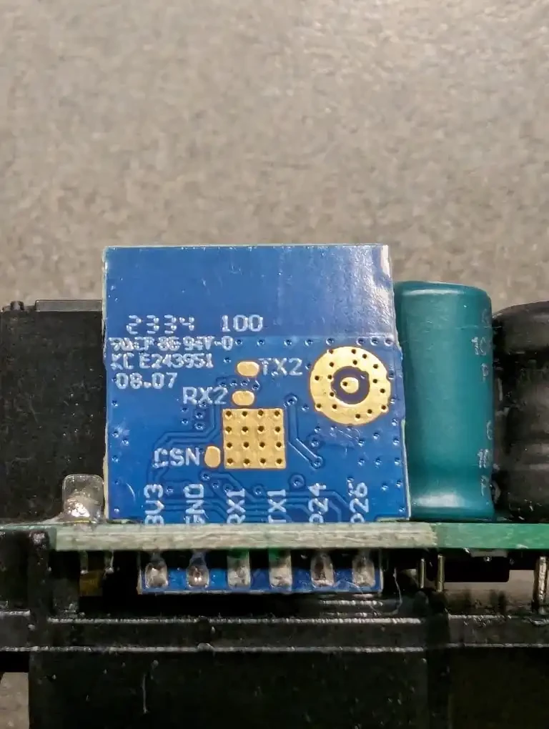

    #15 21086597
    Pete0815
    Posts: 34

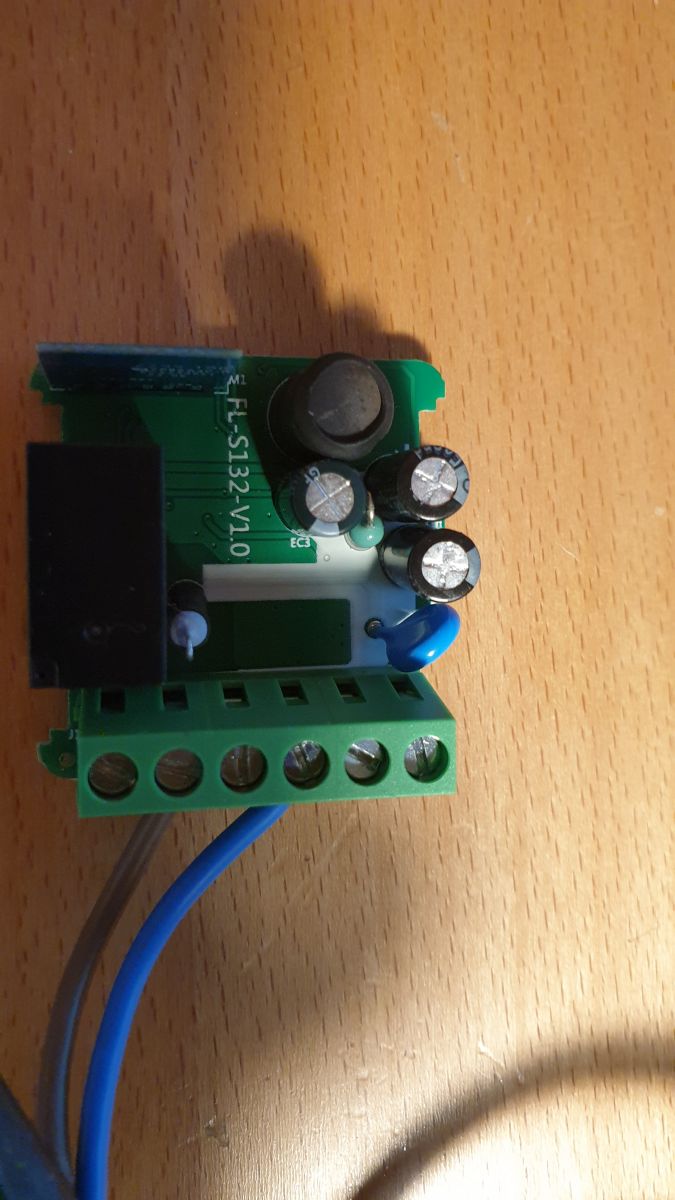

    Ooooh, yes. I only recognized that RX2 marking must be wrong as mentioned in several guides but RX & TX is swapped. First try and success. Thank you
    Image of a blue circuit board with visible markings TX2 RX2. The board has connected wires.
  • Incorrectly marked modules appear to be common
    #16 21086707
    Posts: 14755
    Rate: 12881
    No problem, I think that I even did the same back when I first found that strange silkscreen issue. Luckily the module survived.
    Judging by the fact that you are not the first person to have this issue on our forum, I can observe that those incorrectly marked modules must be quite common.

  • Incorrect CB2S pinout label caused flashing issue
    #17 21332287
    fortunatornforty76
    >>21086597
    I have the same WIFI module. It seems impossible but there is an error in the writing on the back side. Using the correct pinout, ignoring the printed text, I was able to flash. You can compare the pinout with online photos of other CB2S. You can even compare ESP02S which has the same pinout and can directly replace CB2S
    WIFI module CB2S with visible pin markings on a blue board.
    Image of a WIFI module with clearly visible pins and markings. Understanding the Aubess FS-02HW Mini Smart Switch: A Detailed Look at Chip CB2S BL2028N
    WIFI module with labeled pins 3V3, GND, RX, TX, P24, P26.

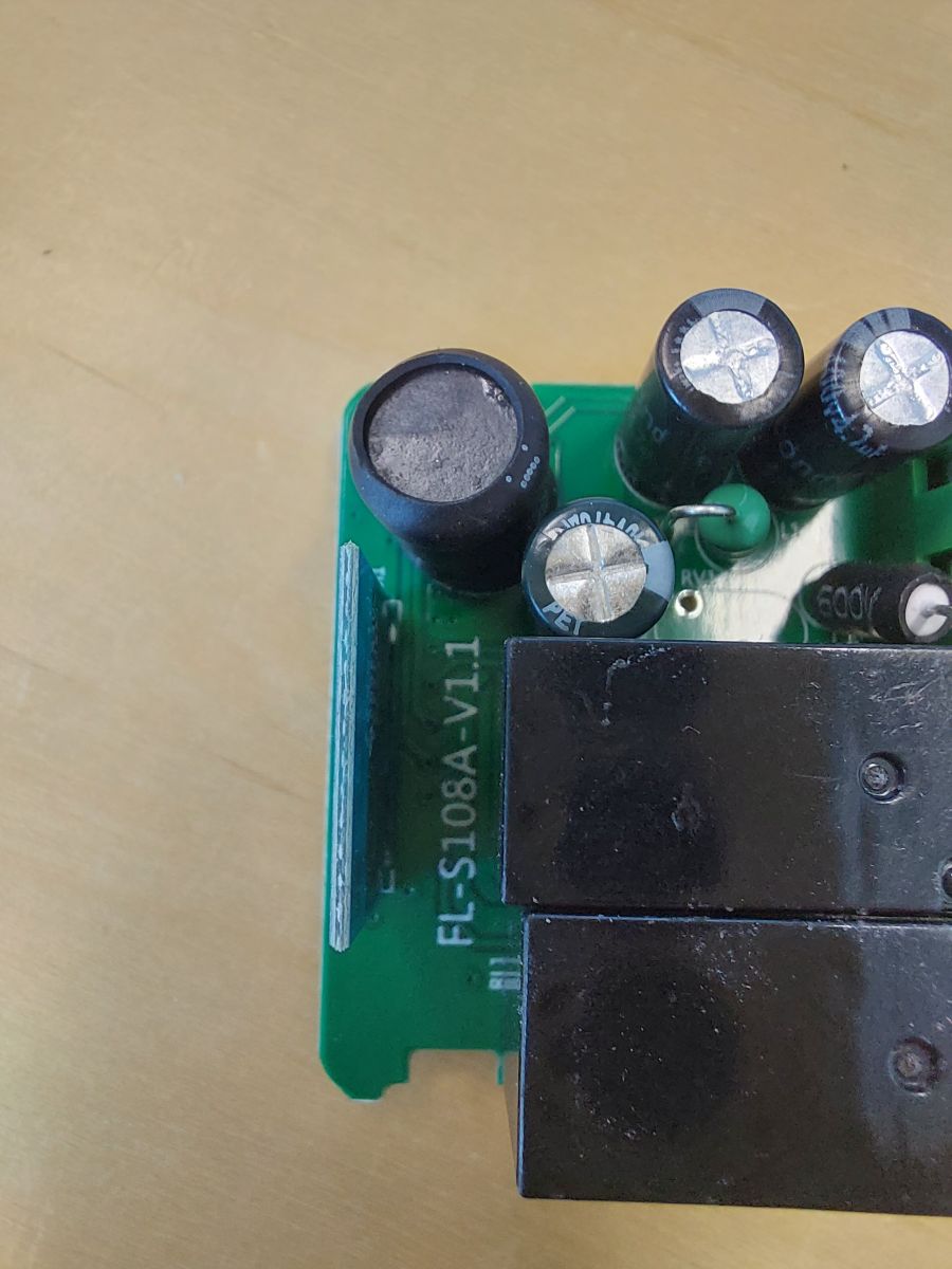

    The switch flashes and works properly, but compared with the other mini switches, it's temperature is very high at 80-85 degrees reported. Other switches idle at 40-50. I have the PowerSave 1 enabled.
  • #19 21438559
    Posts: 14755
    Rate: 12881
    Maybe try swapping CB2S with a module from a device with lower temperature?
    This way you will be able to tell what's the reason of the heat - whether it's the WiFi module or the PCB circuit.

    The modules despite the wrong pinout labels are fine. The relays seem to get quite hot, even if there is no current passing by. Perhaps they need replacing.

Why do I see two RX2 labels on CB2S, and which pins do I use to flash?
That second RX2 is a silkscreen error. Use RX1/TX1 for flashing; UART2 is only for debug at 115200. Expert quote: "For flashing, we are using RX1 and TX1, not RX2/TX2 pair." [Elektroda, p.kaczmarek2, post #20595325]
My CB2S shows no bus when wiring RX/TX as labeled—what's wrong?
Your module likely has swapped silkscreen labels. Ignore the printed RX/TX text and wire per the Tuya pinout. One user fixed flashing immediately after swapping RX and TX. [Elektroda, Pete0815, post #21086597]
What’s the correct baud rate and debug UART on CB2S?
Use UART2 for debug logs at 115200 baud. Flash the firmware over UART1 on RX1/TX1. This split avoids confusion between flashing and logging lines. [Elektroda, p.kaczmarek2, post #20595325]
How do I reliably enter bootloader and start flashing?
Desolder the module and use this sequence: 1. Wire RX, TX, GND; leave 3.3 V from CB2S temporarily disconnected. 2. Start the flasher; momentarily short the module’s 3.3 V wire to GND. 3. Reconnect 3.3 V to the power supply; flashing should start. Ensure your USB‑UART can supply adequate current. [Elektroda, p.kaczmarek2, post #21086320]
Which chip type should I choose in OpenBK/BK flasher for BL2028N?
Select BK7231N. Do not choose BK7231T. BL2028N aligns with the N variant for flashing and SDK compatibility. [Elektroda, p.kaczmarek2, post #20639767]
Can I flash CB2S in-circuit, or should I desolder it first?
You can try in-circuit, but shared rails and unstable 3.3 V often block entry to bootloader. Desoldering, then using the short‑to‑GND boot trick, is the reliable path. [Elektroda, p.kaczmarek2, post #21086320]
How do I back up firmware and extract the GPIO template?
Use BK7231GUIFlashTool to make a full 2 MB backup first. The tool can parse that backup and extract GPIO assignments, saving manual reverse‑engineering time. [Elektroda, p.kaczmarek2, post #20595325]
