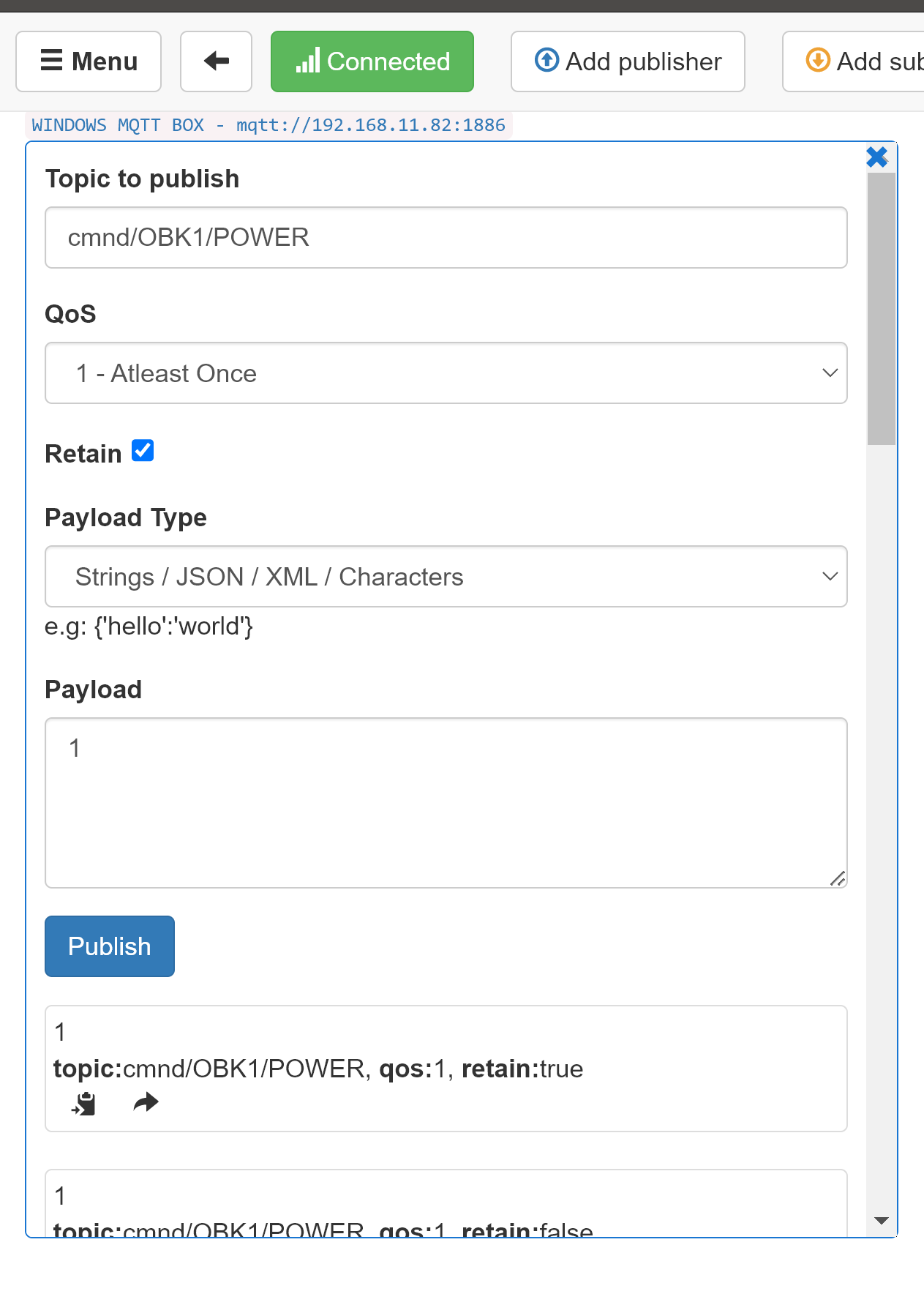

    I would like to switch the device on/off via MQTT. Which MQTT path do I have to use specifically for this? What exactly do I have to send to which topic?
    Thanks

    Well, the Tasmota syntax is supported.
    cmnd/obkDev123/POWER
    with payload
    or On, or Toggle, or Off...

    I test this with mqtt Box and I test it with iobroker and mqtt adapter ... I can see all datapoints but I can't toggle power with this command.
    Can you help ?
