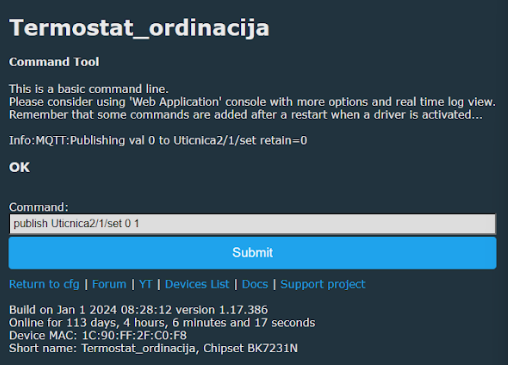

    OBK publish command
    OBK provides multiple commands for publishing data, but most important is just publish command.
    publish [TopicName] [Payload] [bRawMode]
    First argument is MQTT topic name, second is payload, third is optional, used to strip prepended OBK device name to the topic name.
    The payload can include escaped quotation marks, I will show an example soon.

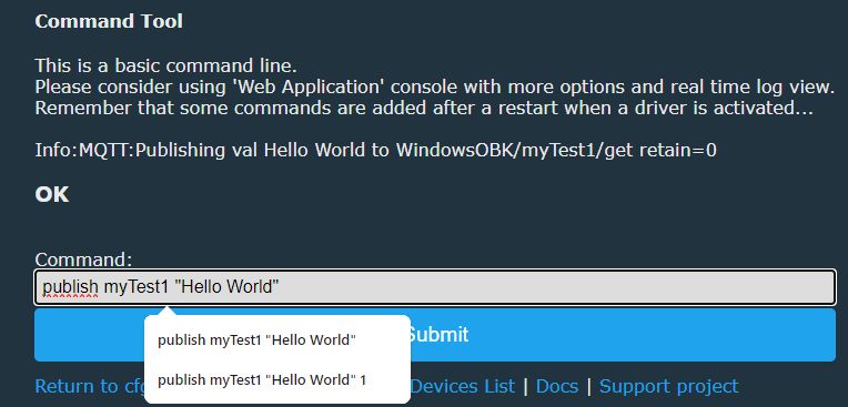

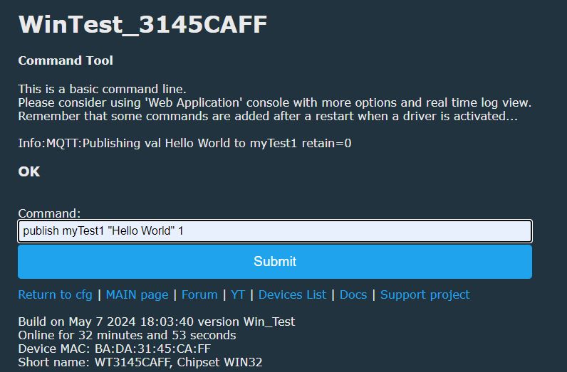

    The bRawMode disabled prepending OBK prefix, let's see how it looks in both cases:
    Command tool interface with an example MQTT command.
    Screenshot of the command input tool for OpenBeken.
    Can you spot the difference? Yes, one command has "WindowsOBK/" and "/get" added.
    For more information on commands, see: https://github.com/openshwprojects/OpenBK7231T_App/blob/main/docs/commands.md

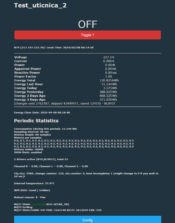

    Controlling OBK device from OBK
    Let's say that your target device is called "Uticnica2". It's OBK device, so it follows naming here:
    https://github.com/openshwprojects/OpenBK7231T_App/blob/main/docs/mqttTopics.md

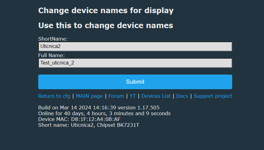

    It's important to remember that short name is used for MQTT:
    Screenshot of the device name change interface in OpenBeken.
    So, the publish to control relay will use name Uticnica2/1/set.
    1 there stands for channel index.
    Then, payload can be either 0 or 1, to set it on or off.
    So the full command is:
    publish Uticnica2/1/set 0 1
    Let's run it:
    OpenBeken thermostat tool panel with MQTT command
    The following command should change the state of target device accordingly.
    Screenshot of the OpenBeken device interface named Test_uticnica_2 showing measurement data and status.

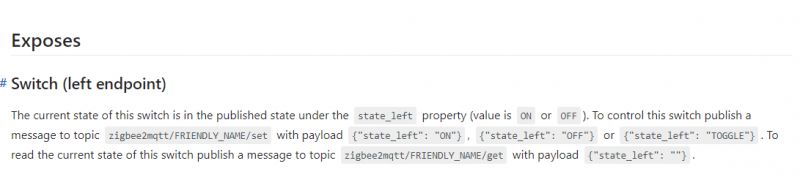

    First, let's look up the topics of Zigbee2mqtt device I have:
    https://www.zigbee2mqtt.io/devices/TS0012.html
    As you can see, there is a clear instruction how to control it, but can OBK do it?
    Excerpt from documentation on controlling a switch using MQTT.

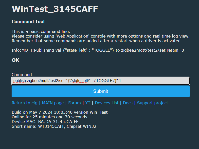

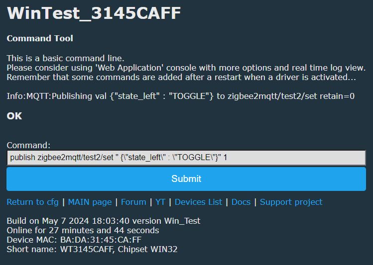

    Let's try executing:
    publish zigbee2mqtt/test2/set " {\"state_left\" : \"TOGGLE\"}" 1
    Screenshot showing the command input tool in WinTest_3145CAFF.
    The state of Zigbee device was changed. It works correctly.
