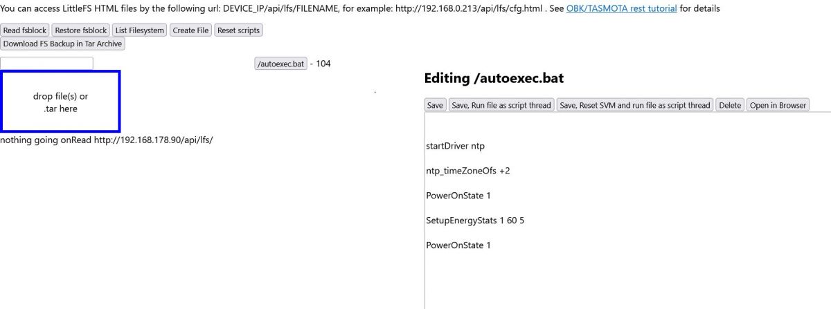

    Hi,
    I currently have this startup command
    PowerSave 1; startDriver NTP; SetupEnergyStats 1 60 60
    OBK Startup Command Line: PowerSave, startDriver NTP, SetupEnergyStats not executing
    But I'm finding that the SetupEnergyStats command isn't being run. I can enter the same command in the web application, Logs tab, command box and they start instantly.
    The PowerSave command is being started, I can see the power save messages in the Logs tab.
    So what am I missing or done wrong?
    #2 20591726
    Posts: 14755
    Rate: 12877
    Hello, the solution is on the screenshot:
    We are supporting Tasmota syntax, which means you have to type "backlog" first.
    But most likely we will change it to be a default-backlog or something...

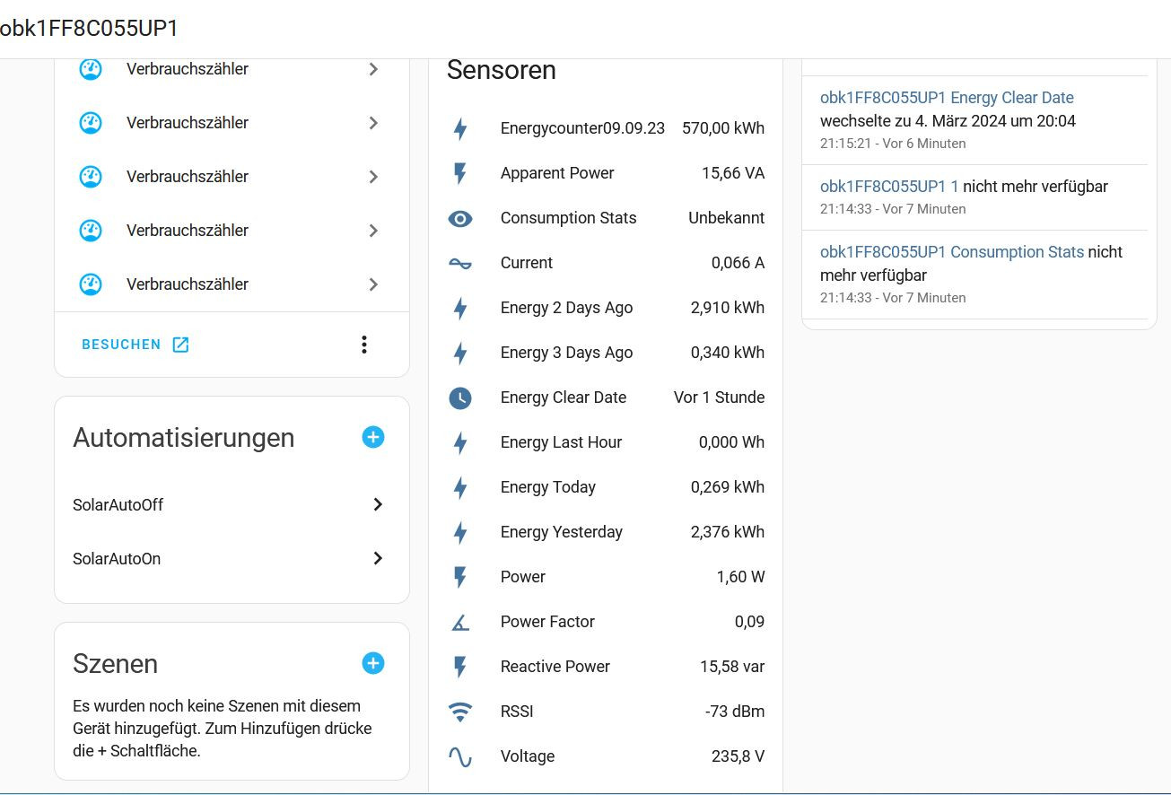

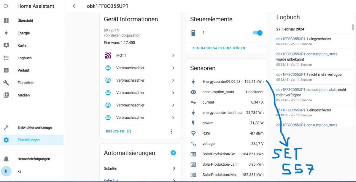

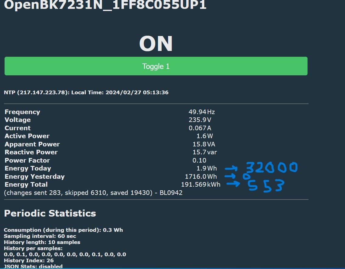

    #3 20981927
    kellers
    Tasmota console control screen with energy consumption and power parameters. User interface for editing files in Tasmota Screenshot of Home Assistant interface displaying device information and energy statistics.
    How can I set the value ?
    Today 1.9 Wh > 3700 Wh
    Total 191.569 kWh > 555.000 kWh
    And can I send frequency 49.94 with MQTT ?
    Build on Feb 9 2024 13:55:22 version 1.17.455
    Thx

  • #4 20981946
    Posts: 14755
    Rate: 12877
    What would you like to set, can you clarify? Do you want to set a total usage value? Total usage value is for statistics, I don't think there is a way to set it, but I can consider adding something like that for you.
    Regarding frequency, we're working on extending the HASS Discovery:
    https://github.com/openshwprojects/OpenBK7231T_App/pull/1102

    #5 20982041
    kellers
    Zitat:
    What would you like to set, can you clarify? Do you want to set a total usage value? Total usage value is for statistics,-------------
    https://github.com/openshwprojects/OpenBK7231T_App/pull/1102 ----------- :) Top !
    Yes, I want to set this value,
    Can you help ?

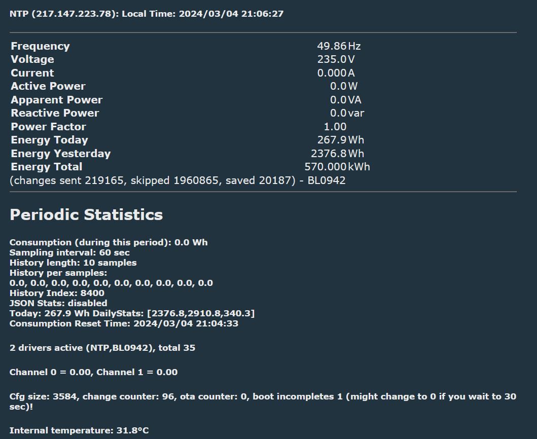

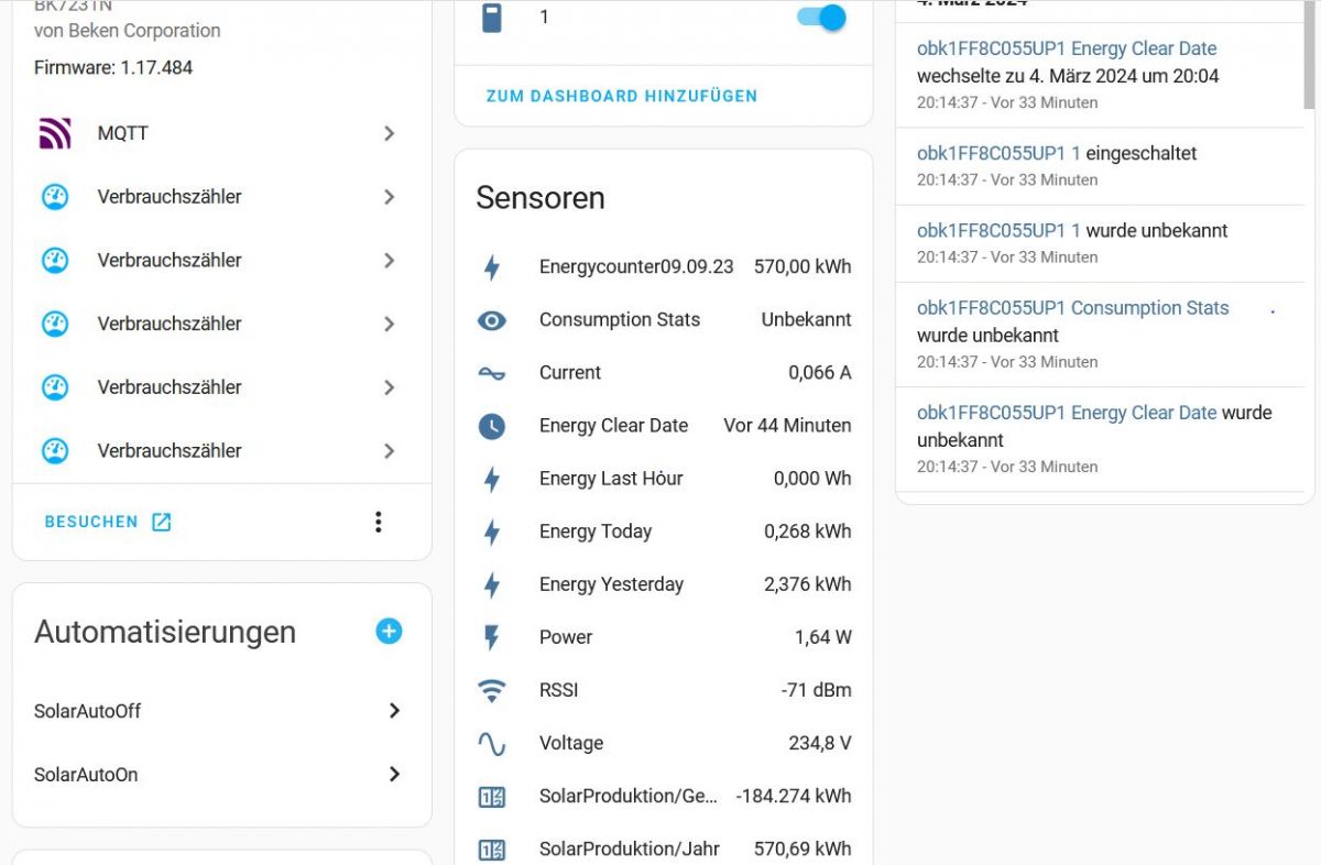

  • #6 20990141
    Posts: 14755
    Rate: 12877
    I have double checked and it seems you can use this:
    EnergyCntReset 1234
    Where 1234 is the new value to set.

  • #7 20990519
    kellers
    I'm thanks so much its done :) and HASS make automatic :)
    Example for 570 kWh:
    EnergyCntReset 570000
    I have send a Coffee ;)
