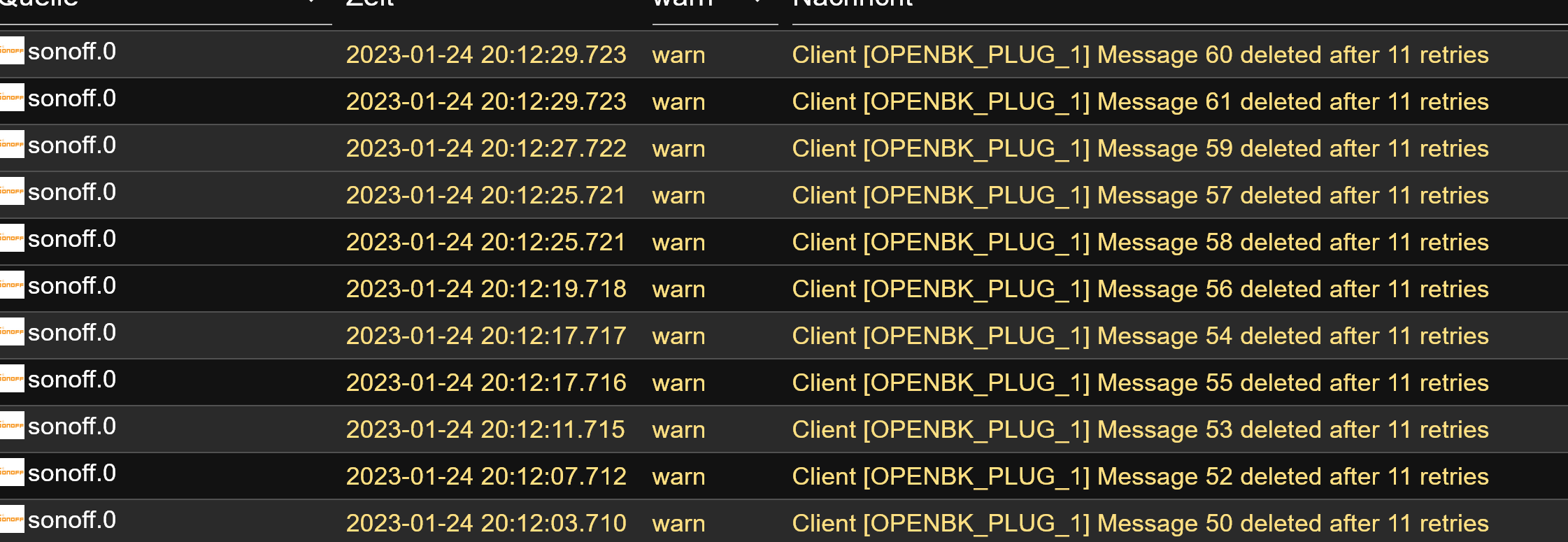

    There is also a Warning error from Sonoff Adapter :
    OpenBK: Control BK723T Smart Plug & Powermeter WSB2 in ioBroker via MQTT Adapter
    thx Urlchecker

    hello, so far everything works fine, but the Sonoff adapter gives warning messages every second. This fills up the log file and causes the system to crash. What causes these warning messages?
    Thanks for the help OpenBK: Control BK723T Smart Plug & Powermeter WSB2 in ioBroker via MQTT Adapter [img-0]
