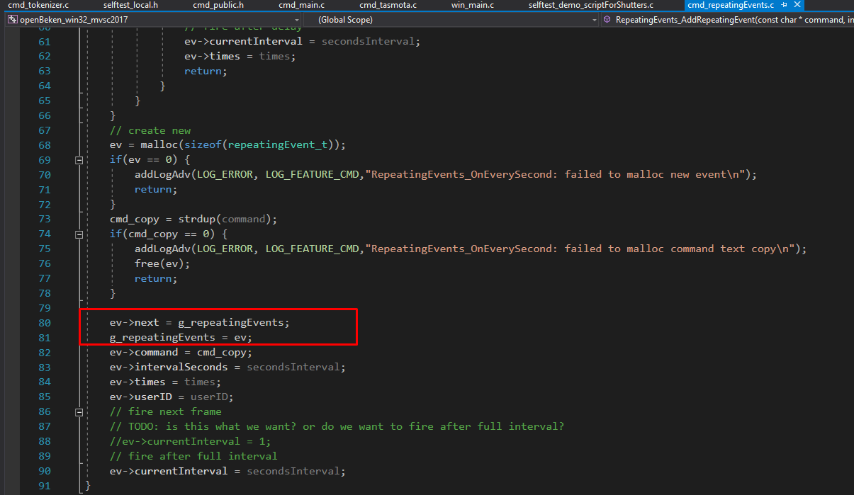

    #6 20430513
    Posts: 14755
    Rate: 12881
    skyvladik wrote:
    backlog POWER 1; addRepeatingEvent 5 -1 POWER 0; addRepeatingEvent 10 -1 POWER 1
    The following code will try to set POWER 0 every 5 second and also try to set POWER 1 every 10 second. I am not sure right now what is the order of the operations, but you will basically try to set POWER to 0 and to 1 in a single frame. This doesn't seem correct.
    You know what, let me check...
    [OpenBeken] Switching on the relay for 15 minutes, every 60 minutes.
    yea, that's what I thought. The latter repeaters are added to the start of the linked list.
    So, basically your code does this:
    - wait 5 seconds
    - set power to 0 (caused by addRepeatingEvent 5 -1 POWER 0)
    - wait 5 seconds
    - set power to 1 (caused by addRepeatingEvent 10 -1 POWER 1)
    and again... and so on.
    This is logically not correct and this cannot work. In your case relay is powered on only for a little fraction of a second, just for a few instruction cycles.
