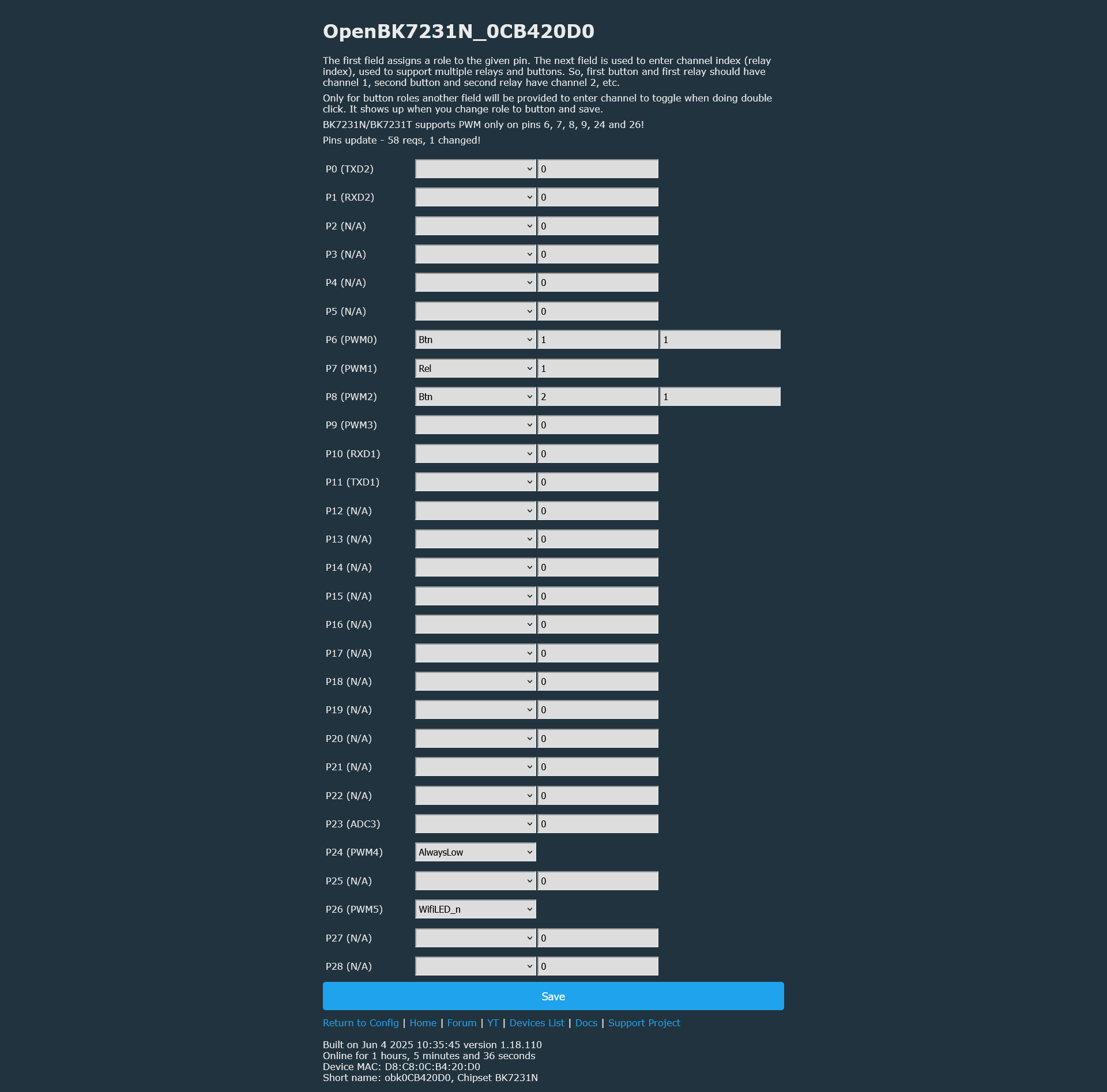

    I bought a wireless (WiFi + 433 MHz RF) 2-channel relay with a CB2S module and flashed it with OpenBK7231N.
    Everything works fine, and the extracted pinout matches my measurements:
    Button (Channel 1) on P6
    WiFi LED on P26
    Relay (Channel 2) on P24
    Button (Channel 2) on P8
    Relay (Channel 1) on P7
    But where are the default assignments defined? I’d like to modify the logic (using autoexec.bat?) to achieve the following behavior:
    - Button 1 should toggle Relay 1 (same as the default behavior)
    - Button 2 should NOT toggle Relay 2, but instead should turn off Relay 1, wait 500 ms, and then turn it back on (to change the color of a pool lamp)
    The lamp only uses 12V AC (L and N) and changes color each time it's power-cycled quickly.
    I already tried:
    addEventHandler OnClick Btn2
    setChannel 1 0
    delay 500
    setChannel 1 1
    in autoexec.bat but it only turned on the light.
    I’ve explored the native web GUI and the web app, but I can’t find a way to customize this behavior.
    Any hint will be welcome!

    Alright, got it working now.
    Was a bit easier than expected! I was not aware of Channel 1 being Relay 1, Channel 2 being Relay 2 and so on.
    But basically:
    autoexec.bat:
    Now I added a second file via Web App > Filesystem > Create file called
    change_color:
    (Yes, 0.05 s is 50 ms and not 500 ms but this works even better to my application.)
    OpenBK7231N CB2S Relay: Custom Button Logic for Pool Lamp Color Change
    Pin setup:
    - Both Btn pins are set to Channel 1 in native interface
    - Relay 2 pin is set to AlwaysLow in native interface (so that it does not wear out while being unused)
    OpenBK7231N click handler uses pin index 8
