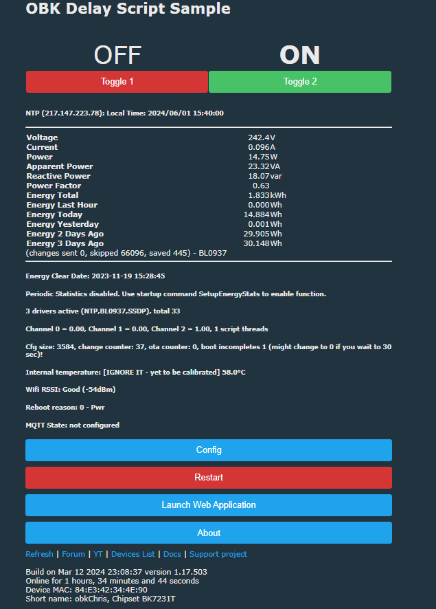

    Here's the original script that runs fine unmodified:
    // advanced delay script
    // See: https://www.elektroda.com/rtvforum/topic4032982.html
    // When user toggles relay on, relay will turn off after delay
    // The current delay value is displayed on www gui
    // The constant delay value is displayed on www gui and fully adjustable and remembered between reboots
    // Used channels:
    // Channel 1 - relay
    // Channel 2 - current countdown value
    // Channel 3 - constant time for countdown
    // this will make channel 3 save in memory
    setStartValue 3 -1
    // if channel 3 is not set (default first case), set it to 15 seconds11
    if $CH3==0 then setChannel 3 15
    // display text field for channel 3 on www page
    setChannelType 3 TextField
    // set label
    setChannelLabel 3 TurnOffTime
    // display timer seconds (read only) for channel 2 on www page
    setChannelType 2 TimerSeconds
    // shorthand for setting channel 2 to value of channel 3
    alias turn_off_after_time backlog setChannel 2 $CH3
    // shorthand for clearing current timer value
    alias on_turned_off setChannel 2 0
    // shorthand to set relay off
    alias turn_off_relay setChannel 1 0
    // check used to turn off relay when countdown value reaches 0
    alias do_check if $CH2==0 then turn_off_relay
    // an update command; it decreases current countdown by 1 and checks for 0
    alias do_tick backlog addChannel 2 -1; do_check
    // event triggers for channel 1 changing to 0 and 1
    addChangeHandler Channel1 == 1 turn_off_after_time
    addChangeHandler Channel1 == 0 on_turned_off
    // main loop - infinite
    again:
    if $CH2!=0 then do_tick
    delay_s 1
    goto again

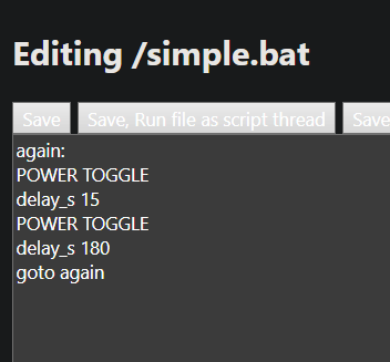

    What is interesting though, is that I replaced the setChannel commands with "POWER TOGGLE", and the script ran without crashing, so now I'm confused as to what is happening and why is it crashing
    Were you able to replicate this behavior?, should I wipe the device and test again?, I don't have another one to test so I would need to wipe to see if it's just a specific behavior to my device

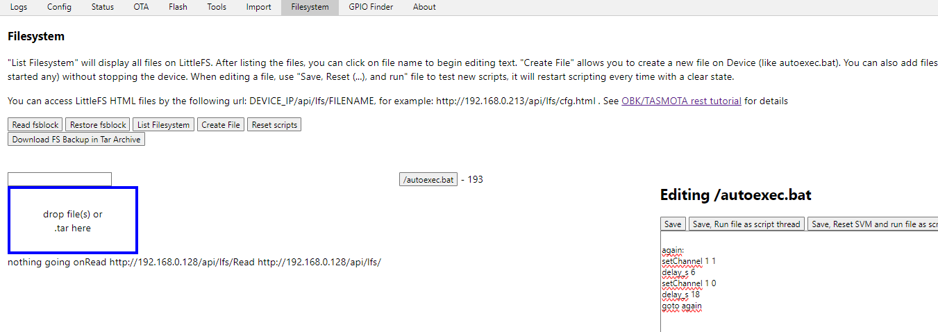

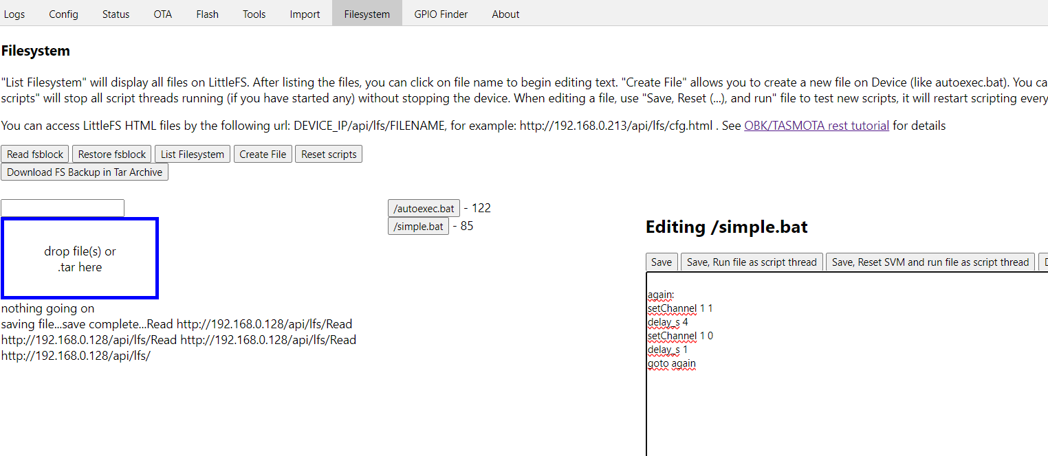

    This script seems to work for me:
    LittleFS filesystem user interface with editing of autoexec.bat file. Screenshot of the OBK Delay Script Sample interface showing voltage, current, and other energy parameters with buttons for configuration.
    what is your device exactly, what kind of template do you have?

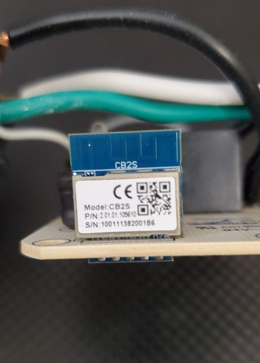

    The only difference is that i'm not running it as autoexec.bat only to avoid it constantly running at startup and crashing, instead i named mine "simple.bat" which shouldn't make a difference "i think"
    Here are the details of my device:
    and here are some images of the device itself:
    Packaging of a WiFi smart outlet with remote control and app functionality. Close-up of an electronic module labeled CB2S, with a visible QR code and serial numbers.
  • #6 21103545
    Posts: 14755
    Rate: 12881
    Still working, sorry:
    Screenshot of LittleFS file management user interface.
    So you're saying that:
    POWER ON
    etc, does not crash?

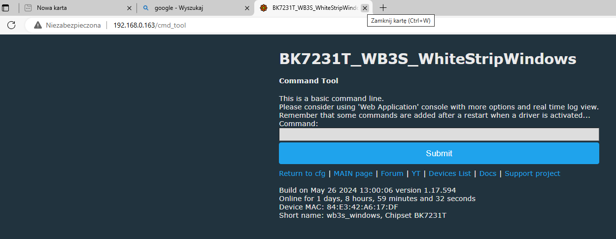

  • #12 21103608
    Posts: 14755
    Rate: 12881
    Ok what happens if you open this page:
    BK7231T_WB3S_WhiteStripWindows tool interface on a webpage.
    And enter your setChannel line there?
  • setChannel loop crashes while power toggles work
    #13 21103646
    angzero
    Level 4  
    Posts: 13
    No issue there, i can execute commands here and in the Log section in the webapp, its honestly inconsistent with its breaking so i'm not sure what is the trigger here and whether it is the setChannel command, as that works with no issue using the scripts posted on the OpenBeken github, then suddenly on a simple loop script like the one provided earlier, it crashes, but not when using the POWER TOGGLE or POWER ONOFF variants, and i'm not sure if anyone else has faced this or just me

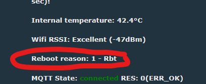

    #19 21105148
    DeDaMrAz
    Posts: 620
    Help: 34
    Rate: 130
    angzero wrote:
    How do you guys debug and test scripts efficiently to determine what crashes the system, is there a specific log level or settings that you use for script development and analysis ?
    On my end I would use a test device on a board that has logport exposed and log it via PuTTY with extra debug options selected from a web app then analyze the log for anomalies.
    Here is a question for you when your device crashed there is a feature in OBK on the index page that is giving a reboot reason, did you manage to maybe catch that info??
    Screenshot showing the device's reboot reason.
