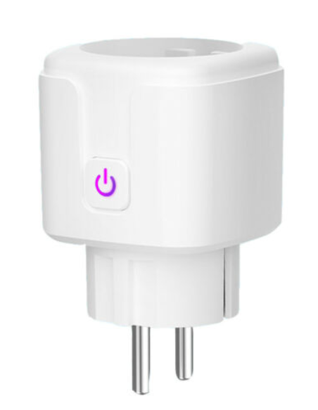

    Device used
    For the presentation, I used a WiFi-controlled LSPA9 socket based on the BK7231 chip:
    White LSPA9 WiFi socket with a power button.

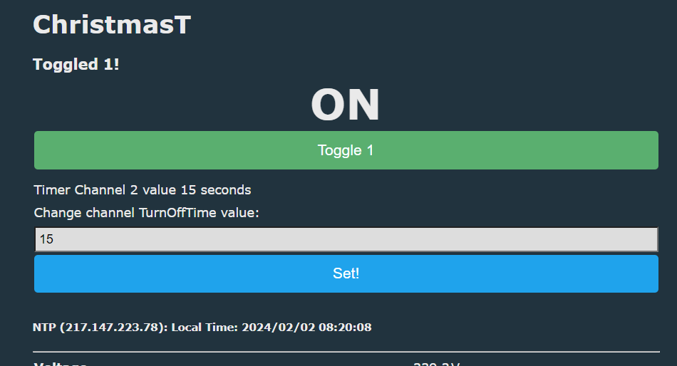

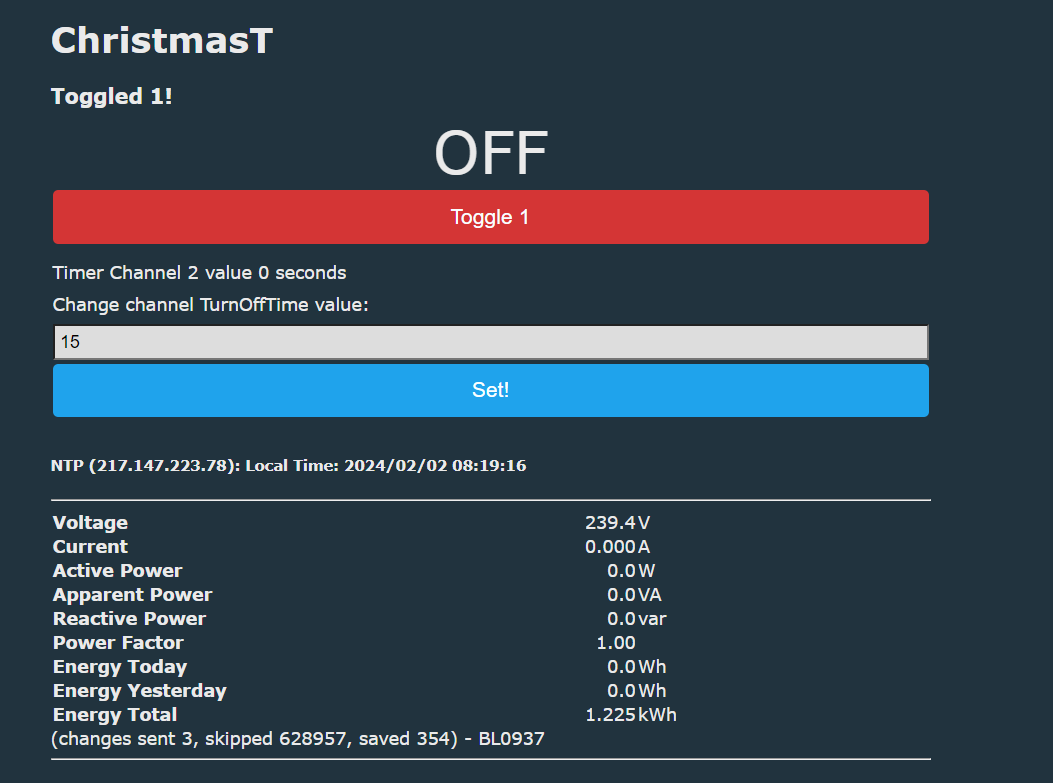

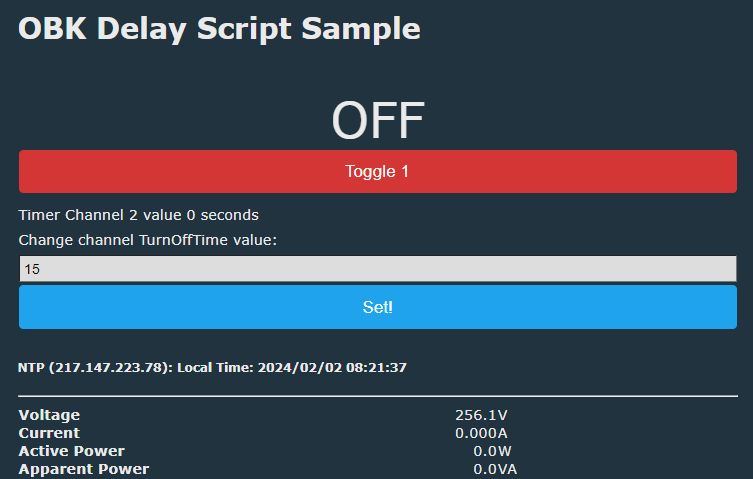

    After restarting the device, we get a modified panel:
    WiFi socket control interface with BK7231 chip, showing options for configuring shut-off time.
    You can see the relay switch button, the current countdown value and the countdown time setting on the panel.
    When the relay is turned on, the countdown starts:
    Screenshot of control panel interface for a relay with countdown timer.

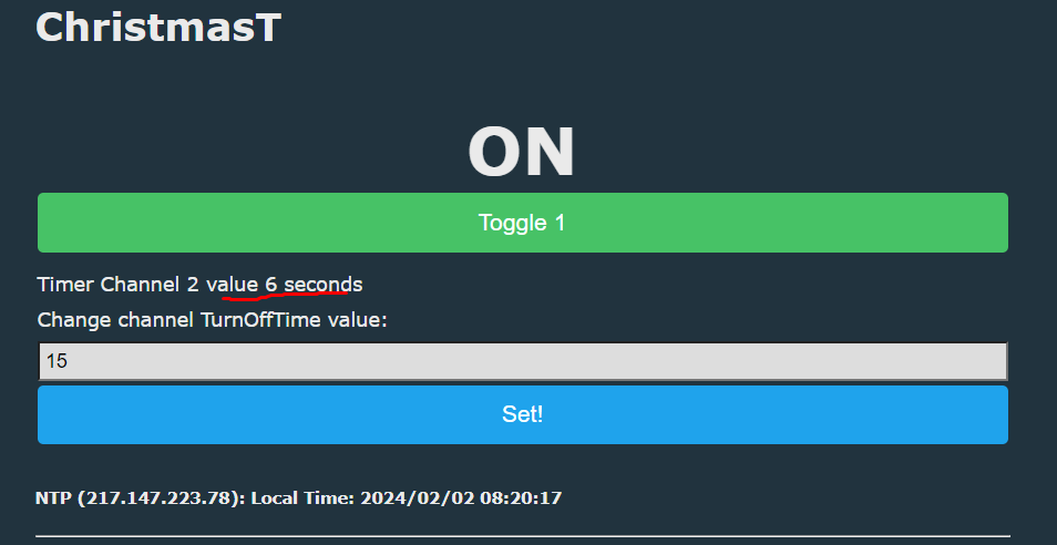

    The value of channel 2 decreases:
    OpenBeken control panel with countdown timer for WiFi relay

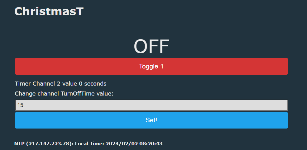

    After a while it reaches 0 and the relay opens:
    Control panel interface of LSPA9 socket with shutdown timer settings.
    The script is resistant to repeated power on and off, there is no way to break this logic.
