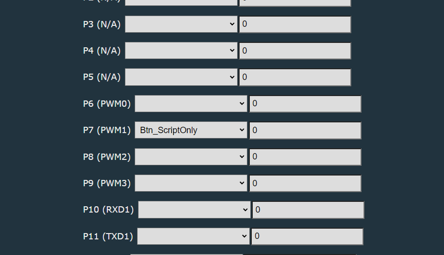

    #2 20335015
    Posts: 14770
    Rate: 12913
    Very clever way to get around the device limitations, although with the latest OBK updates (that weren' t in place at the time of creating automation from the first post) it should be possible to do it fully in script....
    Double click to change temperature...
    Let me see if I can come up with something similar....
    Ok ok, it will not be the same, I will use a simple CW strip simulation as an example:
    // SetButtonTimes [ValLongPress] [ValShortPress] [ValRepeat]
    // Each value is times 100ms.
    // Defaults:
    //  SetButtonTimes 10 3 5
    // more responsive hold:
    // shortcut for command. Repetas time is 10 sec, repeats count is 1
    alias add_turnoff_event addRepeatingEvent 10 1 led_enableAll 0
    alias do_brightness_action add_dimmer 5 1
    alias do_temperature_action add_temperature 5 1
    alias do_hold_action if $CH10 then do_brightness_action else do_temperature_action
    // toggles light state - not needed, done automatically
    addEventHandler OnClick 7 led_enableAll toggle
    // channel 10 describes mode - changing temperature or brightness
    addEventHandler OnDblClick 7 toggleChannel 10
    // turn on and do add_dimmer 5 with bWrapInteadOfClamp enabled
    addEventHandler OnHold 7 backlog led_enableAll 1; do_hold_action
    Code above does:
    - click turns on/off the strip
    - double click changes hold mode (adjust temperature or dimmer)
    - hold adjusts (as above) temperature or dimmer
    Simulation:
    It uses ScriptOnly button so it doesn't tries to toggle anything automatically, all is scripted:
    [Tutorial] Detached Mode for Openbeken wall switch
    If you look at my code, you can see how I handled determining whether we are in Dimmer adjust mode or a Temperature adjust mode:
    I've been wondering if the same approach could be used for your case with checking MQTT state?
    alias do_hold_action if MQTTOn then do_some_action else do_other_action
    but I am just here showing some random ideas, in general, your solution is good.
