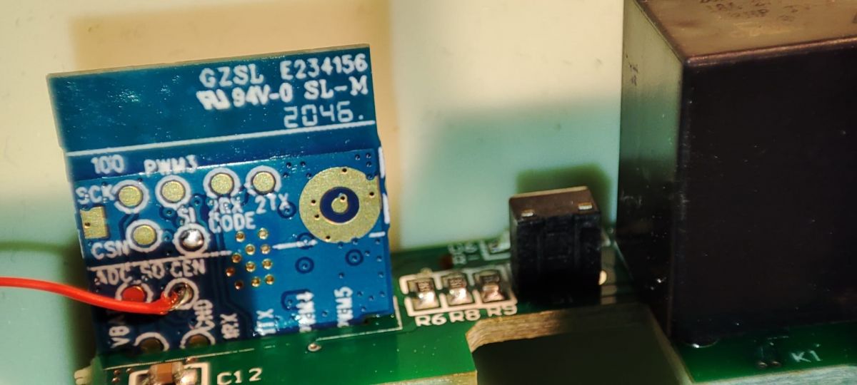

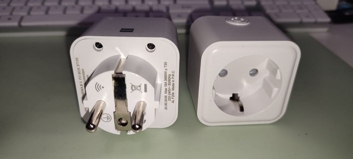

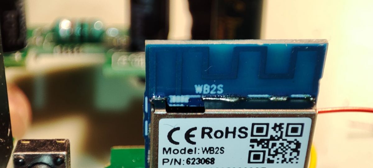

    Hello p.kaczmarek2,
    I have another smart device for the templates database. Is the Smart power plug from HEMA (Netherlands) with BK7231T (WB2S).
    HEMA (Netherlands) Smart Power Plug with BK7231T (WB2S) - Detailed Overview & Images

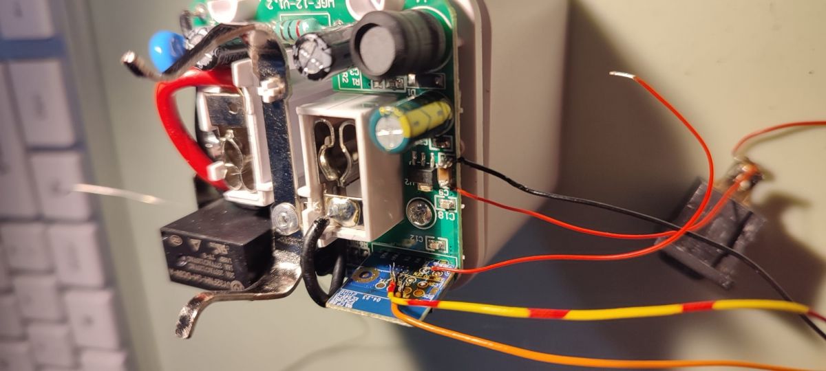

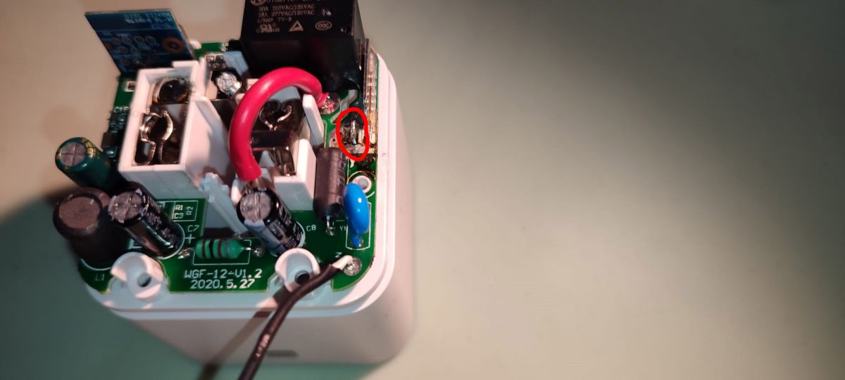

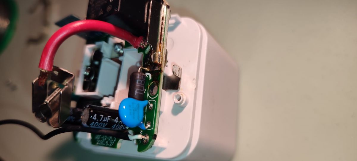

    To take the PCB out, I desoldered the marked locations:

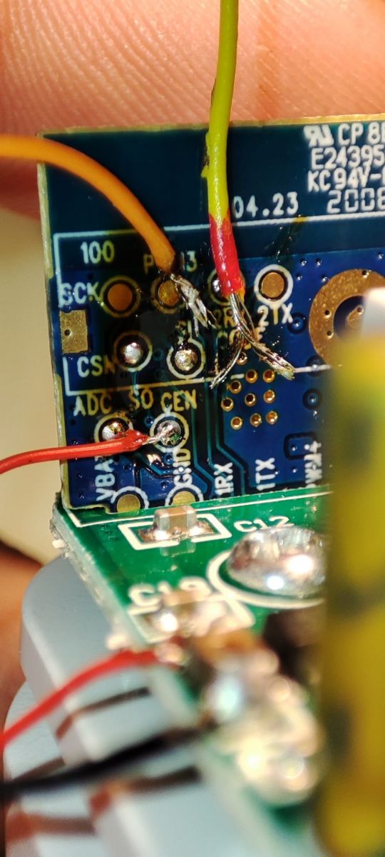

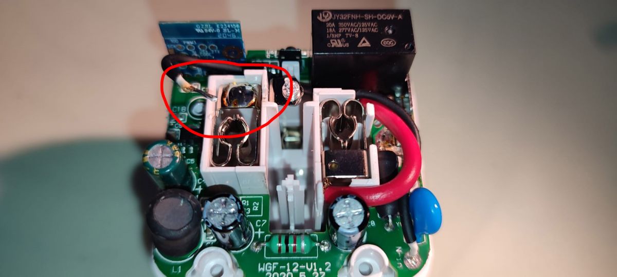

    For the second outlet I chose not to remove the PCB and to program it by scratching the via/track I marked in the photo:

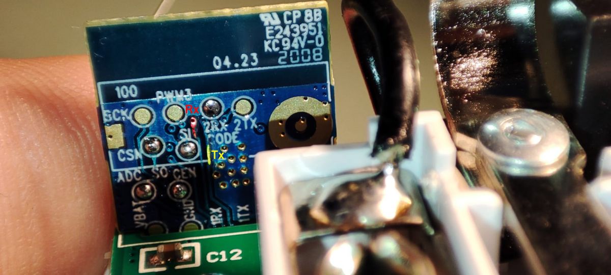

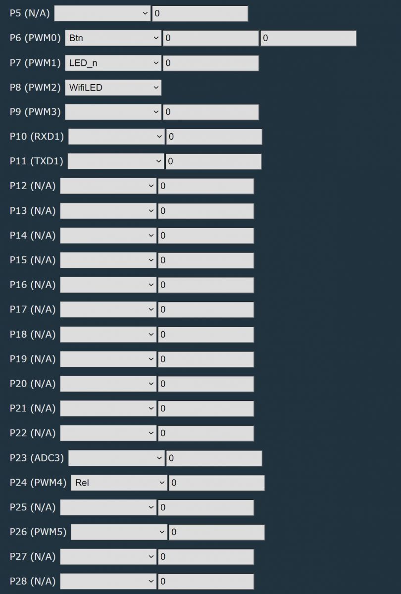

    And this is the pinout configuration:
