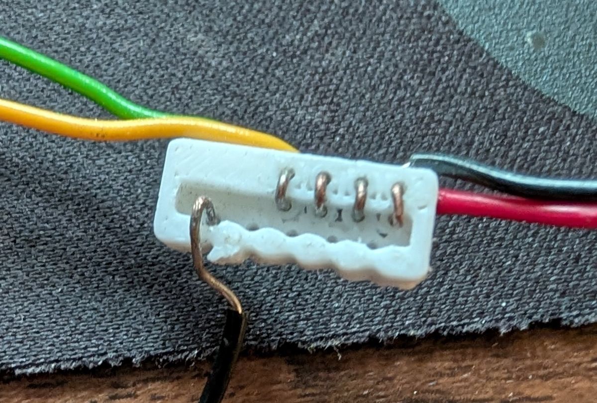

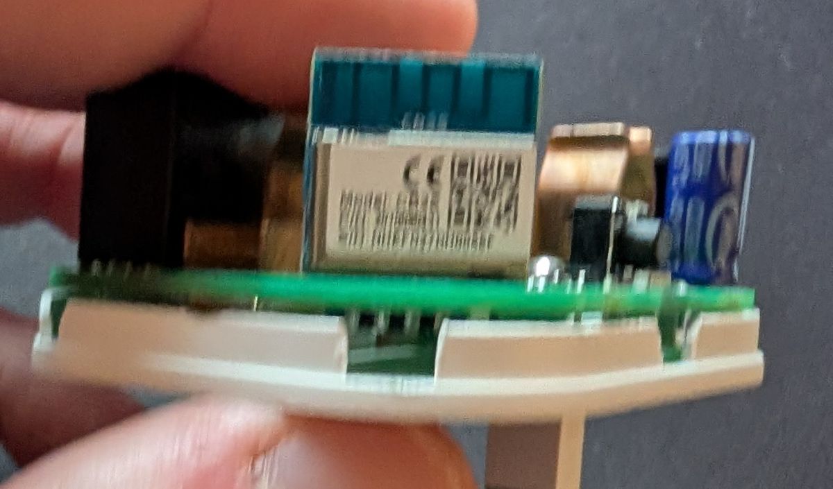

    Close-up of white connector with five colored wires attached to exposed pins Close-up of an electronic module with CE marking mounted on a circuit board
    So I didn't de-solder the chip, I've printed this little caddy and slipped it under the chip to flash it in place .... I'm not sure if this is anything new, I'm happy to share details on this if anybody is interested?

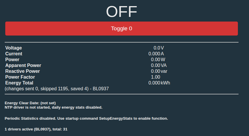

    Screenshot of OpenBeken interface showing all energy values at zero
    I do believe the driver for the BL0937 is running based on the screenshot .... I did play around in the OpenBeken Tools menu, and when the plug was under load I set the voltage, current and attempted to set the power values (though setting power failed). With some load going through the plug voltage does fluctuate seemingly at intervals showing either a value of 0.00 or 230v (sometimes over 400v), and current does similar (varies between some value and 0.00), however Power always shows 0.00
