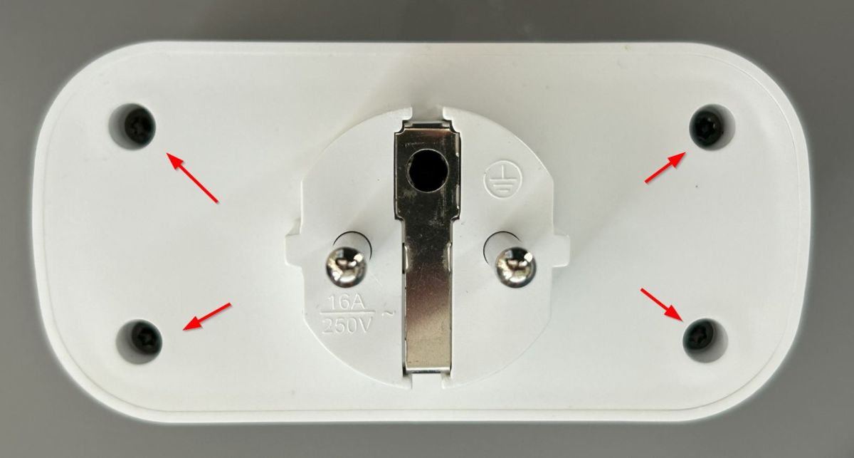

    The plug casing is secured with four screws on the back:
    Rear view of a white electrical plug with red arrows pointing to four screws.

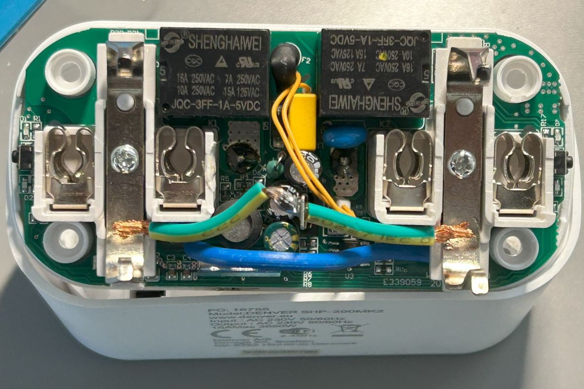

    Inside, a WB2S module is found:
    View of the inside of an electrical socket showing wires and electronic components.

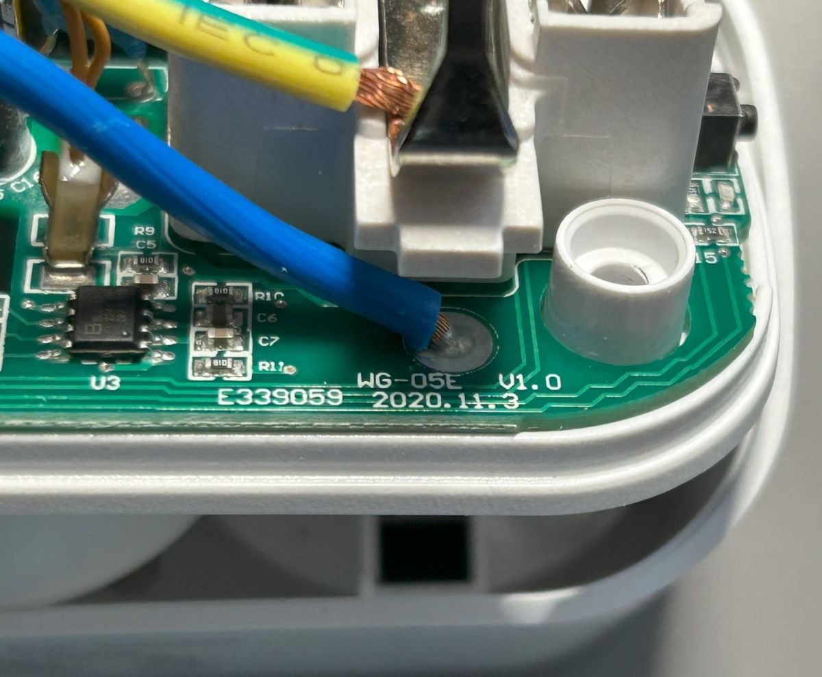

    The PCB itself is labelled as WG-05E:
    Close-up of a circuit board with attached wires and electronic components.

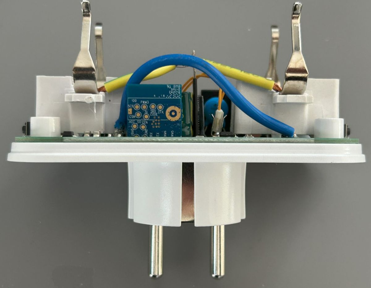

    The UART pins are not directly exposed, and the PCB seems to be soldered to the plug’s prongs, so desoldering didn’t look like an easy option.
    Interior of an electrical splitter with visible wires and electrical components.

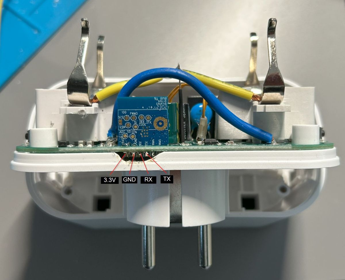

    I decided to simply cut a bit of the plastic in front to expose the pins:
    Interior of a smart plug showing electronic components and labels for 3.3V, GND, RX, TX pins.
    I soldered four wires to the pins (3.3V, GND, RX, TX) and connected to an USB UART. Then I used the BK7231 GUI Flash Tool to flash OpenBeken.
