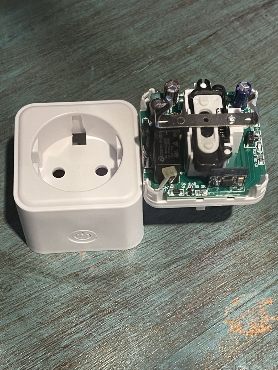

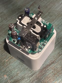

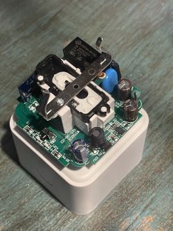

    Teardown CALEX Smart Powerplug EU plus 16A

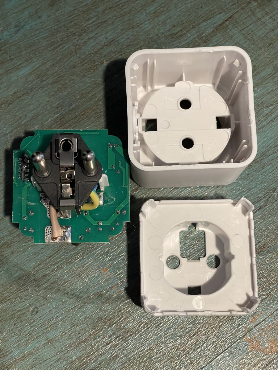

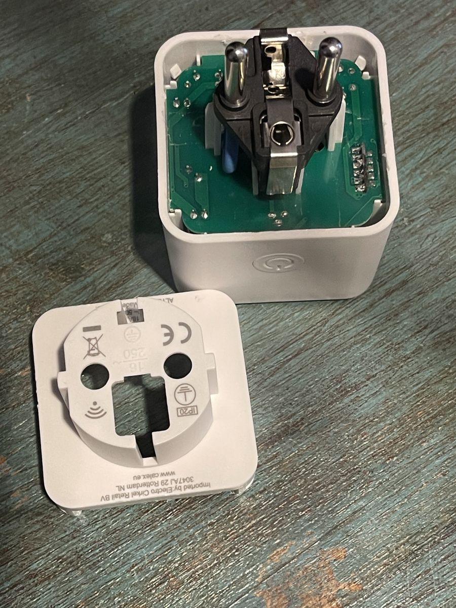

    This smart plug can easily be opened and flashed with 3.3v from the USB to UART converter without a problem.
    Only the module configuration is slightly different from the configuration as described in the first post.
    Contains
    - CB2S WiFi & Bluetooth Module
    - Chip: BK7231N
    Config OpenBeken for MQTT:
    - General Config:
    Flags:
    Flag 7 - [MQTT] [Debug] Always set Retain flag to all published values
    Flag 10 - [MQTT] Broadcast self state on MQTT connect
    Flag 19 - [MQTT] Always publish channels used by TuyaMCU
    Flag 21 - [MQTT] Retain power channels (Relay channels, etc)
    - Calex Modul Configure
    P6 (PWM0) - Rel 0 0
    P7 (PWM1) - Bt 0 0
    P8 (PWM2) - LED 0 (Led 2)
    P26 (PWM4) - LED_n 0

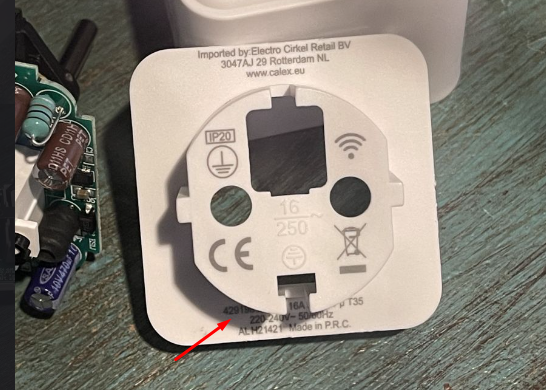

    Posts: 14756
    Rate: 12881

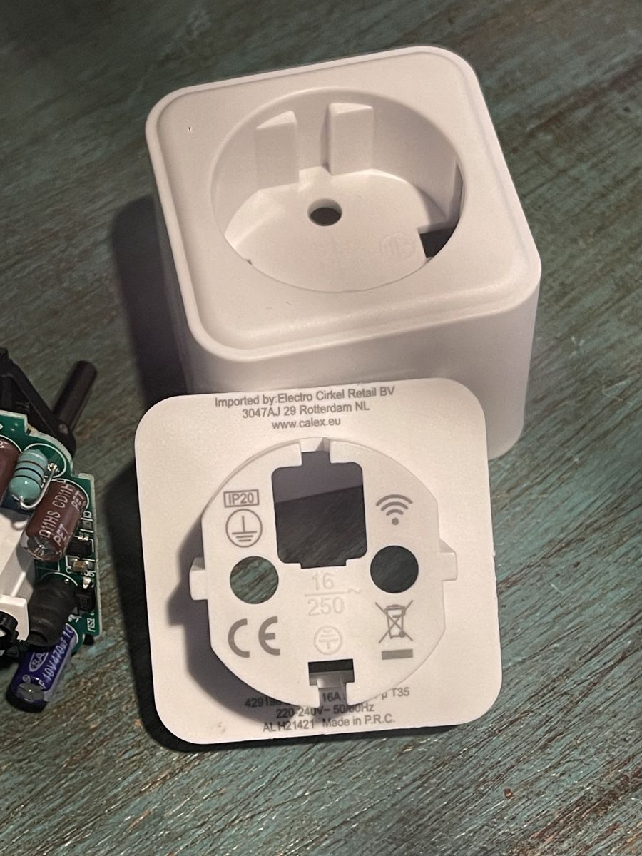

    What model number is here?
    Disassembling CALEX Smart Powerplug EU Plus 16A: Insights into CB2S WiFi & Bluetooth Module
  • #5 20450298
    pplatteel
    Model no. 429198.2
