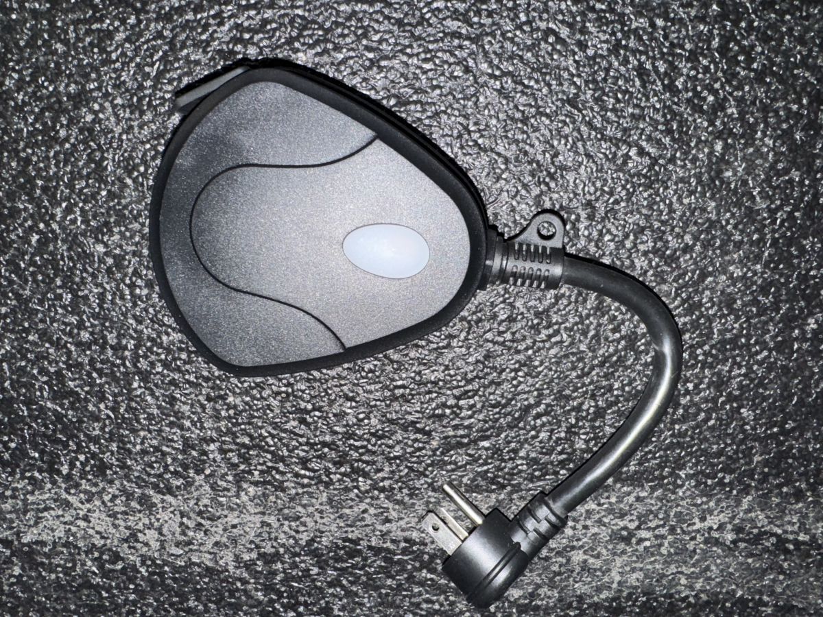

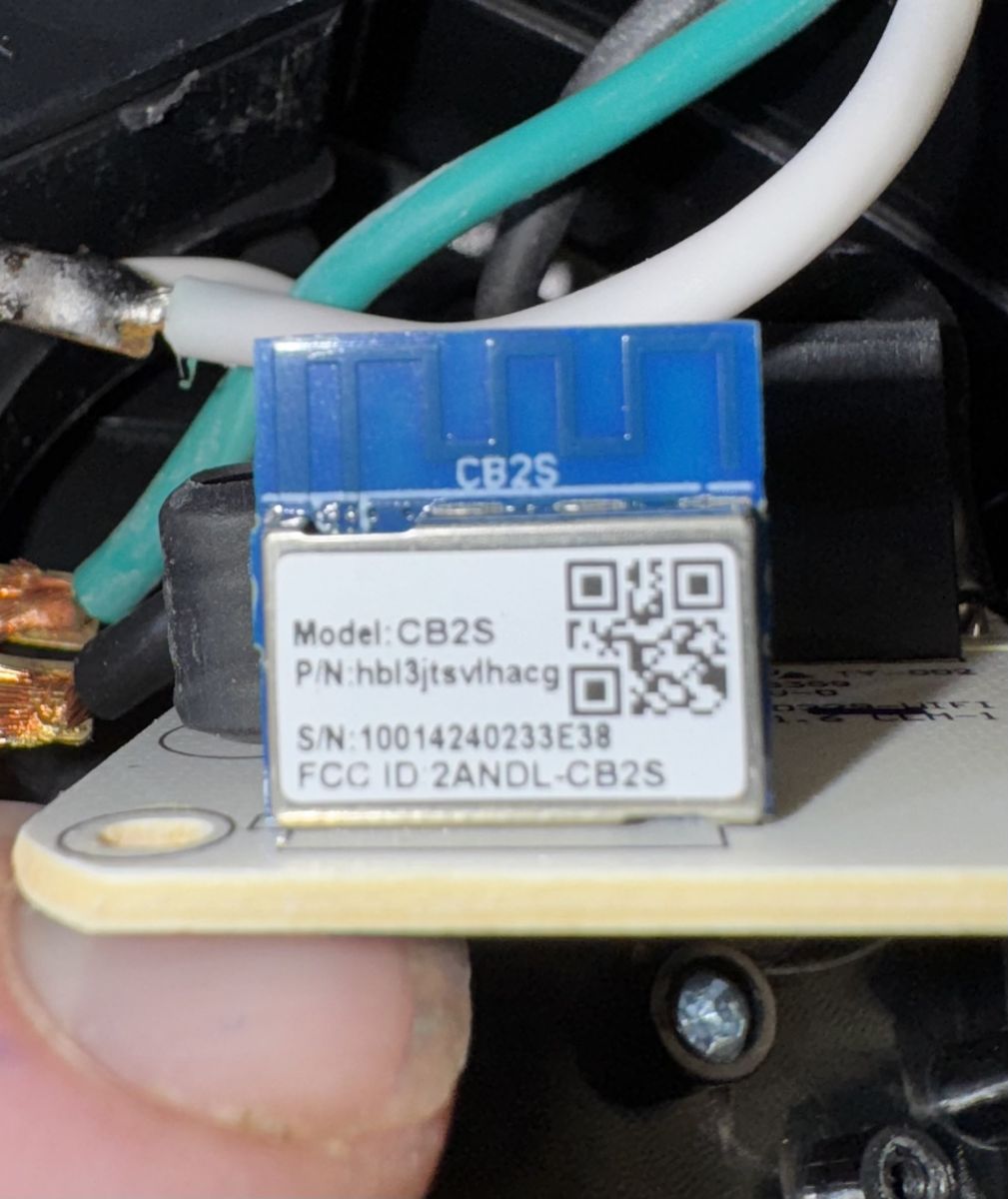

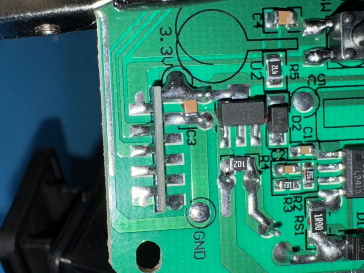

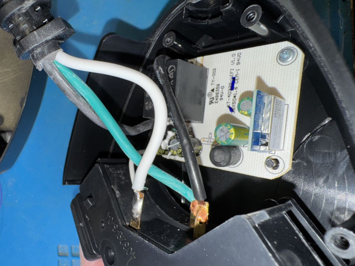

    The Feit PLUG3/WIFI/WP/2 was found at a local liquidation store, however, I don't know the original retailer. Upon teardown, inspection reveals use of the CB2S/BK7231N module. Attempts at flashing the module in-circuit were unsuccessful using either GUI or CLI flashers. I desoldered the module from the main PCB with the typical flux and desoldering braid, and flashed using an FTDI-uart adapter, no separate 3v3 was used. I successfully flashed six plugs this way to firmware 1.17.762.
    pin 6 is input button to control relay
    pin 8 is output from CB2S to relay.
