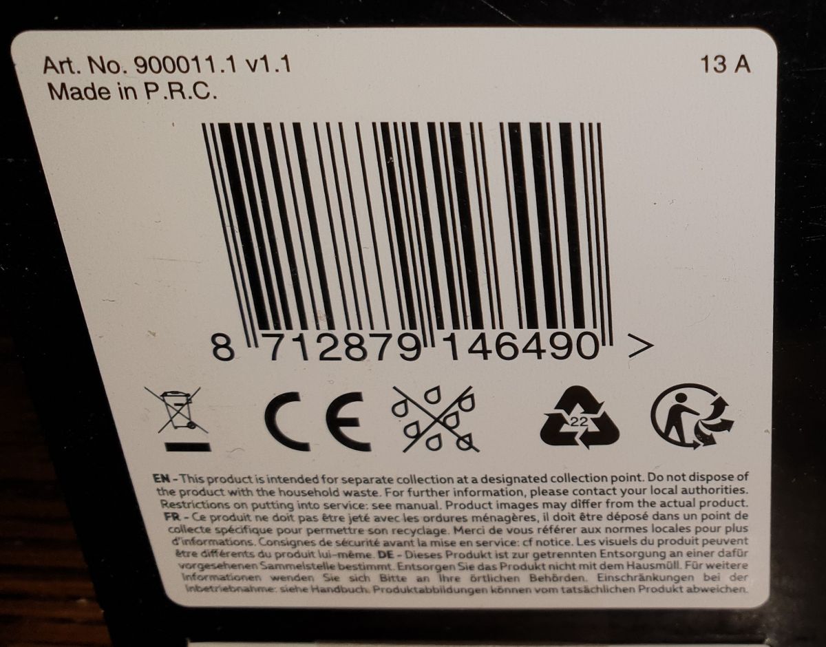

  • Presenting a Calex Holland "Smart Power Plug UK" bought from Tesco for £8 (clubcard discounted).
    Article number is 900011.1
    Board is marked WE-08(10)V1.1 2020.4.13
