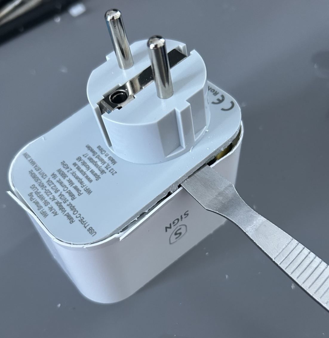

    I recently got a SiGN WiFi Smart Indoor Plug 16A with 20W Fast Charging (2xUSB A and 1xUSB C). I have seen similar models on Ali.
    Packaging of SiGN WiFi Smart Indoor Plug 16A with 20W Fast Charging

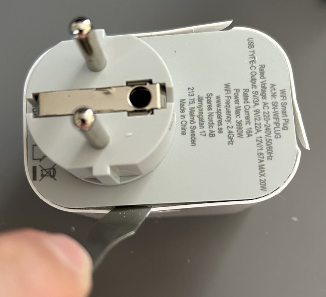

    Warning: It is not easy to open the plug as it is glued together, and it is a bit cumbersome to get access to the CB2S module on the inside.
    I used a hobby knife and some prying tools to open up the plug. I tried to do it carefully, but I could not avoid some damage.
    Close-up of SiGN WiFi Smart Plug back with prying tool inserted into housing
    SiGN smart plug partially opened with a prying tool inserted between casing halves

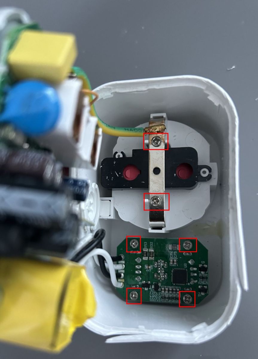

    After successfully opening up the plug, I removed the screws below to take the plug further apart:
    Disassembled WiFi plug interior with marked mounting screws and PCB

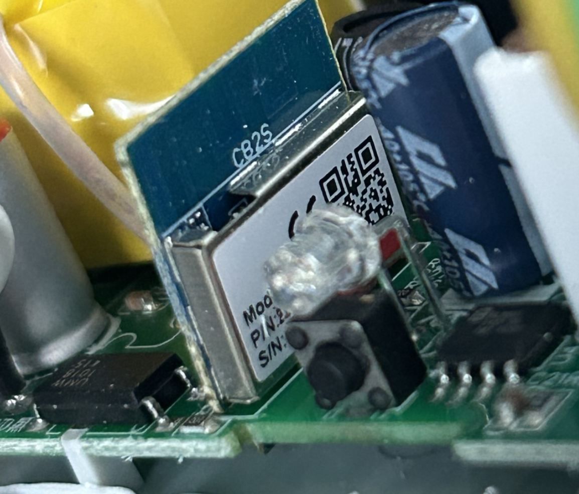

    The plug is featuring a CB2S module:
    CB2S module soldered to PCB near push button and capacitor

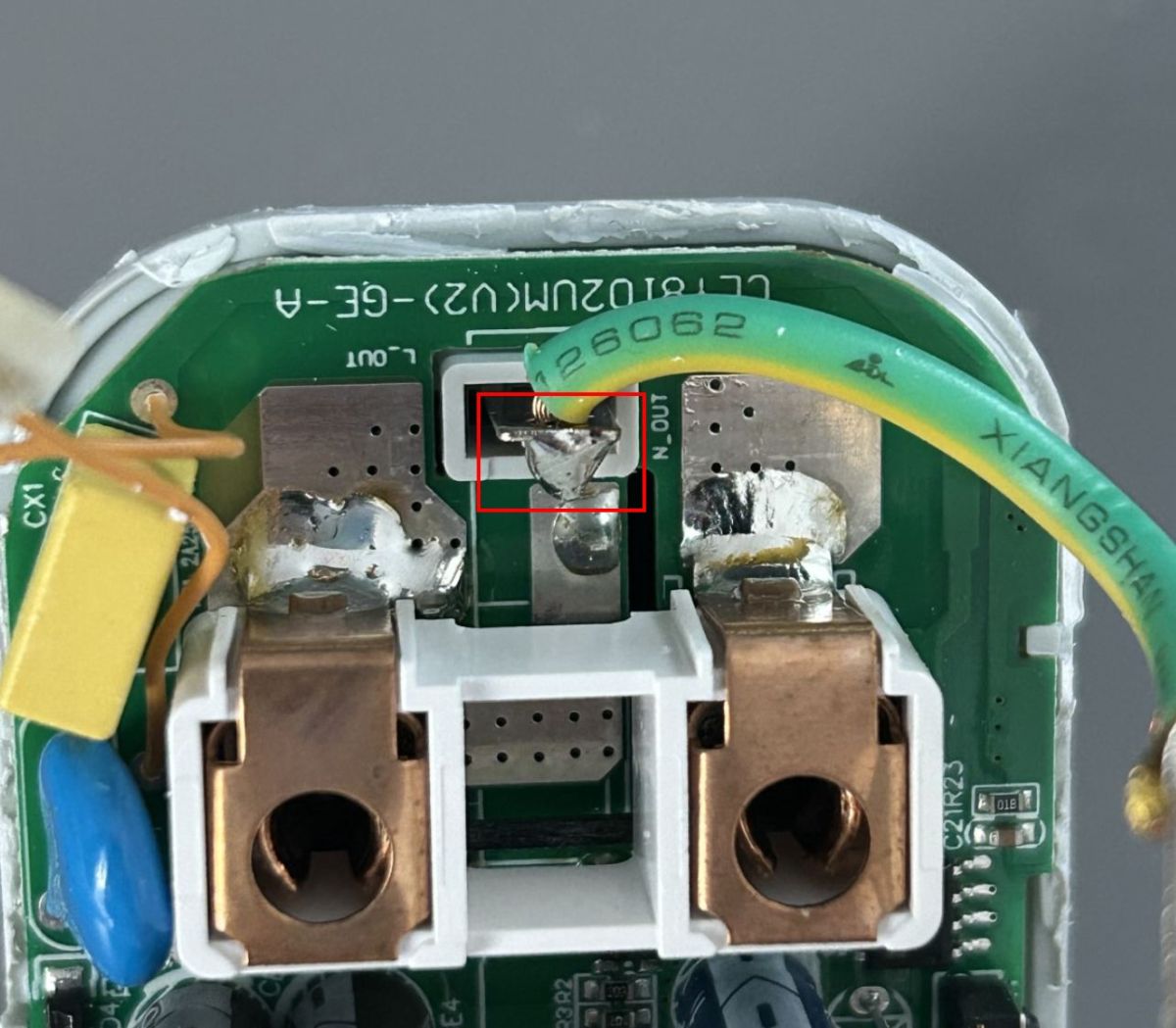

    I desoldered the green and yellow cable:
    Close-up of grounding connection inside smart plug with exposed green wire

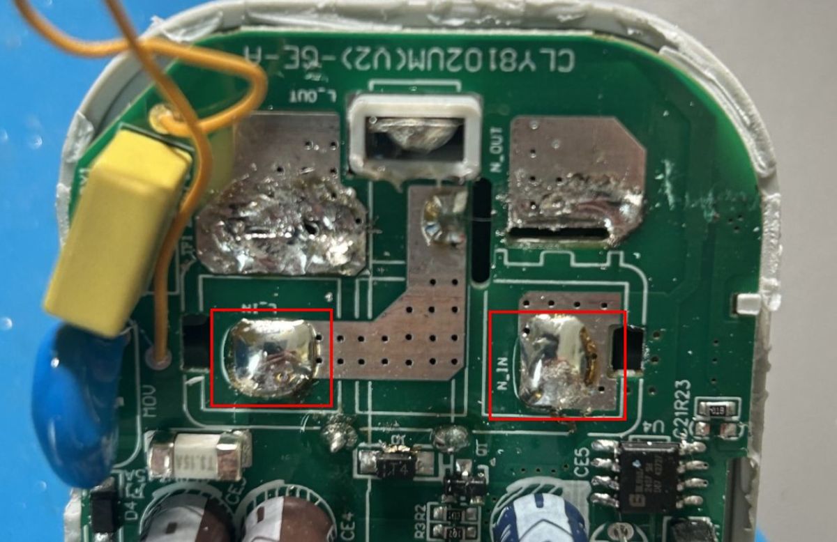

    Next up, I desoldered this thingy. There are some plastic bits underneath the board that needs to be pressed for the thingy to detach.
    Close-up of plug interior with visible solder points and metal contacts

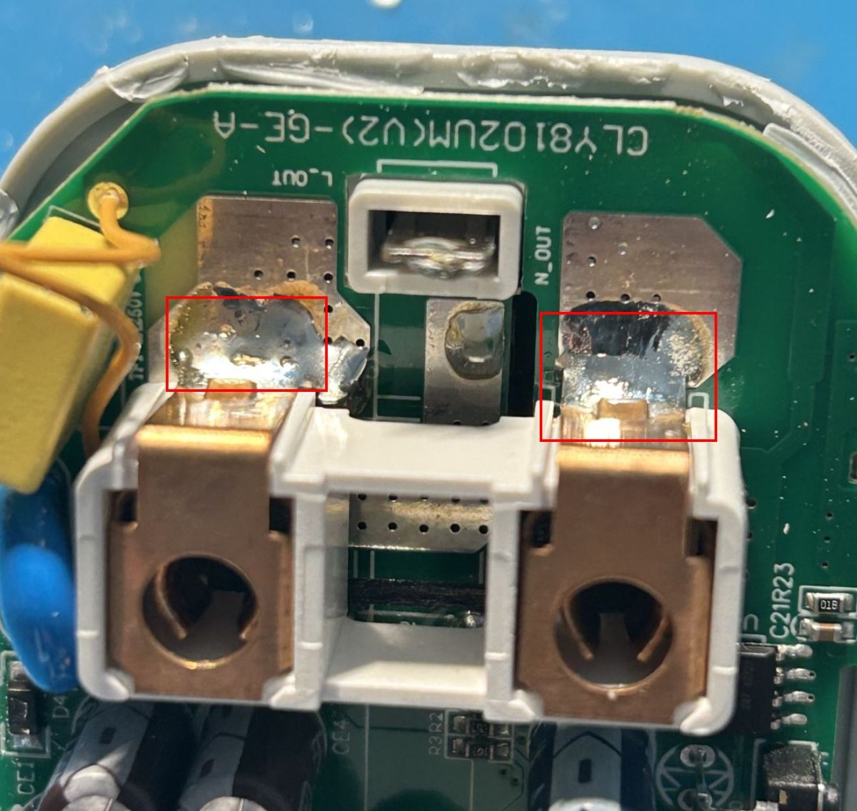

    Now it is time to desolder the metal plugs to get the board detached:
    Close-up of a PCB with exposed and boxed solder joints.

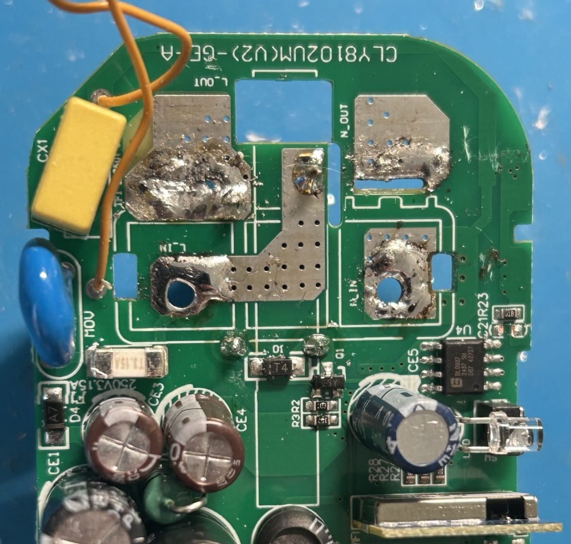

    Now the board is finally detached:
    Close-up view of a PCB with burned solder points and electronic components

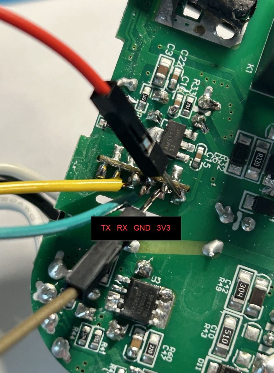

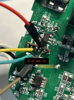

    And there is access to the CB2S pins. I soldered four cables to the module (3.3V, GND, RX, TX).
    Close-up of PCB with connected wires to CB2S module pins: TX, RX, GND, and 3V3
