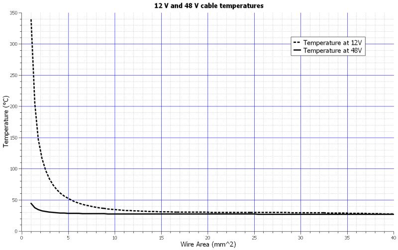

    The following table shows that for the same motor power and cables used, the temperature reached by electrical cables is quite different and sometimes critical.

    In Figure 2, the thermal gradient of cables crossed by electric current can be observed. The critical cases, with a power supply of 12 V, are represented by the cables with cross-sections of 1 mm², 2 mm², 3 mm² and 4 mm². They reach very high temperatures and pose a danger to the whole circuit. For a 48-V supply, however, there are no particular problems.

    Figure 3 shows the temperature graphs, relative to the above table.
    Tutorial: Why Car Power Supplies Are Migrating From 12 V to 48 V
    Figure 3: The graph of temperatures reached by the electrical cables, with a voltage of 12 V
