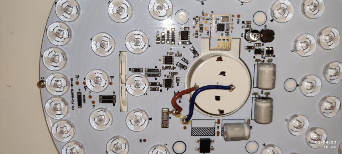

    Hi wonderful people,
    I use Home Assistant and just bought a RGB-CW ceiling light, hoping to integrate it via Tuya or by a custom firmware upgrade.
    https://www.amazon.it/gp/product/B0B689DJVZ/ (I'm not affiliated in any way).
    However, to me it seems the beginning of a rabbit hole, as:
    1. It isn't supported by the Tuya app, but by an app called "Surplife".
    2. I was not able to add this lamp in the Tuya app.
    3. The SoC board is marked BL-M5 v1.2
    4. The SoC is a BL602C20, for which Bouffalo says: “BL602 supports the use of ECC-256 signed images to provide secure boot protection”.
    Integrating Taipow 30W Plafon Ceiling Lamp RGBCW with Home Assistant: BL-M5 V1.2/BL602 SoC Issues
    5. Tuya CloudCutter did not exploit this device.
    6. TinyTuya didn't find this device after adding it to my LAN.
    7. I would like to use hid_download_py, but I wasn't able to find TX, RX and RST. The only pins I found marked on the LED board and on the SoC board are: 3.3v, GND, DAT, CLK. I feel dumb, but I wasn't able to find the pinout of the SoC board (BL-M5 v1.2).
    The lamp performs very good with its RF remote, and it isn't easy to find such products, thus before returning it to the seller I would make other tests, here are my questions:
    A. How can I try to attach a FTDI adapter and flash the BL602 firmware (.bin)?
    B. Do you think the "ECC-256 signed image" could prevent booting a custom firmware?

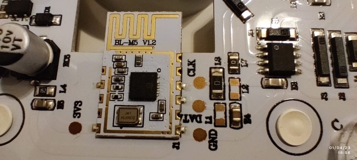

  • Programming pads appear to be under the board
    #2 20519784
    Posts: 14770
    Rate: 12913
    you need to know where RX/TX pads are.
    Cloudcutter doesn't support BL602.
    We need to either find documentation of BL-M5 V1.2 or desolder that one module with hot air (or with a tricky method with cheap soldering iron) and read the markings on the other side of module PCB.
    Have you seen our WiFi module desoldering tutorials?

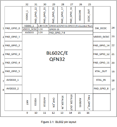

    You could also try probing if you have tiny probes, because we know the pinout of BL602 in QFN, and see where programming pads are going...
    Here is pinout of BL602C/E QFN32:
    do you have probes and the precision to do checking where each GPIO connects?
    Added after 49 [seconds]:
    Wait, here is pinout:
    https://www.elektroda.com/rtvforum/topic3949764.html#gallery-6
    Oh no, it looks like programming pads are under the board:
    You can flash it with OpenBL602 but that would require desoldering the module.

  • Mapped BL602 board pins and accessible pads
    #5 20521426
    piebru
    Posts: 7
    >>20519784
    I managed to map the board pinout with 13 out of 24 pins of the BL602 SoC:
    Board - SoC
    A - 10
    B - 3
    C - 4
    D - 11
    E - 8,21,22 - 3.3v
    F - 5
    G - 15
    H - 24 - CLK
    I - 23 - DAT
    J - 2
    K - 20 - GND
    The FCC docs aren't of much help, as it shows an "old" prototype: https://fccid.io/2A9HW-BL602
    On the board, only B, E, H, I, K seem soldered. TX, RX and RST (GPIO8?) may be accessible by some unsoldered board pins, but we will know only after desoldering.
    I don't have an air desolder and will try the poor man post-apocalyptic way :-)
    Meanwhile, is there other info I can contribute before the surgery?
    Piero

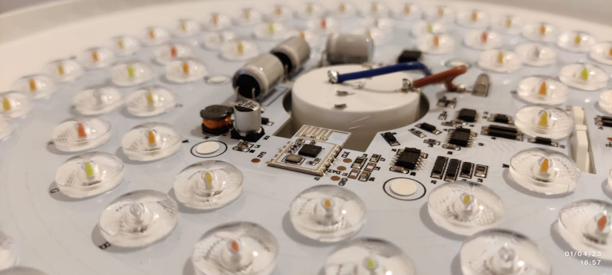

    There are 3 LED driver chips, all 3 are BP5758 https://github.com/dbuezas/esphome-bp5758
    CLK and DAT are connected with two pins of the first (labelled Q1) LED driver.

    I assumed pin 1 on the LED drivers is the one marked with a black dot on the PCB.
    Added after 4 [minutes]:
    >>20521483
    While Q1 (the topmost) pins 3 and 4 are connected directly to the corresponding SoC pins, Q3 and Q4 pins are connected through resistors to the same SoC pins.
    Added after 5 [minutes]:
    Forgot the picture, sorry :-(

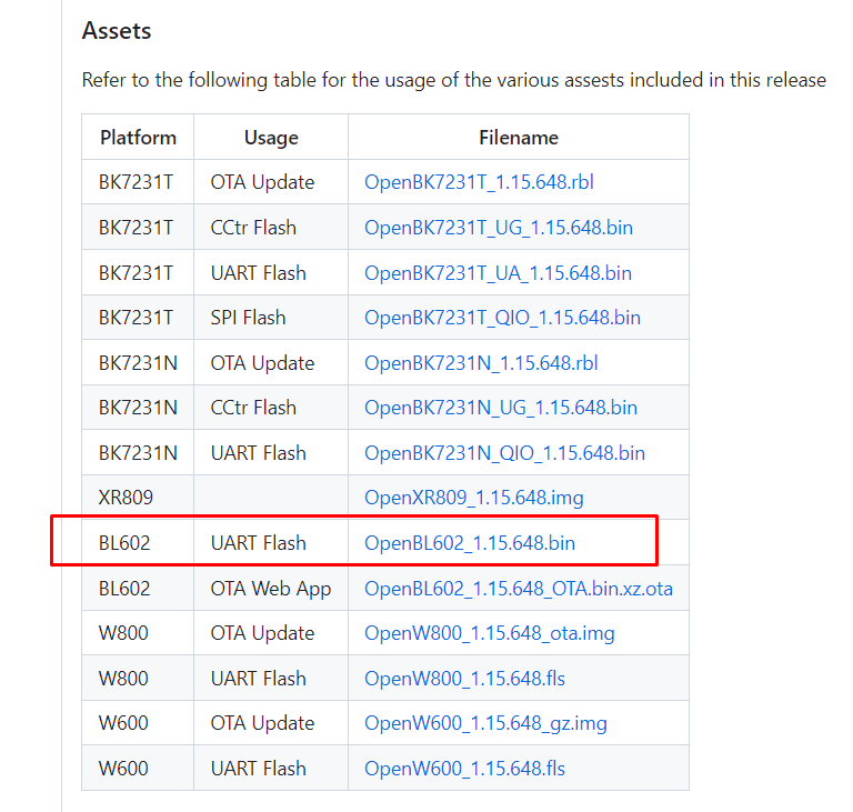

  • Confirming the correct Tasmota bin for BL602 board

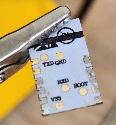

    #10 20522520
    piebru
    Posts: 7

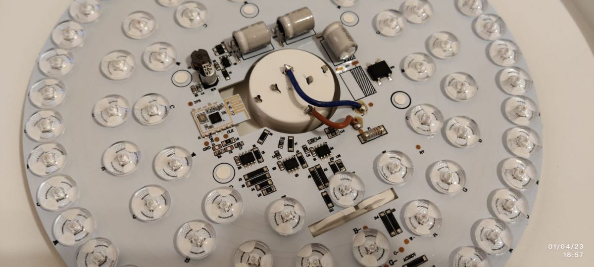

    Desoldered the board with as little damage as possible, I hope it will work once soldered again on the PCB.
    All pins letters and numbers are referred to my mapping above: TX is "F" and RX is "G". BOOT seems not connected to a board pin, but it's on the SoC pin "15" that is connected with the nearest pull resistor (near the xtal). A temporary reset should be possible using a thin probe.
    I would like to install Tasmota, but I fear the unusual LED drivers.
    Can you confirm what .bin I can try first?
  • #11 20522545
    Posts: 14770
    Rate: 12913
    BP5758 is supported, you just need to know which GPIO for BL602 are used for SDA and SCL and then maybe remap colours.
    You have the flashing procedure shown here:
    https://www.youtube.com/watch?v=L6d42IMGhHw
    Binaries are here:
    https://github.com/openshwprojects/OpenBK7231T_App/releases/
  • Pinout for flashing BL602 without desoldering
    #12 20522580
    piebru
    Posts: 7
    Thanks, it seems one can flash it even without desoldering.
    So these are the most interesting pins in this Taipow lamp:
    FTDI --> BL602 board --> BP5758
    3.3V "E" -
    GND "K" -
    TX "F" -
    RX "G" -
    BOOT resistor lead near the xtal
    - DAT SDA (pin 3)
    - CLK SCL (pin 4)
    In a few days I will try to flash the SoC board after re-soldering it on the PCB, just to see if it can be flashed to Tasmota without de-soldering.
  • #13 20522657
    Posts: 14770
    Rate: 12913
    This is a very good news. If RX/TX is indeed connected to F and G, and BOOT signal is available on the resistor, then it should be possible to flash this device without desoldering the WiFI module.

Is there a video tutorial to follow for BL602 flashing?
Yes. The thread links step‑by‑step videos demonstrating the BL602 serial flashing workflow. Follow the sequence to enter download mode, then push the firmware image. Use a 3.3V FTDI and correct RX/TX orientation. [Elektroda, p.kaczmarek2, post #20519793]
Can I use ESPhome if I replace the BL602 board?
Yes. One user transplanted an ESP32 board and ran ESPhome with BP5758 outputs. They used 0.5 s transitions, 2700–6500 K whites, and 10 mA channel current. They also added mmWave presence and a light sensor. [Elektroda, piebru, post #20542665]
What can go wrong when desoldering or flashing this board?
Desoldering the module can lift copper tracks or pads. One user damaged PCB tracks during removal and needed repair. Reduce risk by flashing in‑circuit via RX/TX/BOOT and minimal probing. Consider fine‑tip soldering and strain relief. [Elektroda, piebru, post #20542665]
Does OpenBeken support this lamp’s LED driver?
Yes. BP5758 is supported in OpenBeken, so RGB plus dual‑white control is achievable. Obtain the BL602 build from the releases and follow the flashing procedure. Map SDA/SCL to the lamp’s DAT/CLK lines. [Elektroda, p.kaczmarek2, post #20522545]
Is there community help if I get stuck flashing?
Yes. The maintainer encouraged users to try and offered support. "I'd say just give it a go, we'll help you if there is an issue." Post logs and wiring photos when asking for help. [Elektroda, p.kaczmarek2, post #21328650]
