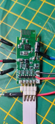

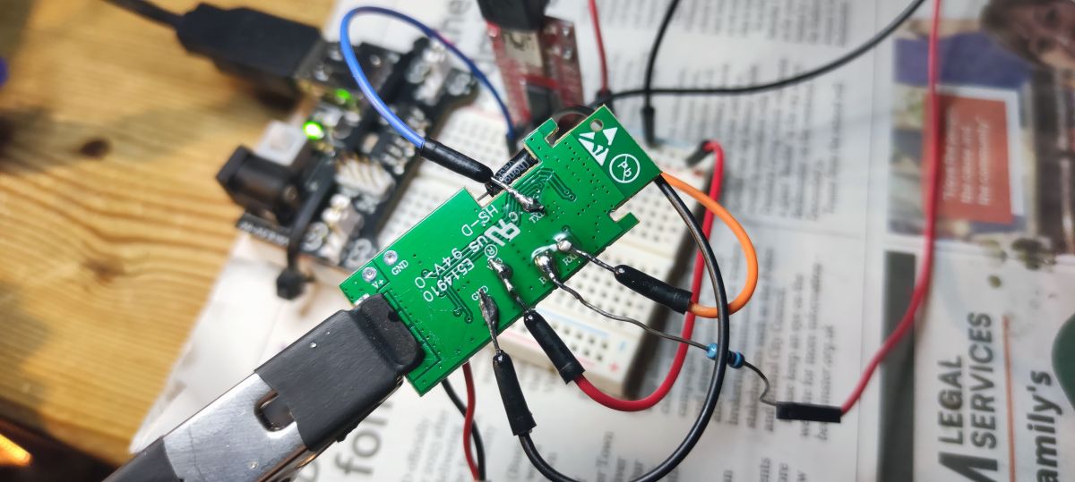

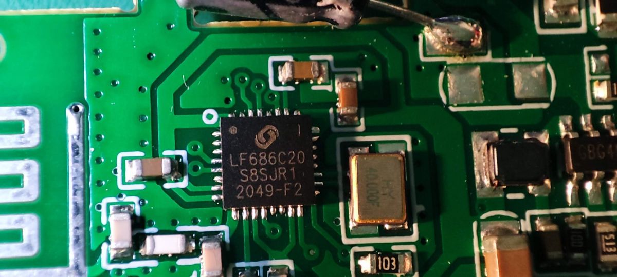

  • A Magic Home RGBW 12-24v 5-pin LED strip controller with an LF686 chip flashed as a BL602 is being configured for OpenBeken.
  • Flashing succeeded only after soldering all pads, powering BOOT from the external 3.3v rail directly, and using BLDevCube 1.4.8 instead of 1.8.8.
  • The working hookup used Ext 3.3v to V33, Ext 3.3v through a 10k resistor to BOOT, GND to GND, and TTL RX/TX crossed to the TX/RX pads.
  • Wi‑Fi appeared only with the external DC jack connected, and GPIO Finder showed pin 20 toggling, but the RGBW pinout and OBK template remain uncertain.

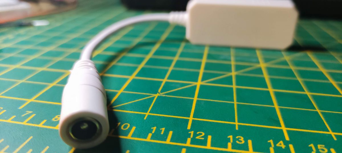

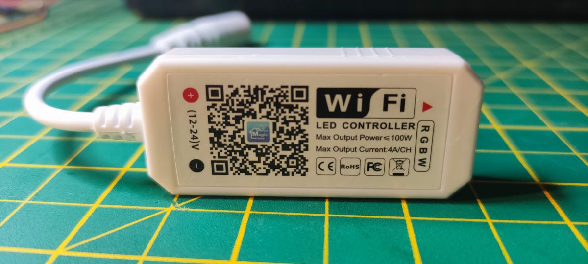

  • Presenting a familiar device, one I've seen around the forum, but this one is without an Ir receiver and comes with an LF686 chip, which is to be flashed as a BL602.

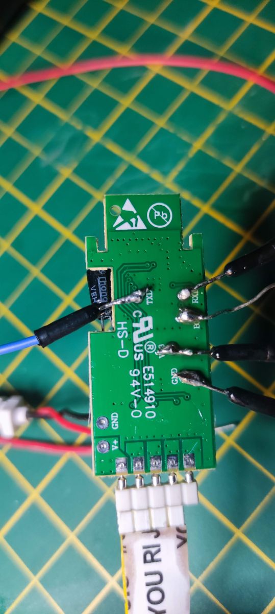

    I spent HOURS trying to get this to flash with my pogo pins and several different USB-TTL adaptors but I only got success after soldering all pads AND pulling BOOT from 3.3v rail on external PSU directly, not via V33 pad and 10k resistor. I also tried v 1.8.8 of the BLDevcube. Success was using 1.4.8.
    Ext 3.3v -> V33 pad
    Ext 3.3v -> 10k R -> BOOT pad
    Ext GND -> GND pad
    TTL RX -> TX pad
    TTL TX -> RX pad
    TTL GND -> Ext GND
    Post-flash there was no wifi, even using external 3.3v (and with BOOT unsoldered), but with the external DC jack connected, it all came up. I did not use V+ and GND pads on this board. I have read in another thread that someone had success flashing with 5V on V+.

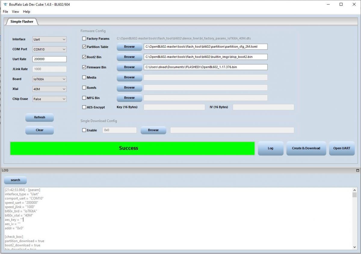

    BLDevCube software interface with selected options and a success message. Electronic board with soldered wires connected to a USB-TTL adapter. Magic Home RGBW controller board with soldered wires. Close-up of a circuit board with wires connected to various pads. Close-up of a circuit board with an LF686C20 chip. WiFi LED controller Magic Home with a label and QR code. White cable with DC connector on a green cutting mat with a centimeter scale. User instruction manual for Magic Home RGBW LED Controller in plastic packaging. Close-up of two packaging bags with product labels for electronic items.

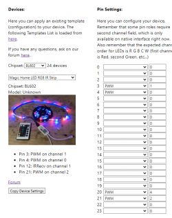

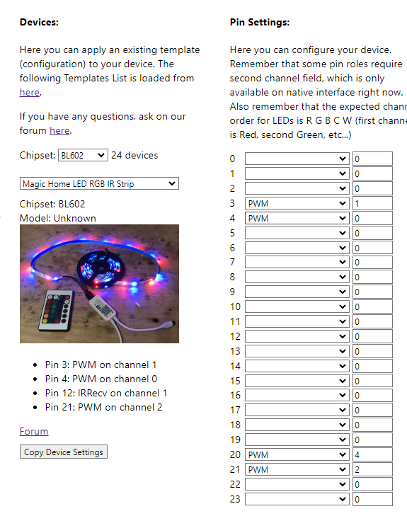

    I tried the device profile of this device but cleared the ir GPIO and used the GPIO Finder to see that pin 20 toggled something on/off
    Screenshot of the Magic Home LED controller configuration with BL602 chipset.

    divadiow wrote 5031 posts with rating 891, helped 438 times. Live in city Bristol. Been with us since 2023 year.
  • #2 20886585
    Posts: 14584
    Help: 654
    Rate: 12607
    So it's basically the strip controller from out video but with a different marking on the chip?

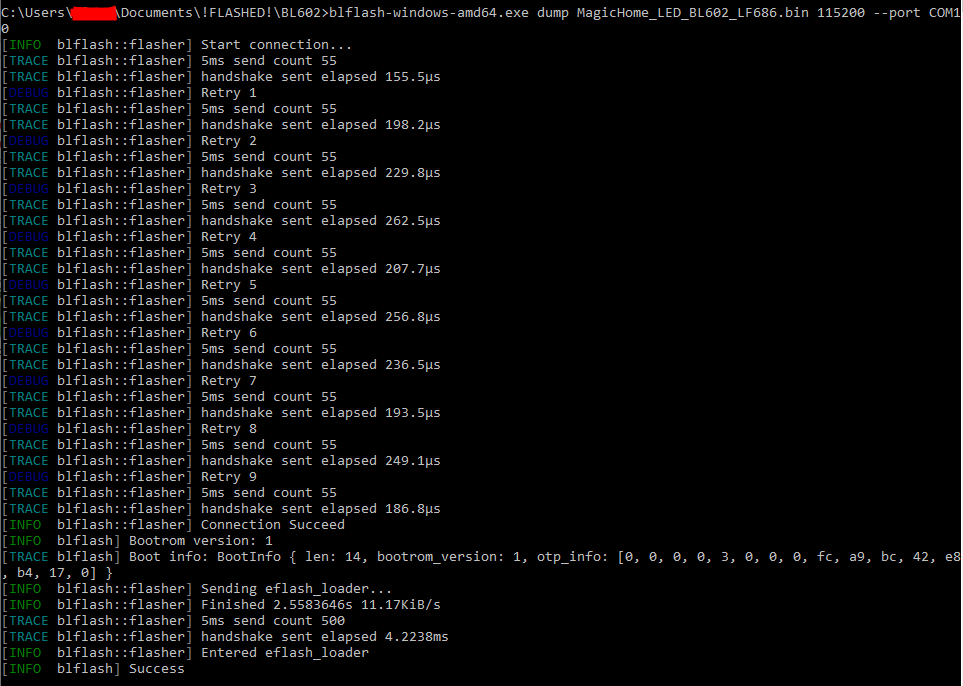

    Screenshot of Bouffalo Lab Dev Cube 1.8.8, displaying settings for flashing the BL602 device and a boot log.
    I'll try factory dump now using https://github.com/spacemeowx2/blflash/releases/download/v0.3.5/blflash-windows-amd64.exe
    • boot.txt (11.84 KB) You must be logged in to download this attachment.
  • #14 20906763
    Posts: 5031
    Help: 438
    Rate: 891
    and here is a dump deleted. was junk
    Screenshot of a text terminal showing the procedure of flashing a binary file onto a device.
    blflash-windows-amd64.exe dump MagicHome_LED_BL602_LF686.bin 115200 --port COM10

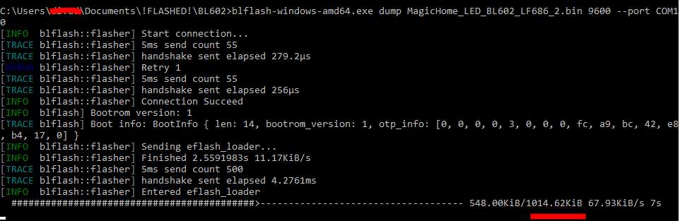

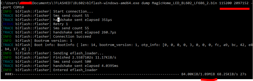

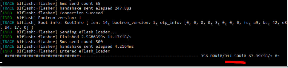

    Is it full dump? This device has 2MB flash, right? Hmm. Maybe you need to specify the size.
  • #16 20906779
    Posts: 5031
    Help: 438
    Rate: 891
    hmm, unsure. during the dump it does give a progress/total bar. 911.50kib is total.
    I don't see any size option switches for the exe. I'll play more later
    Screenshot of a terminal showing a flashing procedure with a progress bar and data transfer details.
    Added after 3 [minutes]:
    I'm trying different speeds and the total is the same for all so far apart from 9600 baud
    Windows console showing the result of a blflash command with data dump progress.
    Added after 8 [minutes]:
    getting closer
    File name and properties of a binary file on a Windows file list.
    Added after 6 [minutes]:
    oh i see, the numbers im specifying are the size of flash to dump (maybe?), not the speed, if setting one set of numbers. Screenshot of a terminal showing the process of dumping data from a device to a binary file.
    Added after 53 [minutes]:
    I see from the datasheet that onboard flash is optional. With this command, which includes the --<parameters>, I get a 1mb dump
    blflash-windows-amd64.exe dump MagicHome_LED_BL602_LF686_2.bin --initial-baud-rate 115200 --baud-rate 115200 --port COM10
    https://www.leapfive.com/wp-content/uploads/2020/09/LF686-Datasheet.pdf

    So can you try to use this command to dump 2MB?
    Screenshot of a terminal with data transmission information to a device via COM10 port.
  • #18 20907230
    Posts: 5031
    Help: 438
    Rate: 891
    Here's the 2MB using deleted. was junk
    blflash-windows-amd64.exe dump 2MB_MagicHome_LED_BL602_LF686.bin 115200 2097152 --port COM10
    No idea if it's complete.

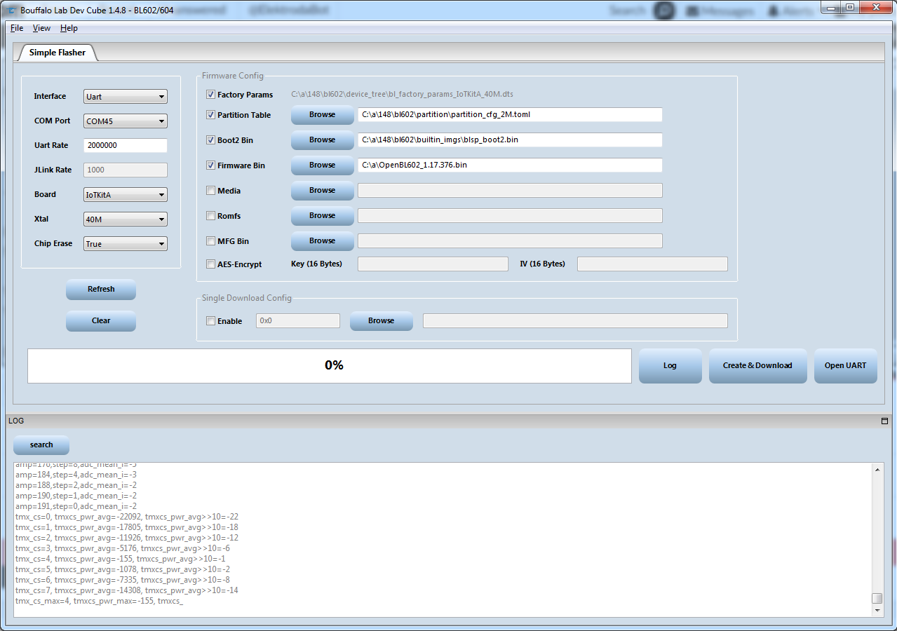

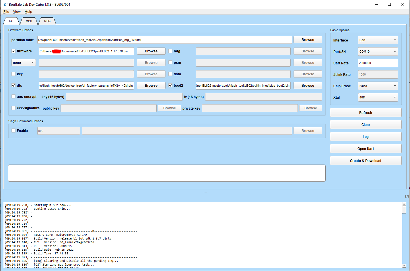

    tech_fr3ak
    I have two modules with me, the same version as the OP. I am not able to make it work.
    Connections:
    - RX to TX
    - TX to RX
    - VCC to 3V3
    - GND to GND
    - Boot to 10k resistor to 3V3
    Screenshot of Bouffalo Lab Dev Cube software showing configuration for flashing an IoT module.
    Flashing part seems successful, but then, as per the log, it seems stuck in a boot loop and keeps crashing all the time.
    No AP
    What am I missing here? Attaching logs, please check.
    Versions tried: 1.17.376, 1.17.398, 1.17.413.
    Earlier, I was getting AP as LEDXXX, which I don't see now, so for sure flashing is done.
    • uart-log.txt (14.46 KB) You must be logged in to download this attachment.
    • flash-success.txt (20.17 KB) You must be logged in to download this attachment.

    I *think* I had a boot loop until I powered it off the 12V DC adapter through the barrel connector. I have had issues with some devices anyway.
  • #23 20915028
    Posts: 14584
    Help: 654
    Rate: 12607
    That's as @divadiow say. It has been discussed several times on our forum already, but you need to power your BL602 with a good power supply to get stable WiFi, especially STA mode.

  • #26 20915156
    tech_fr3ak
    Thanks for the input. Yes, I am using a 12V 5A PSU, powering via the barrel only, not from the USB flasher/PC.
    It's just that I was not seeing the AP, so I connected to the PC for debug.
    Also, for me, the boot reason is watchdog, as per the log.
    Boot Reason:        BL_RST_SOFTWARE_WATCHDOG
    I had ticked the Factory Params box. Can that be the issue? I flashed again without checking that, but it's still the same.

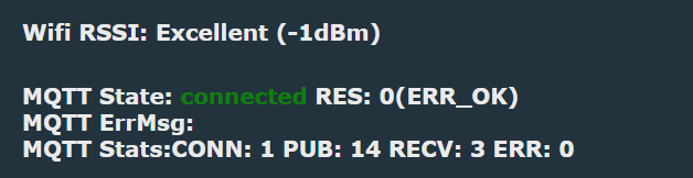

    I have another problem with my second device. Flashed okay, copied the config from the first one and from the Web interface works like a charm. Connecting it with HA on the other hand gives me only RSSI sensor, but no light controls. What am I missing?
  • #28 20918515
    Posts: 14584
    Help: 654
    Rate: 12607
    @mavrov what is the config? Remember that you need to redo HASS discovery after every config change.

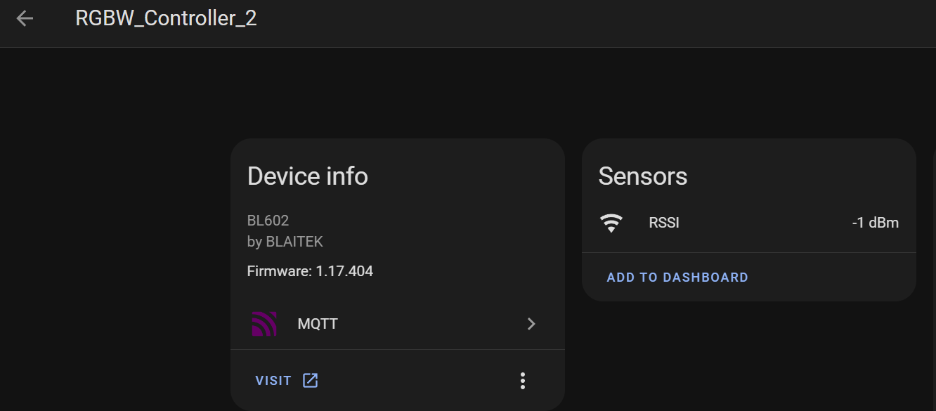

  • #29 20918534
    mavrov
    Level 4  
    Posts: 7
    Display of WiFi and MQTT connection status. User interface for RGBW controller showing device info and sensors.
    This is the device in question. What part of the config you would like me to show you?
    Going back and forth between devices i lost control of my other device, so both now are showing just RSSI.
    Edit: Figured out what the issue was. And how to fix it. In order to make HA detect light control I had to enable flag 24( for simulating white with RGB only). Then again ran HA discovery and the light was there. This in turn made my led strip not use the white channel (which is expected behaviour of the flag). Then after having the light control already in HA I disabled the flag again and ran discovery again. This didn't remove the control this time and made the strip use the white Channel also.
    So in summary for everyone struggling with the light control not appearing in HA for RGBW lights:
    1. Enable flag 24 for forcing white with only RGB.
    2. Do a HA discovery
    3. Disable the flag
    4. Do HA discovery again
    5. Verify each channel is working properly
    Thanks again for the wonderful work on the firmware!
